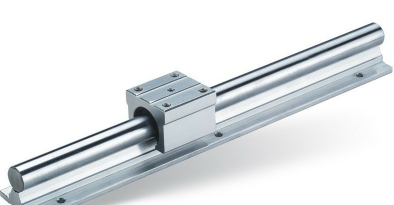

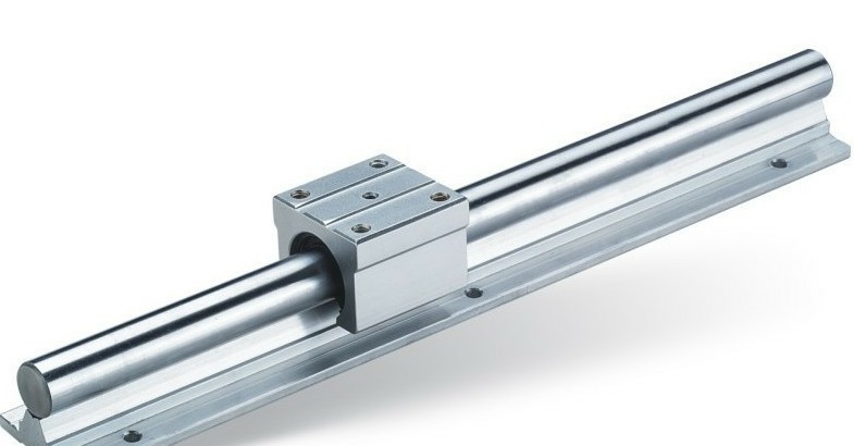

    Hi guys, i want to purchase a few parts from BST AUTOMATION. I purchased a few years ago some linear guides like
    but read bad things about it for aluminium machining :)
