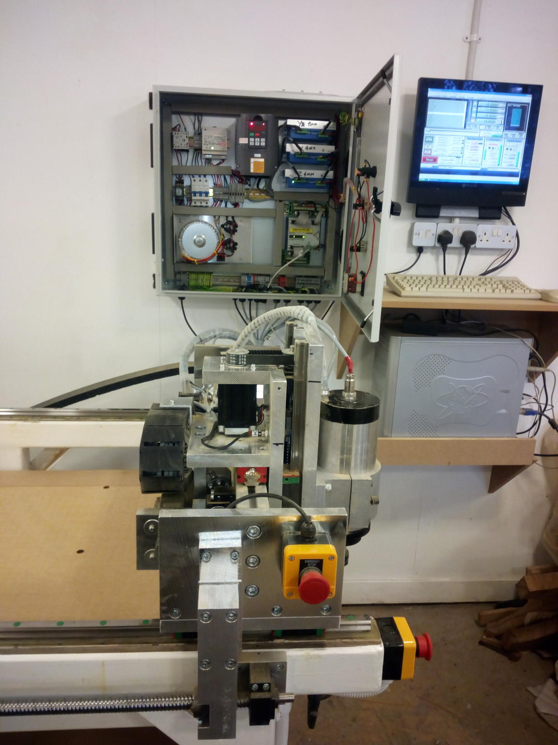

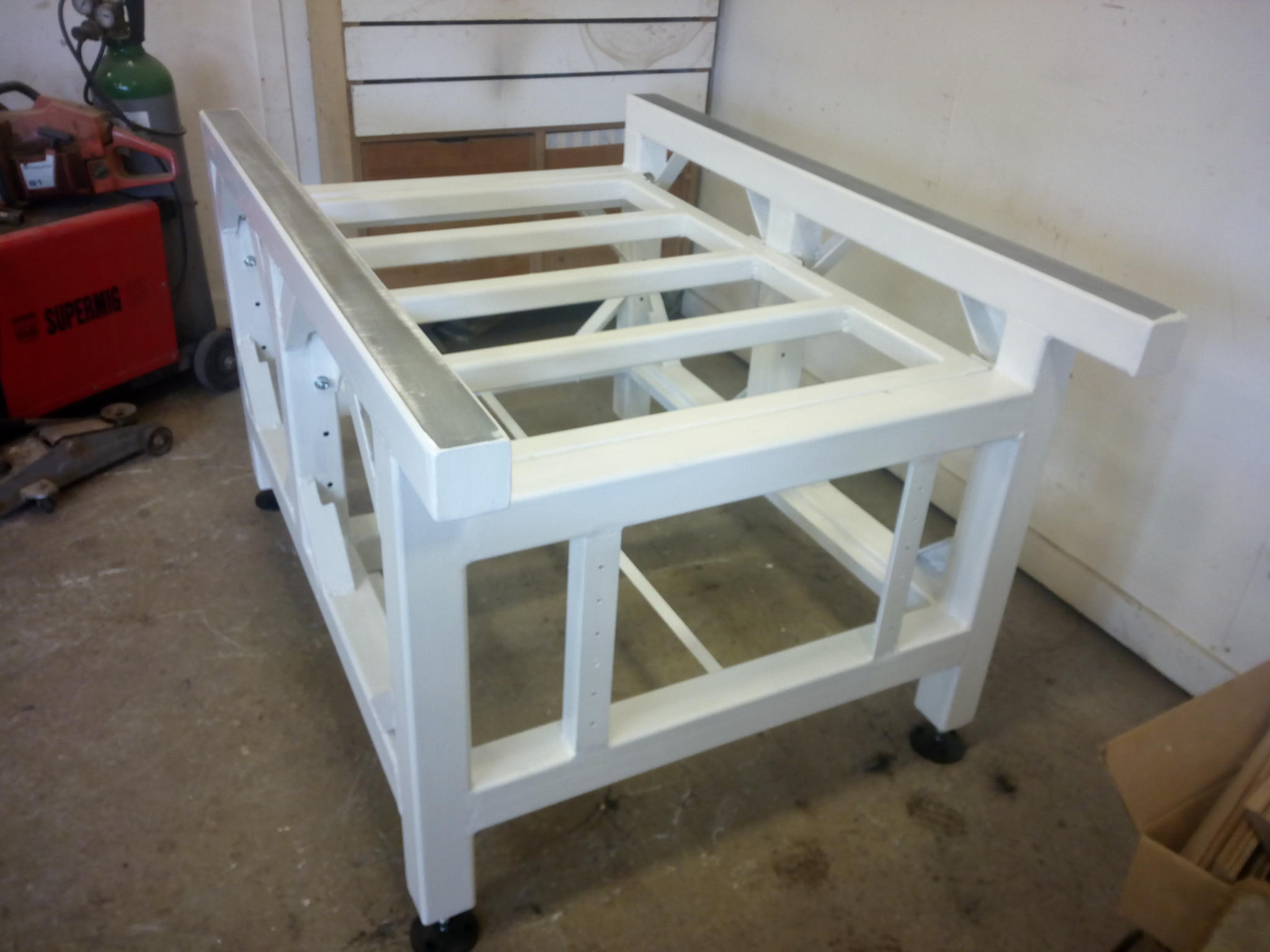

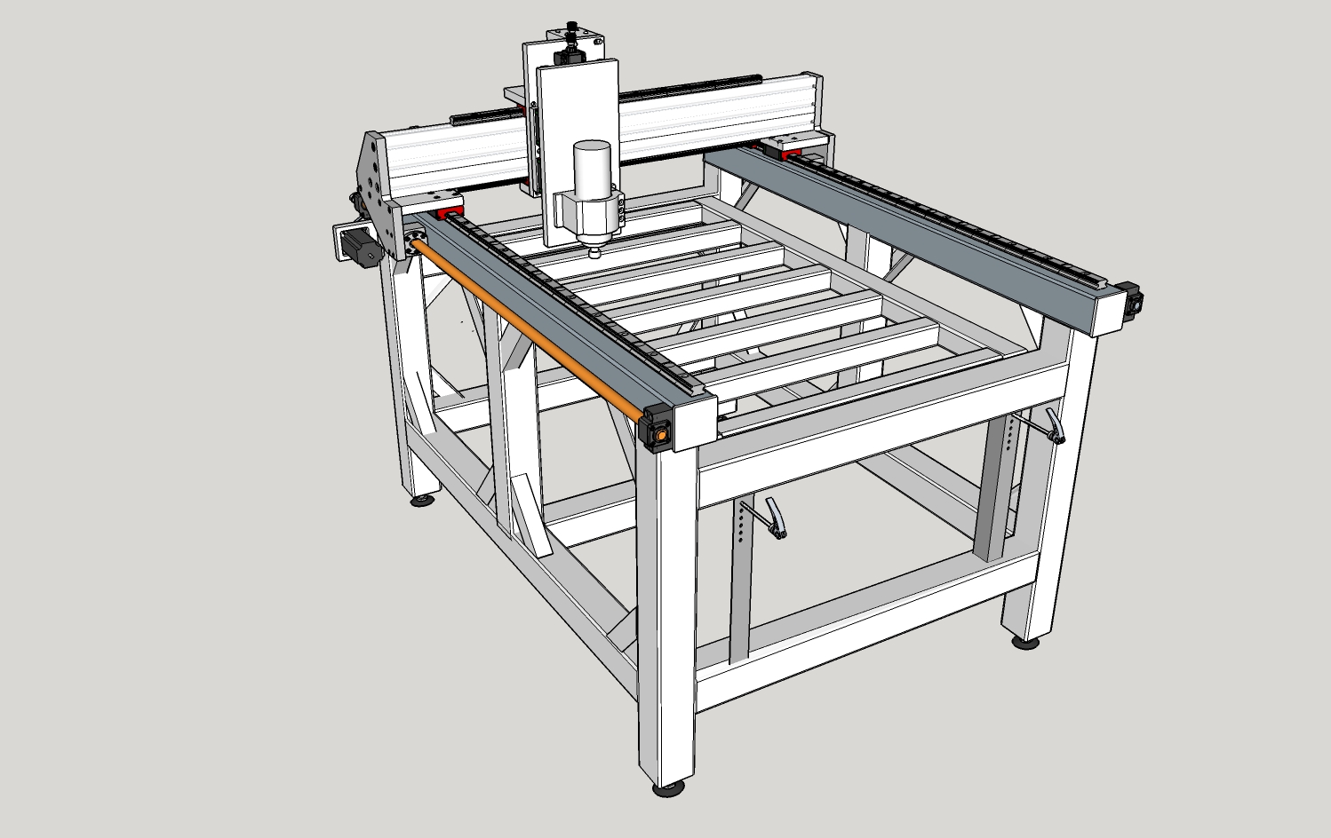

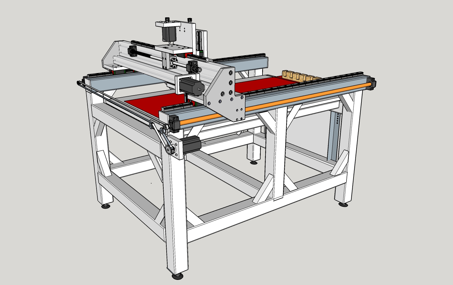

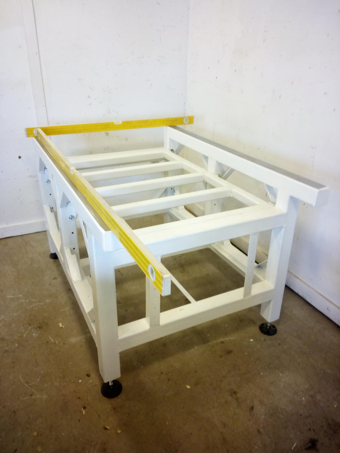

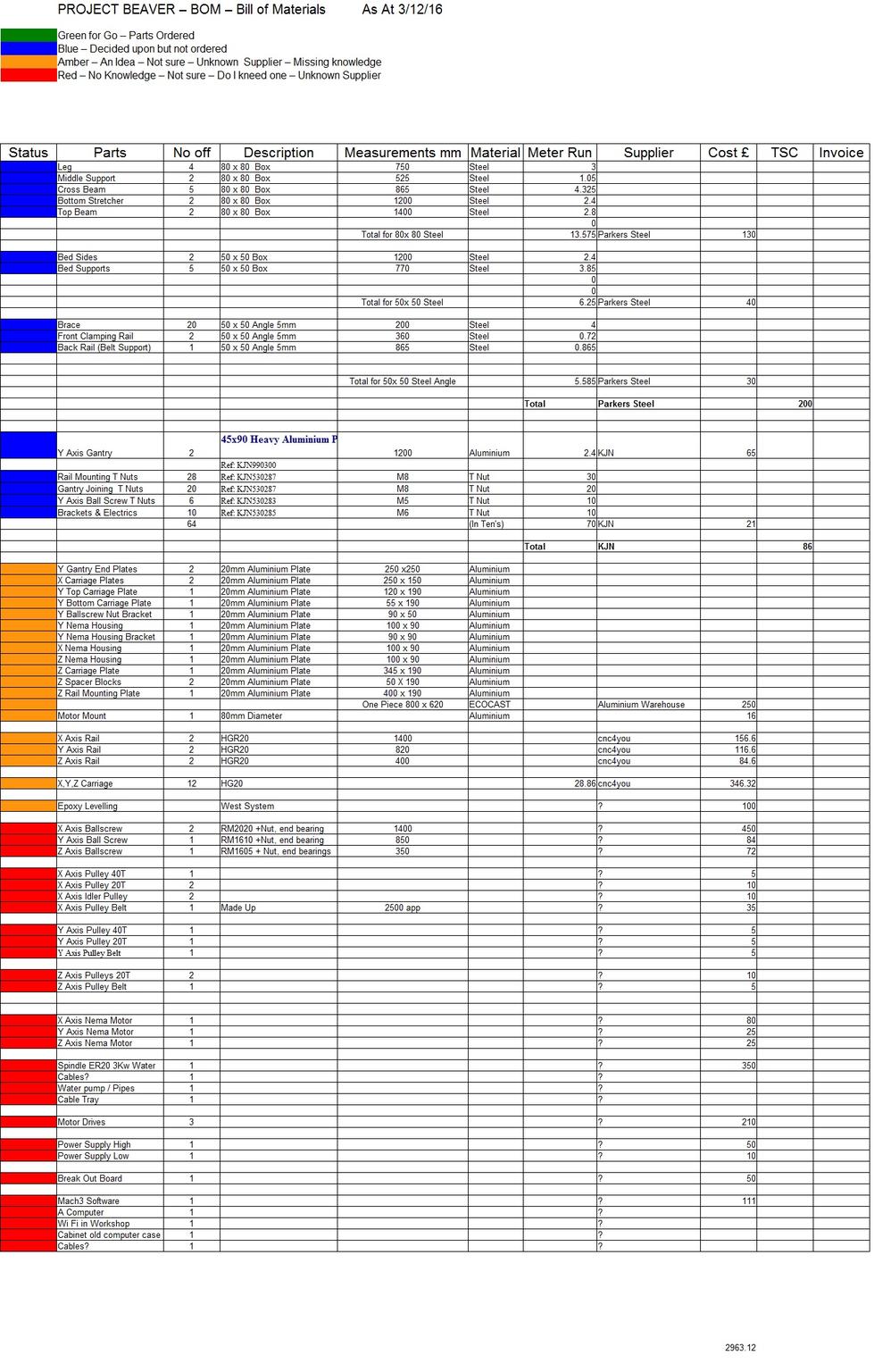

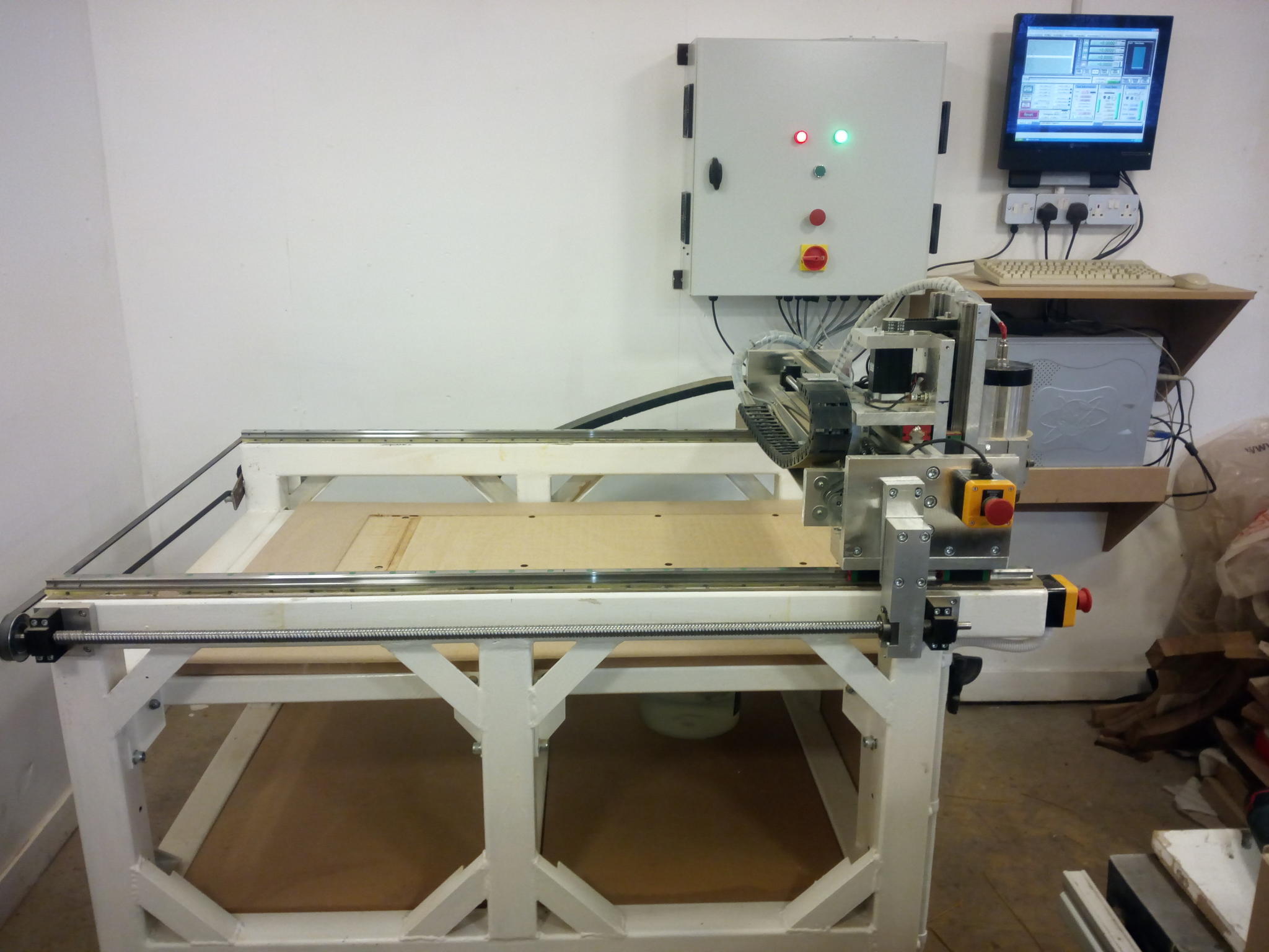

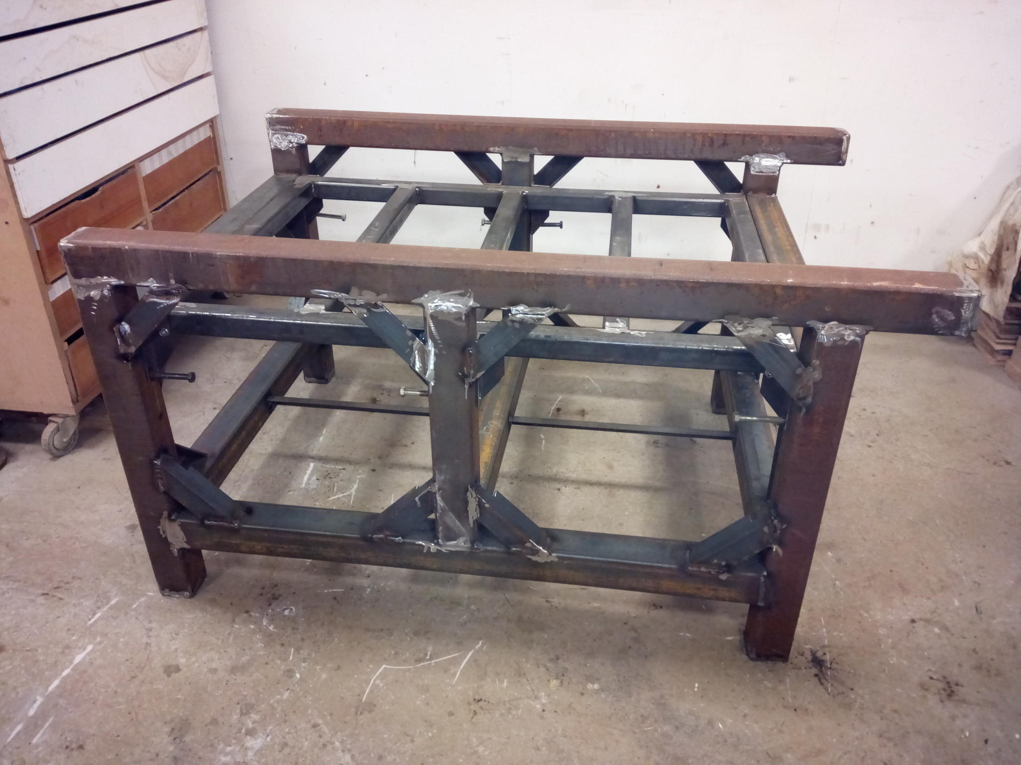

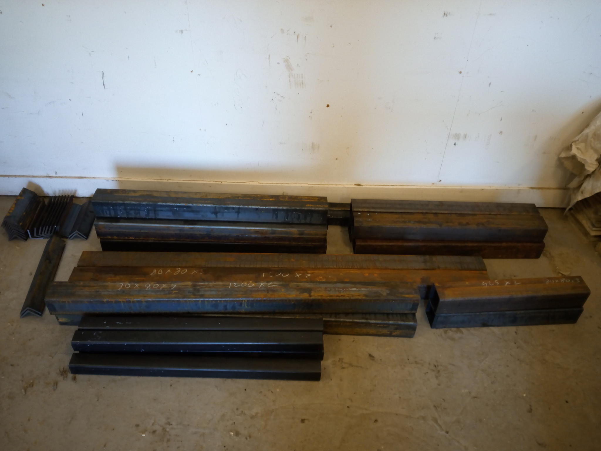

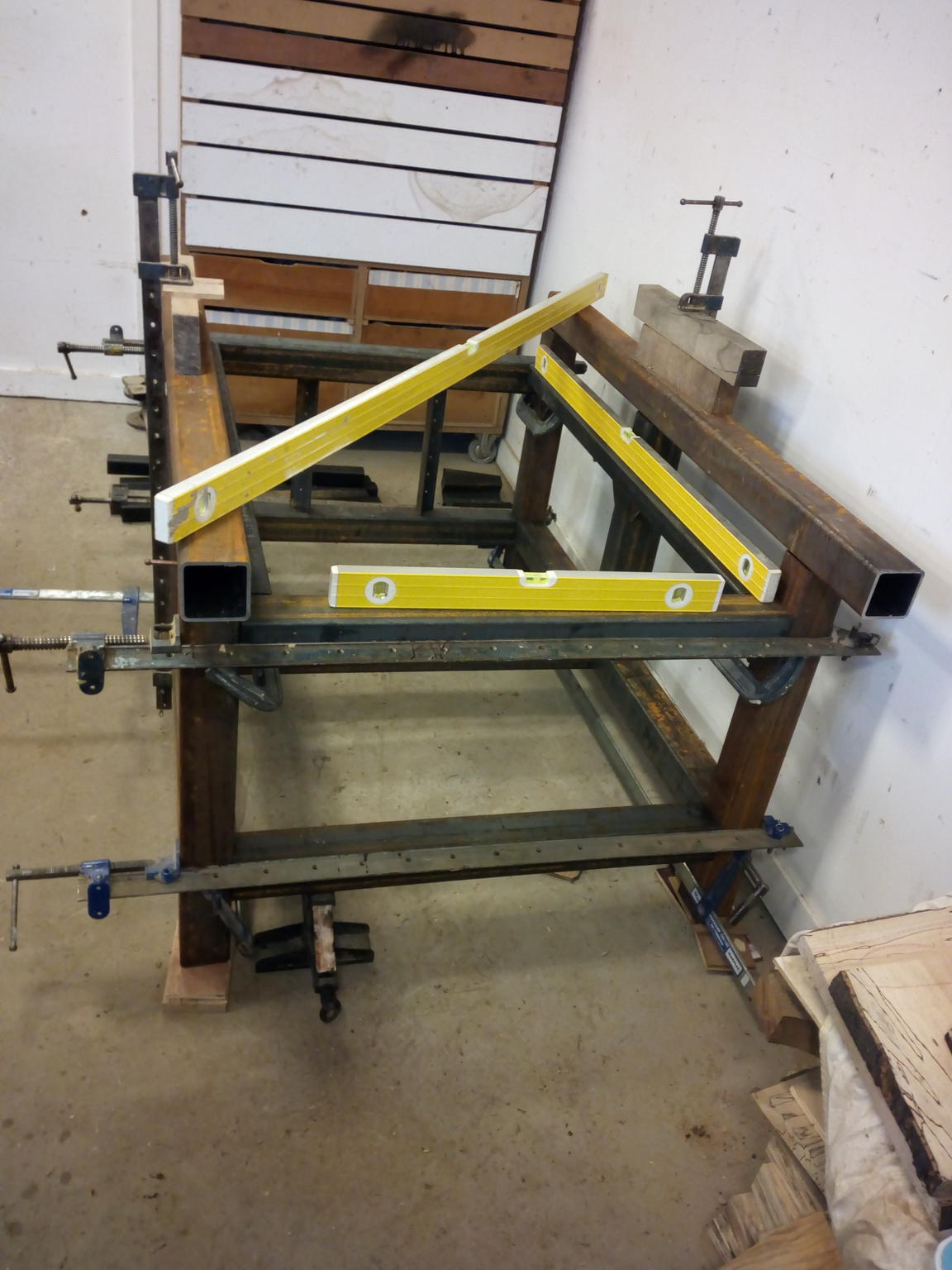

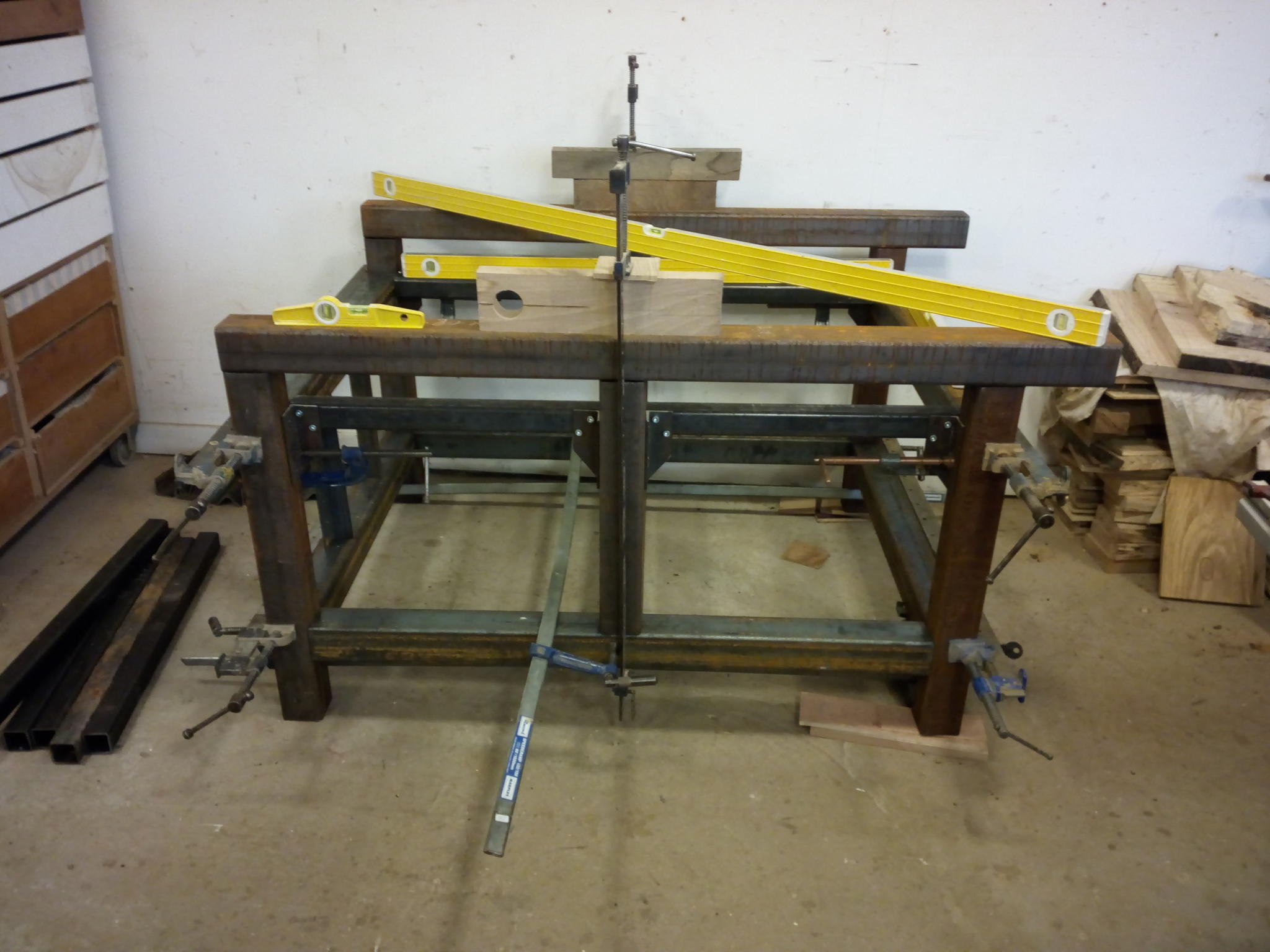

So more or less finished massive thanks to Dean for all his help and the Forum for all the information pictures of anything being great when your studying the detail.

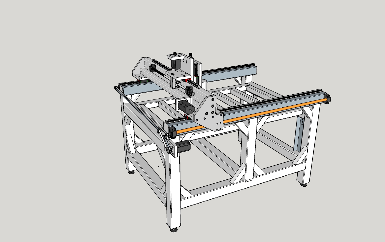

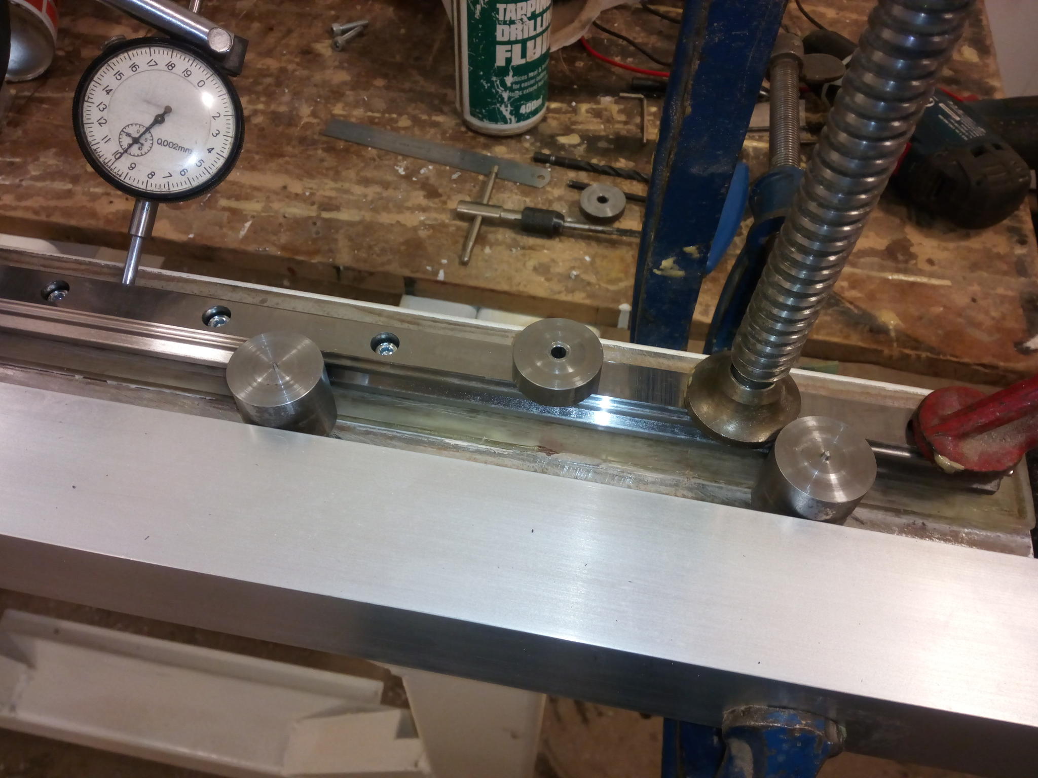

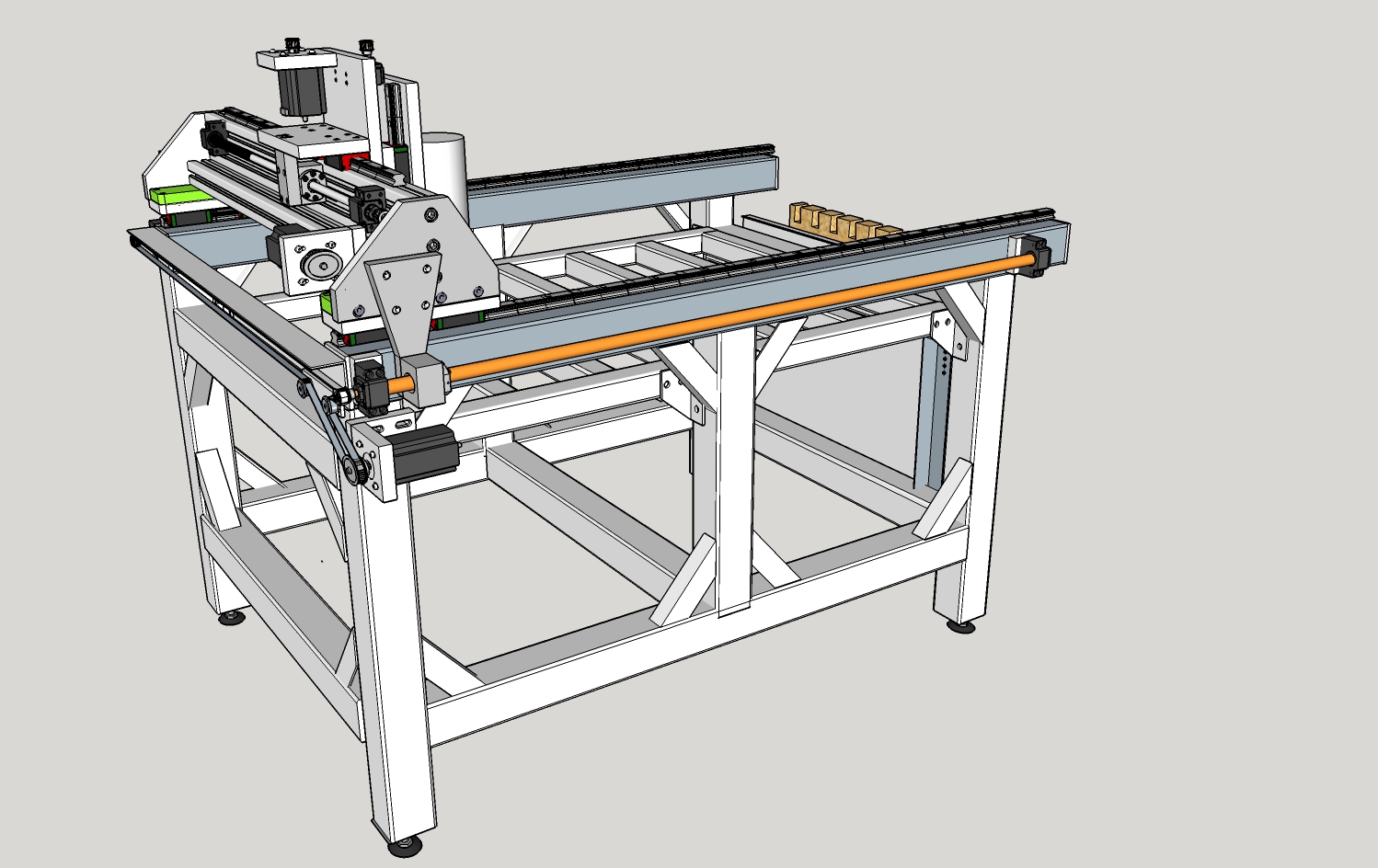

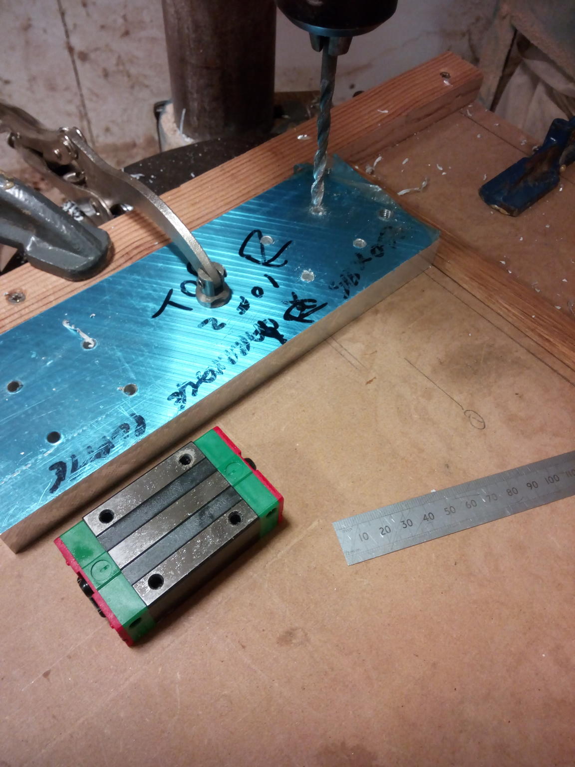

Some changes to the original design being the 50 x 50 x 200mm ball screw housings because of the
problem of getting at screws on the original RM2020 Housings.

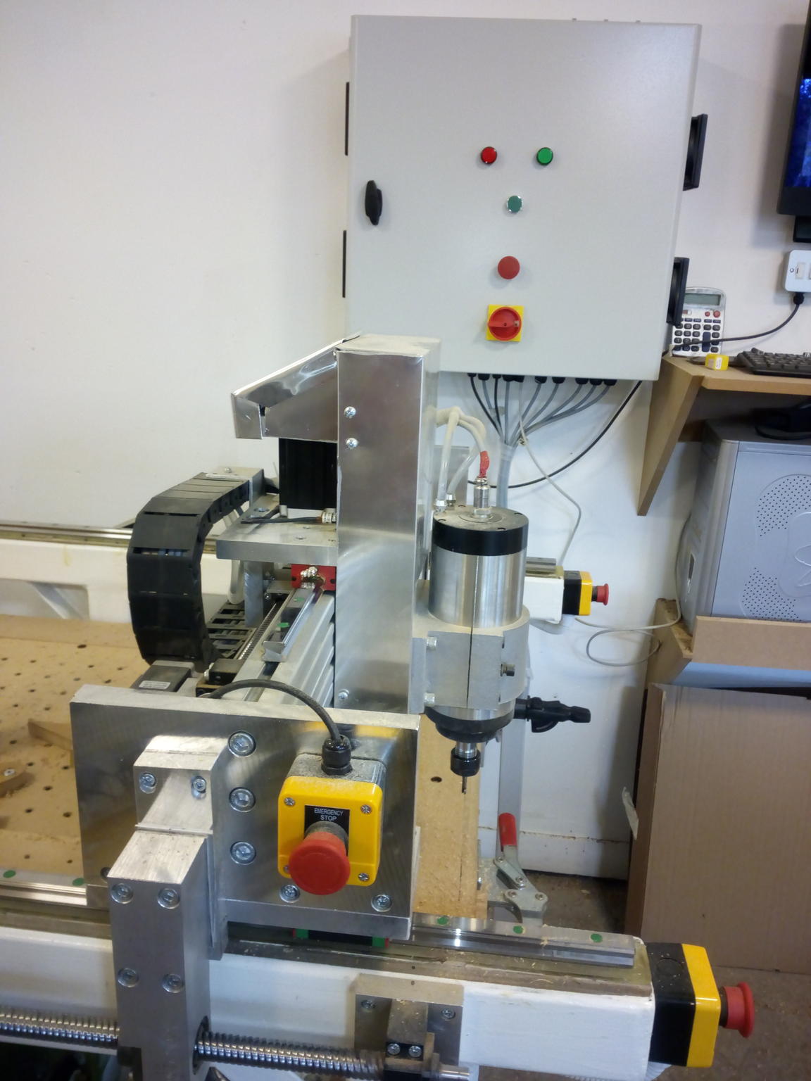

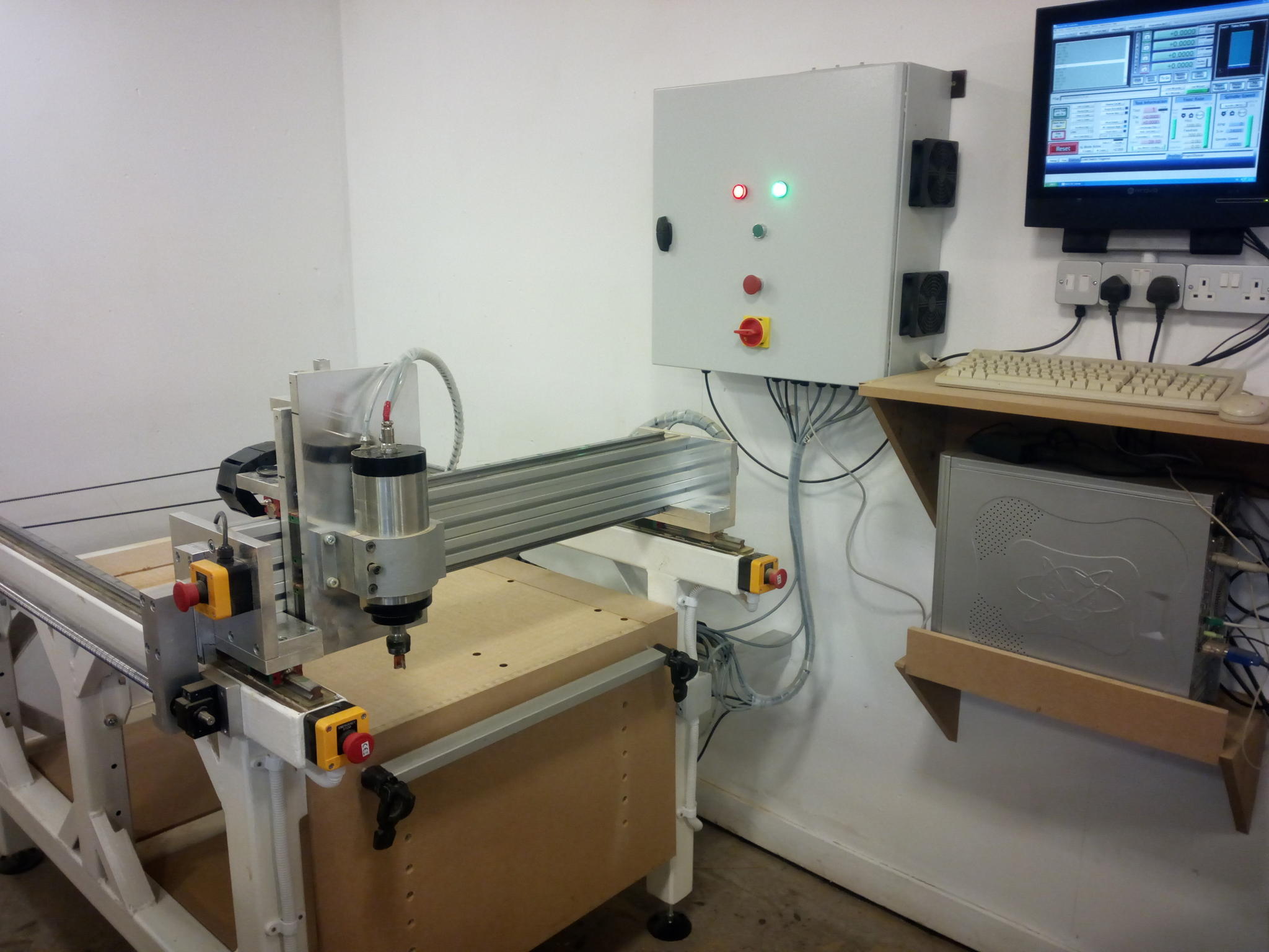

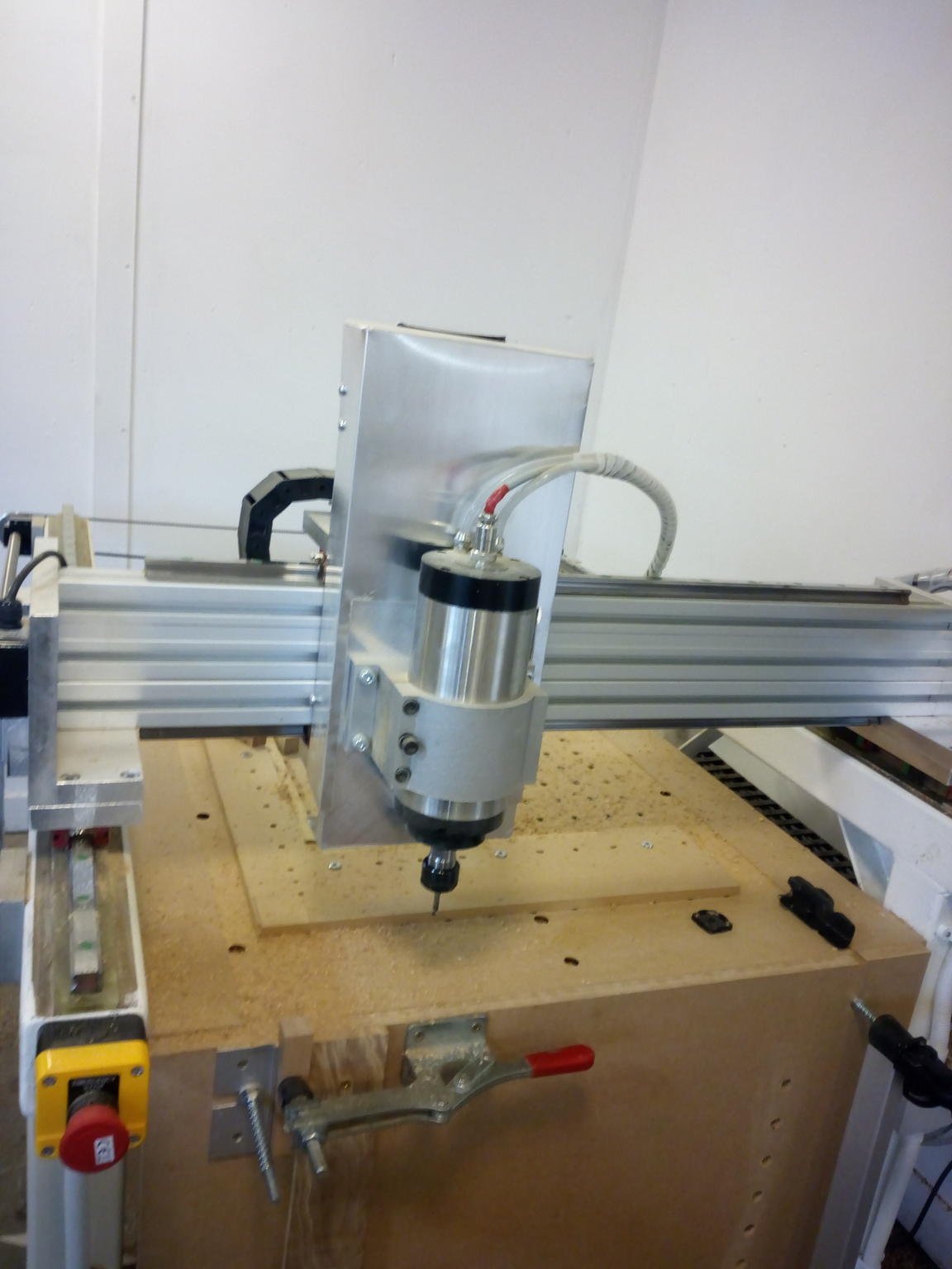

Just drilled and fixed the mdf bed down and surfaced it its a learning curve, you have to move at
fast speeds and feeds to prevent burning (1500mm/min and 24000 rpm)
Guard for the end belt and cover for the Z axis to fitted, plus a dust shoe to be made or purchased.
Extraction system to be fitted and probably a vacuum plate.
Now to get to grips with Mach3 and do some CAD drawings.

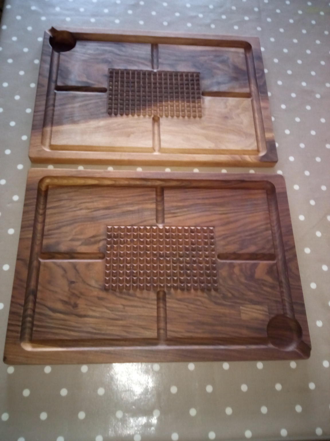

I have a queue of neighbours and friends wanting house signs I'd rather eat worms than do them, but SHMBO will make me.:uncomfortableness:
