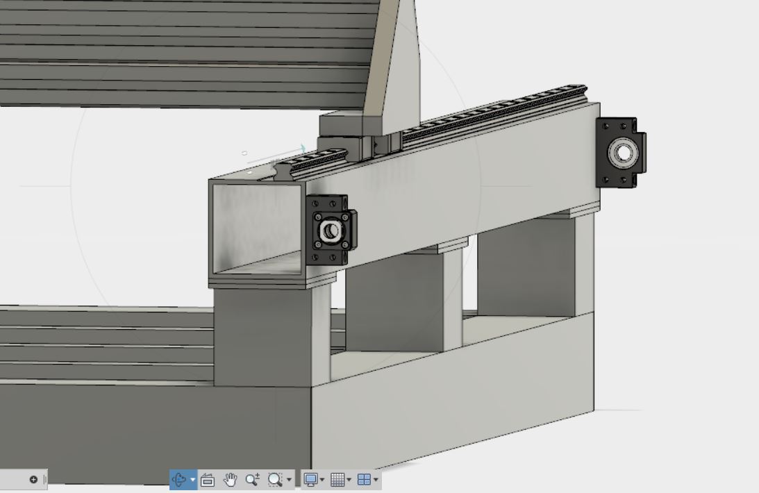

I'm trying to decide how is best to do the stepper mounts to include a belt drive to each of the ball screws.
I was going to have them on the side but that will increase the over all width a fair bit
I was all so wondering if there is a way I could have the motors inside the main tube but not sure its a great idea.
any one have any ideas or suggestions ?

Structurally/mechanically ok but need to get cables to the motors plus best to put holes in the mounting plate and maybe box section as well to allow for cooling.

yes, I was thinking I would probably have the mounting plate welded on the end and then have a hole in the side to post the motor in and allow it to be mounted up, just hoping there will be enough room to get the pullys on doing it like this.
the other think I'm just trying to think about is mounting the ball screw blocks, and having a method to adjust them a little if needed so rather than mounting them direct to the steel have a plate in-between them with some elongated mounting slots?

I don't think it will be a good idea to weld a plate on the end.
How about making a motor mount with the appropriate centre hole and elongated slots made out of ali and make it wrap around the box on the outside left and bottom edge. That way the motor can be fitted to the mount and then slid into the box and bolted through the flanges of the mount into the steel box section.

do you mind explaining why not?
this is what I had in mind, could easily add extra cooling around it and then would print some cover with mesh in to prevent crap going in.

Ok that looks fine if you can wiggle the motor in there I would think you will have to mill out the steel plate so that the motor would be inlet into it because the motor shafts are generally not long enough for the pulley.
Re: Router Build number 2
yes I have that recess drawn in there it should be fine getting it in and then will just tap the holes on the motor
like I mentioned I'm a bit worried about getting the bk blocks all lined up so thinking maybe make some plates up like in the pic just to allow 1.5mm ether way incase the holes are not perfect. but now just thinking maybe I would be better making a bracket from angle ali and using a fk support instead?

If you want to go the route you have drawn then you can make the mounting plate into a tramming plate. Add a cup-point grub screw to each corner which contacts the RHS underneath and allows fine tuning in/out and various angles. When aligned the bolts are tightened down holding the plate in this position. Be aware you are relying on the stiffness of the cup point area contact with the RHS to give the stiffness of the axis as seen by the machine, but if this worries you once it is set up you can remove the plate, cover the underside with machine epoxy and tighten back down. It will set with the alignment position you dialled in using the grub screws.
See here post #23. Grub screws around edge of bracket give alignment, then main bolts tighten against them:

I see the recess from the outside but it is usual to recess from the inside so that the motor sticks out more.
Are you sure the the motor and shaft with the pulley on will stick out enough?

thanks for spotting that i realised i hadn't modified the front for the motor to slide the rear is like this. I have left 5mm thickness. I like the idea of using grubs I was going to do something similar for the gantry but sounds like a good idea to do it all round and then like you say just bed everything with epoxy after that way you don't have to do all that sell leveling resin stuff. :)
I keep hearing dean say adjustment adjustment adjustment which I think is exactly right for diy stuff
all fixed will see if I can find some pullies to put on there but its the same as what I did on my other machine essentially so should be fine.

so thinking this for the screw support instead, at the moment I have the bracket at 15mm alli, not sure if that's ok or if it would need to be bigger, tbh I haven't looked to see what section is even available.Attachment 21779
Personally I would cut that down to 3 mm to get the motor shaft sticking out more.

found some pulllys on line so had a play 5mm is just doable, going down to 4 would be plenty so will do that. even at 5 mm the pullly would go all the way on its just a bit harder to do the grub screw up.

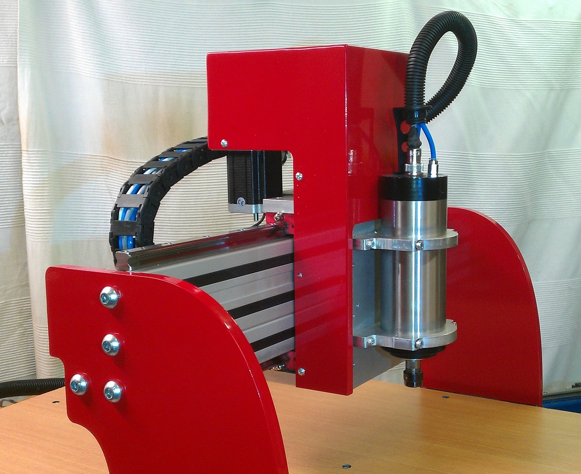

I seam to have stalled a bit on this project as I cant decide a nice way to do the y axis
from what I read the best option is for the rails to be top and bottom of the gantry
However in doing that it doesn't make it all that easy to make the mounts for the carriages adjustable and to get everything perfectly lined up.
what do people do to solve this as it seams most people use this configuration?Attachment 23771

Hi Charlie,
Here are a few that work fine. Bit heavier profile 120x80.

Hi dean
thanks for that
If I can go for that rail setup with one on the top and one on the front it would make life a lot easier!
It was only a first sketch so I can easily bump up the size of the section if needs

Hi Charlieuk,
I have the same thing to think about.
I think i am gonna use set screws in the stationary Z plate pointing at the side of the top and bottom carriages.
So i need a little extra room in the bolt holes in top and bottom mounting plates.
Setscrews will be removed after i am satisfied things are square and torqued down, before moving part of z axis is mounted.
Grtz Bert.

dean could I ask how wide you go for you y/z setup? 200ish?

Yes, 200mm is about right.
Just note that in these pics the rails are on the back plate and bearings on the front plate. This is because these machines required deep material thickness's with long tools so Z axis needed to lift high. They also only going to cut wood or softer materials.
If don't require thick material or long tools then Stronger Z axis can be made by putting rails on front plate and bearings on the back plate.
This pic uses rails on front plate notice that it's highest Z position. Also notice Charlie 90x45 profile in L config.

I wont need this machine to use particularly long tools but 120mm z travel minimum would be nice . Do you think this is doable with this design with the rails on the front plate ?

Yes If remember correctly the machine in pic below is 120mm and that is using short gantry sides. Most I've built allow 150-160mm. That is total travel so got to factor longest tool to get actually Max material thinkness.
Also if using the 120x80 setup you can gain little clearence and extra travel because bottom rail is on front not underside of profile.

If you look close you'll see the Y axis doesn't drop below the gantry so even with raised sides it will pass over the rails.
Not sure what you mean by less rigidity.? This setup doesn't affect rigidity at all. While the gantry is wider the bearings are still located exactly at same place they would be if gantry ended at rails. Only thing it does is make machine wider. This is offset by the fact don't loose any cutting area and no messing around with setup.
