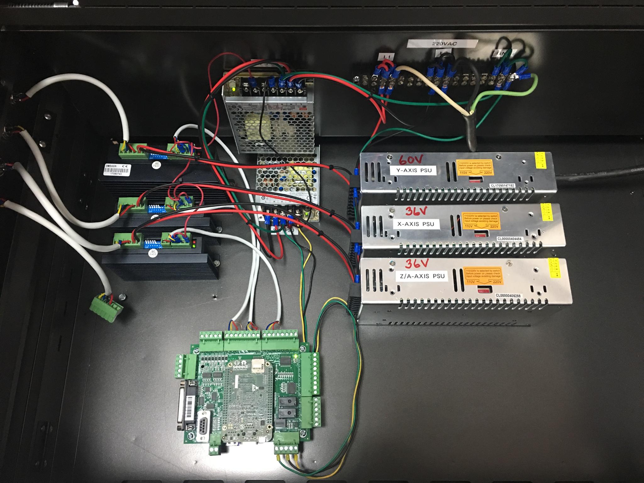

Working on my control cabinet. Not the neatest ever by far, but latest power up did not release any smoke :).
Attachment 24033
Had to bag these 4-pin microphone connectors. Got the female side hooked up OK, but no way in hell these old eyes and fingers are going to get the wires soldered on those tiny little tabs on the male connector side.
Attachment 24034
For now, I'll just hardwire them. What do you guys use to connect steppers to control side?
Got my spindle and VFD from BST (actually came from Huan Yang directly.
Getting there!
Wallace

Re: 1st Build, Steel, Epoxy 24"x24" for Wood
I use those litle 4-way connectors for signal connections (limit switches, etc) - they are fiddly to wire, aren't they?
For stepper connections, I personally use 4-way XLR latching connectors, which are a bit chunkier to handle! Not sure what other people use but XLR are readily available and not too expensive compared to some of the more exotic connector types.
A little more modern to boot. I just took another look at the spindle connector - it is actually a larger version of the 4-pin mike connector. Doesn't look too bad to solder to and seems a bit heftier.
