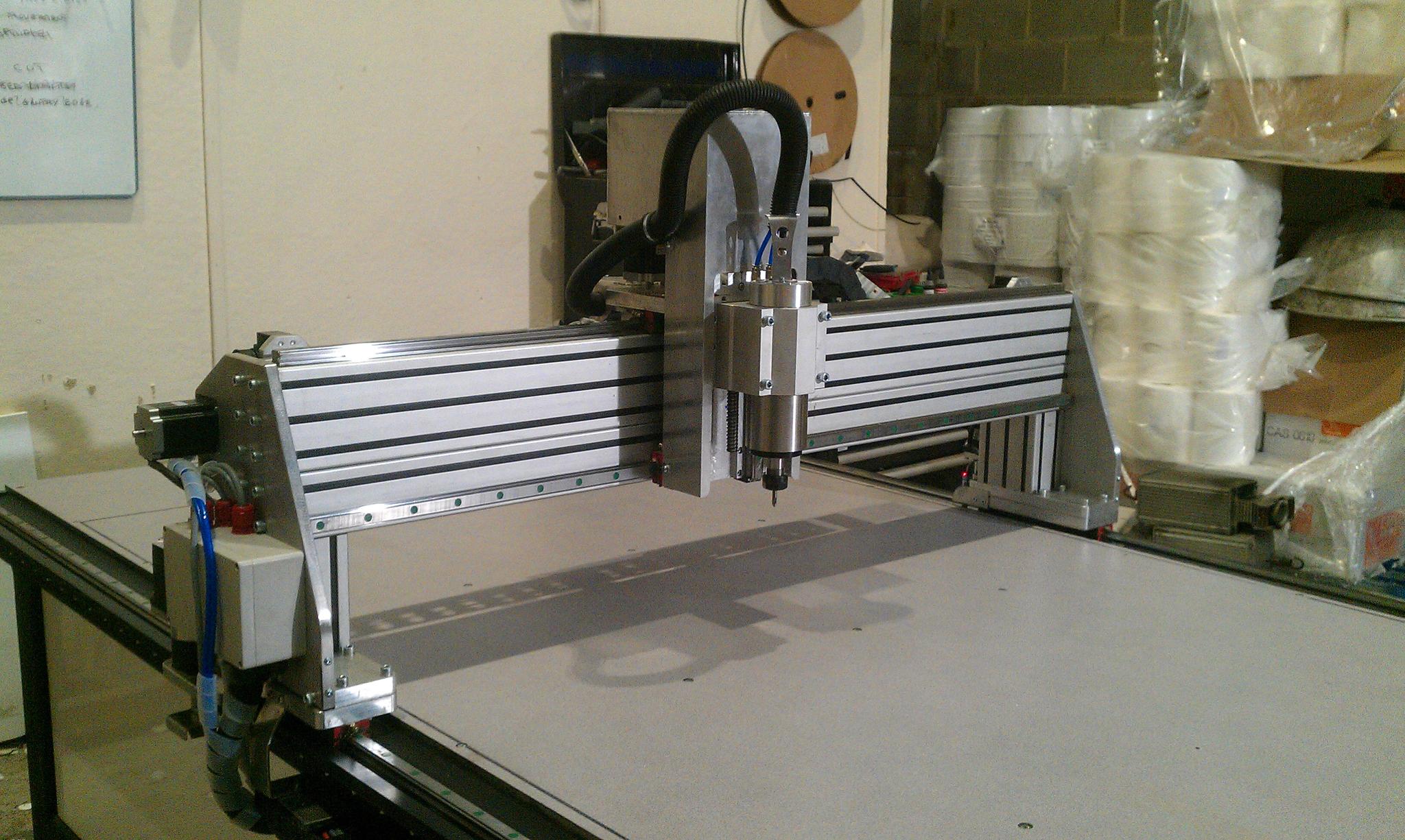

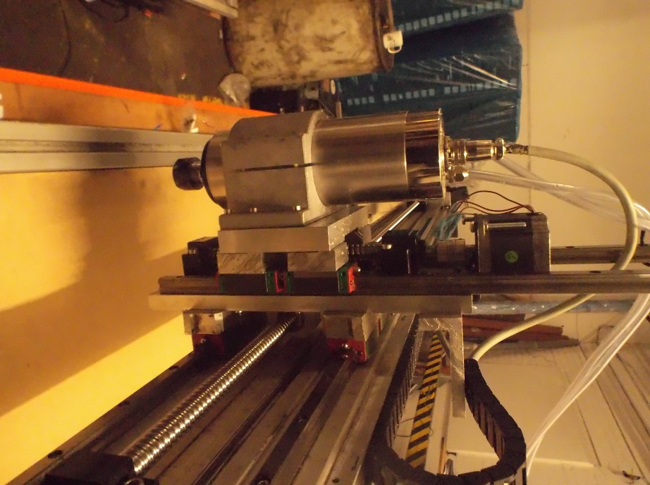

Not read the whole thread but your initial design is incredibly similar to how I just built my router and I can say from experience don't fit the rails on the gantry that way! You lose too much travel.
I lost almost 28cm of Y travel because of how I built the Z axis at some point I will rebuild it so I only lose 15cm but luckily I built it oversized so I still 1.2m*0.7m which is enough to do what I want for now.
Only the Z axis. I found a photo not a great shot I'll get you a better one later but you can see how much travel I lose mounting the Hiwin's forward facing on the gantry.
Attachment 23429
What I'm going to do at some point is remove the centre piece of extrusion on my gantry, strengthen the other 2 pieces up and mount the hiwin on top/bottom of them and sling the ballscrew between the 2 extrusions.

Now I totally understand what you ment about loosing travel ;)
Thanks for the photo. Mine is similar as you said (I will post upgrade soon), but the X ballscrew is on top of the axis.
I plan to use 1605 screw for the Z axis with a 2.2kw spindle. The distance between X rails and spindle will be ~23cm.
I think, with this configuration, it will have more leverage. Is it right?
I will try to put X rails on top and bottom. Thanks for the advice ;)

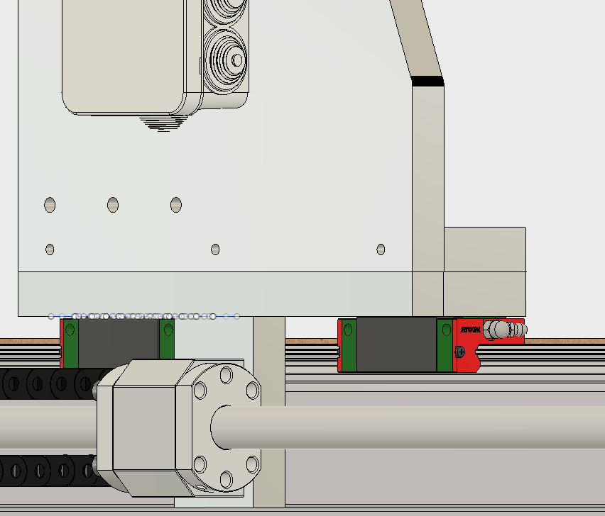

my ballscrew isn't very straight. Could it be a problem when everything's bolted down?
Is it a correct way to adjust the space between ballscrew and plate?
Attachment 23755
Ok well straight away I see Chicken and Egg problem.! How do you access the linear bearing bolts under the gantry.? If fasten the plate to bearings first then how do you bolt profile to the plate.? Also how do access bearing bolts when squaring setting up etc.?
A much better way is to have 2 plates. One that fastens to the linear bearings which also incorporates the X-axis ball nut mounting plate. Then another bolted to the gantry which then bolts into the bearing plate.
This method makes it a lot easier to setup and square the gantry etc. Also can remove the gantry in one piece if ever need to move the machine and not loose setup.

I would like to have your opinion guys. I'm want to be sure to understand this: What's the difference between having high side plate like my first design and the newest one? In my point of view, the sideways movement are less important if you have short side plate. Will it be stiffer? And will vibration be a problem ?
It's late here in UK and I can't be messing around looking back thru 60+ posts to see your design so I'll answer this using my experience of building all types.
Sitting The gantry directly on the bearings using high sides does give much stiffer machine. This leads to less vibration at the tool giving better surface finishes and less tool wear.
However, this is only really needed if cutting mostly harder material like Aluminium/Brass or very hardwoods. If just cutting a general mixture of all materials but mostly woods then gantry with side plates isn't a problem provided the gantry is strong and the plates of suitable thickness and securely braced to bearings.
There are advantages to the machine using gantry sides if mostly used for wood or sheet materials because of easier material loading and access etc.
I have built machines which use both types and in real-world use, both will cut aluminum fine. However, the High side machines can be run little more aggressive in harder materials due to being that little bit stiffer.
You have to decide whats more important to you, higher Stiffness or better accessibility and little easier to build.
