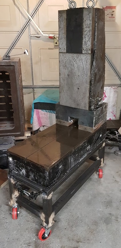

Update:
I'm up to 3m/min rapid speed on X and Y, it will go a lot faster but the stand shakes and rocks. Got index homing, f-error < 0.03mm reliably, still not quite tuned but its working ok. I've got no idea on feeds and speeds, I keep stalling the 24k rpm spindle with larger end mills or gumming up smaller end mills.
Got the counter weight system in place now, went a bit over the top with the chain and mounts:
Attachment 27914Attachment 27913Attachment 27917
Which has meant I've finally got the Z-axis servo installed.
I think the next step is an enclosure, i'm using some Dexter like shower curtains at the moment chips are still going everywhere.
I'll get some designs done and see what you guys think

Congrats. The Z belt looks loose from the pic - is it tight?
The 24K spindles dont have a lot of torque. What KW rating is it?
When you say 'larger' endmills - what size and what RPM are you running them at? You should run pretty much everything at 24K RPM. Below 12K RPM these spindle will stall, drilling becomes a challenge, so interpolation is the best option. Smaller End mills being gummed up is too little lubrication if doing Alu - a bit of WD40 and you should be sorted. On my 'old' 4KW Chinese VFD Id run it at 24K RPM all the time, just adjust the feed rate based on cutter diameter (up to 12mm) which is pretty much max unless you go for some interesting facemill / MT adaptor which Id be concerned about using on these type of spindles.
You can do a bit of tweaking in the VFDs but not a lot if you use the standard HY one. You can get better ones - but then you might want to consider a 380V spindle and use something like the Ecogogo VFD that does Vector and upconverts the voltage.
