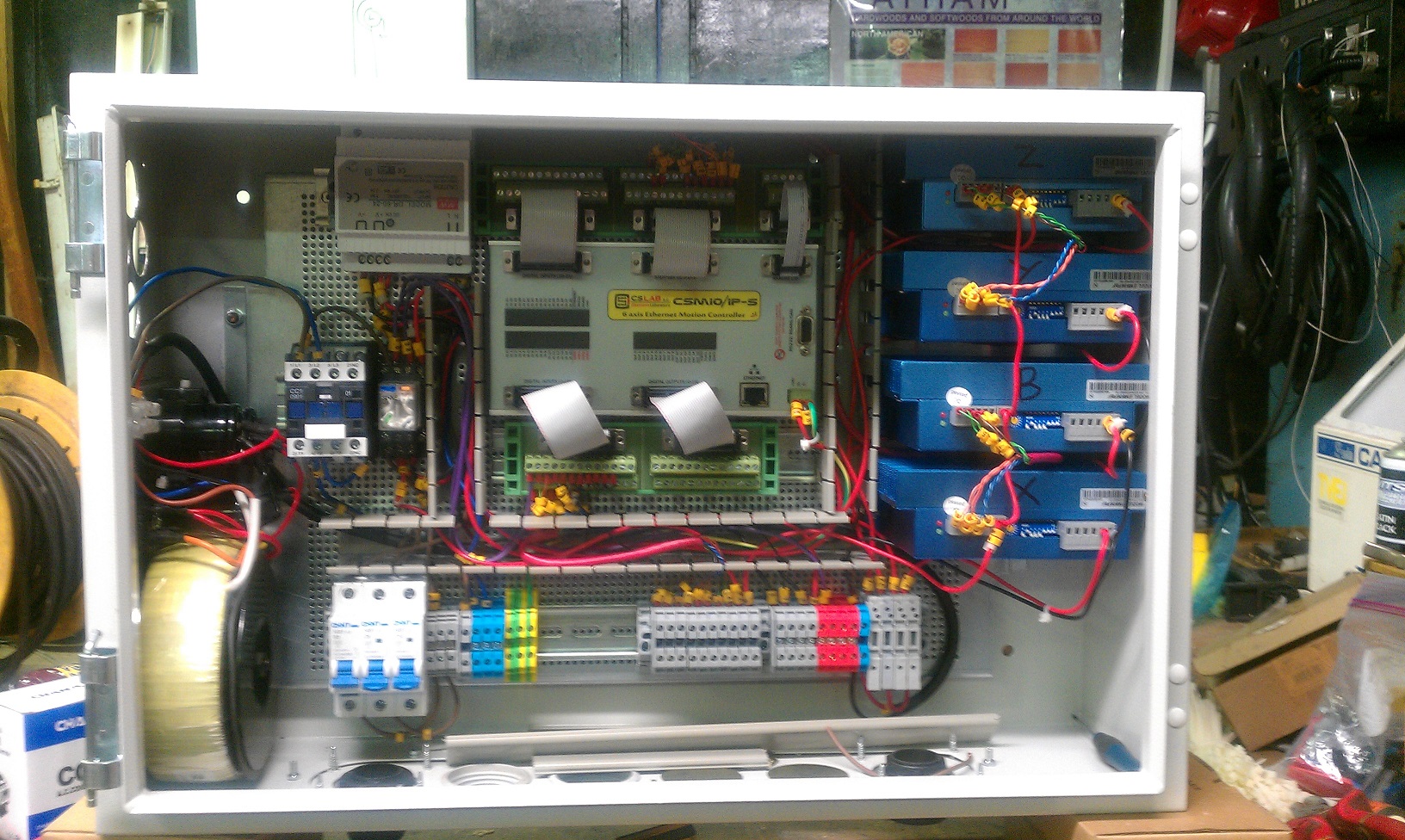

Looks like good progress.

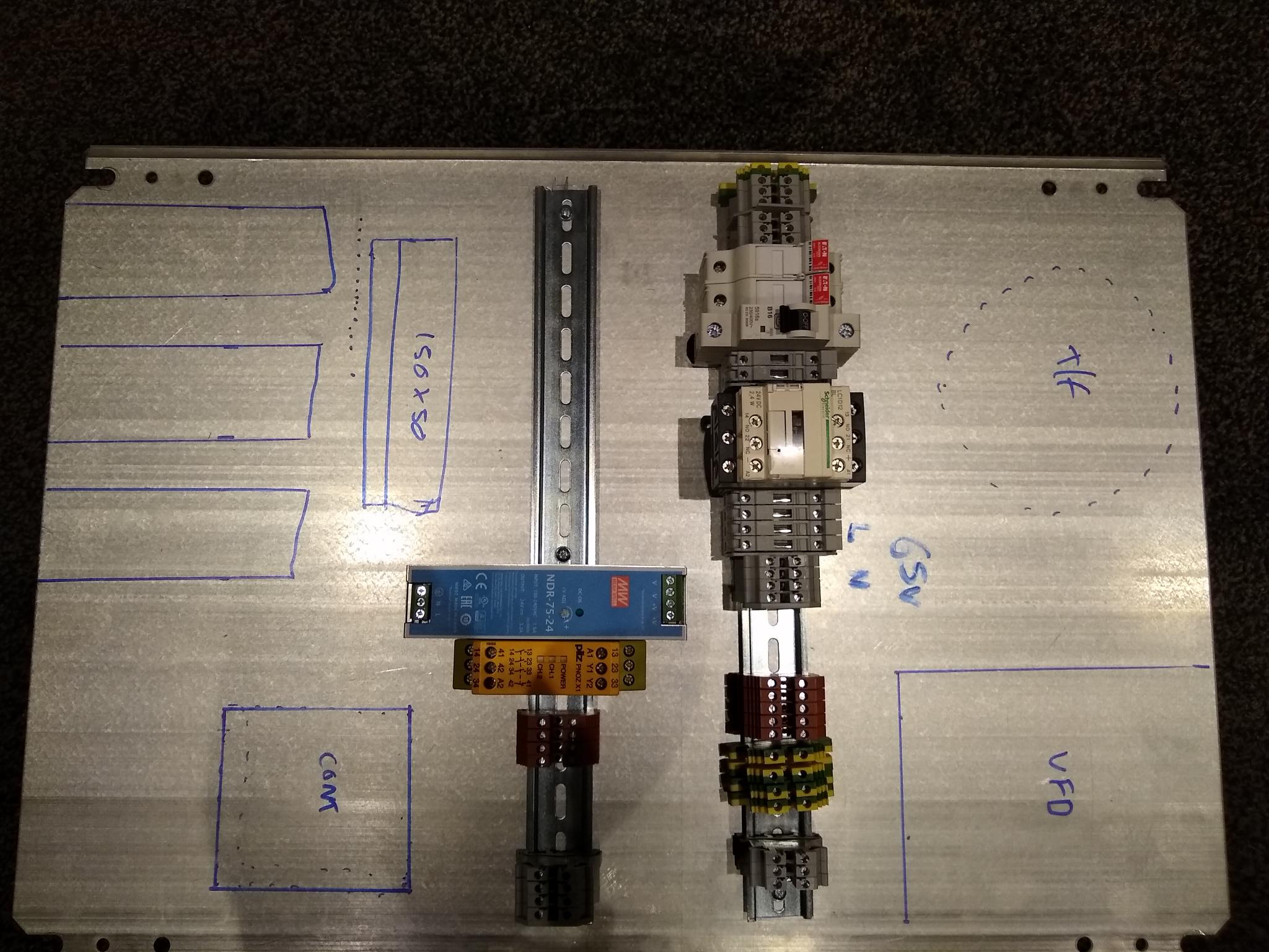

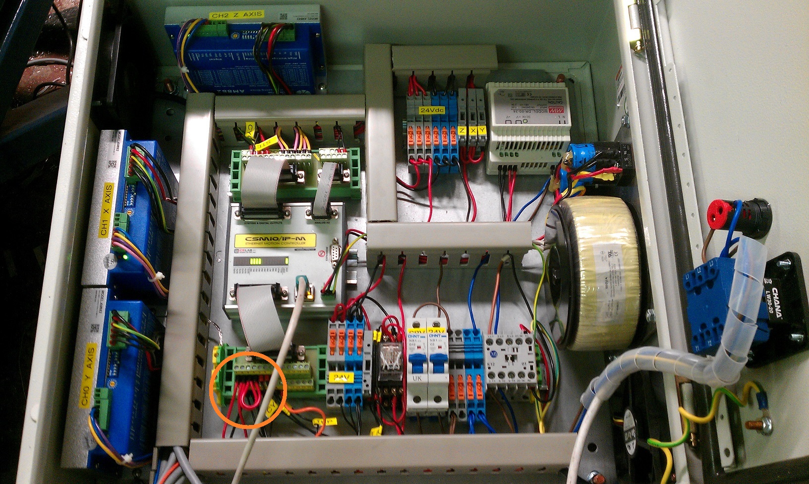

As Jazz mentioned you now need to consider trunking and cable runs, at the moment any vertical runs are awkward.
I'd also consider putting the contactor in the high voltage section.

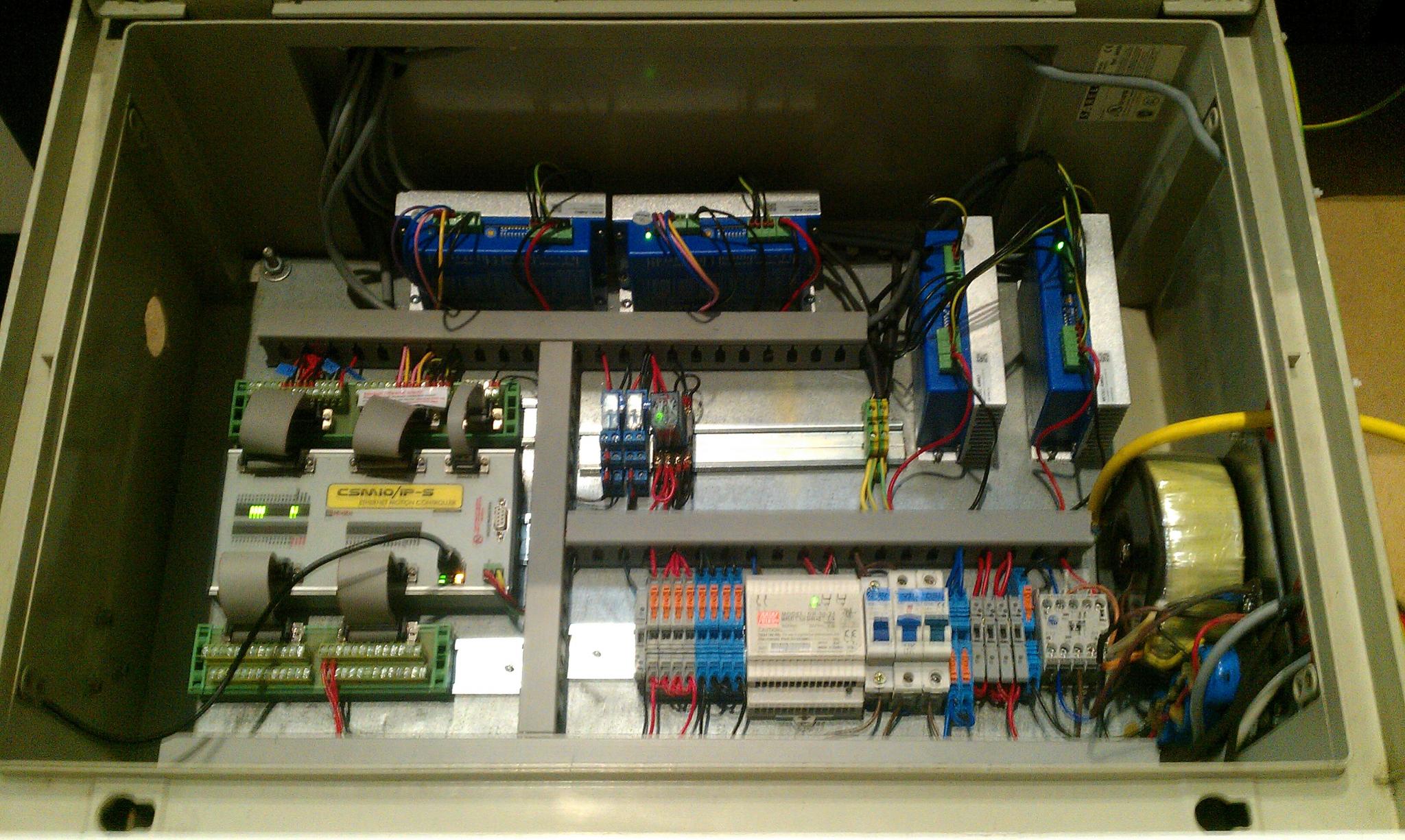

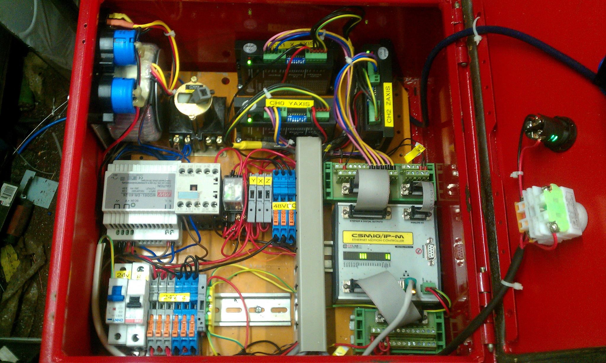

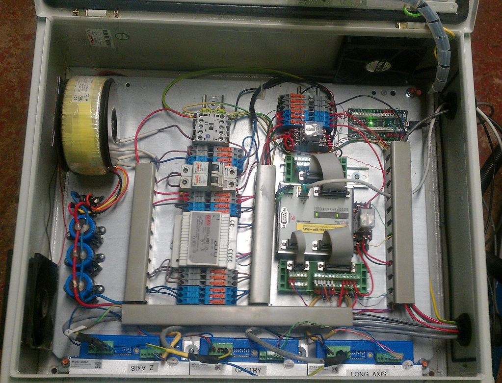

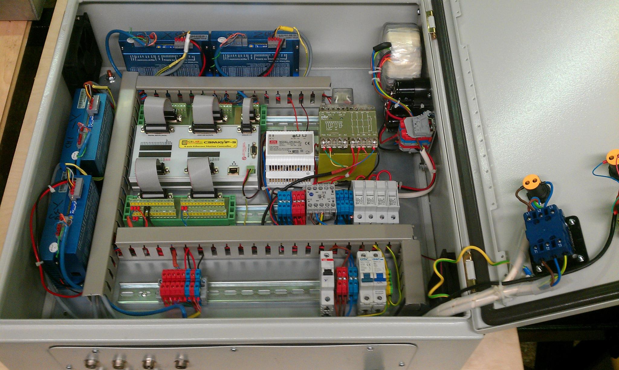

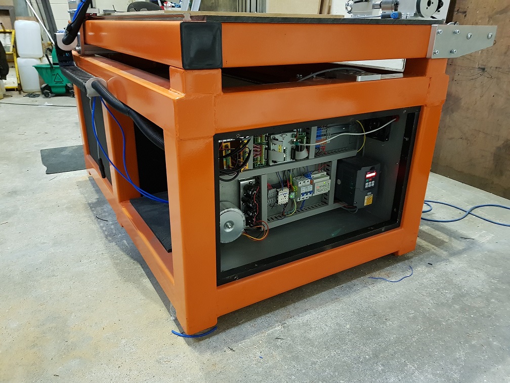

Here's a couple of pics of boxes which might help give some ideas, These range from tiny 300x300(red) to 800x600 boxes.
There's no one way which is better than any other so don't stress over it, just be mindful of high and low voltage wire separation along with grounding and you won't have any issues.
Attachment 27564 Attachment 27561 Attachment 27560
Attachment 27562 Attachment 27563
Attachment 27565 Attachment 27566
Thanks, Some useful ideas there Jazz, with everyone staying close to home at the moment, I had some time to get the E-stop working along with fixing DIN rails and mapping out where things will go:)

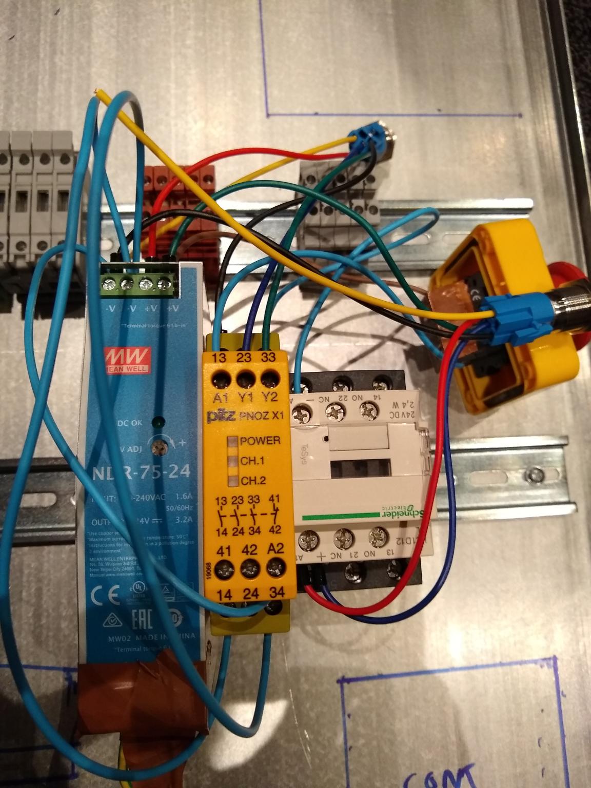

After attempting to drill the first 16mm hole in the cabinet with a normal bit I realised what step drills are for and did the rest.. great tool.
Attachment 27632
Attachment 27633

Edit - Fuse question. The Transformer will be 750VA - 2 x 65V output. I ordered 10A D curve MCB seen on others diagrams, but I'm thinking 750VA/230V is approx 3A so 10A is very high. Or am I missing something (most likely)

I believe that D curve MCB is sized to cope with the inrush current. A 1KVA transformer will only need approx 4A in steady state on UK mains (varies with min input voltage and efficiency) but the inrush can be something like 100A for a very short amount of time (dimming lights anyone?).

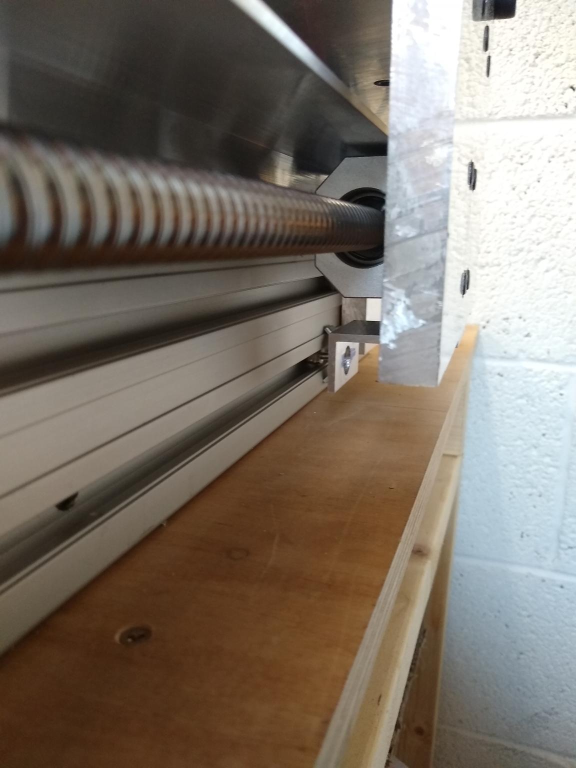

My linear motion parts are finally here! Happy with the service from Fred at BST - all parts received and in good order. Took a fair few extra weeks but with the worldwide situation at the moment not at all surprising!
Attachment 27672

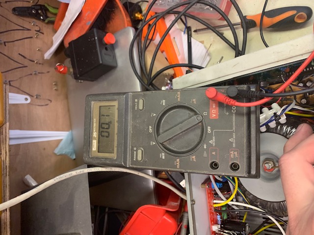

So I was about to mount my 750VA Toroidal transformer to the cabinet back board with the supplied fixing bolt, metal plate and large rubber washers
e.g this kit > https://airlinktransformers.com/imag...photo1_CM5.JPG
Plan was to drill and tap the metal back plate and secure the bolt into it.
Then I read this - https://diy.stackexchange.com/questi...-metal-chassis
From what I understand the bolt itself plus the top mount plate and chassis can form a C shape around the winding and induct a current. People mention fires and things blowing up which I'd like to avoid!
So now I'm thinking to mount to a phenolic (insulating) sheet so the mounting bolt does not touch the cabinet back plate directly. The transformer also has an earth wire.
Any issues with this, or better suggestion people use?
The power of the internet! One of the key attributes of toroidal transformers is a very low flux "leakage" which will limit any potential induced current. I understand the argument but would challenge the actual risk - if I had a toroidal going spare I'd set up an experiment (it's interesting, and this is the first that I've heard of it, and the evidence from the internet looks to be more anecdotal than academic). Actually, because of this thread I've ordered a toroidal just for this experiment - I'll report back in a few days. My thoughts are any current is likely to be measurable but insignificant. The risk can be mitigated in any event by isolating (air gap) the top of the bolt from the chassis to avoid the short.
Edit: What Clive said. The more I read the more interesting this experiment might be.
Wow!, just... Wow! I take back everything.
Following the previous post I'd realised I have a bench PSU with a chunky toroidal transformer that I'd previously hacked to pieces. Sounds like a good experimental platform. Ignore all the crap on the bench - I really need to tidy up.
Pic 1: General topology, next-to-nowt resistance (0.1R) from the top of the mounting bolt to the chassis.
Attachment 27703
Pic 2: Open circuit Vacrms reading from the top-bolt to chassis - about half a volt. A lot more than I'd expected and enough to ignore the fancy stuff with a shunt resistor and 'scope, and go straight for the "blow-the-hell-out-of-the-meter" probe...
Attachment 27704
Pic 3: Current short, top bolt through meter and 3 metres of meter leads to ground. Some 3.1A.
Attachment 27705
So, yeah, isolate that top bolt!
I'm going to throw a spanner in the works here and point out that I've built dozens of machines that use the bolt thru chassis method with rubber pads and I've never had any issues with shorts, fires or getting zapped with stray volts/current etc.
Like Clives mentions it's a Big No No earthing to the bolt but other than that then you won't have any issues provided the transformer sits on the rubber pads.
So just get on with it and don't worry is what I'm saying. If you want to put a rubber washer on the bolt then why not for what it costs but I wouldn't mess around with Phenolic boards etc.
Thanks for all the replies - I wasn't expecting a full on experiment Doddy :) Good to have some real results though as everything I found was purely theory, no-one tried it until now!
So in summary if the bolt is used along with the chassis to form a "loop/partial loop" around the core then there is some serious potential for amps to flow, but its low risk if the bottom of the bolt only contacts the chassis, as Jazz mentions this is commonly done with no apparent issues.
I happened to have a piece of phenolic offcut so ended up using that on some spacers, plus the bolt itself has a rubber washer between the head and the metal transformer plate. Probably overkill - and I'm sure I'll do something else instead !

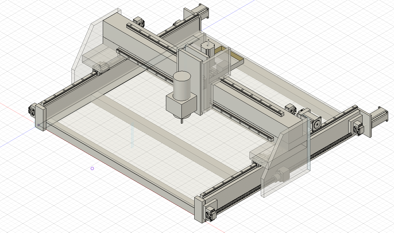

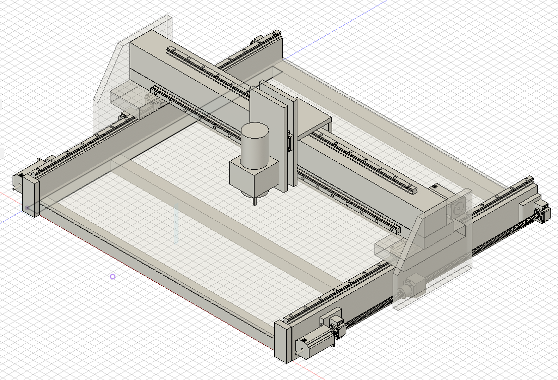

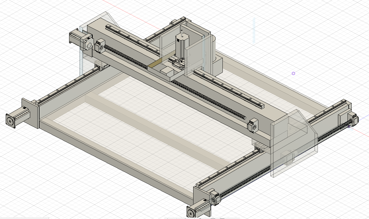

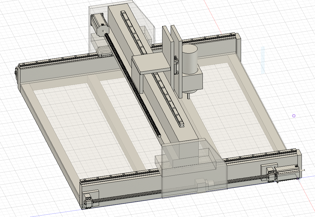

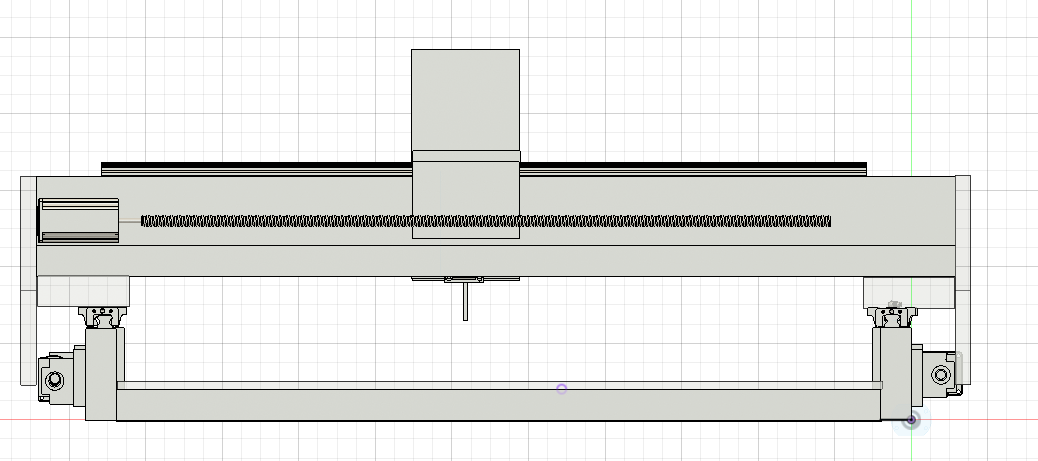

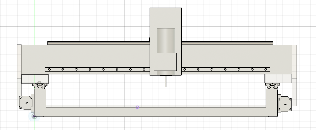

Made some progress over the long weekend - if only I had a CNC machine this would be so much easier:)
Reading some of the new threads I've been re-thinking and slightly concerned that the accuracy I'm building too could result in inaccurate final results.
As this is all "by hand" and printing 1:1 scaling, drill holes are perhaps up to 1mm out, I'm using a digital caliper and angle measuring device during the build, but check as much as possible
There is some slight adjustment by the hole sizing on everything - how much can the software make up for sub mm "corrections"
Maybe overthinking it - but also don't want to end up with something not accurate after all the effort.
As I haven't owned a CNC machine before I don't know what accuracy I'd like, but for example if I could produce something like the Aztec calendar I'd be happy..

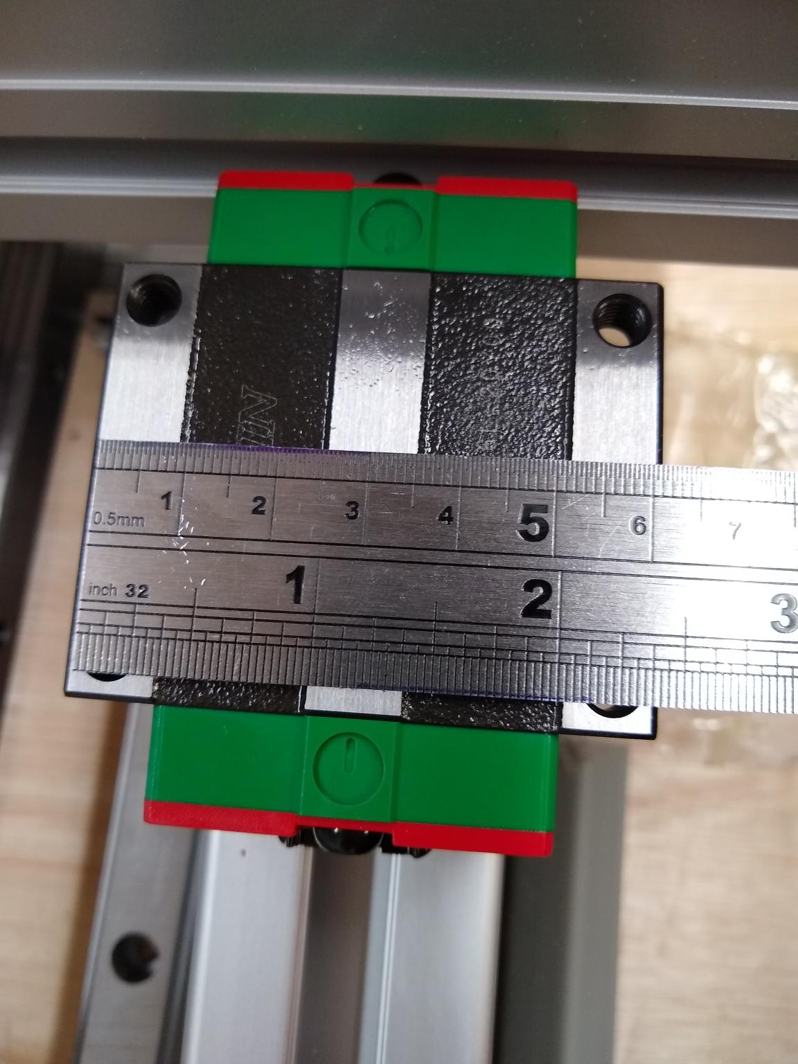

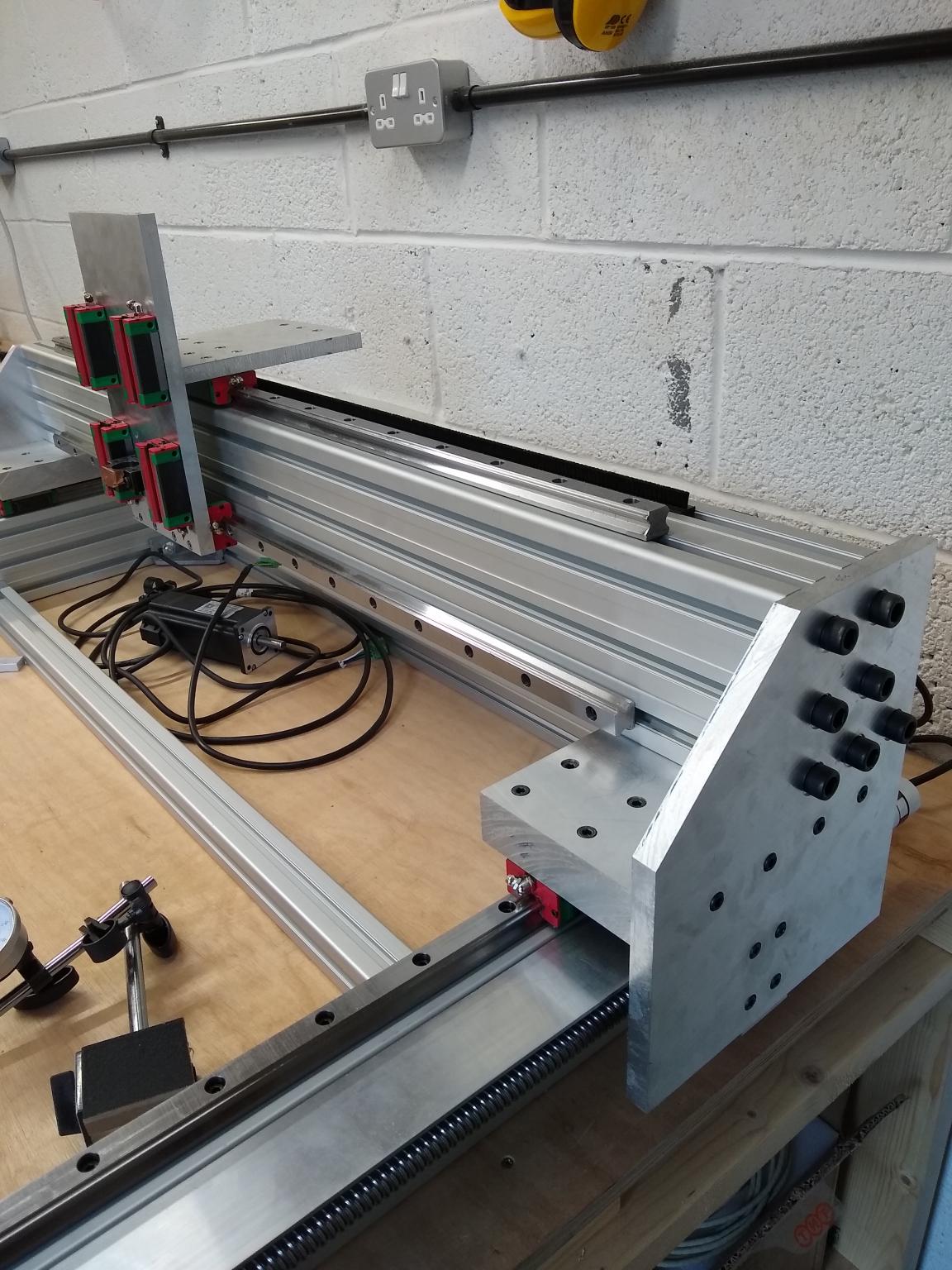

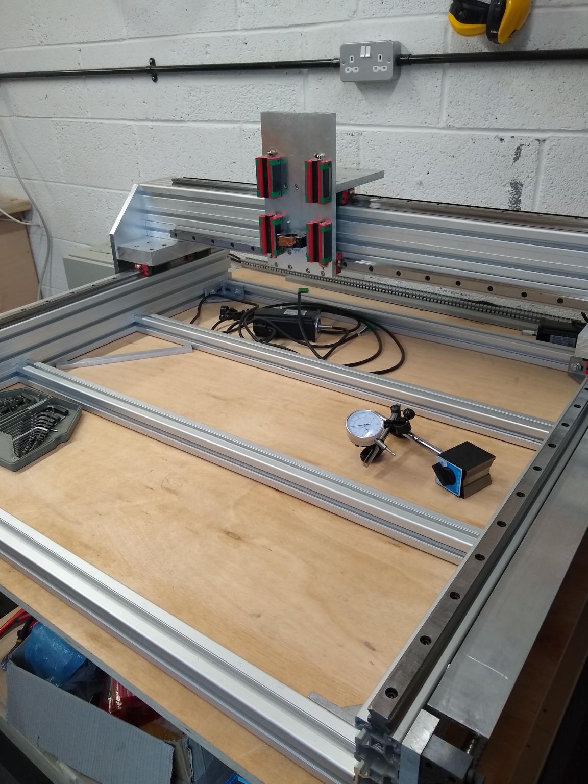

Some photos of current build.
Attachment 27802
Attachment 27803
Attachment 27804

First off, looks like some great progress in the photos, well done!
Regards the by hand - quite a few of us have used this method to good results. Yes, sometimes you cock it up, but just be slow and methodical double checking measurements.
No idea of your experience so lets ensure we hit all bases; make sure to centre punch well (optical if possible - the press type I also like), and let the drill bit align to that punch mark (if you clamp too tightly aligned slightly off, the bit won't happily sit in the punch crater). Use the drill press as much as possible (but check its square to the plate in both directions). If you're not using printouts, use marking dye. Set your digital calipers to the value from a reference surface, lock them off, then use them to scribe the line. When using a steel rule, never use the end for final marking (its a bit variable), always align to markings on both sides (e.g. to measure 10cm I'd align the 1cm mark and the 11cm.) - Now check using the end on the first mark!
If you come to fit components together and the holes are a bit out, you can always identify troublesome ones and widen only those. An M5 clearance hole already gives you 0.5mm of wiggle room, a 6mm hole isn't going to be the end of the world. Worst case is you have to make it again (oh no!) or remake it using the CNC later.
Regards accuracy - mostly to do with how you align the linear rails and screws. Use a dial gauge and get everything running smoothly and true to a reference surface. In your case this is mostly on ali extrusion or cast ali plate, so the height of the rail shouldn't be a massive issue - shim slightly if required, and you'll have plenty of left-right wiggle on the extrusion T slot. Your main problem will be aligning the two sides of the long axis so the rails sit at the same height. You won't go too far wrong if things move smoothly. Avoid software corrections as much as possible - the main one is the steps-per-unit, which shouldn't be too far from the calculated value (if it is very different, somethings probably lose).

Yeah, was referring to the drive without alpha postfix - the stock LCDA86 - that has a much lower (and DC only) operating voltage. Take your point on the 'H' version.
Don't stress over it and it's perfectly possible to build an accurate machine that will easily cut the Aztec calendar by using hand tools, most of the builds on this forum are built solely using hand tools or a large percentage.
Accuracy comes from the setting up and alignment etc. Remember Adjustment, Adjustment Adjustment so slightly oversize holes can help here.

Gantry Sides done - need to counterbore the M12 bolts slightly but waiting on a 13mm drillbit for clearance hole..
Attachment 27880

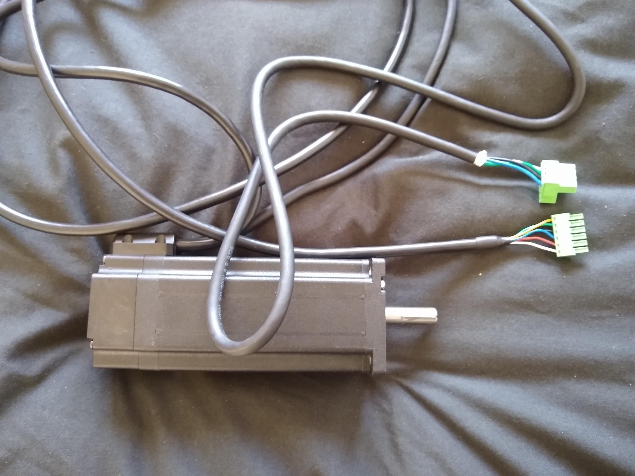

The good news - I now have 4 closed loop steppers and drivers - The bad news is that means more questions:)
So the motors come with pre terminated wires - oddly a 2M motor and 3m encoder one. To extend the motor one I assume I just use CY cable ? The existing cable does not seem to be shielded.
But with most people using CY cable right from motor to cabinet, should I be cutting shorter and using a longer run of CY - or does the closed loop negate the need for shielding?
Same with the trial prox sensor I have, it's pre cabled with non shielded wire, so do people cut short and join?
Also before I ask the manufacturer - does it matter on the polarity the AC connections to the driver are - there are no marking or instructions on Phase / Neutral, assuming it won't matter ?
Ryan
I tend to cut the motor wires short and use shielded cable, but I have used them with the supplied cable and not had any problems. If it was me and you don't have any CY cable then I'd use it as is. You can always change it later if gives you trouble.
The encoder cable is usually shielded so it won't give you any trouble.
Cut these short as possible and use shielded cable.
Doesn't matter it's AC alternating current so it bounces both ways so no polarity.

Some more progress on the physical build - ballscrew covers are on and work as planned! and most of gantry done. Next is to tackle the motor mounts. Plan is to use the long 35mm shaft length to go through the mount without having to hand route out a pocket as others have.
I also managed to connect 4 steppers and get them moving via UCCNC with nothing going pop, so know electronics for movement in place.
Attachment 28066
Attachment 28067
Attachment 28068
Reading Jazz's post elsewhere I realise I may have been confusing the X and Y axis all this time.oops. So stranding directly in front of the machine, I was calling left to right movement across the gantry Y and front to back X. So I have configured the dual ballscrew axis as X in UCCNC,
Reconfigure is just in software so OK, but can someone confirm I have been wrong, and X should be right to left (as per graph axis) and Y is dual axis. Probably good to know for a CNC machine:)
I'm also worried about the stand/table, When you put a decent force in the middle of the ply it flexes perhaps a couple of mm.
Initially I just needed somewhere to build it and didn't put lots of thought into the stand, thinking the machine frame will maintain it's structure. It's a wooden bench with ply top, I can do a fair amount to strengthen it up but - is this going to be a major sticking point? I see plenty of "desktop" type commercial machines out there which I assume people just stick on a workbench etc?
Really don't want to start having to get a frame welded if I can help it ! Ideas?
Axis labelling can be however you want.
The convention is:
Standing in front of machine (as you will actually be using it)
Left to right is X
Front to back is Y
Up and down is Z
So yes like a graph.
CAD and CAM software is based on / defaults to this convention, so easiest to follow it.
Some people get funny and insist that across the gantry must be Y. Or the longest axis must be X. They are wrong. It's about how you draw the design / do the CAM.
Like Pippin say's there is no wrong or right so long as the Controller and Cam match up. Otherwise it gets very confusing when watching the controller Vs machine movement. However the part will still cut correctly provided it doesn't hit the limits which often happens when people mix Axis and Cam up.
But to Answer your question then yes you did have it wrong way around to what is conventional, that being following the Cartesian coordinate system of X=Lft/Rht Y=For/Aft Z=Up/down
Looking good by the way, soon be making chips. then the trouble really starts...Lol
Great progress, hope you will let us follow you to completion. Having read a lot of build logs here, it is so disappointing when a promising build tails off so you never learn if the design and approach had any merit! There are 5 builders with finished machines in the Gallery Post from 15 pagesx20 DIY build logs, so that is less than 2% that actually complete their machine and stick around long enough to share. It gives me pause, but you are giving me hope!
Not to criticise, but to show I am listening to the grey beards here, and want to copy much you have done:
I understand the frequent suggestion of having the gantry (X) separate and adjustable from the Y linear bearings for squaring up etc. You clearly still have access to your Y linear bearing screws, so adjustment is still available. However would turning the thick Y linear bearing plate into two, with the lower fixed to the bearings and the upper fixed to the gantry and then bolt and pin them when XY aligned make things more modular and adjustable?
That's just because people don't bother to post in the gallery thread. Whilst sure, there is an attrition rate, the success rate is a LOT higher than 2% in the build logs. I suggest you look at the last page in each one, you'll get a much better idea where they're up to.
I'm going to answer this Andrew because many won't realize the difference and why it's important, well maybe I should say easier rather than more important.! Ryan might not even realize this yet because it's the first machine he's built.
The Biggest difference is that the 2 plate method doesn't affect the ball screw alignment to adjust the gantry square. However with the single-plate method when you adjust the gantry by loosening the bearing plate you apply a twisting motion on the ball-Nut because the ball-nut mount is attached to the gantry sides which also rotate with the gantry. This puts a bind on the ball-screw so it causes excess wear and lowers the speed.
This then means you have to make adjustments in some other area to bring the ball-screws perpendicular to the gantry sides and parallel to the rails. In a nutshell it's a right pain in the arse.!! . . . The twin plates take all this away.
