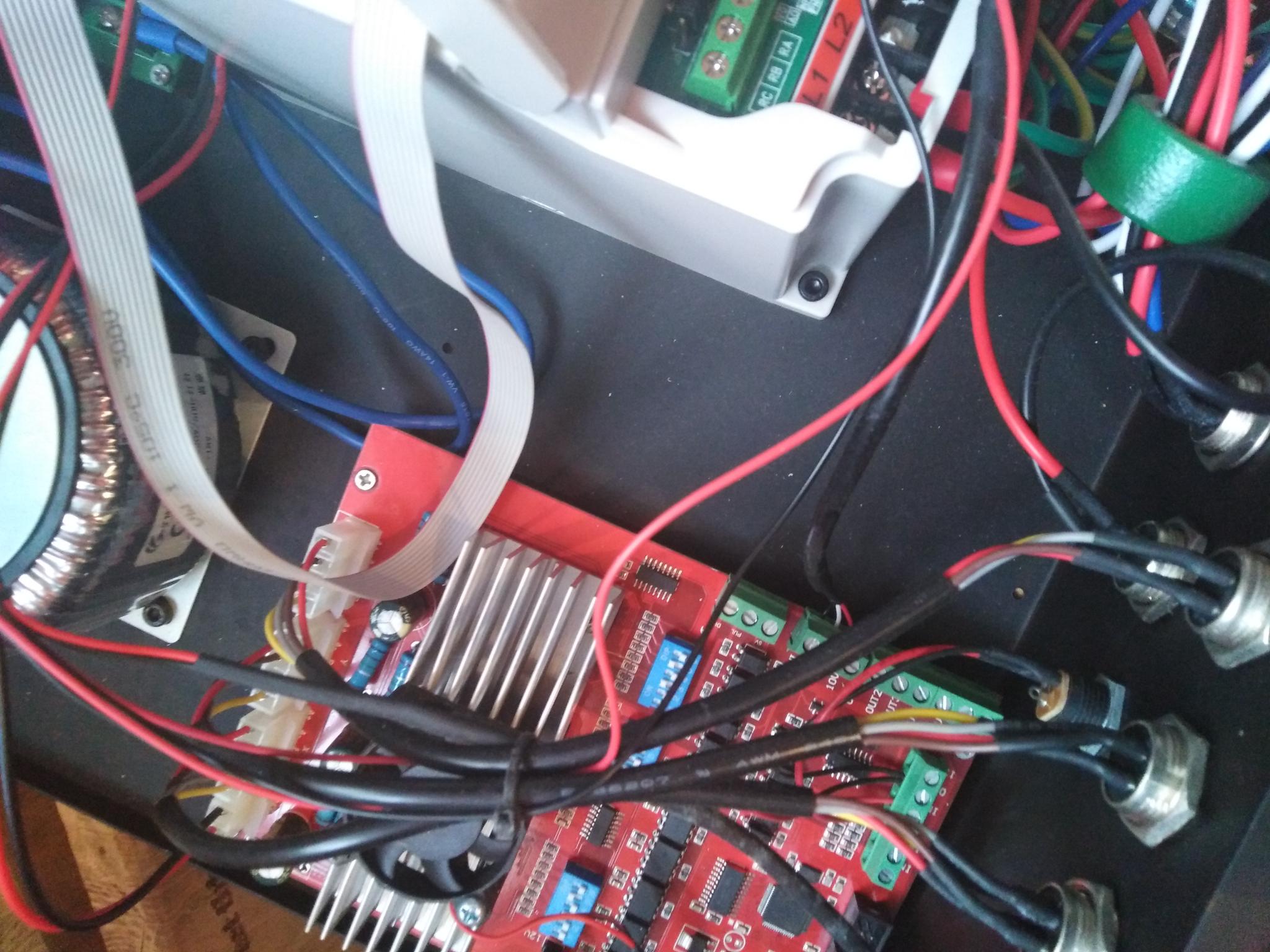

I blew my multi meter a few weeks ago and am confident using one , but i also remember when i removed the cover of the black box VFD to take photos to post i un plugged it from the mains supply but there was a red neon light flashing on the BOB even though there was no power lead connected and even after 30 minutes it was still flashing so i am now asking myself in the name of safety should i just write to the company and say replace the box as there is an issue of a thousand pounds exchanging hands. your thoughts would be appreciated on this
I think if that avenue is open, that would be an eminently sensible thing to do.

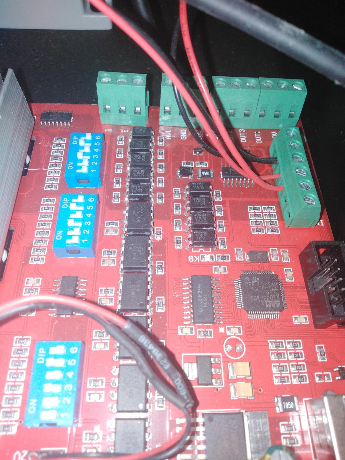

The red flashing neon (LED?) could be the BoB powering from the USB interface - if still connected to the computer. If so, I wouldn't worry too much and wouldn't pollute the conversation with the supplier with that bit of info.

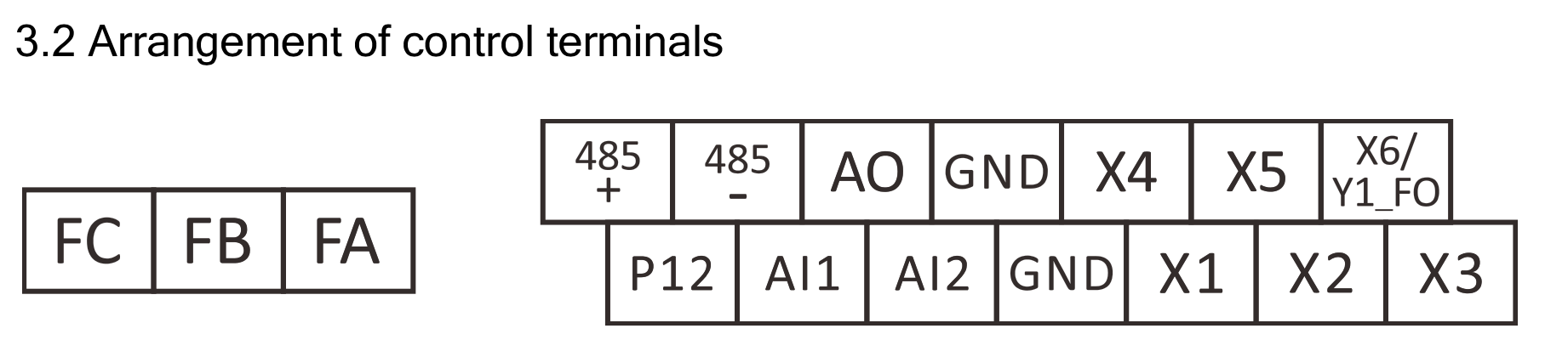

that's a "Nowforever A100 series" VFD just had a quick look but the one sight that mentions they had it was down. I have the D100 series. hope this helps (PS was still looking but apparently rare)
Attachment 28824Attachment 28825

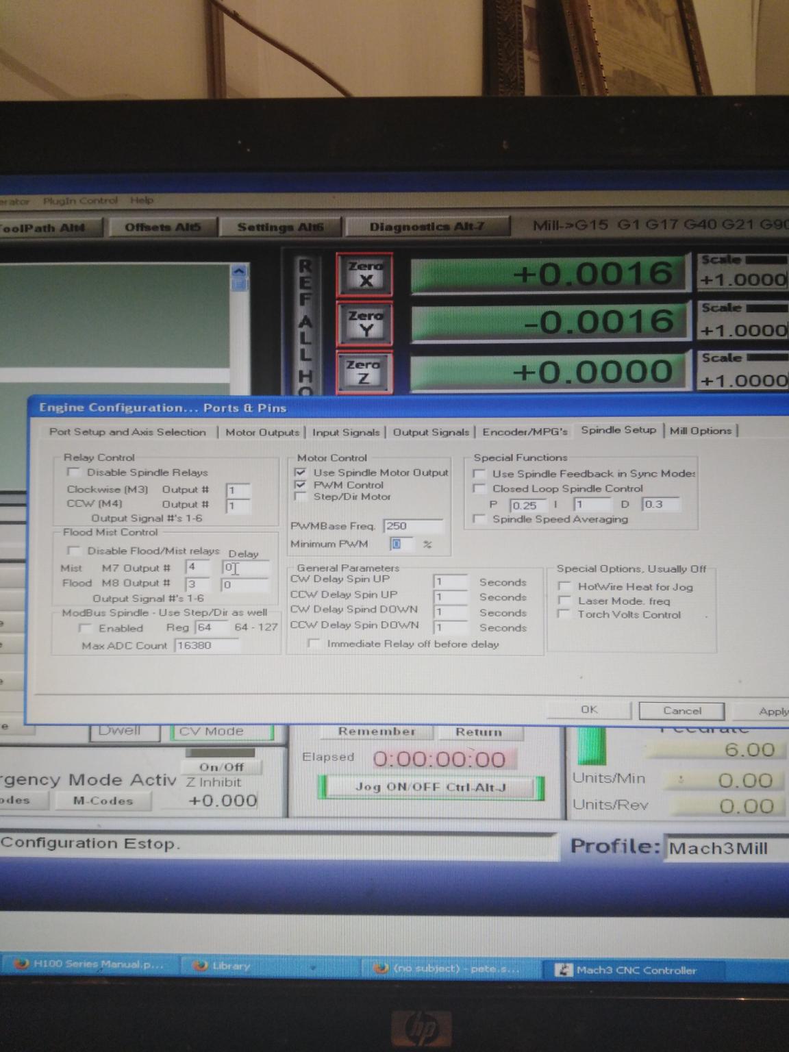

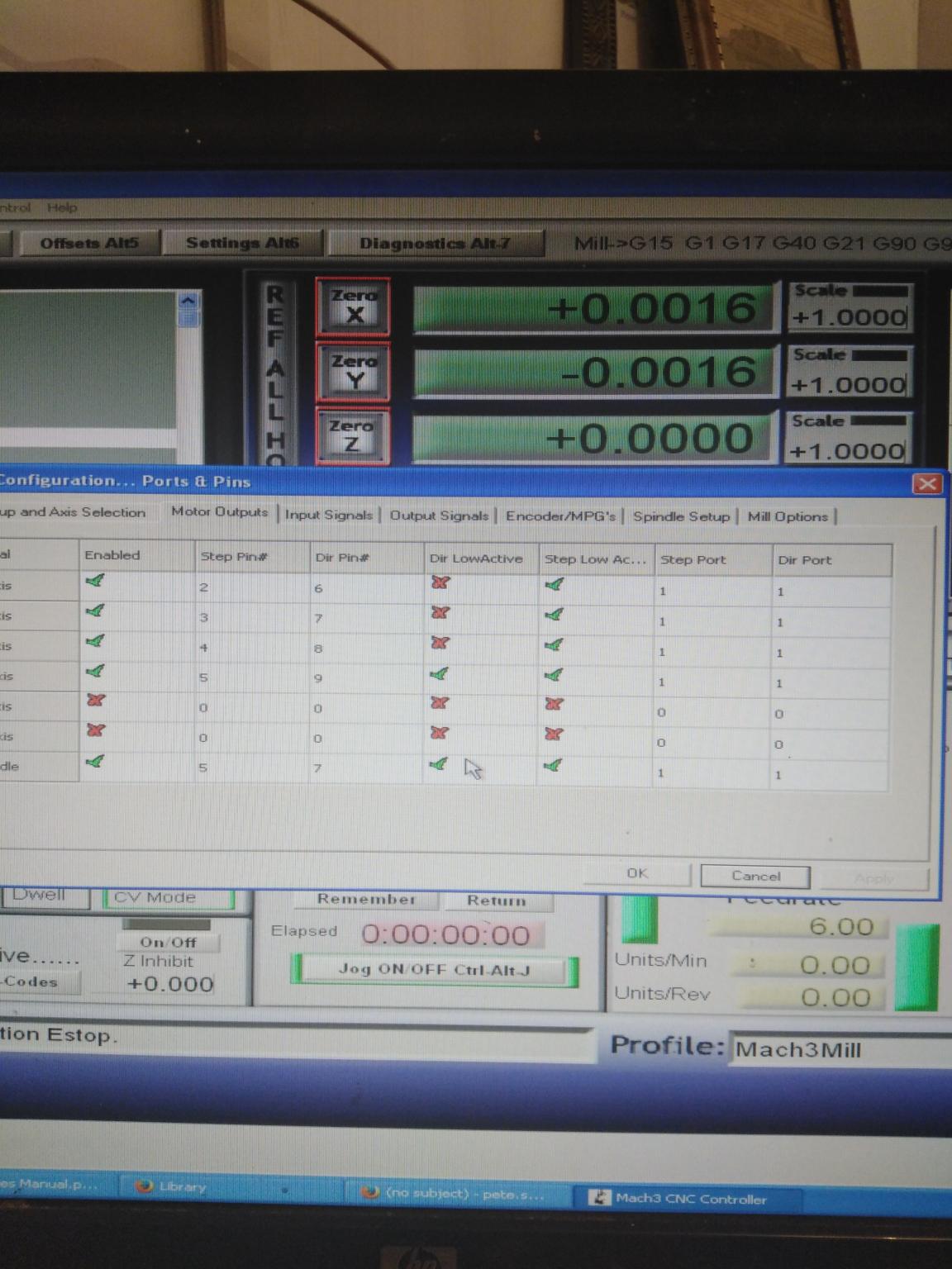

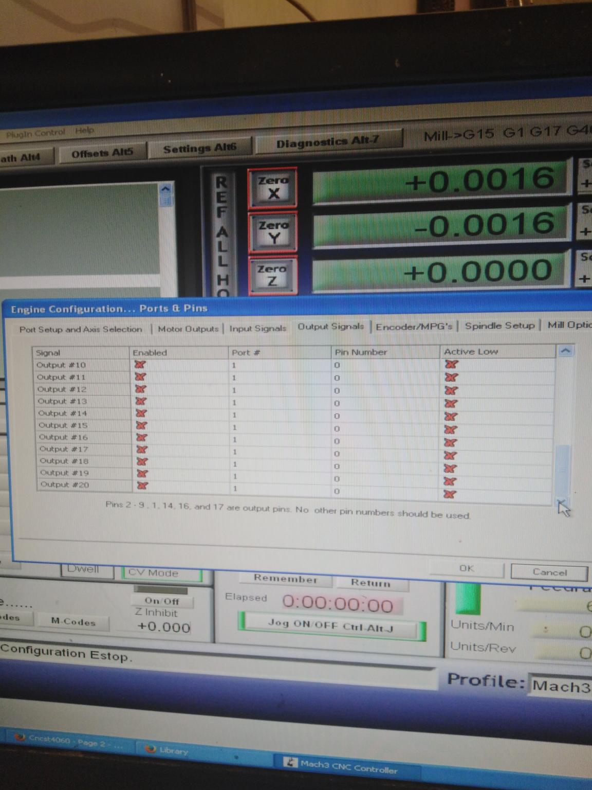

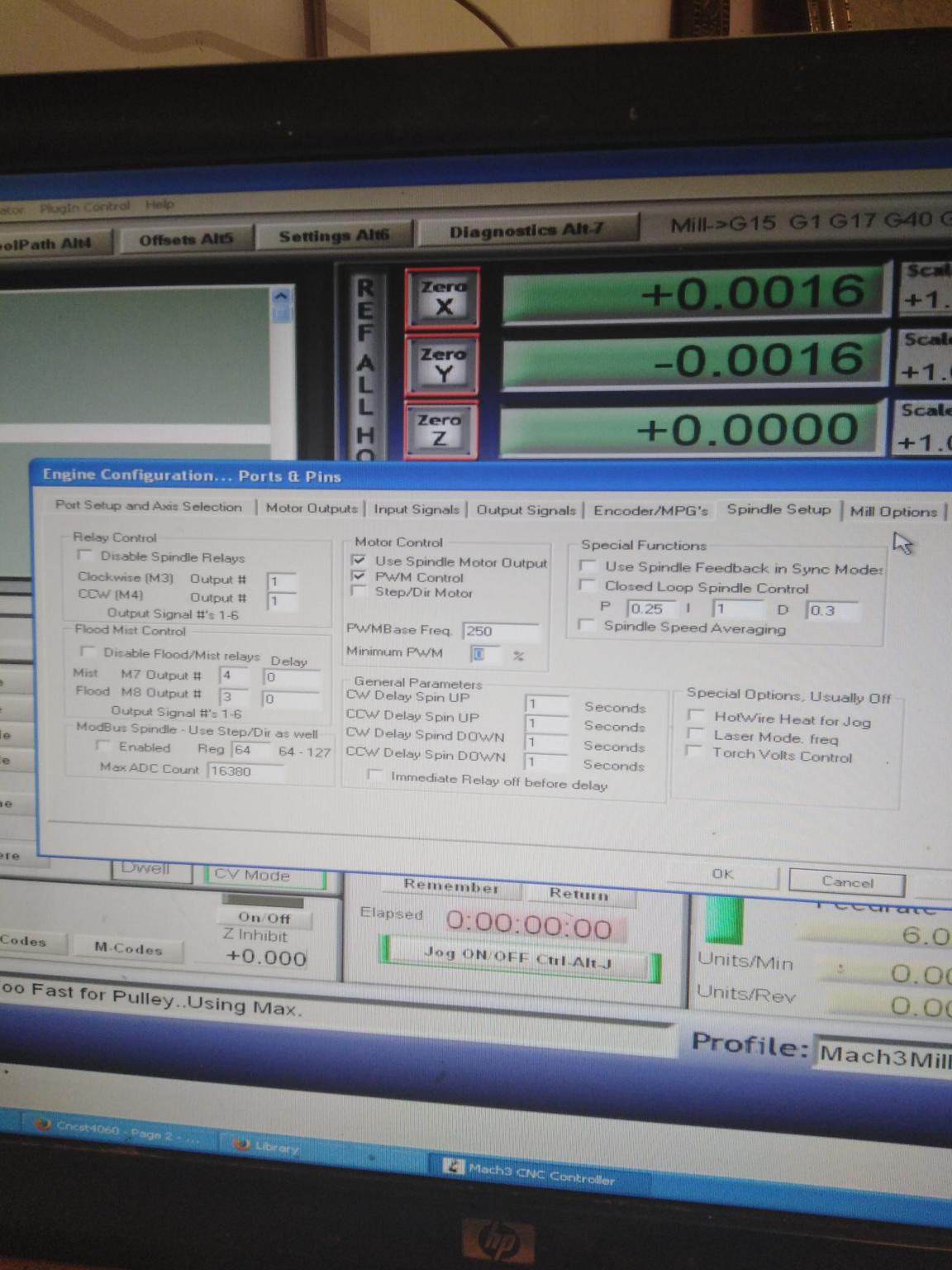

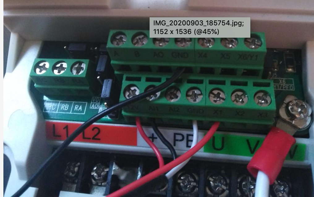

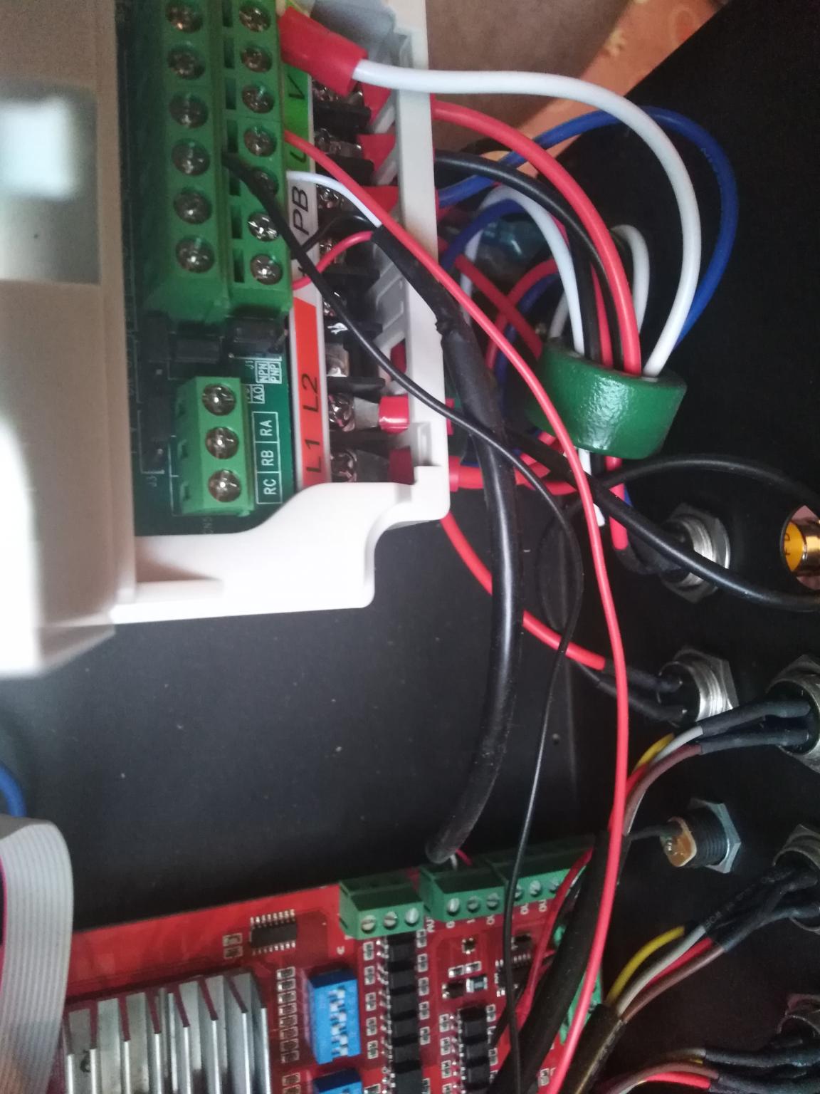

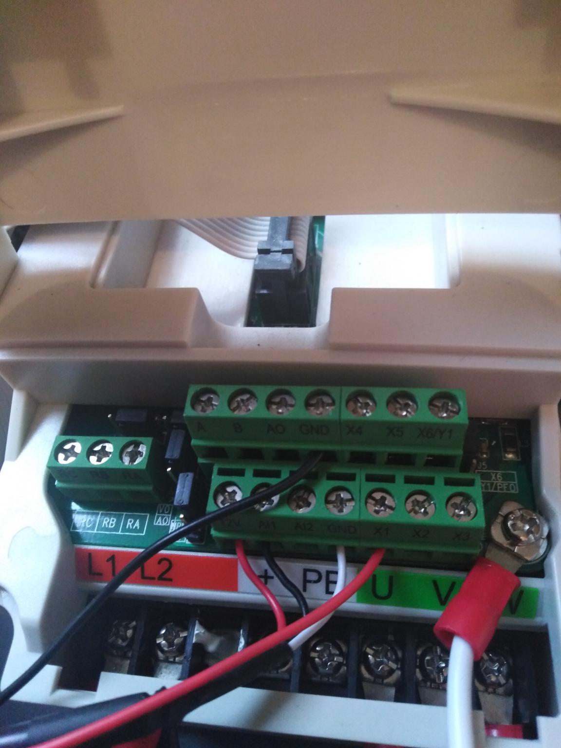

Here is a few photos of the VFD that i purchased today , I bought this one as i didn't want to go and spend a load of money on a real good one yet as i would like to see if this set up works first and if it is viable .
The wire for the spindle was marked from 1 to 4 to start with so i soldered Wire 1 to pin 1 . Wire 2 to pin 2 and so on ( this was on the socket for the spindle.
And using my tester on the connectivity setting i tested each wire and connected them as follows
I connected the No 1 wire to the V
No 2 wire to the W
No 3 wire to the U
Then i pressed run and turned up the speed and at H 16 an error message came up.
any ideas please
Attachment 28849Attachment 28850
Forgot these
...okay...
I'll take a look tomorrow night. Hopefully you're getting no shocks off this - but without configuring the VFD I'm not surprised that you've got errors. Try having a look at the manual (a link would be useful if available online - VFDs are all different). Try not running it until we have the VFD configured,.
Did you set the VFD parameters to match your spindle ie: Voltage, current, freq, etc. If not this could be your problem as the defaults may not match your spindle.
I don't know this VFD and don't have a manual to see the fault codes but the usual suspects for fault codes on startup or slowdown is too fast Acceleration or deacceleration settings.
If you have them set to accelerate too quickly and you call for a high RPM then the VFD try's to get to speed in the set time by dumping high amounts of current into the spindle and this trips a Fault because it pushes higher than the set parameter. Likewise if you haven't setup the VFD parameters and it's on the default which is often set low the same will happen.
Also the poles the poles 2 or 4, Just a thought. Need the manual

...So the H016 is some indication of speed (Hz?) - what was the error code?
Also... did the spindle start to spin?, or at least grumble a bit?
...and have you seen this post...
http://www.mycncuk.com/threads/12842...eters-Settings
...I've not reviewed it in detail - but superficially it looks good.
