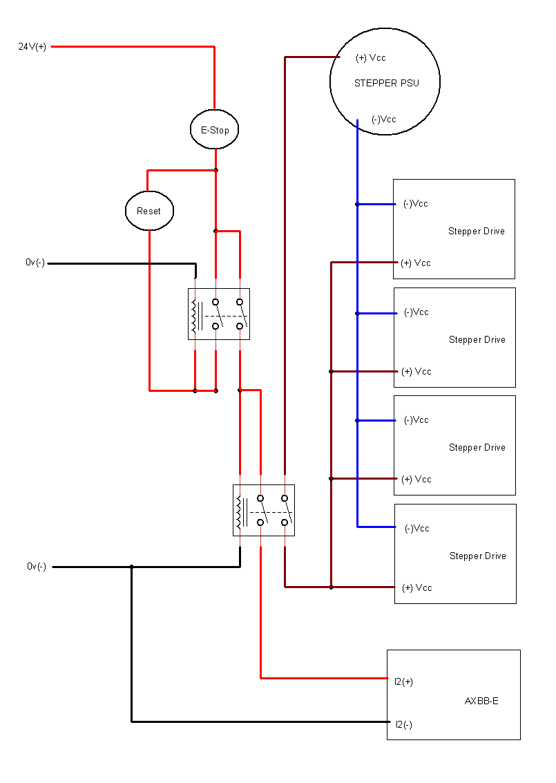

On a separate note to be safe you should really have a latching safety circuit built into the E-stop that turns off power to the drives when pressed and won't be allowed to reset until all is safe. The easy way to do this is with a Relay and Momentary button wired in series with the E-stop. If you want to do this just say and I will draw you a circuit showing how.
If you don't have a latching system the moment you turn on power the drives will become active so if say for instance the E-stop was released and UCCNC was running code when turned on the machine will instantly start moving with no clue where it is and will crash.
With a latching system this can't happen also a signal will be sent to the controller saying an E-stop is in place and won't allow UCCNC to Reset.

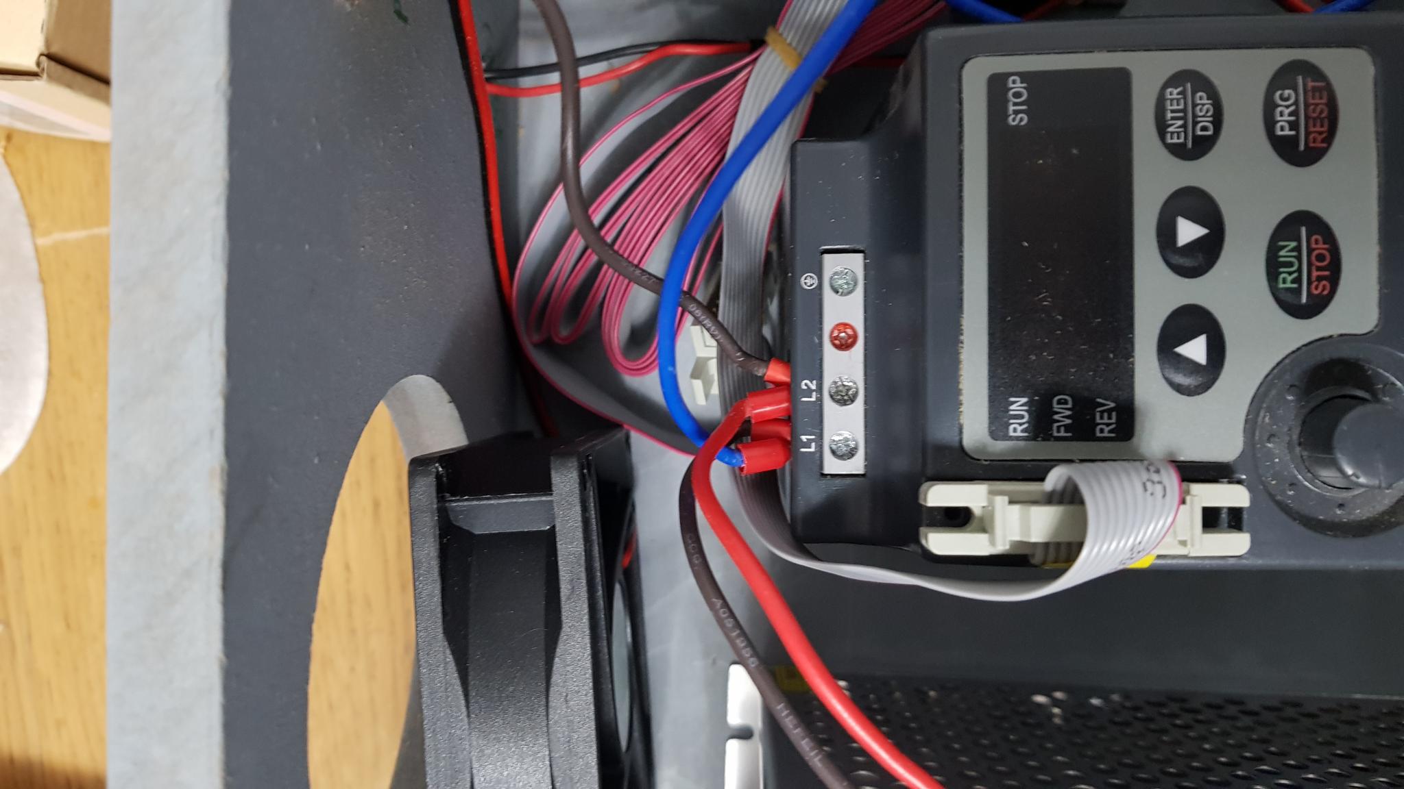

			  Wires coming from L1 AND L2 from the back of VFD where do I locate these.
 L1 and L2 are usually the Mains Inputs but without seeing and knowing more about the VFD it's difficult to know or advise safely. Give better pictures

 Cheers, a latching system would be good if you could do me a diagram , as for the VFD the wires are coming from L1 and L2 and i cant remember what they were attached to, yes i want to join the power inputs so they operate from one cable. What about fans i have 2 were do i connect these.Attachment 30886  Attachment 30887  The cables from the VFD went to in1 and ov on the old board.
 Attached pic. colours might not match yours but should show you how it's done.
Edit: Note that you need a contactor rated to suit the PSU which turns on the drives. Don't use a Relay if you are switching DC to the drives.
 They are the Mains Input so put Live to L1 Neutral to L2.

		still confused by were to put VFD wires coming from L1 and L2 also on off switch not got a clue how to wire this, if it wasn't for this forum and youtube i would have blown up by now.
cheers.Attachment 30895    Attachment 30896   Attachment 30897   Attachment 30898  Attachment 30899
		Re: step and dir pulse problem Mach3

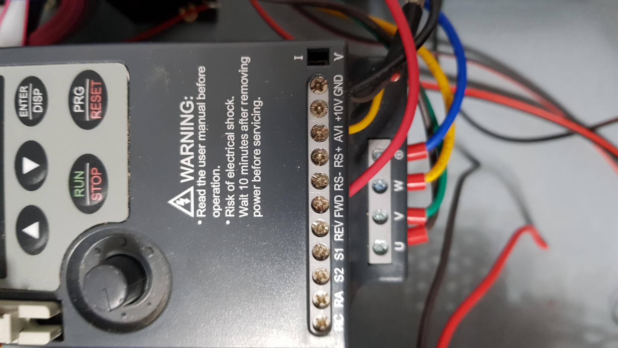

		Had a look at the diagram in the vfd manual.
S1, S2, FWD, REV all simply loop in parallel into the ground connection.
So if you want to use say a simple switch on the fwd, it simply goes-  From FWD, into switch, out of switch, into ground. So, a straight ground sinking connection.
So for now get a simple 5v relay module on an AXBB-E output and simply use the NC/COM or  NO/COM connections in the place of the simple switch I mentioned above on whichever controls you want.
Figure the AXBB-E board out later. Just going straight from an output alone won't work.
As for the 0-10v AVI. Your vfd looks to be 10v pot type operated analogue control. Have you set the jumper inside AXBB-E in correct 10v position?.

 Vfd Wiring diagram is on this page:
http://whzoncn.com/m/view.php?aid=83
You can see the loop and the break of the switches.
(ignore the 0-10v,, it's showed for pot use).
Mach3 plugin here:
https://www.cncdrive.com/AXBB.html
It's the ucx00 auto installer file.
The jumper is inside the AXBB-E top cover.
Easy way to test first is if you midi M3S24000 and the max the spindle spins is only around 12000rpm then it is likely jumper set as 5v (half speed).
UNLESS.... Your spindle full speed is less than 24k. If so, set full speed in midi and see if you get half or full rpms.

 Don't do that.!
The S1 and S2 are just set speed ranges determined by parameters in the VFD and you choose one or the other not both at the same time. Rev and FWD are what they say and obviously, you don't want both on at the same time.!
However, you have an Analog 0-10V speed output on the AXBB-E which you can use so you don't need the S1 or S2.
REV is not recommended as it will unscrew the collet nut so most don't use this either. So you only need FWD which I explained how setup further down, and for setting the speed you use the 0-10V output which connects to the Analog inputs on the VFD. There may be parameters that need changing in the VFD wire it as shown in the pic and if it doesn't work let me know and I will look at the VFD parameters.

 I didn't mean altogether. I said they were Parallel.
Should have been clear on 'using only what you need'.
Gave the VFD wiring diagram/manual showing how it was a loop style circuit. Each one individually switched
Wasn't sure if AXBB-E was preset to 10v out. That's why I said test max speeds first to see if you get 100% or 50%.
If you're going to dabble in cnc, you NEED to be able to at least read a wiring diagram.
Your diagram in post #61 shows how the relay on the output activates the loop circuit for fwd on the vfd as I said.
Relay connections on outputs is covered in AXBB-E manual. VFD switch connections are covered in it's manual.

		Hahaha taking the mick , sorted the Z axis it was a loose connection , so all i need to do is sort probe and e-stop out.
Also Jazz the 10v on the vfd does that need a wire going from it to anywhere.
Many Thanks.
mrmacca
Many Thanks.
 No.
The vfd 10v is to give power to a manual 3 pin potentiometer. Then the pot dial adjusts that voltage and sends it back into the avi input via the wiper based on where you position the dial. Then it has a 3rd wire that goes to gnd .
That's how that one works.
If you did want to add a manual pot you can use the analog inputs on the axbb-e.
There are 2 on it so you could manually override both the spindle rpm and the feedrate using the wiper wire on a 3 pin dial if wanted.
