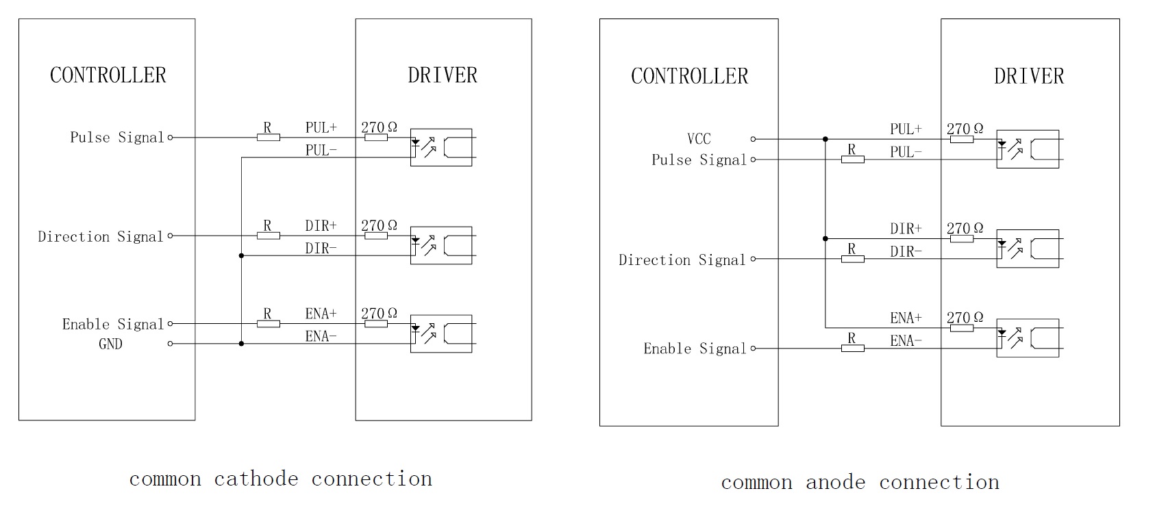

1. If you are sure you NEVER will use the enable signal then you don't have to care about that, so just ignore as it is ignored in your picture.
2. Check PUL - and DIR - with a DMM, I think those are connected to the same source, so basically you could have only the blue wire connected and from that bridge to PUL -.
3. In theory, if both your controlling devices share a common signal ground then you don't need to switch that signal, but it is a good engineering practice to do it, so I would definitely switch that also.
4. This leaves you with three signals to switch and these are the same as PUL + , DIR + and DIR -. Remember that DIR - is bridged to PUL - otherwise it will not work.
In the end, according to the above, you will need a relay which can switch three signals, but you won't find such relay. They are always made as 1, 2 or 4 (or more) pole relays.
I wouldn't assume -DIR or -STEP are connected to ground, the output circuit could be a NPN transistor (open collector). So the safest bet would be to put each (for lack of better description signal) on a separate pole.

GND is the same as STEP - , DIR - and EN -. It is better to connect those to the same - output as the one providing the control signals. Again, it would do no harm and we know too little about his design and implementation.
However I did think about this earlier, as the alternative controller may not have differential outputs, so some thought may be needed in that regard.

There are two documented possible ways of connecting the driver, in one case you bridge all the + to the same and switch all the - signals, the other way is what I am using, which is I think the most commonly used. Basically there is very little difference between them (I know that electrically the difference is huge), and both uses the same principle, but without knowing all the details of his solution it is impossible the say which is right and which is wrong.

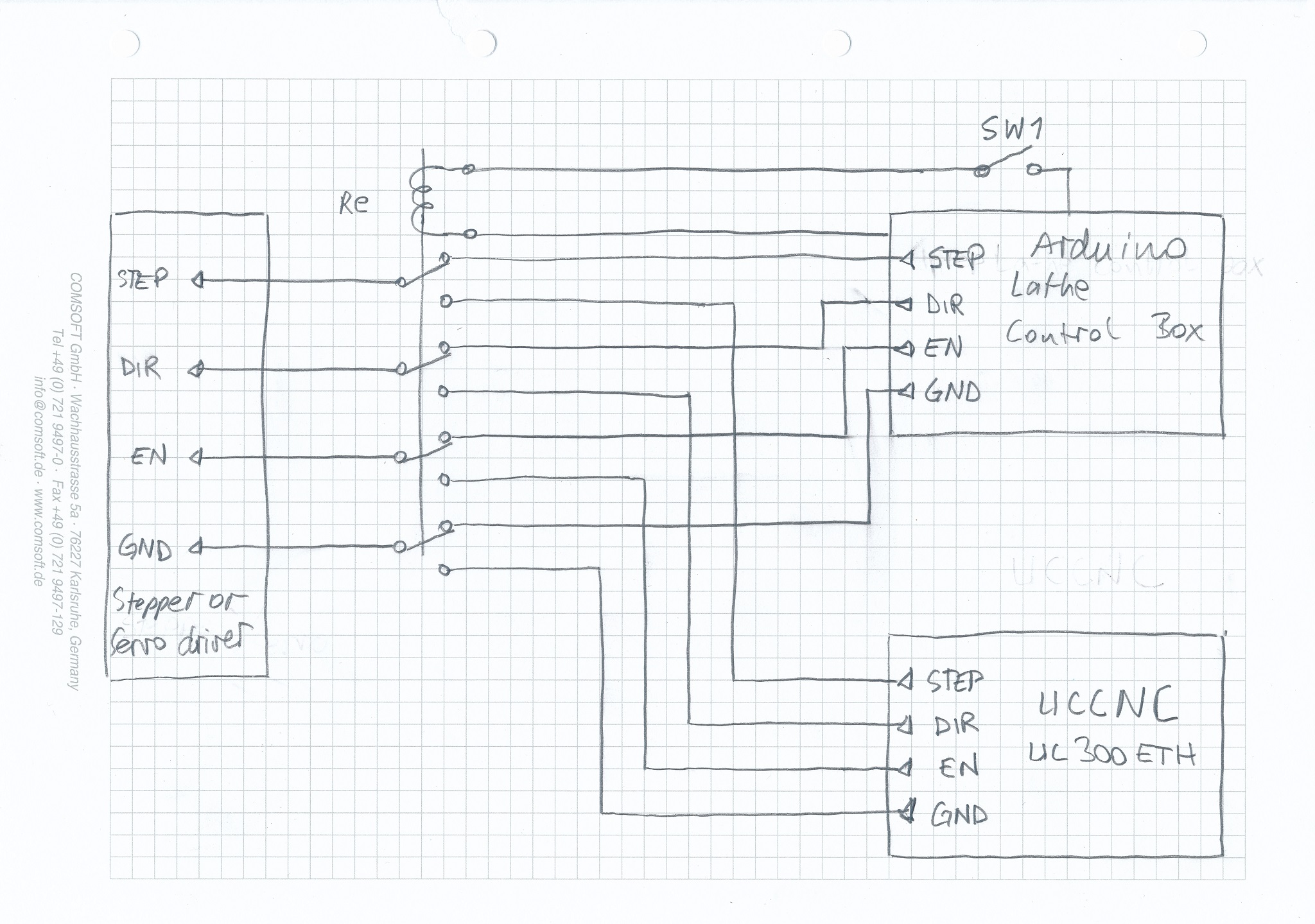

I was going to do this in F360 to test the schematic section, but the default component choice is limited, so here's a quick doodle -
Attachment 30723
I've marked the resistor, but I'm assuming as the switch is listed as 12V, it already has an internal resistor for the LED part, so it shouldn't be needed, but without seeing the datasheet, I'd add it just in case.
