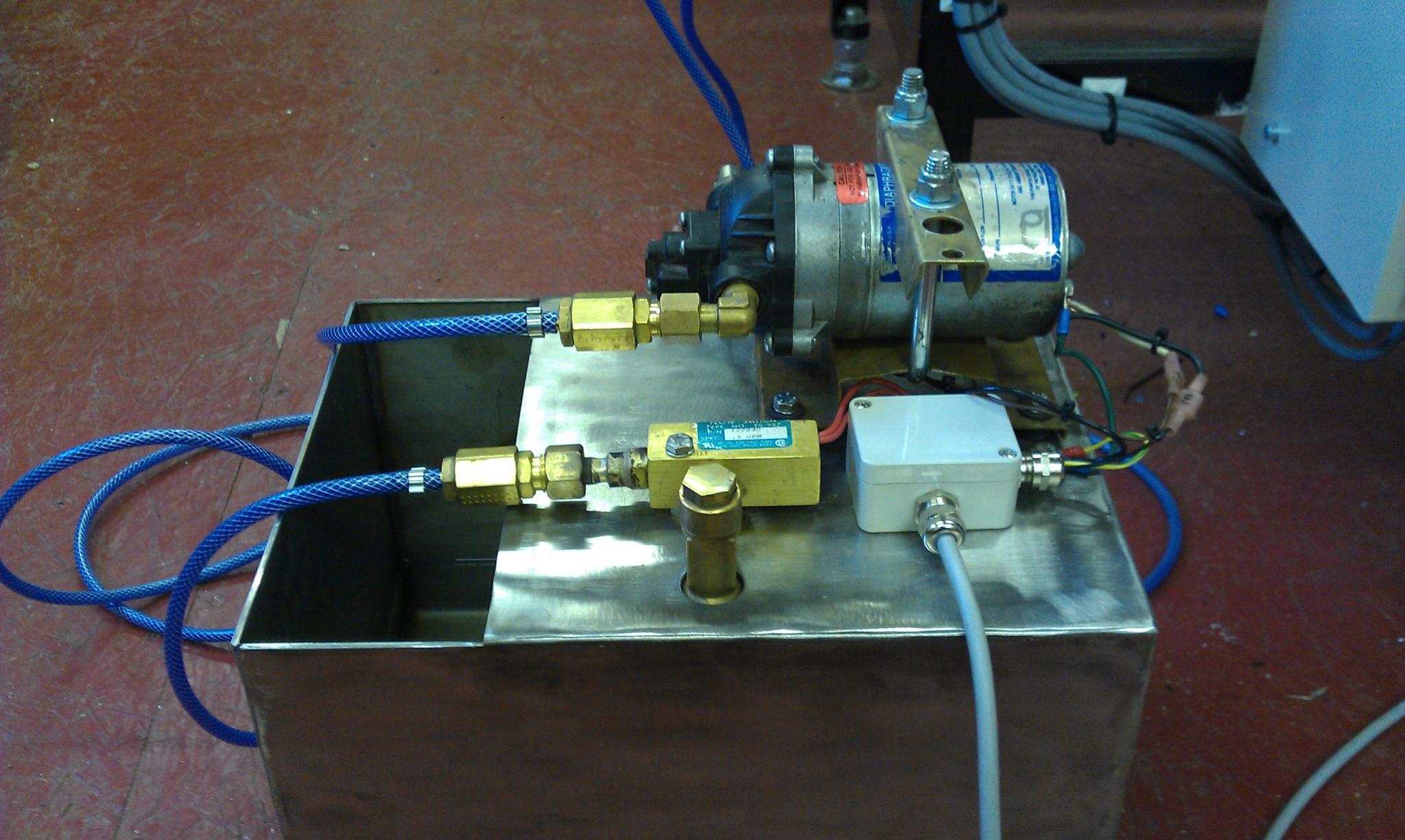

2 Attachment(s)
Re: Web Goblin cnc has begun
Here are a couple of pictures of the cooler unit.
Attachment 4443Attachment 4442
Just to add this will probably hold around 25 litres and not 10 like I said in an earlier post. Got my sums a bit wrong.
I have made a little control unit with a couple of switches, an estop and a pot for controlling the speed of the spindle. I need to have a read through the VFD manual now to see what to set up for it to take an external input for start/stop and speed control.
Ian

Looks good. I could do with a box like that to put a coolant pump I acquired in.
Web Goblin
Should be able to do it with the input the pot uses. Substitute the pot for the parallel port pin and use PWM output in mach. I'd put a capacitor (and possibly resistor in parallel) at the VFD from that pin to ground to smooth the PWM. It's all in the manual... you can do it with digital inputs but you probably wont have enough I/O on the parallel port to do that.

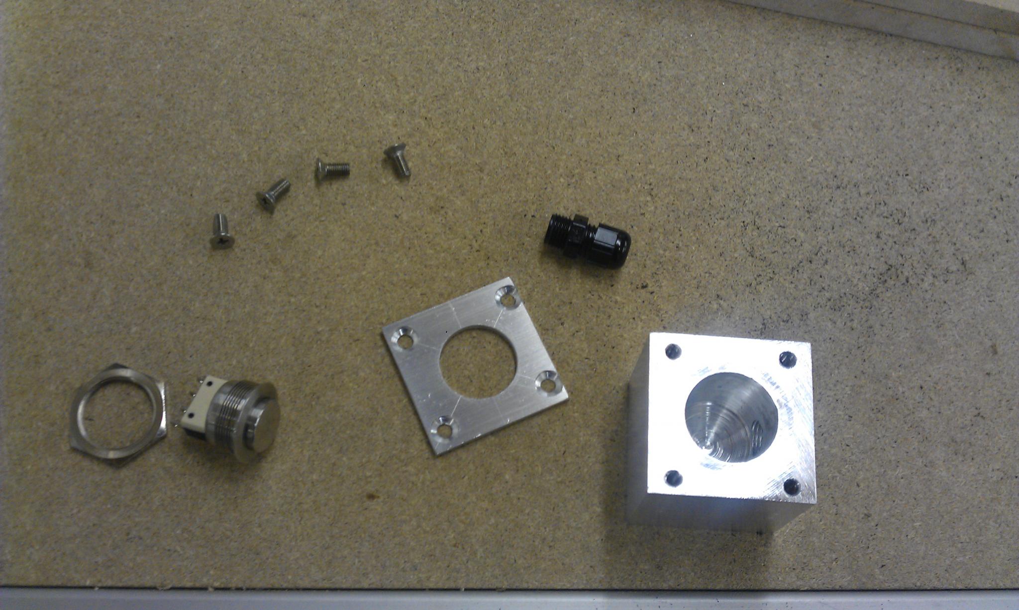

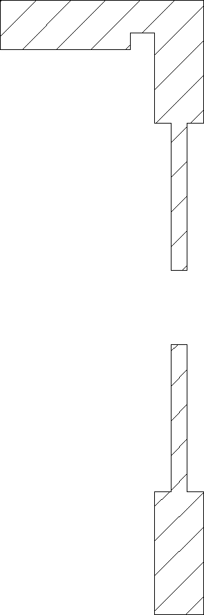

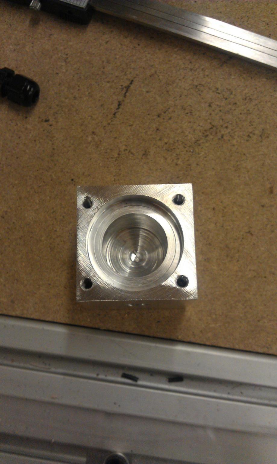

4 Attachment(s)
I have made up a tool height setter. Its a bit rough but I will make a better one when I get more time.
Attachment 4543
The basic parts. The centre of the top section was a bit off so doesnt look quite right.
Attachment 4544
Hole drilled and tapped to PG7 to accept the cable gland.
Attachment 4545
The block was cleaned up a bit on the lathe and the inner edge recessed to accept the switch locking nut.
Attachment 4542
The finished parts before assembly.
I have also set up the block in USBCNC and calibrated and tested it. Working fine it is.
Ian

Nice that Ian, are you going to change the script to touch down faster.?
I've set mine up so does a double touch 300mm/min first then retracts few mill's, can't remember what I set it at without checking, then does slow 75mm/min for accurate touch off in case over shoot. . . . . Works very good and one of the best things I've added to machine.
Nice indeed. Can you link me to the switch you used? I had not considered using a switch, only measuring resistance. I thought at one point of using a piece of PCB as the contact as then if something goes wrong the PCB is weak (as long as it's not FR4) and will break instead of the cutter.
Have you checked the repeatability?
Your spindle mount looks a tad flimsy to me ... only one support.
Jonathan,
the link to the switch is : http://uk.rs-online.com/web/p/push-b...tches/7082967/ Its a bit expensive but I chose it to take a bit of punisment.
I checked the switch a few times with my digital vernier and repeatability is within 0.3mm so its not too bad. I had also looked at making a voltage touch probe like Jazzcnc is talking about, that might be version 2 if I can get my hands on some solid clear perspex square bar or similar. The spindle mount is 25mm thick alu so its stronger than it looks but I have started on making another two to replace that one to strengthen it up.
The head comes down quickly until 20mm above the estimated tool block, depending on the guess value you input into the tool database, then slows down to touch speed.

Web Goblin
That wouldn't do for me.!! . . . 0.3mm is far too much for my liking.! . . . I would want 0.1 at the very very least.
My first thought when seen you where using a switch was it wouldn't be quick enough and your measurements backs that up.
Try pcb and you'll see what I mean by super sensitive, accurate and repeatable.

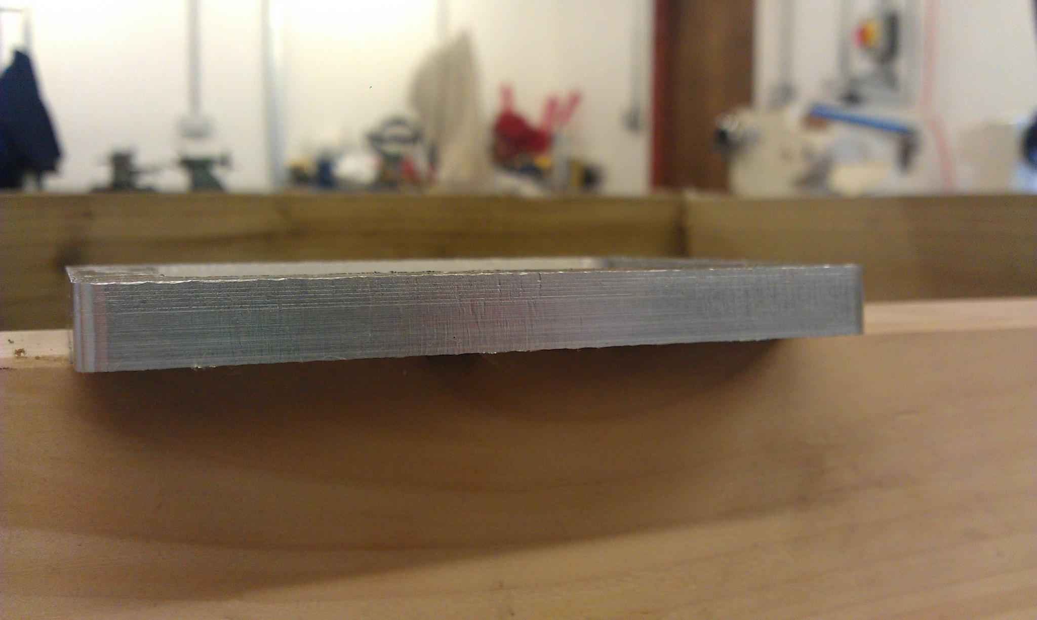

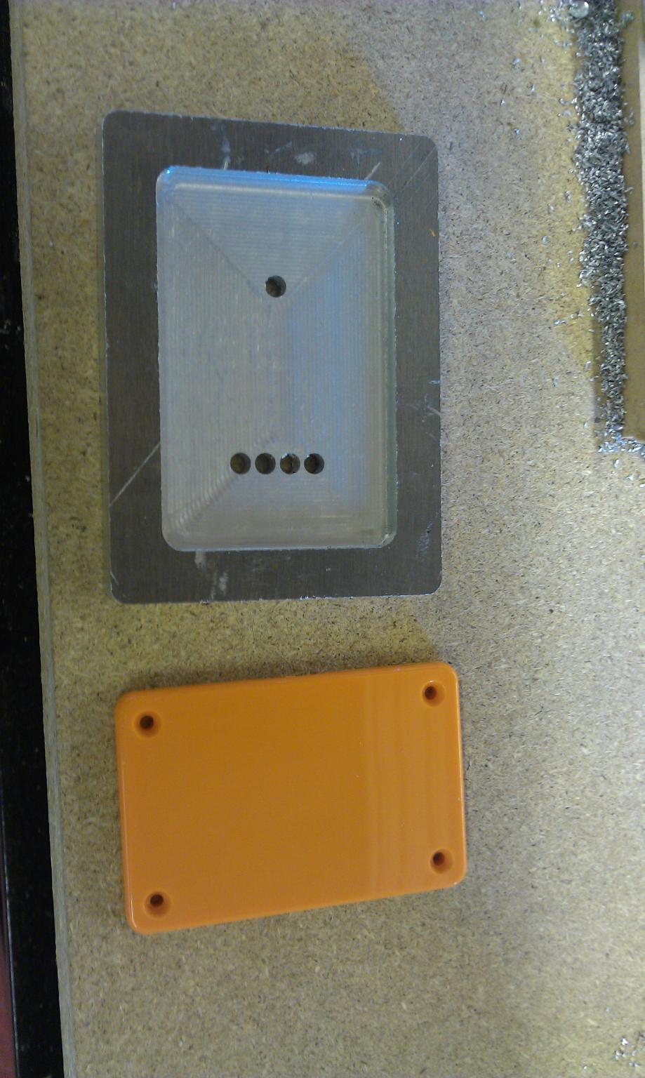

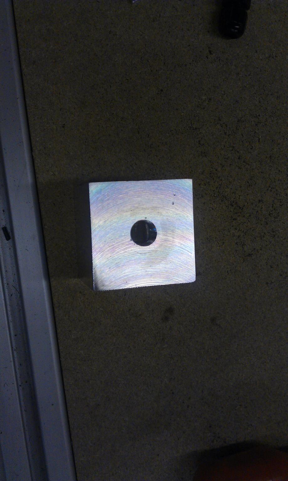

5 Attachment(s)
Right I decided that I had to have a go at aluminium, just couldnt resist the urge!.
I made up a dxf through autocad for a box drilling jig for some welding test boxes that I make.

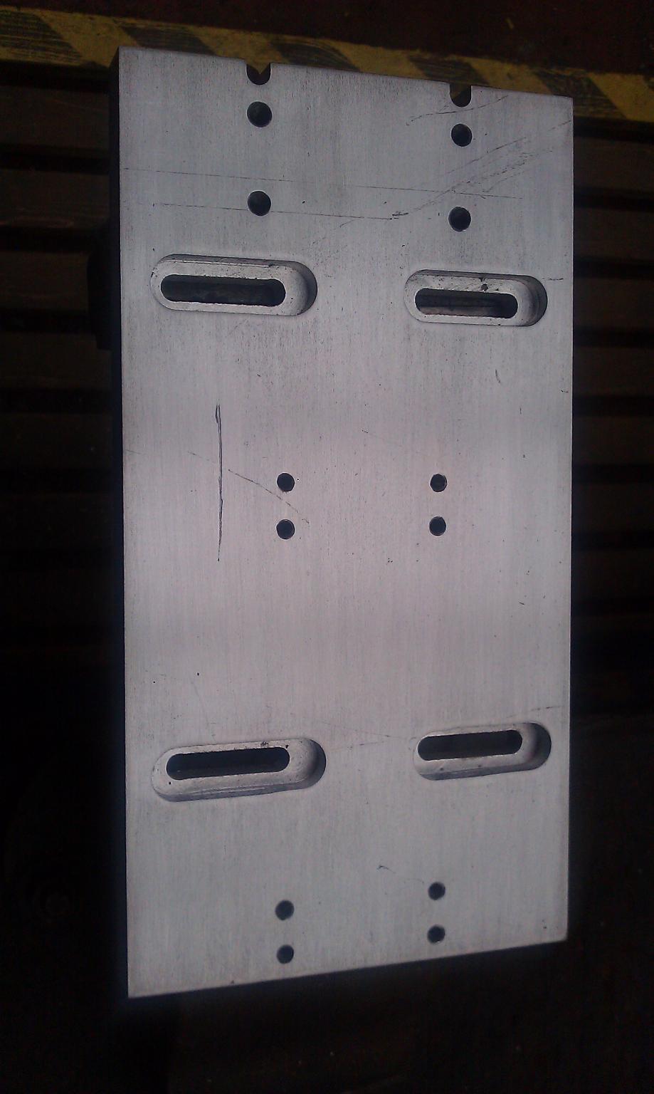

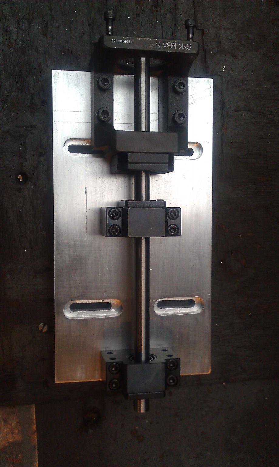

The material is 10mm thick alu and I used a 3/16 end mill, didnt have a 5mm one, I need to build up my cutting tool supplies.
Attachment 4557Attachment 4556Attachment 4555
Admittedly I did forget about the top face of the jig, at the moment I am still too used to programming for profile cutting. This would have looked better with a bit of a clean up.
Attachment 4558Attachment 4559
The box lid to be drilled and it fits snugly inside the jig.
All in all I am quite pleased with my first alu job. For using an old cutter and for a first attempt I'm a happy chappy.
I have also done a bit of video for parts of the cut and hopefully after my little gilrs 5th birthday party this afternoon I might get it loaded up to youtube.
Ian
