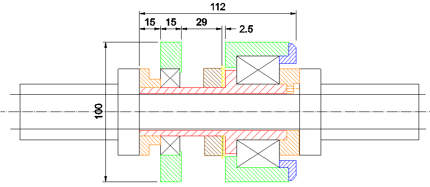

Re: Rotating Ballnut - design ideas
Thanks for the kind words...
I just mounted one ballscrew to the frame with a couple of G-clamps and some wood, so not the best but it holds. So with one ballscrew and 3nm motor I'm getting at least 12,000mm/min! It might do more but things are wobbling a bit as I have not fixed the X-axis linear rails down to the frame.
With the previous rotating nut setup (see post #1) using M20 threaded rod the best it would do reliably was about 2500mm/min.

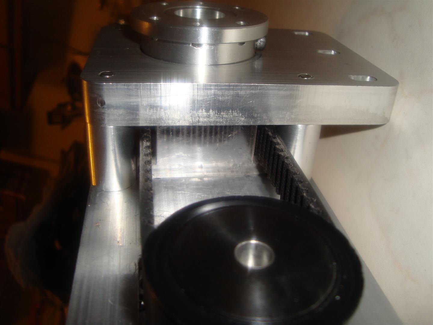

2 Attachment(s)
Video here:
http://www.youtube.com/watch?v=mSNFD...=youtube_gdata
Whipping caused it to stall at 15m/min. That be less of a problem when everything is mounted properly.
Some pictures:
Attachment 4229
Attachment 4230
At 8m/min I couldn't stall it by pushing on the gantry. Above that I
can, but only by bracing myself against the wall and pushing with both
hands...otherwise it just pushed me along the floor.
After the video I tried adjusting the acceleration. It went up to 3m/s^2 quite happily.

Jonathan interested to know what cutter you are using to cut the teeth on your pulleys?
2e0poz
It's just a trapezium shaped form tool. I ground it by hand on to a piece of 5/16" HSS. I mentioned it in post #37. Can post a picture if you want, but there's really nothing to it...

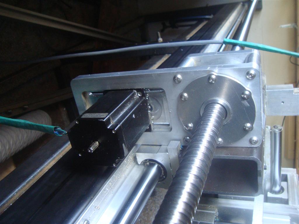

I have now mounted both X-axis ballscrews, like this:
Attachment 4231
Interestingly with the second motor the feedrate decreased from 12m/min to 10.5m/min. I think this might be due to me not yet being able to get the second ballnut on centre which is causing the ballscrew to vibrate a bit.

Update:
Can't really fault the rotating ballnut mounts. They're rigid and get a plenty high enough feedrate from quite small motors. The oil does keep flying out of the ballnuts, as predicted, so I occasionally put more in and they seem fine.
I should have incorporated dust covers as swarf does land in them. I did cut some aluminium covers on the router to protect the angular contact bearings:

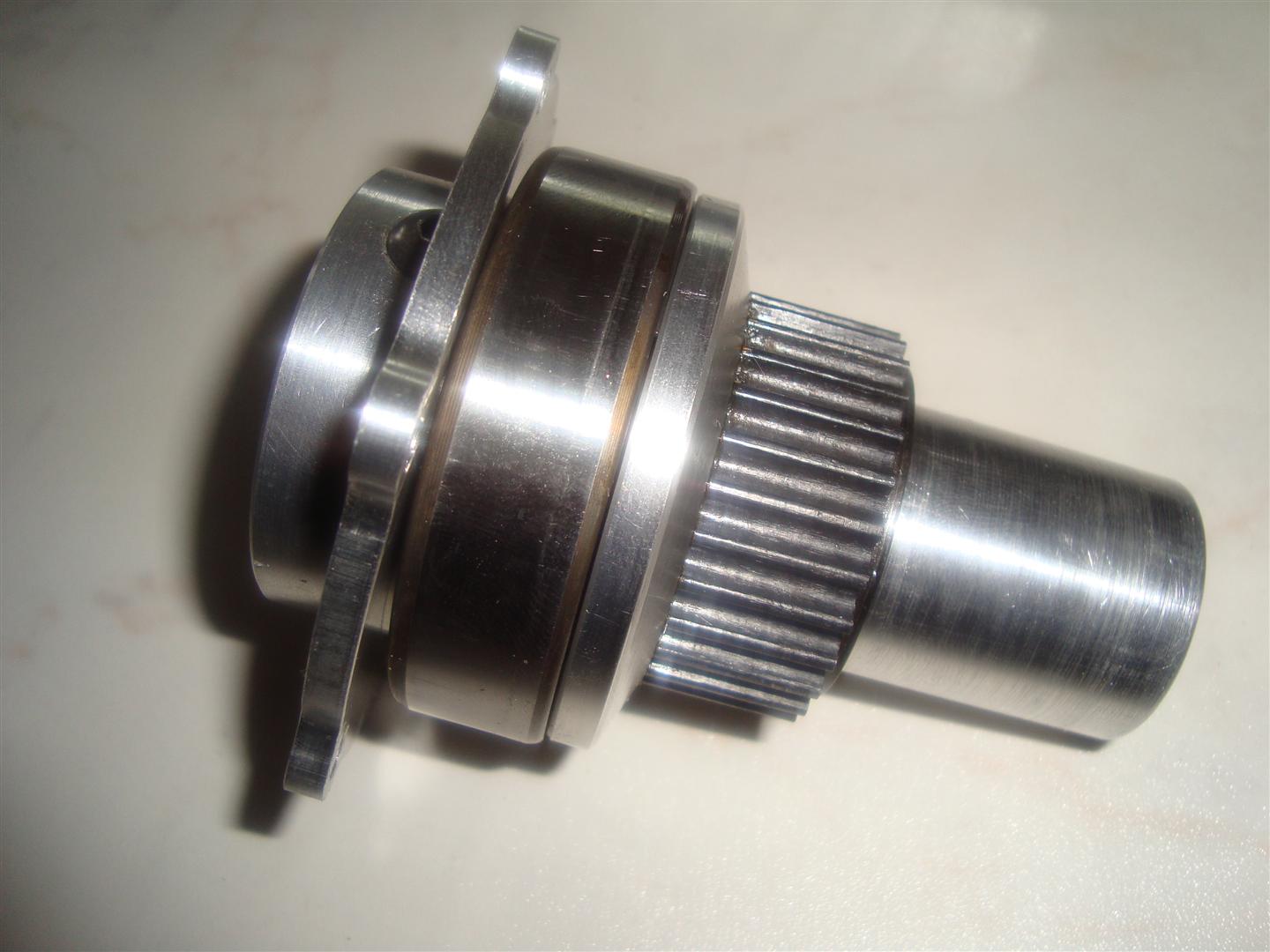

More recently I have made two more mounts, this time for 20mm or 16mm screws and with polycarbonate covers, HTD pulleys, and just generally neater as I made them on the router which gets a better finish than the milling machine:
Attachment 4961
Attachment 4955
Attachment 4956
Attachment 4959
Attachment 4960
Attachment 4954

What's the gear ratio between motor and pulley/ballnut??
Is 10mm screw pitch?
It is 1:1 and 10mm pitch, but clearly one could use it with any pitch and to change the ratio just change the pulley on the motor. The mount for the motor is long enough to accommodate different pulleys without changing the belts. It will go faster with a bigger pulley on the motor, but with a 10mm pitch screw there's not much point ... you're just loosing resolution.

How did you fasten the pulleys on the rotating ballnut shaft and motors?
M5 and M4/M5 grubscrews respectively. So long as you threadlock them it works. The reason I didn't use a clamping method is that tends to require a larger diameter pulley, particularly on the ballnut shaft, which would increase the moment of inertia.
Basically from what i understand 24 tooth pulley / OD 37.08 at the lower point at the tooth/ can not be fit, had to be machined on the shaft directly? So the next in line is the 26 tooth pulley which is OD 40.24 at the lower tooth point, so that will give 40-35=5/2=2.5mm wall, which seems quite thin. Then 28 tooth pulley is 43.42-35=8.42/2=4.21.
So it seems if not machined directly, the minimum pulley will be 28 tooth? Or am i missing something?
The minimum pulley size that I could fit on the shaft was 30T, so that's what I used. By machining the pulley teeth directly into the shaft, as with my first version, a smaller pulley could indeed be used, but it adds a lot of time to the machining.
The shafts are 35mm diameter, so it's a bit thin even with 30T as you can see from the previous one I made, here:
Attachment 11008
