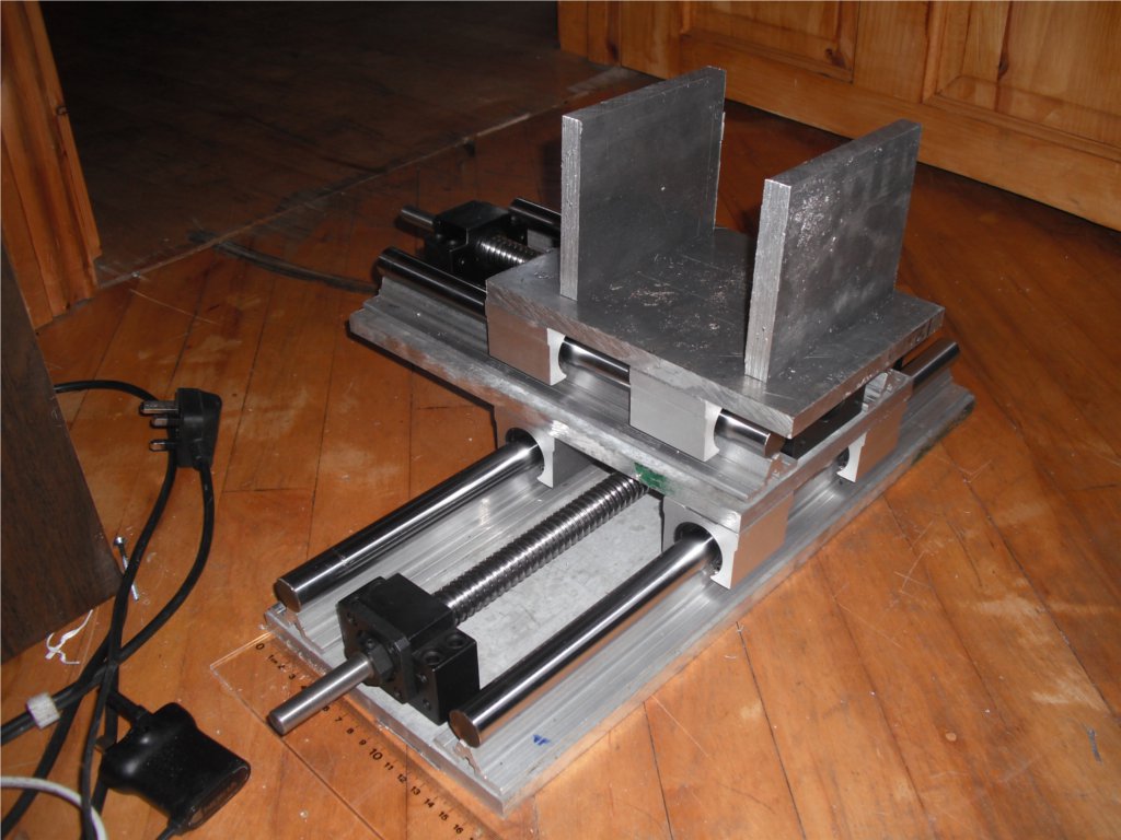

Attachment 4539Attachment 4540
So if the ruler was a stupid price how much was the aluminium? Looks like about £31 worth to me...so I guess a stupid price would be £20.
You seem to have laid it out with the Z-axis rails mounted to the Y-axis slide, not the other way round. Was that just for the photo? Putting the rails on the Z-axis so they move up and down and the bearing blocks are fixed is stronger.
the ruler was £1.29, £20 is bang on.
I'll give it ago with the rails the other way around, it's just I thought the extra weight would be a problem.

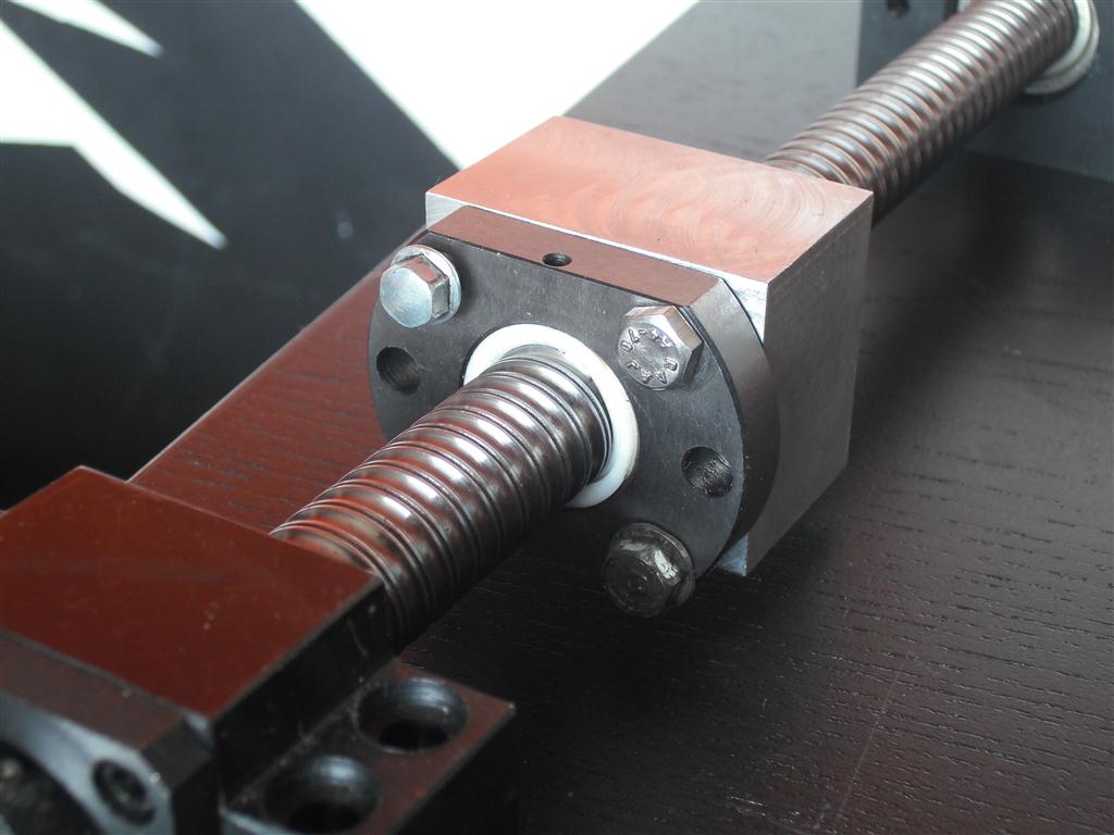

So, mounted my rails on my bit of alu, also mounted the screw as well
Attachment 4635Attachment 4636Attachment 4637
the ballscrew isn't perfectly central, off by 3mm or so.
but it's going pretty well.
