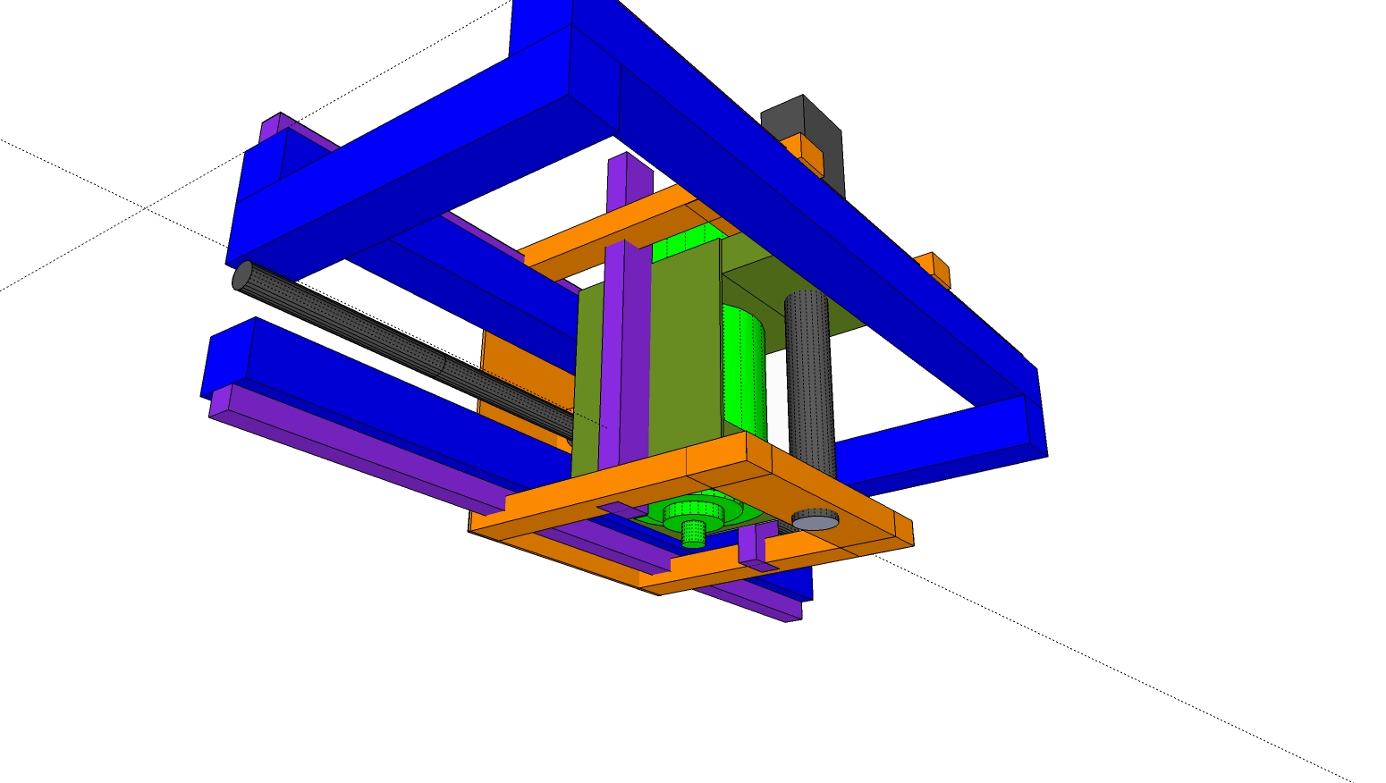

I've attached a few shots of something I was playing with to help me understand what I am trying to do... It's not to scale! more of a schematic block diagram sketch to see if it could be done, but comments are most welcome.
I've left out some of the elements so it can be seen easily. (like the colums parralell to the Z ballscrew joining the upper and lower Y axis motion, joining the upper and lower blue box sections etc.) and I've shown as bars things that could be plate etc. The purple areas are the supported rail, any other questions just shout. If you want to play with the Sketchup file PM me and I'll send it over as Google wont let me upload it, they must have standards! lol.
As I said it's not to scale and not an opimised design, putting the ball screw mount under the 3rd Y axis support, moving the Z ball screw closer to the spindle, etc. could all help to reduce the overall footprint - although the overall size should be spindle + ballnut + Y axis support? could drop it in the region of under 200mm??
I'm wondering if the ideal position for a high sided frame design be putting the whole of the Z axis UNDER the Y axis? (but I might have OD'd on the coffee this morning LOL)

If you mean the Y axis rails then No they where just drawn that way, they could go either way round. The back plate and rail was just put there for affect really and this was just quick mock up drawing really not actually a finished design in any way. . . . . . Only posted to give some idea how thinner material could be used put still give a stiff Z axis.!!
Regards your design I'm slightly struggling fully under stand the layout but my first initial reponse would be "WHY".??? . . . . Why all the complexity when you won't really gain any extra support over a conventional Z axis.
The way you have it drawn you are still relaying on just 2 rails/bearings and if the bit with rail on top thats jutting out from the Y axis with rails top n bot is not directly mounted to the gantry sides or X axis bearings plate then your in big trouble.!
If Z axis was supported on 4 sides with rails/bearings then yes I could see the bennifit but can't see any how you have it now. . Plus still the jutting out bit would need attention.
If you have the length and done right then the wide gantry with central Z axis (Ala Mech mate) can be very strong it just cost's MORE, more expense, more real estate, more work.! . . . trick is working out if it's worth that much MORE.:question:
So what you have there is a copy of the MECHMATE? that is the type of arrangement they use.

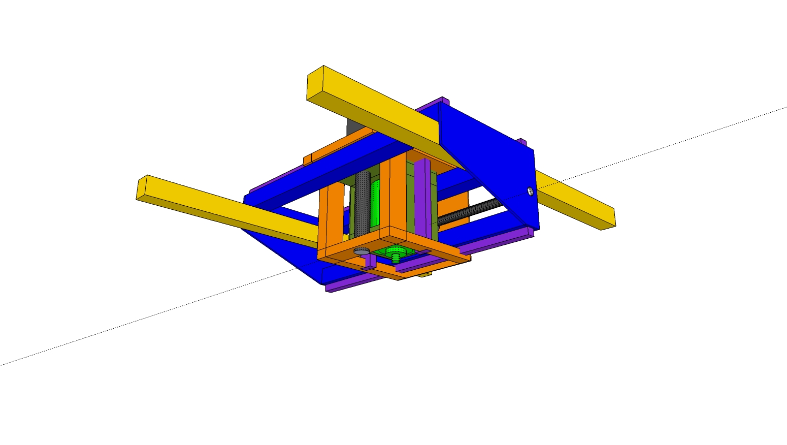

Attachment 4703Attachment 4704Attachment 4687
[edit: added pics 2 and 3, x axis in yellow! that might be clearer and make more sense!!]
Apologies for poor quality drawings!!!:redface:

Yes, the image probably doesn't make too much sense as it is, LOL, this might be clearer, although not necessarily better! :-)
In answer to your points;
Why? I'm thinking that the closer to the spindle that the supported rails of the Z are, the less leverage that can be applied to them, so the spindle mount is also the supported rail bearing mount.... This of course assumes that fitting the rails to the spindle is a good idea! lol
yep, ammended pic aboveQuote:

Mocha sorry didn't see this before but Doing it this way means the X axis is unsupported from under neath and could flex.?
I would still do it with this configuration but lift the whole thing up and sit it on the X axis bearings, basicly making a rectangle box section frame.
Like I say Spindel supported on four sides would be better but I see why you have done it this way to keep the width down, thou I think the extra strength would be worth the width loss.!
