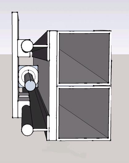

I have spent an enjoyable afternoon staring at the screen. My problem was enough strength to overcome rorational deflection and keeping everything close. I think I may have cracked it using 100 x 50 x 6.35 al channel. Although I have shown a single section it would be no problem to bolt another piece back to back if it was required on building. The rails are close and the leadscrew is also very close. Tidy.Okay comments please.Bruce
I changed the design slightly for the assy and put channel at the top to support the motor mount.
Re: Definately a scrapyard challenge
C section also does not have very good rotational stiffness. If you added another bit on the back that would make an I, better but still adding some rectangular on the back (100*50, or over 100) would make a big difference. 1/4" looks a bit thin to be mounting the rails on.
Two pieces of box section wide enough for the rails on a flat aluminium plate with the rails facing outwards is probably the simplest.

Bruce,
Another option you could look at with that build is two section of rectangular box section and bolt a backing plate or wings to them and bolt that to the gantry uprights as well as the box sections themselves. This will give a good bit more rigidity and either the wings or the backing plate could be indexed to help keep it all true and proper. Drop me a message and I can send you a few files in a format that you can use of ideas Jazz and I worked on that will work. Also take a look at my build log as there are some ideas in there you might be able to use. The following might help:
http://www.mycncuk.com/forums/showth...-machine/page6
If you scroll down you will see one model with sections lifted off to show an idea for the Y axis. That might be a good place to start from and change the solid rail to box or rectangular section extruded aluminium or steel and you would have something that would be a good bit more rigid then the channel. Just trying to help and hope not to offend.
Michael

Bruce I'd be very weary with both the Channel and the angle they could both give you more trouble than they are worth.?
Angle and channel are very rarely 90deg or very flat.! If the angle for the bearings hisn't perfectly 90deg and flat it will cause binding in the bearings. If compounded with the channel the rails are sat on not being square or flat then you'll have a bear of a time with sticking.!
Both the Angle and channel will need bracing to fight flex and resonance, esp where the angle meets the channel used for gantry sides.
Can I just ask why you are using channel,angle and 10mm plate in all your designs.? Do you have the material or a cheap source.?
If you have the 10mm plate then why not build using a bolted and braced design which incorparates the gantry sides to increase strength and ridgidty. If braced enough even 9.5mm plate can make a very stiff gantry and Z axis.

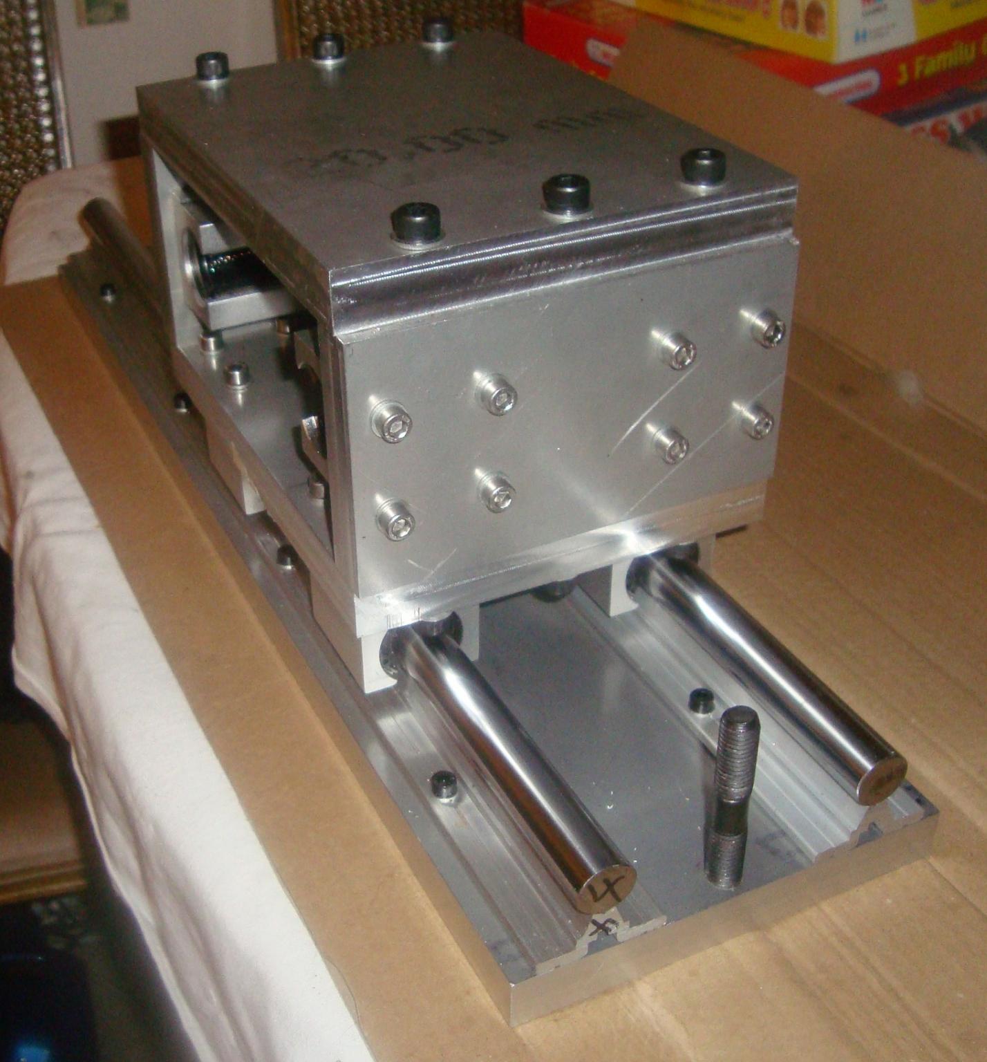

Hi Bruce,
In reply to post #73 I would delete the box section and the 2 angle sections. I would then replace them with either an RHS (rectangular hollow section) of similar depth to the plate, or stack one box section on top of the another and bolt the rails&plate to that. Looks like it would be a reasonable fit based on your drawing.
With the RHS option you could potentially delete the plate, but I think on balance I'd still leave it in.
Hope this helps,
Barry

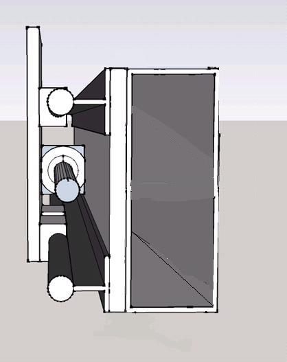

Like this?
Attachment 5239
(not to scale, 3D cad program stopped working otherwise I'd post a proper drawing)

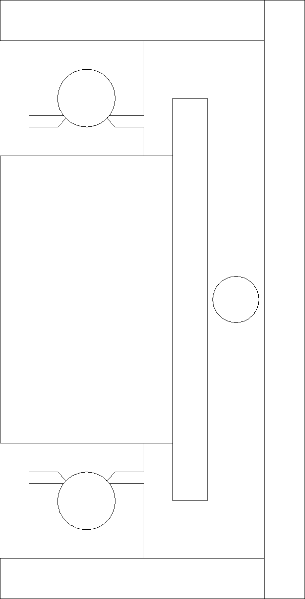

Right, here is redesign 5-1.
Obviously I will need to figure out the best side pieces for the gantry. Am I, sorry, are we heading in the right direction?

You've gone for a pretty generic arrangement now, which is fine.
It will be stronger to put the bearing blocks for the Z-axis on the Y-axis and the rails on the spindle plate. This sort of thing (mine):
Attachment 5249

Hi Bruce,
I meant one of these to keep your re-design work to a minimum. But what you've since drawn is also good.
Attachment 5250Attachment 5251
Routercnc - Thanks for that. The latest soluton allows for the screw nut to travel between the rails which keeps the overhang to a minimum. Apparently I still have a bit more work to do on that.:whistling:
Chip - I realise it may be a bit belt and braces but what I have learnt so far is that strength is paramount. The back plate will assit in the end supports and reduce any rotaional force on the boxes....maybe
