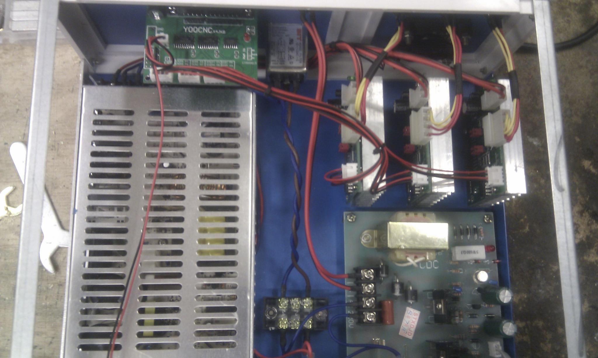

Care to share a picture of your spindle drive circuit? :)
Re: Ebay Chinese Routers (CNC3040) - anyone purchased one of these machines recently?
Tenson
will get some lid off shots tomorrow :-)

3 Attachment(s)
Lid off pics, Yoo CNC controller:
spindle control;
Device numbers been scrubbed off the two power trannys, it does the job of controlling speed but a decent D.C. drive or change to VFD spindle somewhere down the road.
Paralell in breakout, now know why E-Stop does nowt, its physically connected to the probe pins ;-)

At the moment we are able to run ok on approx 50% of the bed without problems which enables us to continue and produce parts (for the moment anyway!)
In the meantime I will make up a new cable if i can work out what the connectors are!
camhguh
Sorry i missed your offer to come and sort us out Jonathan, lol, much appreciated mate!
Try the yellow cable that connects to the Z axis connector on the parellel board. I had a similar fault and it turned out to be loose in the socket.
Phil
Thanks for the suggestion Phil!
I made up a new cable this evening and although i havnt tested it in anger yet, the z axis does seem to work ok while moving the gantry back and forth.
Hopefully problem solved!!
Bugger me my machine went and did this yesterday.!! . . . I've just transfered all my control box into a new larger box. . . . I knew straight away what it was and to be honest I'm embaressed that I didn't think about it in your case.:redface:
It's one of the Dir pin wires thats either come out at drive or connection/wire come lose in motor. To be honest I didn't expect it to behave how it did.? I expected it would only move in one direction but it infact it was moving in one direction then changed direction randomly.!!
LOL , its catching, must be a virus going round!
Anyways were back up and running ok after replacing the cable...must have been a spot somewhere along the length of the cable where there was a breakage but making contact depending on where the gantry was positioned.
Thanks once again for all your input its been very helpful and much appreciated as usual!
