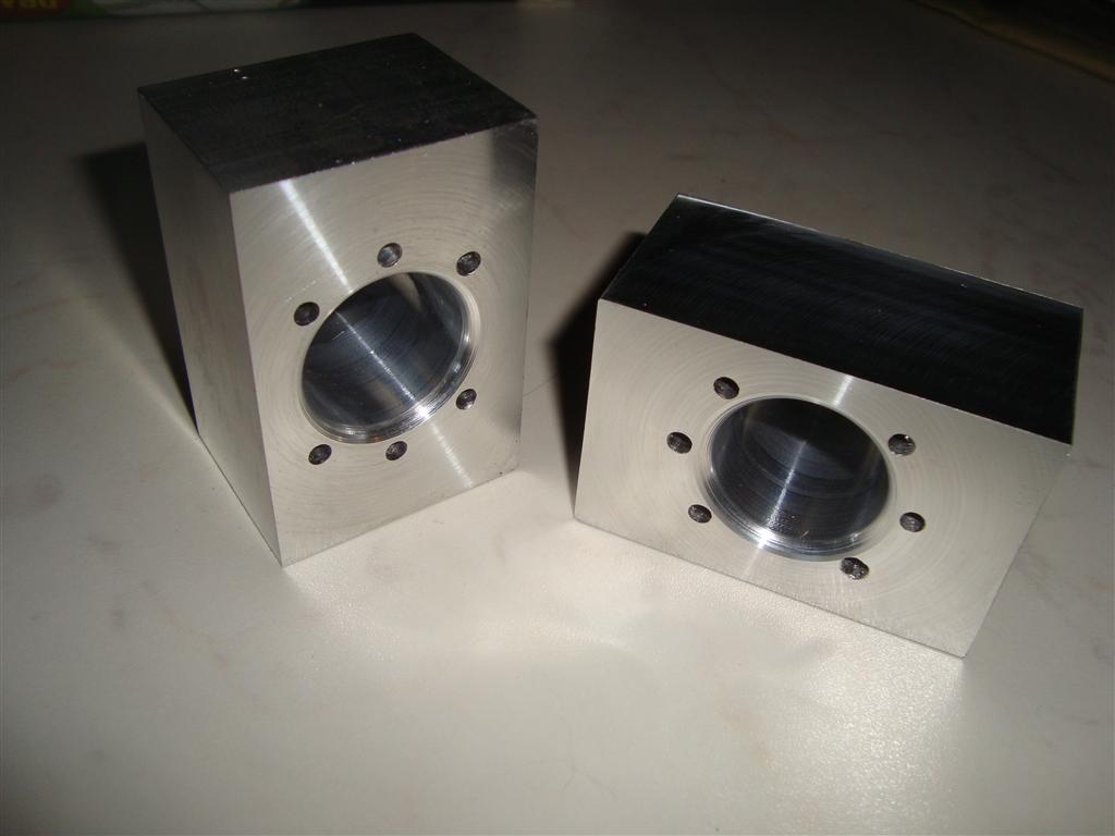

Hi Tenson,
I see your cnc endeavours are coming along nicely!
I have toyed about a little with ball nut mounts myself using the "off the shelf" components, what I found with using the SMA units is the mounting holes for the Nut. If memory serves me right only two of the fixing holes could be used.
Your drive nut is properly one of if not the most critical part of an axis, personally I wouldn’t be happy with such a fixing, however I have seen machine’s up and running and only using the same two fixing points. I am guilty of being a perfectionist though with a little OCD topping to add to the flavour :)
In the end I decided to design my own drive nut mounts, I wasn’t able to machine them myself but another member on the forum was able to and did a great job for me. The price wasn’t a lot however they did stress that clamping was an issue due to the shape/design.
I have attached the finished picks for you to view, if you want the part details I am happy to post them for you.

Thanks Lee! Four of the six screw holes can be used, so I thought that is enough. I also considered putting a bit of lock-tight around the nut before inserting it. Not too much, since it should come out again with a whack.
P.S. your mounts look like a super-charger!

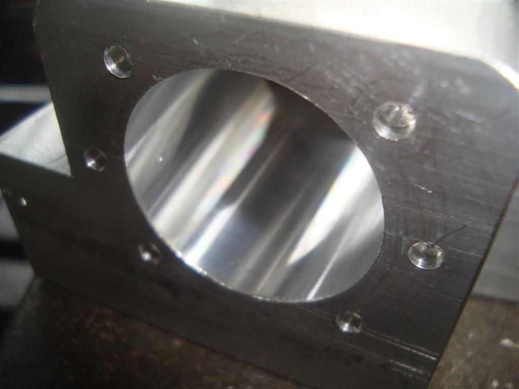

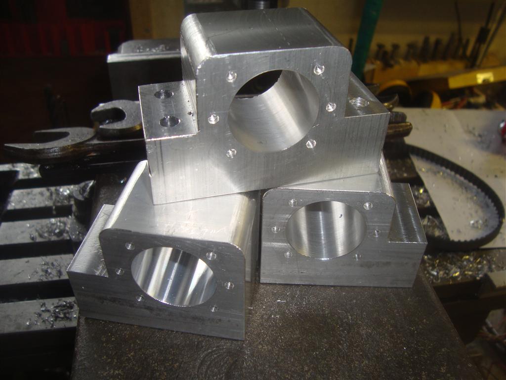

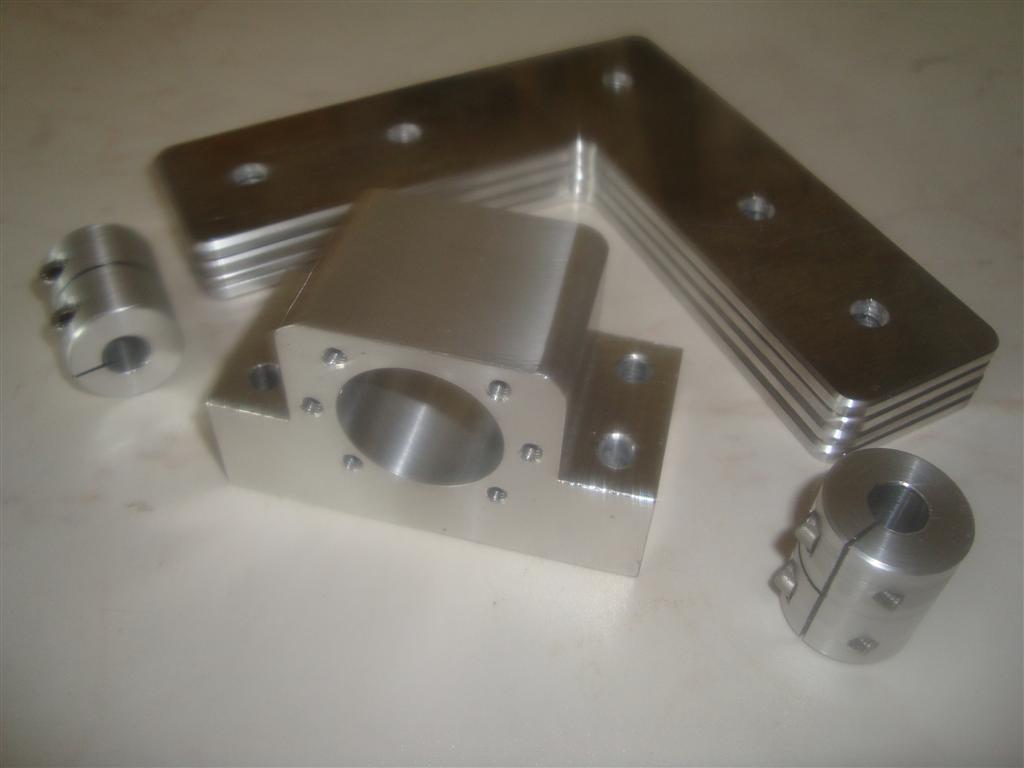

I've made a few ballnut mounts for myself and these for people on the forum:
Attachment 5581Attachment 5582Attachment 5583Attachment 5584Attachment 5585\

I wouldn't put lock-tight round it. You'll need a bit of room for adjustment when you first fix everything together to ensure the nut can be set precisely concentric to the screw.
Do the mounts usually have much room to move? This fits absolutely perfectly and tightly so no room to move at all, although it could rotate a little.
*Pictures*
I hope you're not intending to use those unsupported rails on this machine?
Very nice mounts. If I use your super rotating ballnut systems on the Y and X then I only need a nut-bracket for the Z right?
Yes... but how long is the Y-axis screw going to be? It's a bit sledgehammer to crack a nut using a rotating nut on the gantry, althought it would work well.
Re: I want to DIY.. some questions please!
Don't under estimate the job the ballnut mount does.!!
Ballscrew mounts, alignment and nut holding are crucial to a good working machine, if any one is off the slightest amount the result is friction.
