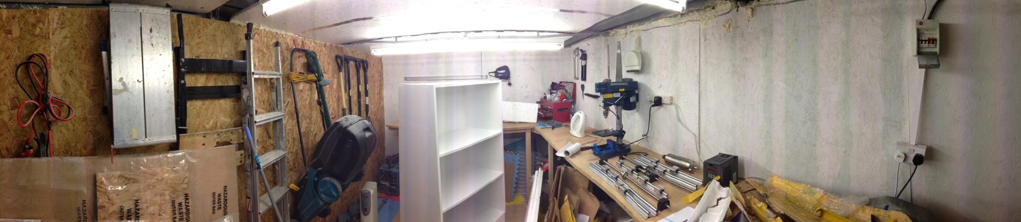

here is a fancy pano picture of the garage as it stands in its messy state.. i cant wait to get that box painted and reclaim some of my space.
