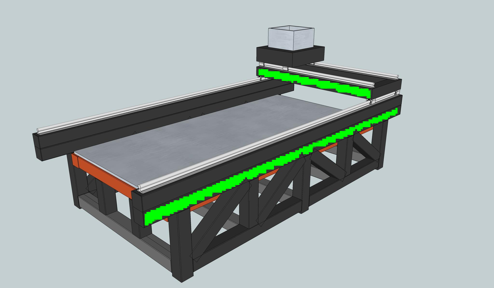

Next round guys Mk3!

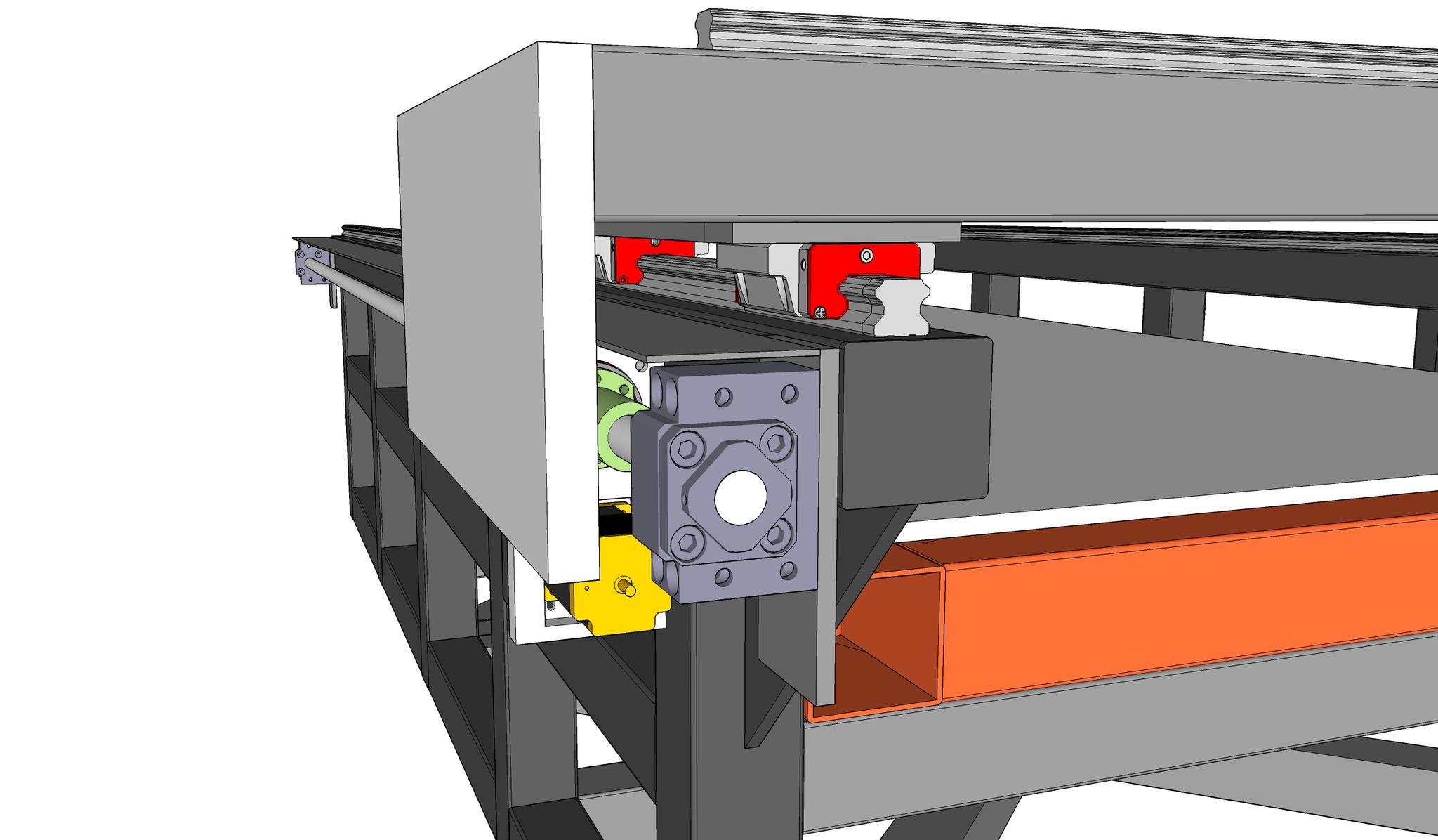

Attachment 11240
Attachment 11238
Removed steel form sides and changed bed supports. Any better? Saves a lot of excess steel.
Attachment 11239
Started on ideas for rails etc... let me know your thoughts please.
Attachment 11241
Attachment 11242
Think this should provide a strong setup, also thinking about using BK blocks to mount Ball screws? Will these be suitable?
Thanks!!

The covers round your ballscrews will fill up with swarf and cause the ballnut to fail prematurely.
Wejjmeister
Best way is to use a rotating nut. If not, then at this length you'll want two angular contact bearings at both ends to get a respectable speed. Search on Google 'ballscrew critical speed' for more information.

Thanks for that, as for the former comment, I would have covers all along the open section to prevent swarf ingress, would this suffice?

Could always put the slot in the outer sides and make it so the gantry overhangs a little more and they attach on the side? Was trying to keep the rails and screws as close to each other as possible thats all.
That is a sensible priority.
I'm being intentionally vague here since, as you've realised, you've got to weigh up the factors and if I just say how I'd do it, then you might miss out on finding your own better solution. Ideally you need to minimise distance mentioned for rigidity, not allow swarf to build up on the ballscrew (especially if rotating nut) and not cost an unreasonable amount.

Exactly what I feared!! I will do some more thinking, need to research rotating nuts first as I'm not at all familiar with these, then I can hopefully come up with something. The covers are pretty resilient though and will stop most foreign bodies, with those plus regular cleaning I think it may be the best option as it gives the most strength.
I'll give it some thought! Any other glaringly obvious mistakes in the design??
100% Agree I wouldn't use rotating screws at this length.
The covers will still fill up the way you have them now. The little extra the Gantry will extend to make it so slots are on outside won't make any differance to how this machine performs so it will be worth doing no matter if rotating screw or Nut.
Don't get caught up in the over analysing the machine because while important your only talking a very small differance which won't a make a JOT of differance to the cut quality or speed needed for cutting woods, plastics and even for the level of Aluminium cutting this machine will be capable of dealing with.
Shit in the Screws or Nut will make you REGRET NOT doing it EVERY DAY were has you'll never even notice the screw being closer to rails.!!
Not glaring but you have gone too far with removing the diagnols but not far enough in other places.?
I would have diagnols at each end of the sides. But would remove the central upright and re-space others on all the Bed support frames.
Would also have a Bed support frame on each side upright and not laid flat in like you have in centre.
The rest looks ok.
EDIT: I would also on the outer End bed supports have diagnols on inside lower beam which fastens to the sides to help hold frame square while setting up and bed frame is fastened. Like this but larger and to suit your design.

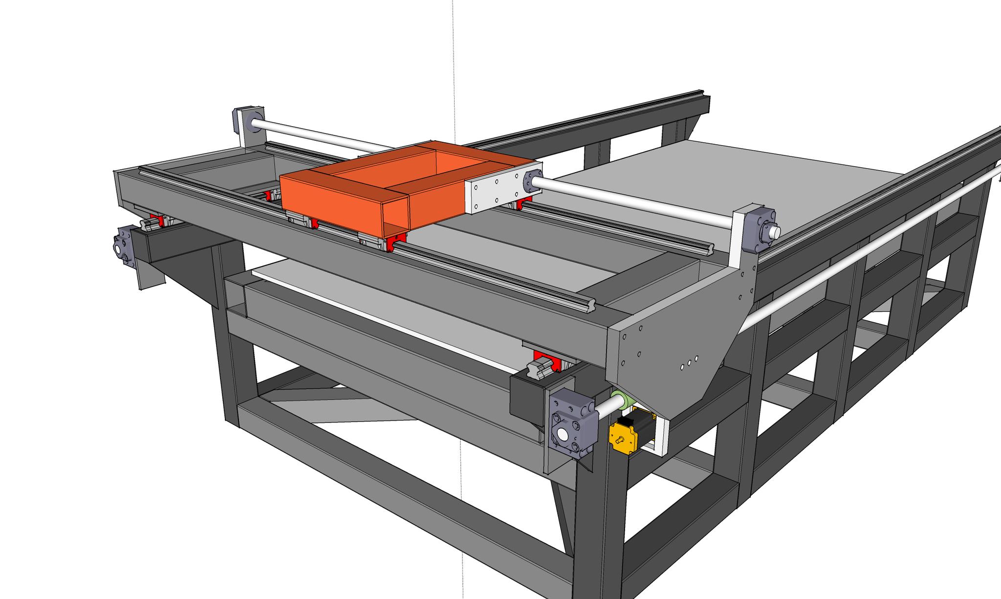

Here is the Mk4 frame layout, any opinions guys? Ive taken on board other designs in this one, Im making the bed adjustable too on holes inside the legs, so it will have further movement, will that affect anything else do you think?
Thanks in advance!

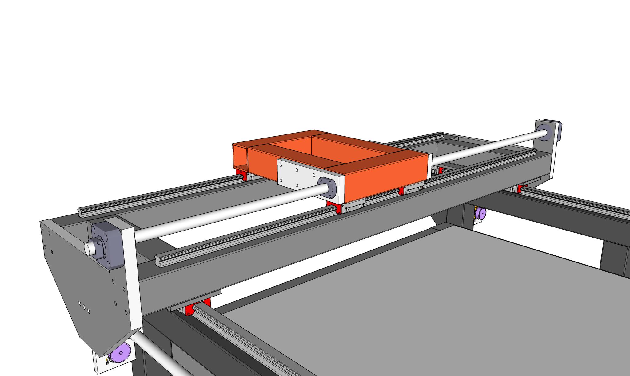

Is this any good chaps? Changes a fair amount to incorporate it...
Attachment 12469Attachment 12468Attachment 12470
Re: Advice on Mammoth CNC Router Build - Steel Framed - 2440mm x 1220mm cutting area!
Can anyone just gimme an idea as to wether Im heading in the right direction please, I dont want to go too far with any major flaws. Thanks.

How are you planning to allow fine adjustment of bearing/ballscrew nut position? This isn't a criticism of your design but I'm working on exactly the same issue on my own design! I'm assuming I can build a structure to within a millimetre or two, but will need to permit tweaking to get exact alignment afterwards. I can't see how you can move the bearings, for example, in both dimensions, unless you plan to use shims?
For the top rails, I will use the epoxy method, both on the x and y. For the ballscrews and blocks it will be shimmed to suit, hopefully that will be sufficient?! Im a newbie though too so looking for advice throughout the process just to keep me on track!

Why do you need the bearing blocks to hold the ballscrews if you are using a rotating nut.
gavztheouch
I will fix them, they are just for reference to begin with to get the spacing etc correct. Couldnt find a skp file for anything else to be honest!

Frame looks fine to me and if anything it's over engineered in places and under in other. By this I mean you don't need that much diagonal bracing near the floor but it would benifit from more diagonal braces on the sides and ends/cross sections..
If you don't plan to put on feet then I would also lift the lower horizontal beams up a few inches to help with levelling. Just the stubs of the vertical members will be better and easier.
Other than that then it looks fine and will be plenty strong.

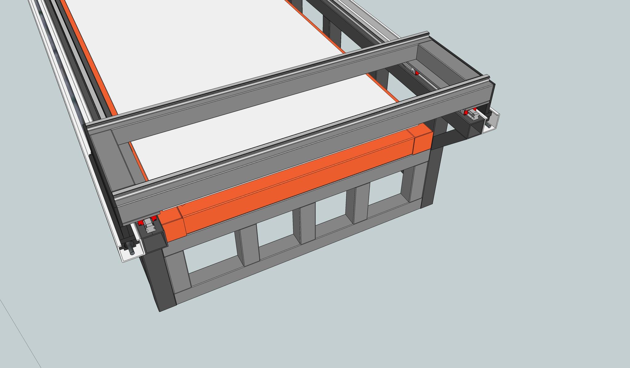

Right so I have now officially ordered the Steel for the frame, I have gone with a local company, they've agreed a good price and to cut to a decent tolerance level so I'm happy. The bed Will be tweaked slightly as I've never been happy with it, but the frame is the same.
Questions for those in the know:
1. Does this look to be strong enough guys? The ball-screw will be driven by a pulley on the end so that the pitch can be played around with.
2. I'm not sure where to mount the motor though?
3. Will 20mm profiled rails be sufficient?
4. What kind of motor should I use, as I specced all Nema 34 12.1N's throughout so far but do I really need these on this axis?
Attachment 12589Attachment 12590

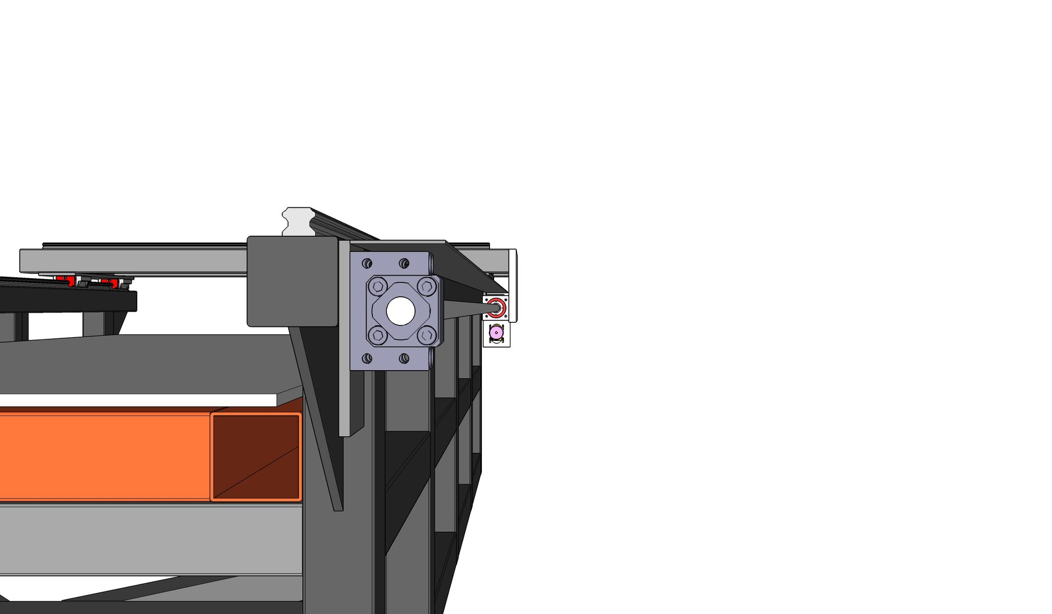

The gantry is a nightmare, I am trying to keep everything close together to keep it strong, whilst using the space well too and trying to save on machining costs etc, if you have any thoughts so far, please let me know as I am dreaming in CAD lately and my thoughts are all over the place!!!!
Ok well it's plenty strong enough but I would use 2 x ballscrews on the Gantry with this wide Y axis design to stop any racking affect but connect with timing belts using one motor.
I would use 20mm diameter and 20mm pitch screws at this length with a ratio applied. This will give more torque allow lower screw speed and still maintain decent rapid speeds.
Regards the motors then be aware that large nema 34 motors spin slower and require high power drives. So for this reason I'd go with 6Nm or no more than 8Nm motors as they will spinn slightly faster but still will require high power drives to get the best from them.
20mm linear rails will be more than enough.
With this wide gantry design you make it more stable/stiff but your making life hard regards the Z axis and you'll need to work on this area because that simple frame won't be enough. To be honest I'm not a Fan of this style of gantry design because it makes life harder than really needs to be and for not much more gain really. If your just cutting wood then you need to ask your self do you really need this complexity and my answer would be No.
Also to take advantage of the extra stiffness the gantry allows you need to have a powerful spindle so again not much point if your just using a plane old router or 2.2Kw spindle as a conventional gantry design built strong will be more than good enough.!!

Thanks Jazz. I will change the design to incorporate the twin screws with belts in my next drawing. I could change the motor to whatever you recommend though, it doesn't have to stay at a Nema 34?
The frame for the Z axis is just a starting point, the actual Z will mount to the box section but wont be relying solely on the box. It will be a solid construction all round and will cut every material possible. The main material I will be cutting will be 6082 aluminium so the stiffness will hopefully provide me with a great finish on the cutting surface, rather than the opportunity of mounting a monster spindle. i will stick to the 2.2Kw items most people use.
I know it may be overkill, but I think it will be great to have the best machine you can build and afford, rather than something you know you could have improved and done better on, that would just bug me.
If there are any other changes I need to make, please comment.
Thanks as always for the quick replies, really appreciate it!
Ok well lets see the rest of the design for Z axis and work from that.
My suggestion for nema 34 on 2020 screws was mostly for the long (X)axis to keep screw speed down to reduce whip and still maintain 10mm pitch speeds but I've just noticed it looks like your intending to use rotating ballnuts which if correct then you could use nema 23 motors on 10mm pitch.
That said 20mm pitch would allow a ratio to increase torque and have a lower nut speed for same speed as 10mm pitch which if using 20mm dia screws (which I would use at this length) may be better with the larger nut on smaller motors.
This doesn't help the Y axis thou which will still need nema34 motor if you use twin screws on single motor. That said Mixing motor sizes isn't a problem if you use High powered drives because they run from mains AC so don't have a mix matched DC power supply which would be needed for the lower voltage DC drives running the nema23 motors.

What you miss with this gantry design is that the rails must be as low as possible, at least one of them. Otherwise is pointless. Now you are just making a big lever.
As it is now is weaker than normal gantry.
The big+++ of this design is eliminating overhang and stiffening at the bearing blocks and lowering the assembly and eliminate gantry twist.
But as i see it you just lengthened the lever and didn't eliminate twist. Ok, square z casing will be stronger but will push more the gantry beams and bearings.
Ideally 3 rails at the gantry will be perfect as i see it with this design.
But adding third couple of bearing blocks on a normal gantry Z will do the same, its easier and cheaper. And 2 beams soldered together will be stronger than 2 separate beams as is your case.
So, try to lower one of the rails.
The point being here is that this design needs to be done correctly cause it will allow high speed machining or deeper dig, but you will need as i see it at least 3kw spindle, or it will become the weak point. As Dean said before.
JAZZCNC
Ok that makes sense. I will swap out the motors for 23's on the X axis and then install a 34 on the Y axis in the fashion you stated, with pulleys and dual screws. I had intended on using 10mm pitch on the X axis, do yoou think that 20mm would prove advantageous, or would it be a case of pro's and con's?
silyavski
Im not sure how I can get the gantry any lower without it interfering with the material on the bed? Can you possibly sketch something up to demonstrate what you mean, as I am not following. I could weld another box section piece below the existing long section of the Y axis, but these would then protrude down into the cutting area, and reduce Z height.
Also just to clarify, the Z axis will be inside the boxed section, not on the front, overhanging it, so the loads will be evenly spread across the frame as far as I can see?
Running a 3kw spindle would be nice, but to begin with I think I would opt for the 2.2kw as I can find out the limitations of the machine with that and then start to push things later on in the process. The option of quicker cuts would be nice, but quality is my first concern to begin with.
Help?
I mean- to lower one rail at least on the gantry. To be nearer to the bed. Not on top like its now. I know- more difficult.
My point is that if you don't lower the gantry rails like Jonathan's friend machine, you gain nothing with this gantry design.
Yes, i get- the Z will be enclosed and strong, but long...so bearing blocks will be the weak spot.
Jonathan's design is great but changing this and that can make it weaker and not worth it or opposite, better it.
Obviously you haven't seen 2.2kw and 3kw spindles. There is 1hp difference, which could be quite important at low revolutions where there is not enough power. Also the bearings are bigger if i remember correctly.
A 100€ difference including VFD, which i believe is worth investing into.
Ok question whilst Im back to the drawing board.... Can I run profiled rails upside down, as in, on the base of my gantry box section? If not I will have to build the Y axis completely differently to the way I intended and therefore the Z too.
Also I have seen the difference between the 2.2kw and 3kw spindles and am aware of the differences, also the diameters are different 80mm vs 100mm I recall? I will use the 3kw at some point, but as with everything, budget has to come in somewhere.
Wejjmeister
Yes no problem.
Thanks, makes it a lot easier. Will that put the twisting/leverage issue right?
Wejjmeister
Can't answer that without seeing a complete design.?
