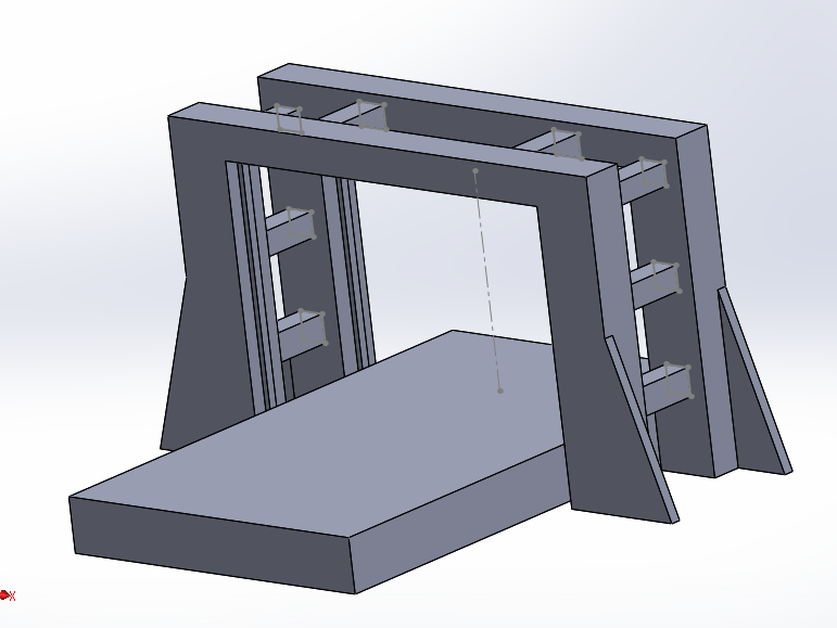

3 Attachment(s)
Re: Accurate Strong Gantry
silyavski
Now i am looking back at your gantry design. What size are the profiles, why 4, why are not connected each other? Whats your idea there?
I will go on with the Fix gantry system because it is properly fit to my goal -the moving bridge is a big advantage and present for me- so I am not restricted with a fix bridge height.
However I do not want to cut this line and leave it this way.-probably I will make gantry with this principle too.
Some draft are attached with the gantry base solution.
I prefer to save the expensive, vulnerable parts
balls crew rail , belt drive so I tried to hide them next, behind or under the frame -I belive this is the best place for them against the impact of
-work piece uploading
-chips
-coolant
The other view is to apply the roof trusses principle where incredible small profile in a certain arrangement can form a very strong element.
In my dwg the three SQtube run along he perimeter tying to each other with reinforcement plates.
It is a pity I cannot check and compare the different version with software so only suppose it gives big torsion resistance to the frame
Looks good but you might need a bit more triangulation. The thin gussets only work in one direction so ideally you need them in equal amounts in all 3 planes.
Why is there a bit gap in the middle?
What rails are you using? There are different types and some can handle 4 way loading and others cant so are best mounted on top of the rail. Espesially if you are using a heavy moving gantry.
The Hiwin HGR are double row bearing blocks and there is no difference how you mount them, so don't worry about that.
For a router HGR20 is enough and even a bit overkill, depending on the design. So no worry here also.
Ok, I'm a bit confused. You keep saying fixed gantry but then you show a bed with rails on the side.
Is this the bit that will be moving? If so I would have said that it is not the best way to do it. Moving beds should have the rails underneath and at approx. third points or a quater in.
That way the rails are supporting the load better and are closer together so you can get away with one ballscrew.
As you have drawn it the bed can bend in the middle under load.

Chapter #2 Fixed gantry
I am back again after aging some thoughts however I could not go too far. I cannot find too much examples for the ideal fixed gantry frame.
Probably I am making the typical mistake and try to reform something that is good as it is.
My viewpoints are:
using hot rolled profile -do not know but think it is better vibration damper than cold formed tubes (SQ or RECT)
using bigger cross sections- to eliminate the bracing and welding as far as possible
setup with 1700 mm total length-just slightly longer than moving gantry
My concern are:
-bolted connection as figure shows-is it is good enough- instead of welding?
-The spindle overhang is quite big -though is fixed in one direction . Is there a better setup to eliminate?
-I would balance the moving bridge on both side with pneumatic cylinders or gas spring that I red here and like this option.
As the spindle moves in Y direction the Center of Gravity moves with it -that seems not too beneficial for the balancing
Figure below shows mainly principles first to make a good machine setup
http://www.mycncuk.com/attachment.ph...id=14068&stc=1
Thank you for your comments and advice in advance.
To get the best rigidity you need to keep the spindle inline with the support bearings so no overhang. You could rotate the rails so they are mounted end on and in the middle of the beam.
The vertical moving gantry beam looks a bit slender with regards to the end bearing spacing. I would guess its 200mm deep and 1000mm wide? Thats is not a good ratio for racking and I would make the most of the gantry height and increase the bearings to maximum so the moving beam is like 'H' shape.
That would naturally reduce the racking and take the pressure off the screws and rams.
Just how I would do it anyway :0)
The spindle on a vmc has to be like that so the table can move. But the column is fixed and only the z axis moves. Don't get your designs mixed up, you have the opportunity to build some thing specific to your requirements so best look to optimise it.
If you want to get technical then you don't have to put the cutter directly in line with the bearing but you need to balance the y axis and put its centre of gravity in line with the rails as that will produce the smallest moment loading in the bearings and hence deflection.
I wasn't meaning to use a H beam but rather trying to explain the position of the beam relative to the vertical bearings, ie keep the beam 200mm deep but increase the bearing spacing To 400-500mm. Might need to draw something up.

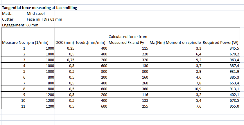

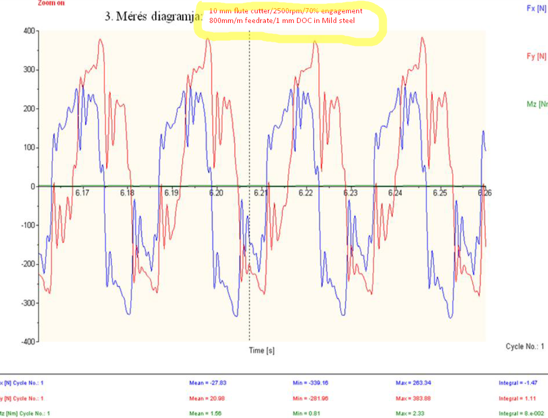

4 Attachment(s)
Ross77
Tried to catch the principle based on sketches but this is more complex and one detail can change the others.
Here are some slightly more detailed plans -the C/G is near the C/L of the horizontal ball screw so hope this setup works.
I have increased the bearing spacing-350 mm now.I do not think it is worse than a moving gantry since it has double Z screw. Forces on screws mainly come from the vertical feed force -assuming it about 200 N(??) while I would like to reach 1000 N machining force in the horizontal plane.
If something might be considered to apply one more shorter Z rail and +1 each carriage on both side-I do not know if it worth
Drilling only means center drilling in this machine and max 6-8 mm holes. The machining that requires Z force will be arranged in the middle zone of the table where the load is almost symmetrical on screws
Regarding to the profile I started to change them to bend opened ones from 6-8 mm thickness. All of them havv to be designed according to their function
By the way when I am taking about balancing I am thinking of the Z motor too. I want it to get relieved form beam mass. It cannot be balanced perfectly since the spindle is moving but I want to remove the dead load expect the spindle at least.
This vertical in-between railing makes me worry a little.
The implementation will not be too easy. At the moment I am planing to put together the Z frame from three bolted parts

My aim is to design parts that can be done by both DIY and machining method.
machine bad is Ok -it has surfaces to be leveled on top -preferably positioned on the same level-that is way stand the gantry leg here at the moment
Y beam is the same -can be done on both way
Z beams will be separated and bolted so it is similar to Y -I do not want to weld a U form and do something with frame -it makes my life hard
rather to make strong flange nodes and the careful assembly and adjustment will give the accuracy (especially the two parallel surfaces)
Nodes will be oriented and fixed with parallel pins.
That is only may plan for now -God knows nothing about it.
That design will be a night mare to build and setup which isn't required and will have no gain over other simpler designs. C channel is bad choice due to it being bendy/twisty in relation to boxsection.
I don't think you have really thought about the complexitys and realitys of building this design.?
The C section inner surfaces won't be flat so will need milling for the rails. Then you have the problem of making sure the uprights are perfectly parallel in 2 planes and perfectly perpendicular in the other.!! . . 99.9999999% Nailed on that you won't be able to weld this up and keep parallel/perpendicular in all planes.
Any surfaces that where milled flat and true won't be flat and true after welding so this will be a waste of time and you have no way mill when welded up.
There is a no provision for adjustment and the design is such that there is no room for any error to be taken out.
Boxsection will work far better and be much easier to setup or deal with alignment errors after welding.
The slight difference from ideal bearing loading which Ross suggested won't make any differance to the machine in real world performance or longevity but it will to your mental health and sanity when setting up.
Also the Uprights need far more bracing as any deflection here will show at the cutter and finish quality. Personally for best strength and bearing loading I would have double uprights each side of gantry with 1 rail on each upright and the uprights would be braced in 2 directions.
I feel If you go with this design you'll regret it come setting up time.!
JAZZCNC
vargai
First of all thank you for giving me a 0,0000001 chance.
This is a design evolution process with analysis, checking, listening to the pointers . I am not able to put a ready for production plan on the desk right now and I am patient and have time. Bad design leads to a better one. (in a good case)
This is still a study where I try to find the place for all the function.
Some detail explained in written form and never meant to weld this construction otherwise I would need medical treatment right now.
Yes, box section is better than C no question-even when equipped with bracing
For some reason I supposed that box section is more inclinable to resonate than a thicker opened one
The stronger the better so I am opened to the closed section
Just a sketch about how I understood double upright braced in two direction
http://www.mycncuk.com/attachment.ph...id=14153&stc=1
Now you have got me with that constant changing of the design. Why don't you like one design, stick to it and further develop it to suit your needs. If you liked the before suggested design from the video in post #41, then just see what is good and what could be bettered. i would suggest even contacting the guy and asking him if he were to make it again what he would change and what he liked. That will save you a lot of unnecessary trouble and give you invaluable real life feedback. Thats why people stick with certain designs, cause they are good and there is feedback.
I understand that the overhang of his design is bothering you, and it should be. Cause it bothering me. Not only the spindle, but the hole gantry overhangs. That kind of kills the good points of that particular design.
One thing from a design point of view people should understand is that the fixed gantry design we discuss here has one really strong point. I am sure most people don't understand this point properly. Its not that the gantry is fixed. Its that the rectangle it forms is very big so its moment of inertia is incredibly big. So when changing that fixed gantry design/where it forms a portal with 2 legs/ in any way that compromises it main strength is not a good idea.
Another basic point to understand is that all rests on a couple of bearing blocks in all 3 different coordinate planes. So no matter how strong you make the machine frame, the bearing spacing, placement and forces there will form the real weak spots.
the purpose of the strong frame is to hold enough for the forces. next purpose is to minimize bend and twist which leads to minimizing vibration.
What people fail to understand, i see it here and in the other forums, is that the machine frame should be sturdy to a certain point and then the aim should be to be integral. No need to make 1 ton machine when same could be achieved with integral 200kg one.
Sturdy machine that is extremely rigid will ring like crazy if not integral. So thats when all make them heavy instead of making the design integral.
By integral i mean designed so that all forces spread equally, neutralize themselves and no weak spots and overbuilds in any direction possible.
Thats why there are some principle designs that all use, cause they are integral. Not that always people take full use of the possibilities with that design.
I assure you that a properly designed L gantry will beat any day the fixed gantry design if its not properly designed.
And IMHO after playing a lot and rethinking all designs and reinventing the wheel, my conclusion is that if all things taken into account we must not forget that we usually use only 2.2 -3kw spindle, using only 6-12mm bits, so we should not forget the strongest point of each design and choose it when needed, cause at the end they will all work if made properly.

I have downloaded some kind of study about machining force and my
goal on 1000 N is not oversized requirement. I hope I can use max DIA 10-12 mm with moderate technology and dia 30-35 face mill on same way.
The machine will give the right answer and I will give a "reluctant" acceptance to it. I do not care if some work take a while since I will use this machine on one off and small batch production. With good strategy and preparation I even can compensate it but not bother if not. I have a day time job so it will be a free time profitable passion.
Regarding the design I am rather analyst type and it is important and challenge for me to see the theory behind the result.
Everything happens according to some kind of theorem and if one catches the rule then catches the physical result.
So thank you for your help in advance.I still have to adjust my plan a bit and revert it later.
I use Solidworks but the estimating the elastic deformation (strength ) would be a big help too.

2 Attachment(s)
Ross77
Could you post a link to that cutting data? Some quote the force required to cut the material and the tangential force seen by each axis can be much lower. Those figures seem a bit high. Unfortunetly all my reference material is on my old pc so will have to dig it out.
What spindle do you plan to use? To a certain point the more powerful the spindle the lower the cutting force.
Thank you to correct me. I have just referred to it by heart and of course do not want to propagate false data
Here is the link and it says 40-50 N
http://www.ijens.org/103004-5151%20IJBAS-IJENS.pdf it is talking about HSM milling but use 1000rpm for this test ??
200-400 N is from a college measurement protocol where the matl is mild steel
the first is 10 mm flute mill
http://www.mycncuk.com/attachment.ph...id=14288&stc=1
and the follow is face milling in mild steel
http://www.mycncuk.com/attachment.ph...id=14289&stc=1
Sorry for digging too deep but I am confused about the new present day parameter used in Ali.
At my former job we machined Ali 20% of total and used empirical values in technology heard from colleagues and the owner of the shop. On that Hurco VMC we used max 4-5000 rpm (4-12mm 2 flute cutters) and as I see this is the lowest on router. Could you tell some practical values according to table above? It is not complicated but I am not confident in machining calculator but more familiar with practical data.
