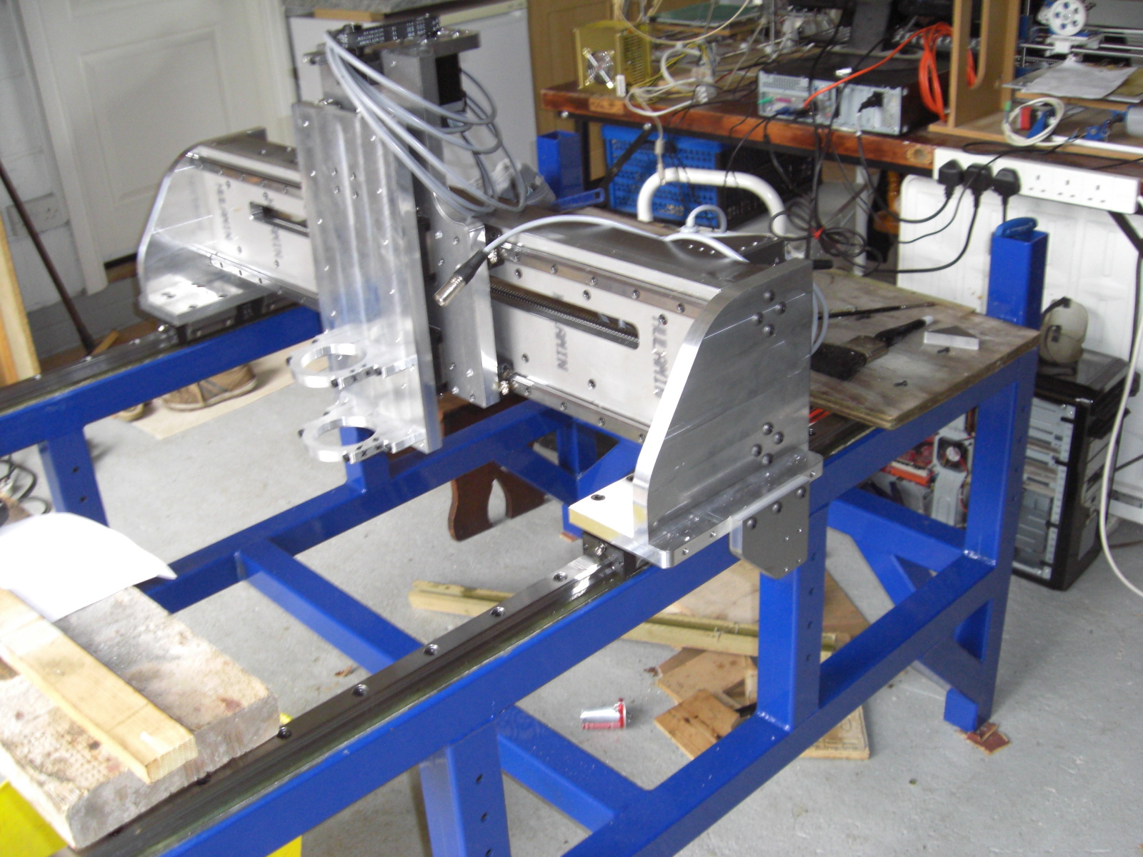

Have you considered whether the fault lies with poorly mixed resin? The cure is a polymerisation. If the relevant components aren't available in sufficient quantities, the density of the film may change, leading to variation in final thickness?
Epoxy resin tends to be quite sensitive and there's little mention of preparation in this thread.
Using a good set of scales will ensure the right amount of resin and hardener is used. Really important if you want to resin to perform per manufacturers specifications e.g. hardness
Mixing. Spend at least five minutes mixing before use. Hand mixing is fine, an electric mixer is easier, but a slow speed. Avoid mixing in air. Once you have mixed for a minute, use a pop stick to ensure the resin sitting on the side and in the crease of the cup is integrated properly. Mix for the remaining four minutes. Once the batch is mixed, poor into a separate cup - leaving a little behind, so as to avoid any un-mixed resin transferring across.
The surface to be coated needs to be clean and dry.

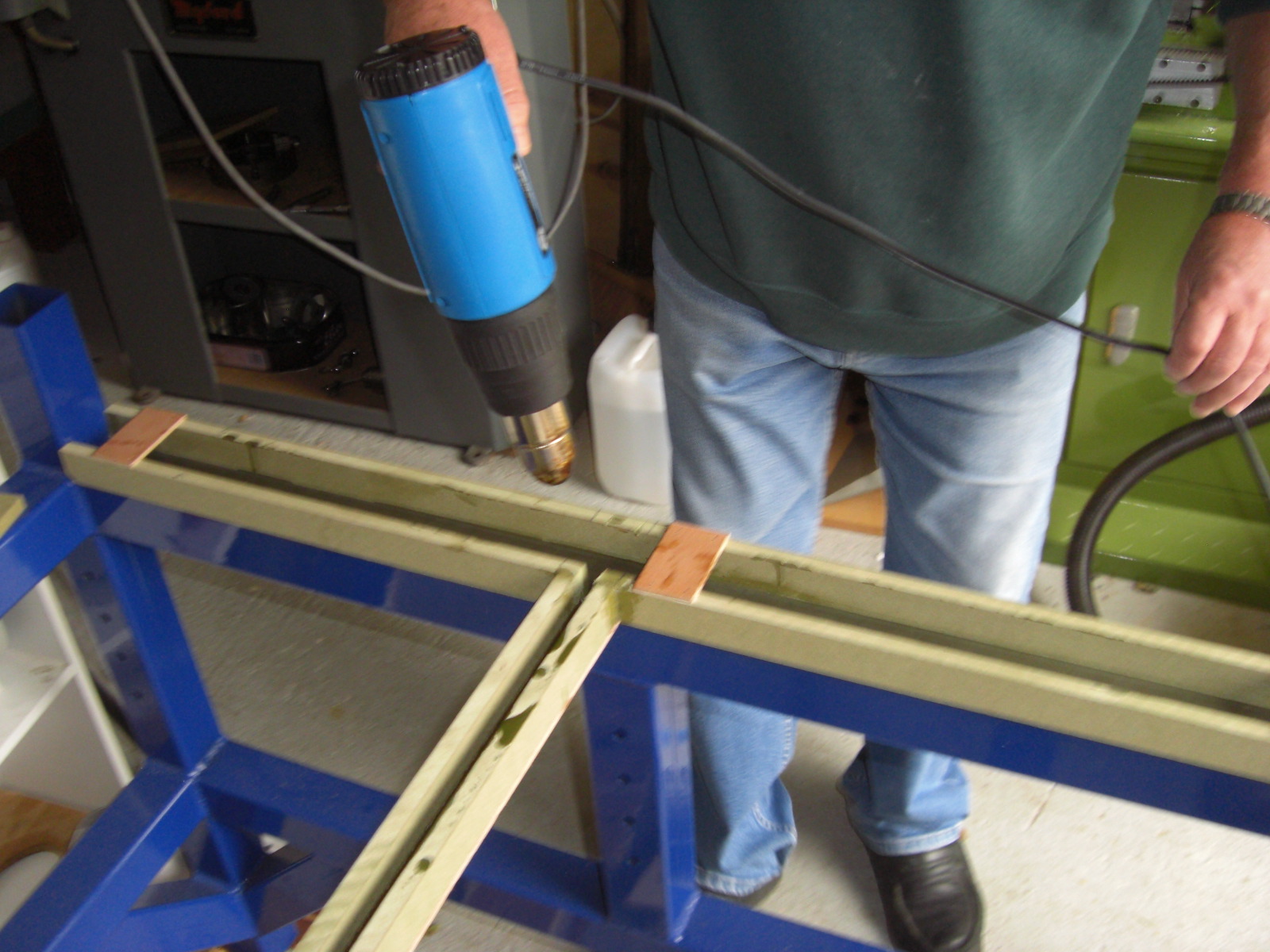

The video was helpful in some respects. Personally, I wouldn't put a heat gun near epoxy without wearing a mask - air bubbles or no. But he's right epoxy loves heat and it does affect the viscosity of the poured resin. Personally, I'd lift the temperature of the resin prior to mixing using a water bath, especially here in the UK. I'd also be more interested in ensuring the ambient temperature of the room remained constant - especially in a hot climate.
I understand the target thickness for the film is 3-5mm. There's no reason why this need to be done is one pour: http://www.westsystem.com/ss/epoxy-chemistry/ A second layer can be applied once the first layer has started to gel, sufficiently. This might well be the best approach, assuming the underlying cause is human error
I'm not entirely certain what steps are taken after the film has been applied, but if the variation remains say 0.3mm i.e. human error is not a factor, could a high viscosity resin/compound then not be used to seat the rail? I believe that what is taking place here? http://www.moglice.com/ . You'd need to wait around a week before seating the rail. Ambient cure epoxies take a while to reach a state of final cure, which could be a problem, as you don't want an ultra thin layer of epoxy being exposed to pressure, when not chemically bonded to the layer below .... all my epoxies are heat cure, so I'm not in a position to run any tests. So lets hope its human error and applying two layers to create the desired thickness produces a lower error rate.
Oh yes. Vinegar is a good solvent for any split epoxy.
Personally, for this job, I'd been thinking about urethanes - but I'm not any way near needing to do this yet.

-heating too much/too slow pass with the torch/
-making more than 2 separate passes /leads to orange peel/
-heating from different angle,not trying to be 90 degree with the torch
-heating too much the dams if they are from plastic
-accidentally heating the bridge more than the epoxy mixture

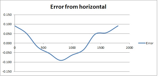

Sorry Boyan but who's lieing to them self's if they believe they can measure to 0.01mm accurecy over 3000mm length.!!! . . . . . Yes Epoxy method works OK and easy when done correctly but anyone is fooling them selfs if they think there going to get accurecy down to the Hundreth's MM's over such length and width.!!
Thou as they say in Yorkshire " Proof is in eating the pudding" so when your machine is finished let us know if your machine can surface two faces parallel to each other across it's full length & Width then surfaces hold ONE hundreth millimeter parallelism over the whole length.? . . . Then I'll be impressed and Don my Flat Cap to epoxy and You Sir.!
Re: Use of epoxy for levelling

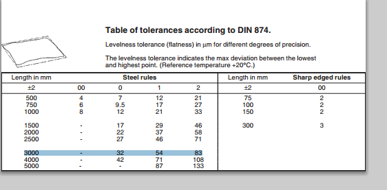

Its relatively speaking. I did not mean to brag or mislead, just to encourage and lay down the points that should be followed to the letter, if one wants to achieve what could be achieved at home.
Yes Dean, its more like a wishful thinking. Of course it could not be measured, especially at home. I agree its not real 0.01mm. Maybe even not real 0.05mm at some places. But may be it is between 0.01 and 0.05mm if lucky and done right/. I was able to discover bigger than 0.05mm gaps using the edge and strong led torch.
Lets say i am happy when with the straight edge i could not find a spot where it did not look perfect and tight fit to the edge. Thats my criteria for straightness for my machine. Obviously on a 3000mm travel, that's something, when done right and at home.
Having in mind that the straight edge itself is not so straight over 3000mm , table below, that on paper it should be supported/handled at a special length for the measurement to be right i would say there is no way that something could be proven right or not.
That means though that there is still a small chance in a million that in fact is that straight. :joker:. Who knows, when its not measurable. :hysterical:
So i say, better do things right with the idea that all must be perfect. Yeah the result may not be. But what would happen if one even does not even strive to do it right.

When thinking about the issue last night, I had in mind UK conditions and the tendency, recorded within various logs, to complete this task at below 25oC i.e. circa 10oC. This is relevant because as a general rule of thumb, a 5 degree F increase in cure temperature will half the time taken to cure, which is a thought I'd like to carry forward.

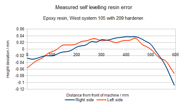

Per Jonathan's data, the suggestion must be that even with careful construction and preparation, the process retains a relatively high error rate, when compared to the required outcome. My addition is to suggest that the impact of the error rate, regardless of cause, could be halved by taking a two pour approach. I think that's relatively sound logic. But that not good enough.
However, as per the original posts #1, it took 72 hours to reach a state whereby it was possible to mark the epoxy using a finger nail i.e. the epoxy was still in a very plastic state at this time. So I am thinking, is this not the time to be thinking about mounting the rail?
The sort of procedure I have in mind is detailed below, but then I don't know how long it takes to mount the rail accurately? How much tinker time is needed?
Broad brush, the process would be as follows:
- Set up a bench test for the epoxy you are using. Dam an off-cut from the material used to make the supporting axis, circa 30cm in length?
- Before testing the epoxy, measure the ambient temperature, it needs to be below the manufacturers recommended cure temp, let say 15oC instead of 25oC. This provides for a much long gel and cure time.
- Mix and pour. One layer or two, depending on your view.
- Measure the hardness of the epoxy at regular intervals during the cure. A cure schedule can be drawn up based on the manufacturer specs in any event. Once it becomes evident that a thumb print can be made, start measuring the hardness of the cure by dropping a ball bearing from the same height and recording the difference in the diameter of the depression made.
- At a point to be determined by the dropping of the ball bearing i.e. while the epoxy is still relatively plastic, seat the rail using pre-drilled placement holes.
- There is where there is a balance to be struck, or not, depending on tinker time and ambient temperature. The rail needs to be seated on epoxy that is able to resist the the weight of the rail, but unable to resist seating of the rail when lightly bolted into place i.e. such that there is insufficient upward force to cause a deflection in the rail at the mid-point, between the two bolts.
Clearly it would help to run this experiment a few times. Removing a test sample isn't an issue.

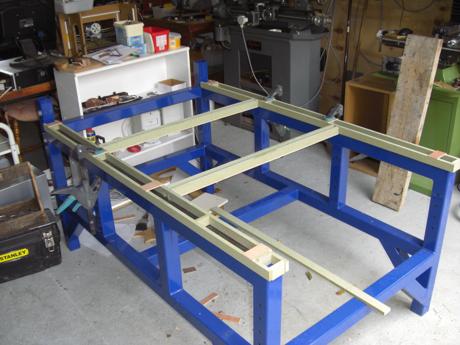

3 Attachment(s)

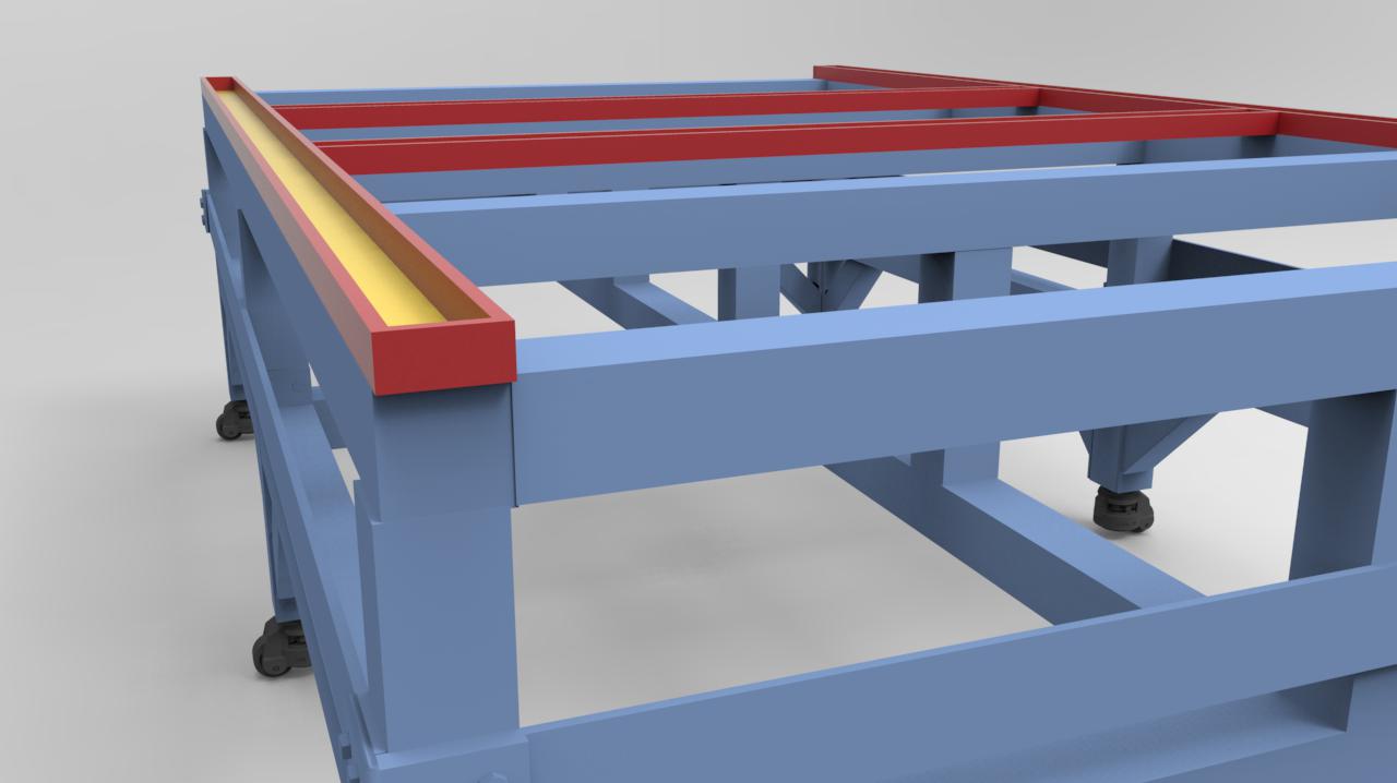

http://www.mycncuk.com/attachment.ph...id=14890&stc=1Ok This has all been said before. The system I used is this http://www.westsystem.com/ss/209-extra-slow-hardener/ this is the pdf. http://www.westsystem.com/ss/assets/...%20105_209.pdf
It is very important to measure and mix well. it is important to make the moat water tight as any small leaks will spoil the job. I used a thin bead of silicone all round the inside edge. Just make sure that the frame is least at about 18C .
Mix the epoxy with a flat paddle ie not a round dowel and mix well slowly so as not to introduce air into the mix then let it settle for a couple of minutes. If you have another prepared container with a hole near the bottom about 6-8mm with some tape over it you can then pour the epoxy into the prepared container.
Then take the tape off the hole and let the epoxy pour from the hole into the moat. (this will get rid of most of the air as bubbles rise and you are pouring from the bottom)
http://www.mycncuk.com/attachment.ph...id=14888&stc=1http://www.mycncuk.com/attachment.ph...id=14889&stc=1
Don't just pour all the epoxy in one place but try and get it even all the way round. Then if you see any big bubbles you can just flash them with the hot air gun they instantly disappear. (you are not trying to heat the epoxy up it is a quick flash)
The epoxy is almost like water and will flow very easy.
Rich There is no way a soldering iron will stop the surface tension miscues thing from happening all around the edges of the moat AND around any bolts you have put in.
When the epoxy has cured at least a week then remove the moat sides etc and with a rasp bastard file carefully remove the miscues. If you are using 20mm rails you want the moat at least 40mm wide (mine was 55mm)
I used two dams from one rail to the other and was more than happy with the result.
This has all been done to death and is not rocket science I think in a hot country you may have to be a bit more careful. The epoxy may feel hard to touch but DON'T play with it until at least 7 Days have past and has been said already make sure that the base is clean and oil free. You can rub some oil around the inside of the moat edges to stop the epoxy sticking to the sides (make sure it is sealed first though). ..Clive

Let me respond instead.
It achieves the level of accuracy of your straight edge + your intention of accuracy.
You need a straight edge that should be at least as long as your machine is wide, to check the result and later square the gantry. Your intention of accuracy will help you see small mistakes if any and using shimming and checking against the edge will help the desired accuracy. Anyway you will need the edge to mount the rails straight in the other direction. The more accurate you want it to be, the more you will check and adjust and generally the more time it would take you.
For an example i did 3 separate pours of epoxy on my 3m long rails, when happy with the epoxy i mounted and dismounted 2 times the left rail and 4 -5 times the right one until i was happy. It took a week with helper, only adjusting the rails. The only reason to do that was because i will use that machine to surface other smaller machines and gantries in it and not mess in the future with epoxy :black_eyed: if not building something huge. If this machines purpose was not meant for that, i would have shimmed the first unsuccessful pour and finish with that stage.
So if you mean all day doing precision aluminum milling is one thing, other thing is if you do all day wood.
Even so, the bigger the machine the difficulty to achieve precision multiplies. It not only the epoxy, it how many times you check all and if you take your time to repair all that you have found.
Its difficult to explain but at the end the precision of the machine depends how precise are you or how precise you want it to be. All else is means and ability to achieve it.
At risk of repeating myself, the error I got with the epoxy was exceedingly small (according to my surface plate) - the large deviation you see at the end of the graph was caused by the bearing seal/lower surface rubbing on the aluminium epoxy boundary. That error went once the rubbing problem was alleviated. The other graphs with large errors were false readings caused by accidentally measuring roll not height. I'm not mentioning values here lest they taken out of context - see the original post for a proper explanation.
I heated the resin in a water bath before pouring. It clearly lowered the viscosity, but I can't comment on what effect this had overall as I have nothing to compare with.

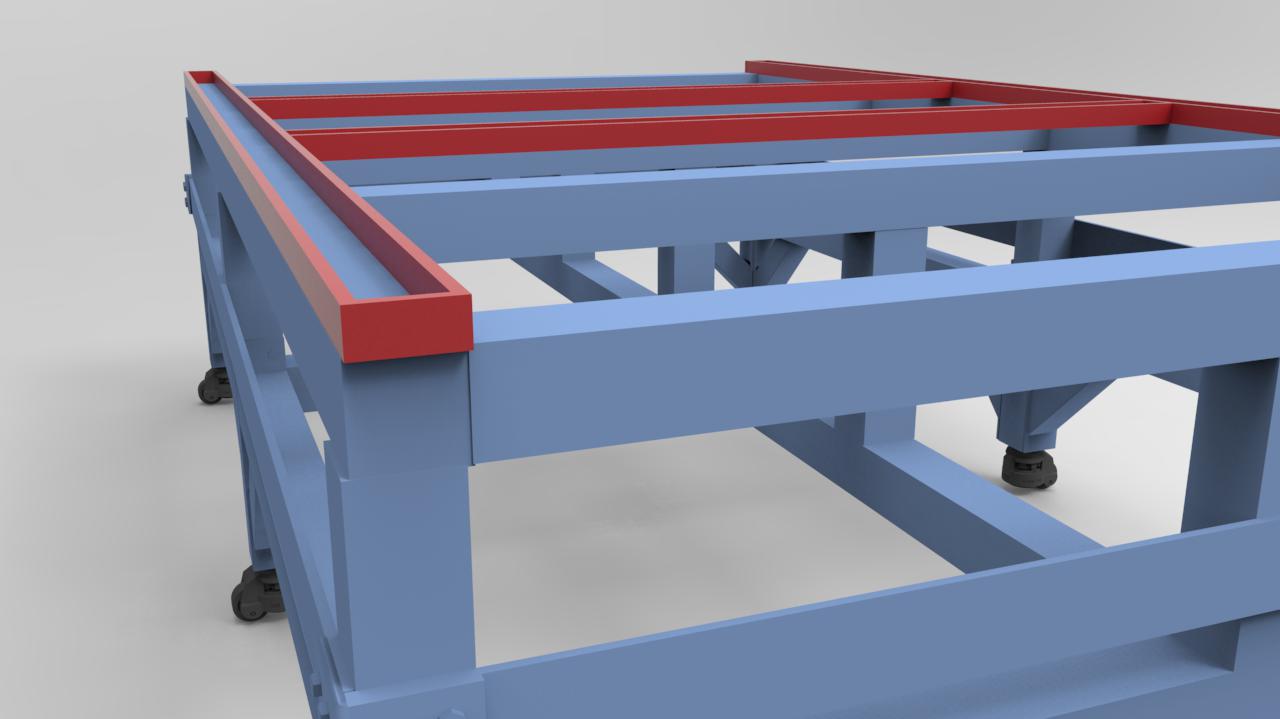

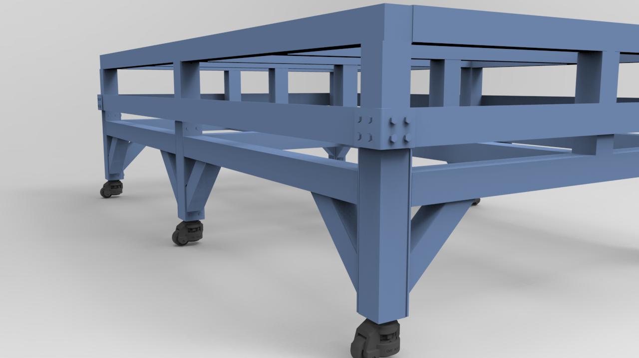

5 Attachment(s)
so in theory i should get the frame as level as a human can by hand using adjustment castors on the feet, then once thats as level as you can get it i then place the dam ontop of the frame (im using 25mm rails so my dam will be 65mm wide) then pour epoxy into the dam and let it level out then wait for about 2 weeks (to be safe) and then i can now bolt my rails ontop of the epoxy assuming its flat level?
cheers
ash
http://www.mycncuk.com/attachment.ph...id=15938&stc=1http://www.mycncuk.com/attachment.ph...id=15937&stc=1http://www.mycncuk.com/attachment.ph...id=15936&stc=1http://www.mycncuk.com/attachment.ph...id=15934&stc=1http://www.mycncuk.com/attachment.ph...id=15935&stc=1
I doesn't really matter if the machine is not level on the floor as the epoxy will level out like pouring water into a channel it will find it's own level. What is important is that you do not have any leeks in the moat I put a very thin bead of silicone all around the inside.
You will need it about 5mm thick. If you use MDF for the moat after the silicone you could put some Vaseline on the insides of the moat to stop the epoxy from sticking.
thanks clive, do you mean the silicone has to be 5mm thick or the epoxy? i was going to use about 5mm anyways for the epoxy if so.
cheers
ash
reefy86
cheers
ash
The silicone is only to stop any leeks so a very fine bead between the MDF and box section. Iff you have any leeks the job will fail:devilish:
