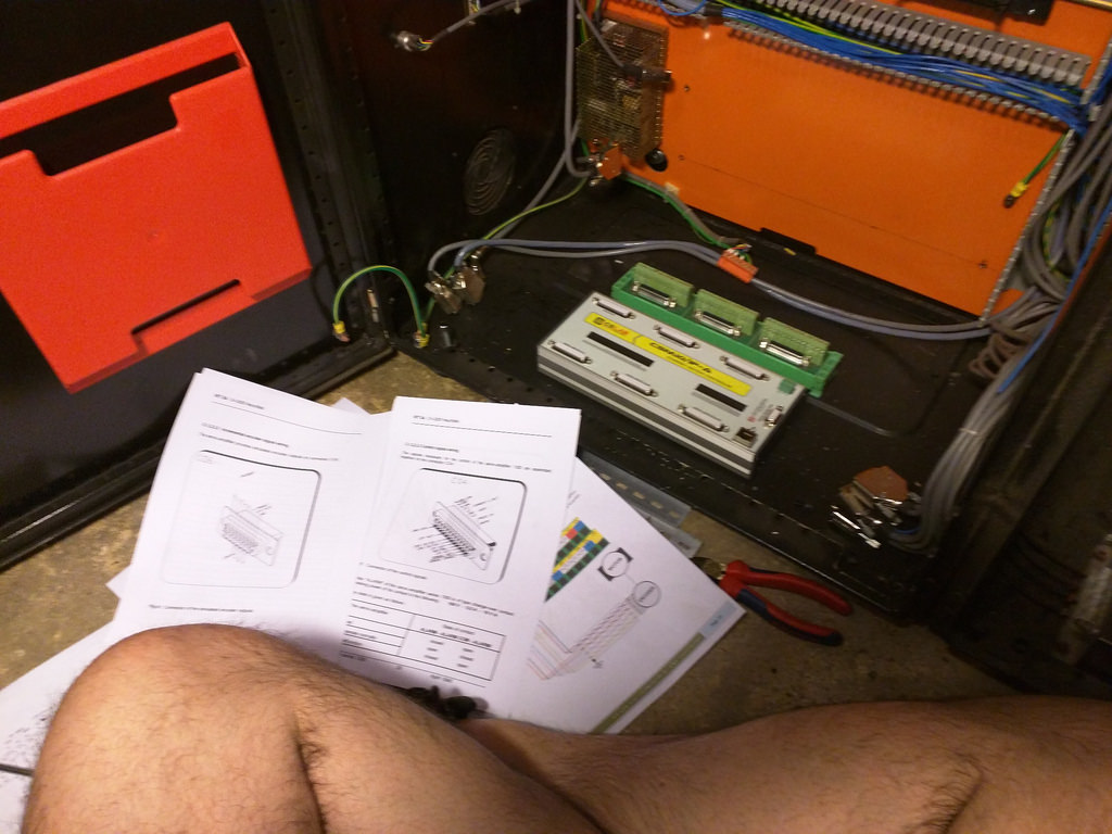

Thanks. How do I do this isolation?
The CS Labs mentions this, is this the same thing?
"Another important assumption was simplicity of installation. CSMIO/IP-A does not require any external electronics for proper operation. Inputs/outputs signals are inside optically isolated, filtered, protected against short circuit, overheating etc. Of course, all I/O signals are adjusted to industry standard 24V. The device is enclosed in a compact cover, mounted on a DIN-rail, what makes that mechanical and electronic installation in a control cabinet takes less time and is even simpler. "
Either way can be used, 4 and 5 or 5 and 7 depends on the application. When the tacho option is used 6 and 7 are used for this and 4 and 5 are used for the spindle run, if yours is wired that way use 4 and 5. The guard relay will be in the circuit to limit the operation of the spindle if the cover is up, but the sgr would still be the relay that connects 4 and 5 on the sprint board.
PS. sfr may have replaced sgr.....edit...... Looking at the other photos sfr has replaced sgr, and common practice with denford machines is to control the relay on the ground side. To the left of the sfr is the srr, this reverses the spindle by changing the polarity to the motor.

A bit stuck at the moment. Have wired in the Y encoder but a bit of confusion about whats needed next. I know I need 0V and 10V Ref but a bit confusing as I also have an enable option. Going to power up now and see if I can get something moving, still need to config the CS Labs and install Mach, so still a bit to go yet I think before I can get anything moving.
I managed to get 110V, need to see whats holding out the main contactor now, must be an E stop or similar.
Connect the enable on drive to an output on IP-A and set the Enable 1-6 Output in Mach3 to port10 pin(which ever used). You can connect all drives to same pin to save outputs if you like.!
This will enable the drives when Mach is Reset and disable when Mach isn't.
If you want an extra layer of safety then run this signal thru your E-stop relay. So Enable can only happen if E-stop not pressed. This way the Axis won't be enabled even of Mach is reset( Which it shouldn't if E-stop is done correctly)

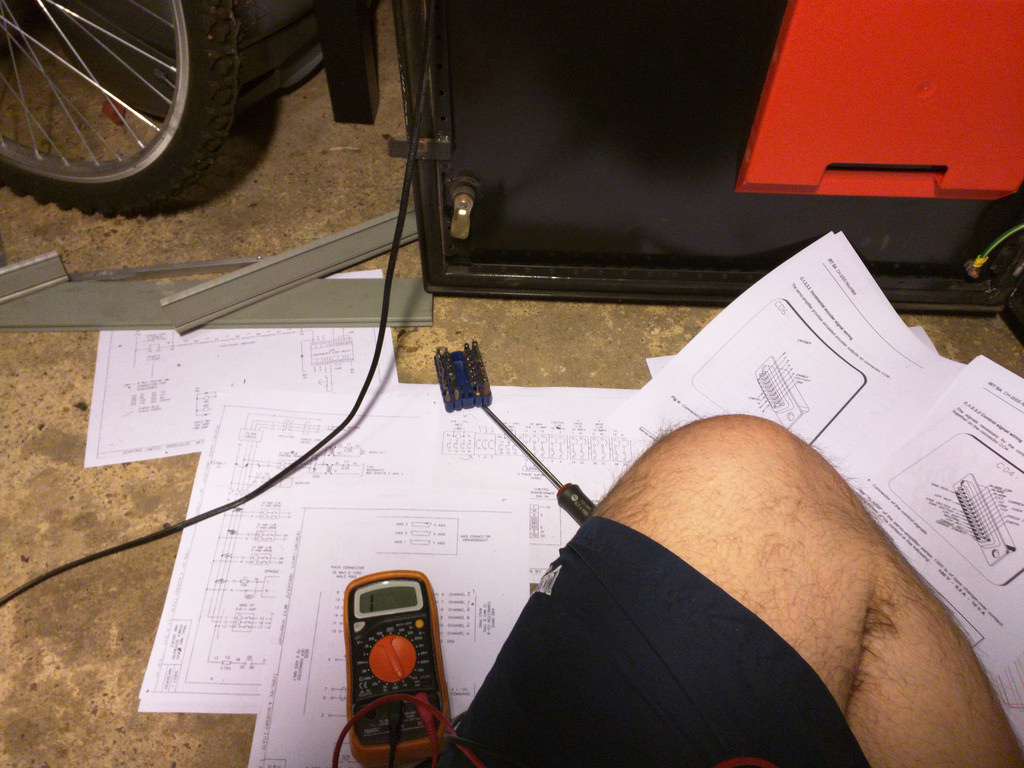

Can I double check something, for the 0-10V Analog input, this shows using 1 and 14 for the first axis. On the pic below, the left hand side is the wiring of the drivers.
Is VRef- 0Volt or something else?
I assume VRef+ is the 'up to 10V'?
Are my red lines below correct to show how they should join?
http://www.mycncuk.com/attachment.ph...id=15600&stc=1
Ok well kind of right but your needing ANALOG +/-10V OUTPUTS for the Channel(axis) your using.! . . . It's not 0-10V ANALOG INPUTS they are very different things.!!
I realise you probably know this but it's these little details and wrong INFO back to us here that can get confusing and you in BIG trouble if we do and your letting out Magic smoke.!
Vref - = Negative Voltage ie: -5v = right direction at half Motor rpm
Vref + = Positive Voltage ie: +5v = Left direction at half Motor Rpm
Manual will show you which pins are for Negatve and Positive for Each Channel(axis). Careful you don't Mixup the GND because the Channel GND's are different to Analog input GND's on same connector.!

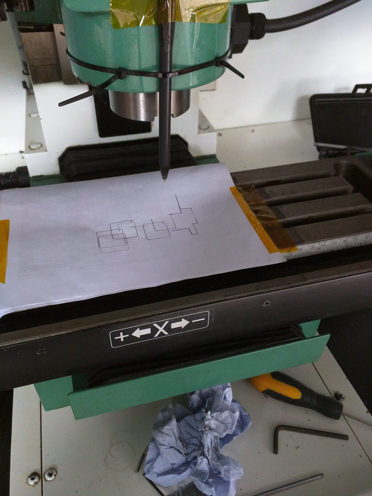

OK, X and Y are working, inverse direction but I can do basic G Code. The measurement however is 3 times too much. Have changed the steps / mm value in Mach3 but no difference. Its doing a 60mm square instead of a 20mm.
Something not right with Z when I connected it back up.
OK, I hadnt saved the steps setting. Sorted now, very close to spot on but still having issues when I connect Z. Without Z, the machine will work fine even though + - are reversed (according to the stickers on the mill). I tried to get Z to PID tune but its not happy and the mill starts to move the other axis without me asking. Odd. Not sure if I am getting some cross talk on the wires, ive checked all the wires a few times.
So, this might not look like much, but i can draw with some gcode.
