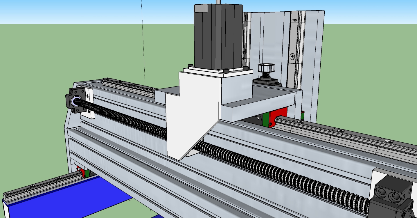

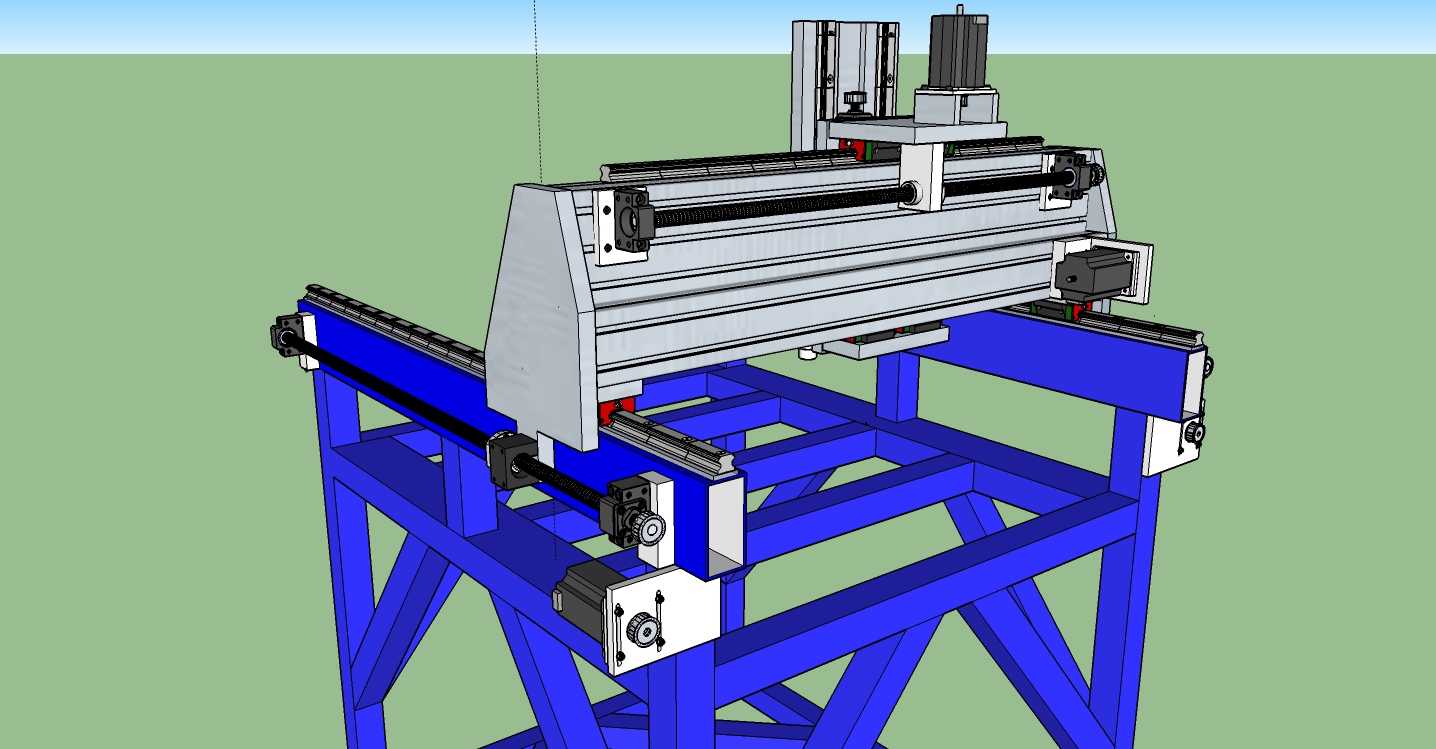

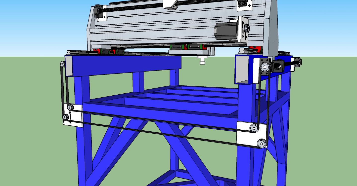

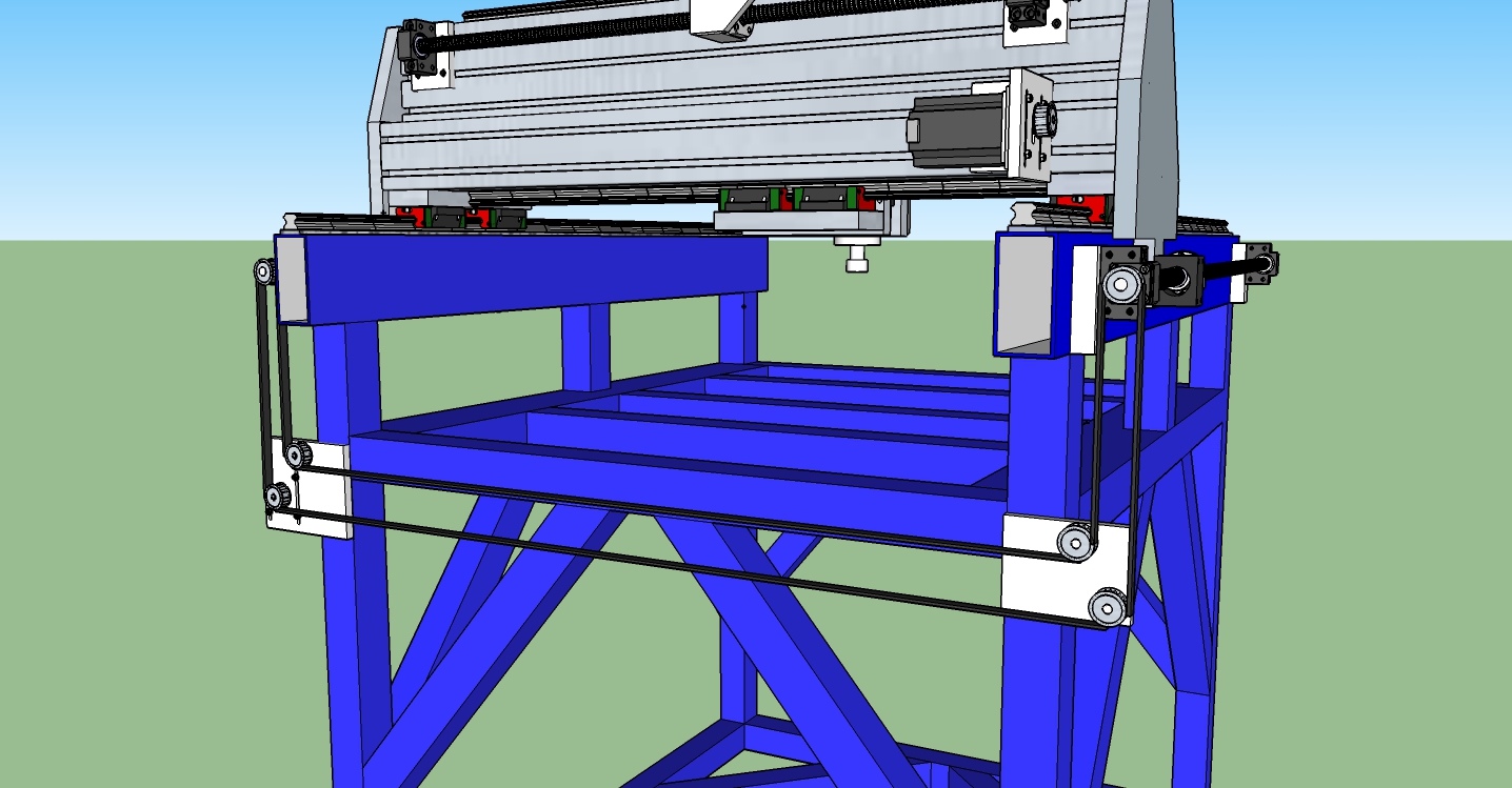

Thanks - lots of really useful info. I know a lot more about limit/home switches now.
So 3 switches it is. Based on the above, I cannot really see why you would want to use separate home switches - unless you want some very special home position?
And let us switch tune:playful:. I have updated my model with a single Nema 34 motor for the Y-axis and an adjustable mounting flange, as suggested by Silyavski. Is 20T pulleys/idler pulleys ok for this, or should you choose larger ones?

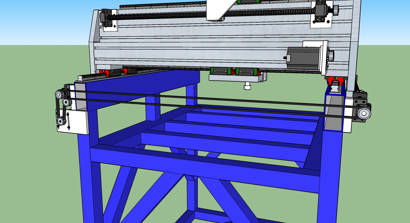

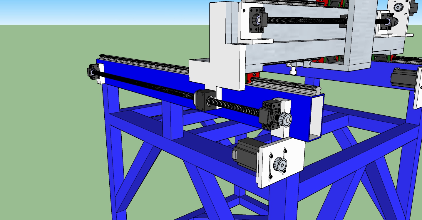

ngundtoft
Yes they will be fine arranged like this with nearly half the teeth engage. Don't want to go too large other wise the extra interia starts to affect things.

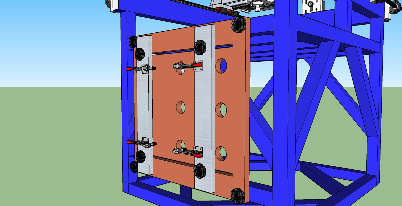

I have been thinking about how to design a holder so that you can route dove tails at the end of boards.
This is not a function I will be using every day, so it should be simple and it should not compromise the machine in other ways.
I read the thread by EddyCurrent and how he has done it. It looks good and stable and I am sure it works very well.
However, I dont want this function to interfere with the precision of the bed, so I am not too happy with the removable plate. Also, for handling, I find it somewhat impractical to have this opening in the middle of the machine. All that is needed is a jig that will hold the work piece in an accurate and repeatable position. So I was thinking of placing it at the end of the machine, as shown in the model. You simply fasten the work piece with one or two clamps. I may have to extend the cantilevers/ rails to get sufficient overhang for the spindle or alternatively reduce the length of the frame, since this machine is already getting fairly large.
http://www.mycncuk.com/attachment.ph...id=16169&stc=1
Re: New build input/comments appreciated
I remember Jazz showing (it had a red frame I think) a design that did just this, it could take panels etc on the front to rout the ends. This is one thing that I'd on my list for mk2.......

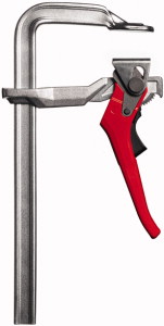

Something like this works well for holding boards on end.
Slots with Pockets on backside.
Attachment 16170
Thanks JAZZ. This is actually a brilliant design. It is simple to make, it can be removed from the machine when you are not using it and the width it can accomodate is adjustable.
The only thing that may not be optimum is the thickness of the material you can clamp. I remember using this type of clamps (although much smaller) and the reach is not so big. I tried to find the reach for similar types. I only found this specification for a single one and it was 3". I am not sure if that means it will go from 0 to 3" or if it is just the maximum. Maybe you can use this type of lever clamp instead (although they are quite expensive):
http://www.mycncuk.com/attachment.ph...id=16171&stc=1
Excellent start !
One point.

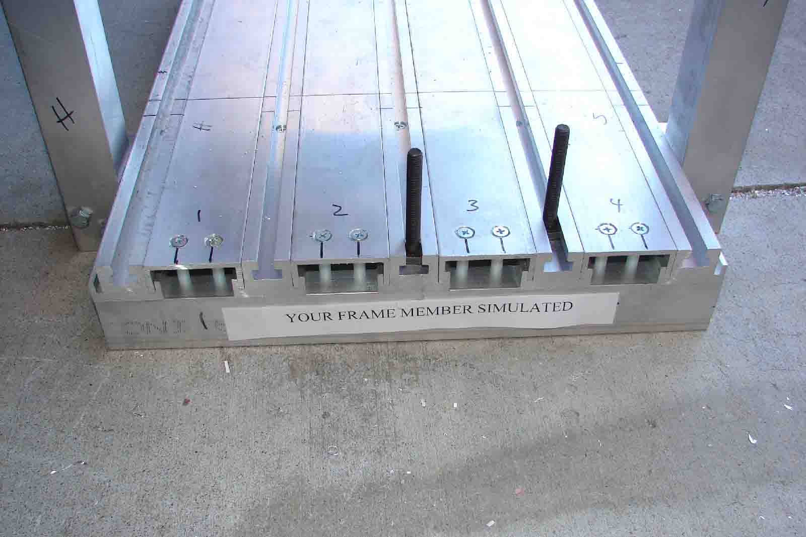

A tiny nema 23 stepper, on my machine, moves my bed mill, effortlessly.
The bed is 1600 mm wide, 60 mm thick on ribs, tool steel.
Mass is 200 kg, with upto 200 kg of stuff on it.
The "right" way to do it is drive the moving bit at 1:3 with the stepper with HTD belts.
This provides better overhead, much better acceleration, better accuracy, and about the same speeds.
If nema 23 steppers dont work, get ac brushless servos, at 130€ each, or 290€ for servo motor, driver, cables, encoder, everything.

A small update to the dovetail jig. Since you can easily remove the vertical braces, I figured that you could just clamp thicker things directly to the base plate with clamps - same system as used in the Festool worktable (you can use the same clamps). If you are normally routing items that are not so wide, you can also have one of the vertical braces fixed tightly as a fence to ensure that the work items are perpendicular to the bed.
http://www.mycncuk.com/attachment.ph...id=16174&stc=1
If it was me I'd have a combination of 3 things.
#1 Clamps as shown.
#2 Matrix Grid of Threaded holes for clamping Odd shapes with mill type clamps.
#3 several larger holes for Festo type clamps for deep items.
Oh and I forgot to say I'd get lift those bottom rails up about 75-100mm to create short stumpy feet for levleing and lose 2 of the diagonals wich are not required. Less welding, less chance of heat distortion.

Yes, good idea JAZZ. Some holes with T-nuts would increase the possibilities for fastening things.
One of the things you'll probably use in vertical position is lower bracket or shelf like setup to help support and locate material when clamping. This makes repeat work like dovetails much easier and the Thread holes come in use full for things like this so I'd take them all the way to bottom.

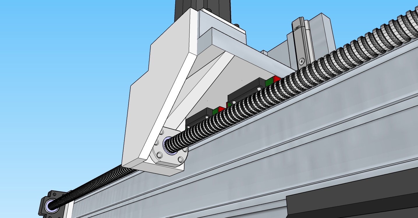

It seems I am getting close to having a mechanical design that will fulfill my requirements. However, there is still one point on my list that I need to look into. I would like to have some kind of adjustable bed. I will mainly be working with wood, so I think an MDF plate will be sufficient for that, and also with wood the fairly long Z-axis will not be a problem. But for aluminium I think it will be good to lift the bed for better stability. This bed could be smaller and also have provision for clamping the work material.
Something like this:
http://www.mycncuk.com/attachment.ph...id=16184&stc=1http://www.mycncuk.com/attachment.ph...id=16185&stc=1
If anyone has come up with a mechanically good construction for raising/lowering the bed, I would love to have some info/links.
