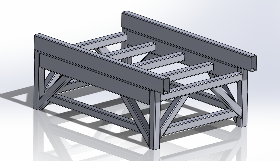

Noticed that I might have some difficulty cutting the motor mount slot accurately on the gantry side, so made it a separate adjustable support plate allowing for the Y axis ball screw to sit more central, more adjustment and lets me get started on welding the gantry before getting access to a mill :nevreness:
Attachment 17667Attachment 17669Attachment 17670Attachment 17671Attachment 17672Attachment 17673
I am going to start welding soon and have next to no experience with this so hope you guys can keep me right:
Attachment 17674Attachment 17675
1. Whats the best way of handeling this, tack up the full frame whilst checking squareness and then weld up fully when happy or do it all in sections?
2. I read on here that short runs are the way to go. Would a 50mm single run along one side of the 50x50 box section be ok or do I do this in two separate runs (25mm)?
3. Are there any parts of the frame I could stitch weld? Maybe the x axis rail support and all of the gantry/side plates? If so, whats the typical size of weld and gap between stitches?
4. Any tips on this/recommended welder settings?
Re: First time build - Steel Frame CNC Router
Mig? Arc? Tig? What sort of welding?
Yes, always tack up first, when choosing where to weld, always think of contraction - the two sides of whatever you weld WILL be drawn together as the weld cools, no two ways about it, it will happen.
On a box frame I would tack up and check all square, then weld the inside 90 deg angle on opposing corners first. Next I would do the outside edges followed by the two faces. Welding the inner/outer sides first should help resist the tendency of the frame to buckle if the faces are welded first.
Test your settings well on scraps first.
Stitch welding is fine, in the right place - if you were welding a plate to the side of a box structure or maybe a corner fillet plate inside the legs, I would stitch, maybe 1" runs. For something like box section legs then seam welding is in.
Think of the stresses the part will encounter, it will help decide how to weld it.
Thanks Davek, I will be using a Mig welder for this. Should have the steel in this week and welding started this weekend.
Will tack up the entire frame and gantry assembly first and check if its all square, once OK I will fully weld/stitch where needed whilst baring in mind contraction.
Is epoxy leveling recommended for a build this size?
The chances of it being square when done are slim, treat it as sections and concentrate on getting each section as perfect as possible, whatever method you use there should be a method of tweaking the fit later - my plasma table is 1500 square, it is made up of two side frames bolted together with cross-tubes - i could shim the joints as needed which wasn't in the end but handy still.
The plasma was built in 2mm box section but carefully braced where needed to gain rigidity. I used about 21v / 140A and 0.8mm wire with a tri-mix gas (hobbyweld5) you need to get hot and fast, don't run the power low because it might warp.
Cant help with epoxy, never used it I'm afraid.

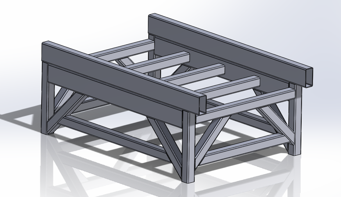

Been a nightmare finding a local supplier that does box section without a 7.5mtr minimum order charge, but got one eventually who can do me some off cuts at a 3mm wall for a good deal.
Will the 3mm wall thickness box section be OK for the bed support beams and horizontal supports shown below in green? Will it also be OK to weld?
Attachment 17786
examorph
Attachment 17786
The main problem apart from resonance with 3mm box is that it is not quite thick enough to tap 4mm or 5mm would be a better option. If it is just for the green bits then it is probably OK
