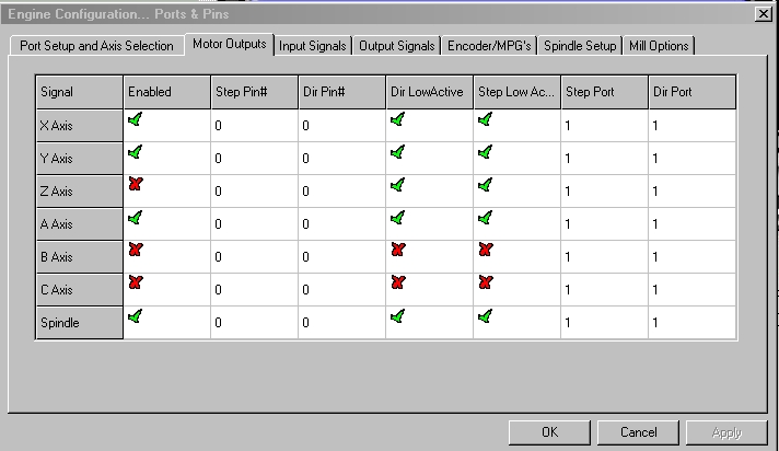

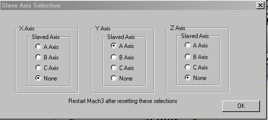

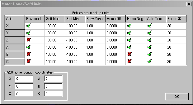

AFAIK some external motion controllers do not support axis slaving.
So it's not Mach.
I am starting to think that maybe this board is one of those.
I have checked and double checked the settings, and although I can get each axis to move independently I cannot get them to slave.
I have added some images of my settings. The motors all work with these settings, but no slaving at all.

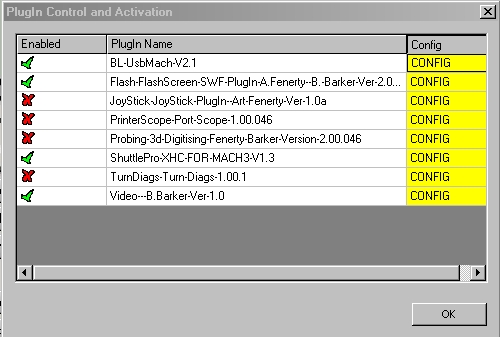

Re: Missing information for Mach3 settings
It's common for external motion controllers to move these options into the plug-in so have you gone into the config plug-in settings.?
You will find this in Config Menu under Config plugins, then it opens another window showing all the installed plugins, click the yellow config button which relates to your board and it will open the plugin so you can change the settings.

I have tried that Jazz, the plugin seems to be fixed and not editable. Nothing happens when clicking the yellow button.

Ok well you might be screwed then regards proper slaving, you could always just connect both drives to one motor output, it's not the correct way but will get you working. The downside is you can't home each side independent to square the gantry without getting creative.

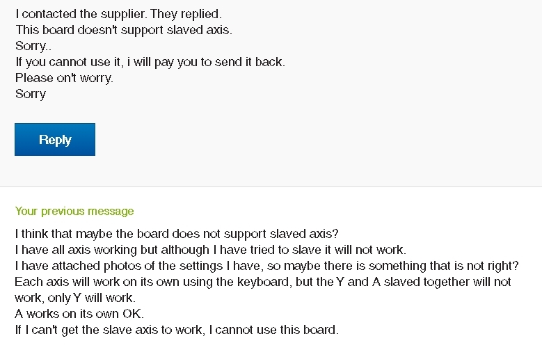

That was the whole reason for setting this system up. The machine was already working fine using GRBL, USB and no problems from the plasma. The only problem I had was that the gantry was so wide that it didn't stay square, so that is why i wanted to have Y and A slaved together for homing. I know that GRBL 1.1h also has slave options, but wanted a change from using UGCS.

OK, I contacted the seller of this board and asked some questions and here is the answer.
So now we all know that if you want this feature, DON'T GET THIS BOARD.
Attachment 30233
