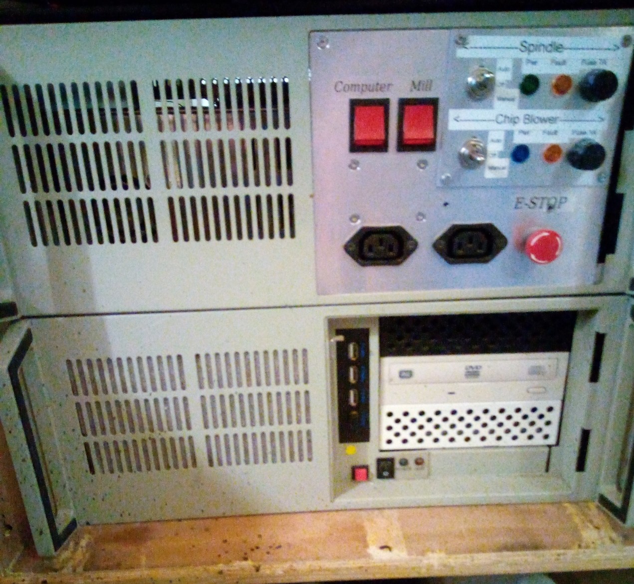

Another option is to grab yourself a server rack with a glass front (reasonably inexpensive on ebay - especially the kits or 2nd hand), or use a large PC case.
Server cabinets are cheap enough, the larger ones can't be given away sometimes. I have one dismantled in storage, deep enough to put a tool cabinet in the front and the control electronics in the back.
I built my control box in an old computer case, with the computer in another :-
Attachment 26740
It got a bit messy recently when I splashed it with a solution of black ABS, nothing like the mess when a spray can exploded on my garage:upset:

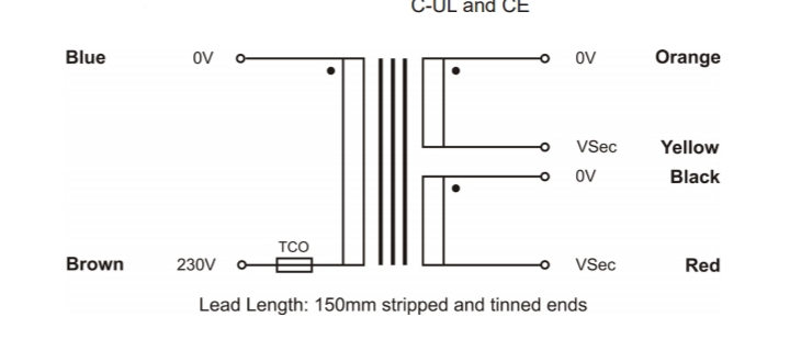

Got a new multimeter and I'm getting 33v from each secondary. Glad I didn't get a 35v transformer or I would be very close to the 80v max.
Attachment 26744
To wire this thing in series, am I correct in thinking I connect the yellow and black?
Attachment 26743
Also the drivers dont have positive and negative marked on the input, both are just labelled AC. I'm guessing that because it AC it doesn't matter which way around it connected?
Re: First Proper CNC Router
diycnc
Attachment 26743
Yep.

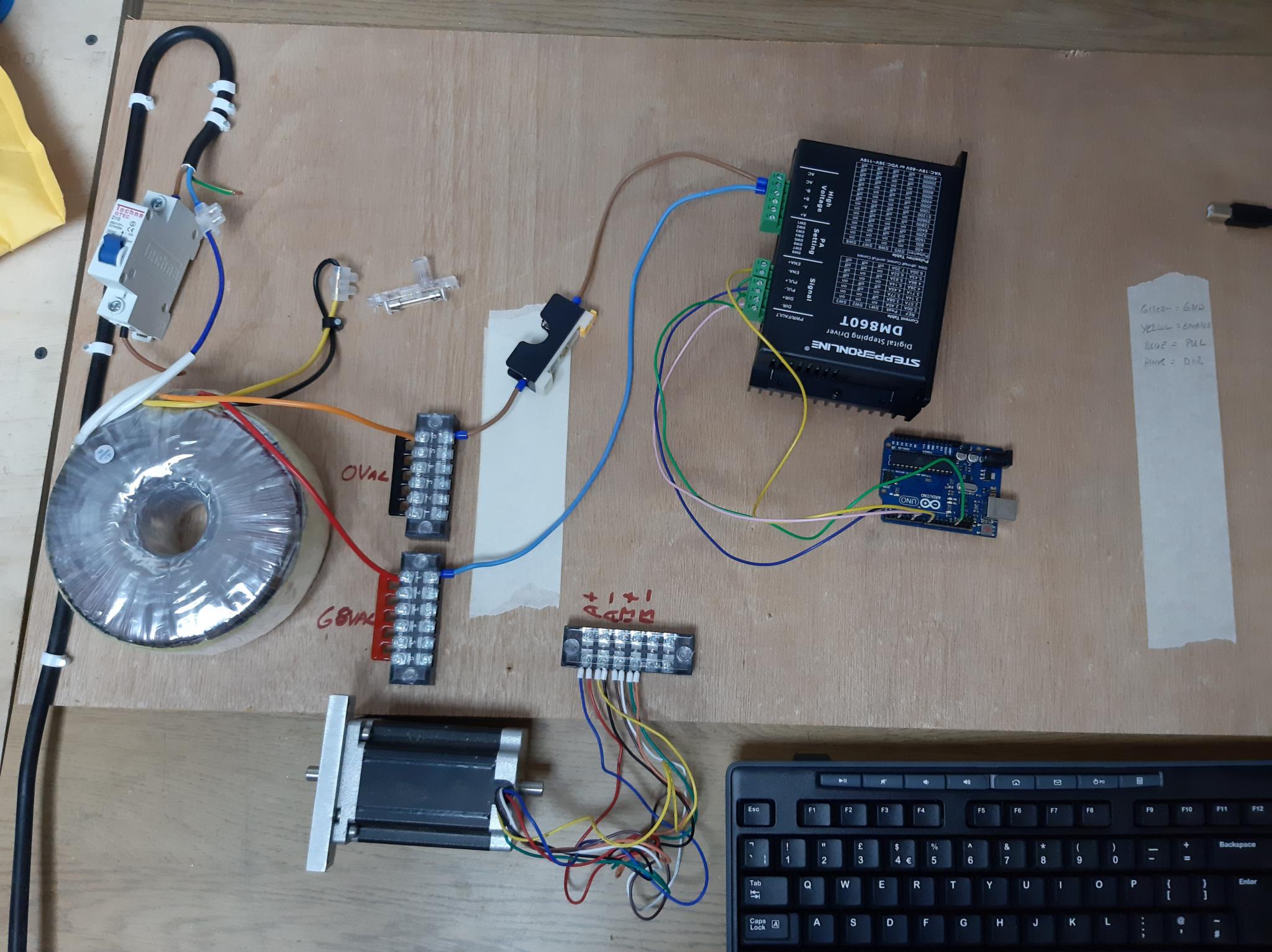

Finally got around to putting some test electronics together, just need to connect the motor and flash grbl onto the arduino. Would be awesome if someone could take a look at my wiring befor I do anything too stupid. I'm a bit unsure about the earth at the moment. The negative enable, step, and pulse are all connected together and the ground pin on the arduino. And mains earth isn't connected to anything at the moment.
Once I have one tested and working, will test all three together.
Attachment 26770
Just spotting I have the fuse on the zero volt side of the psu!
If it were me I'd run the enable, pulse and dir. signals as twisted pairs - common the -ve ends up at the Arduino. This approach gives much cleaner waveforms and better resistance to interference.

That's exactly what I was planning on doing, but at some point I managed to wire brown to + and blue to 0! Not really sure how.
When it comes to the finally wiring I'm definaltly planning on using other colours to differentiate. Is there a standard when it comes to control panel wiring?
All three drivers tested and working perfectly. Thanks for everyone's help with this!

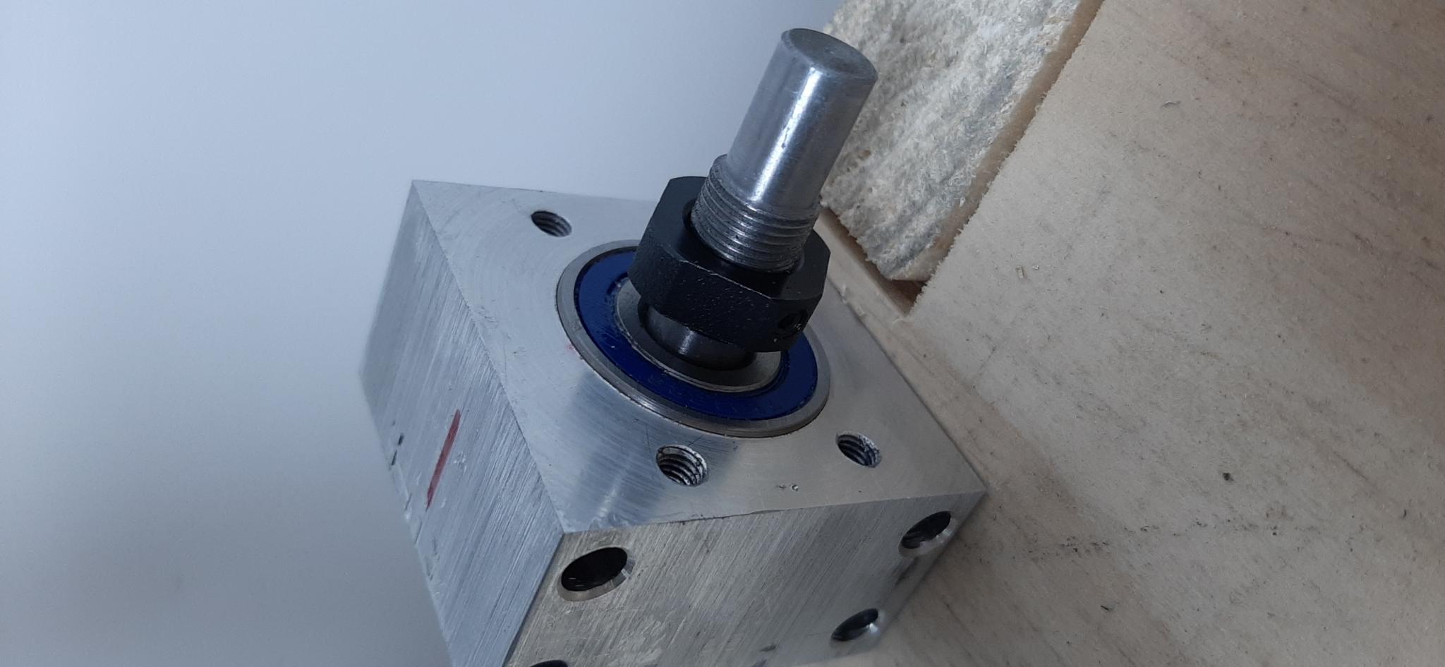

Could someone help shed some light on the correct orientation of AC bearings?
I thought I had a handle on it, but iv just come to install some pulleys and iv spotted iv got some face to face, and some back to back, so now I think i must have misunderstood something.
My current understanding it face to face is the preferred orientation and to preload them to remove any backlash I shim the outer race.
Face to face is with the larger inner race face pointing towards each other?
A second opinion on this would be great!
Scratch that.
If I'm shimming the outer race, I need them back to back.... with the larger inner race face pointing away from each other...?
Attachment 27145
Yea, for this application back to back is what you want.

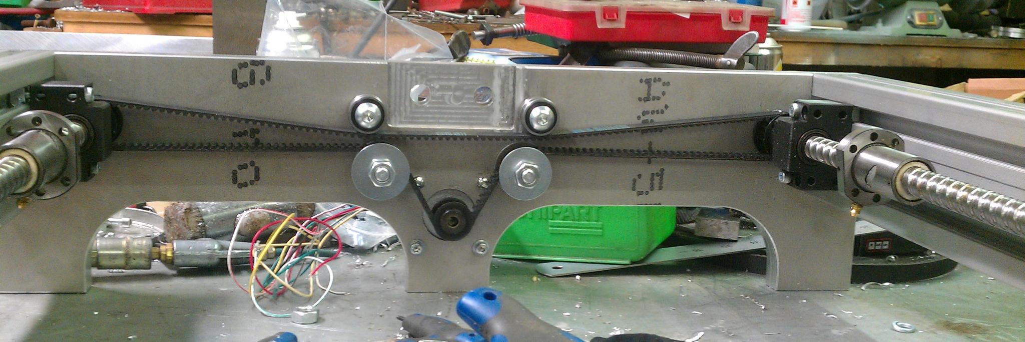

I'm struggling to decide between to different belt arrangements for my y axis (the one that moves the gantry). I will have to ball screws driven by one motor, with either one belt connecting all three pulleys. Or two separate belts, one connecting the screws, and one connecting the motor to a single screw.
I have space for either setup, and enough shaft on the end of the ball screws for the two pulleys needed for the dual belt arrangement.
I can see pros and cons for each, but struggling to make a decision.
Any suggestion?
Use the one that allows the shortest belt arrangement. They will all work equally well as each other but shorter belts are easier to find and implement.
This is my preferred setup.
Attachment 27732
