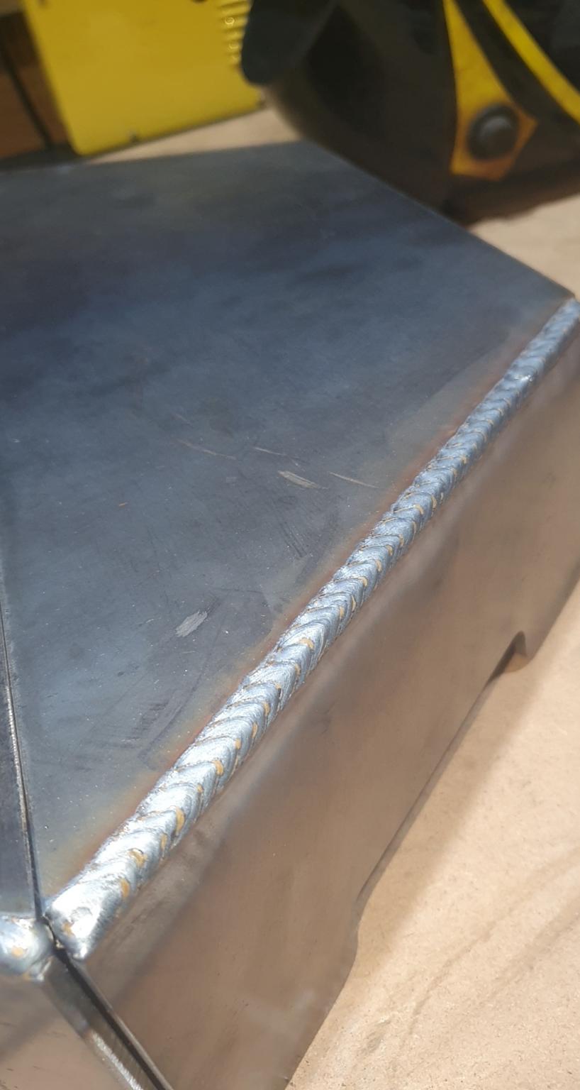

it's not easy to get neat welds with mig on thick material unless you have a really powerful machine and then it just pulls out of alignment more.
Mike.
Not strictly true, with the correct setup and a skill full welder then even a cheap welder can give excellent welds on thick material without too much pulling or distorting as you can see on these pictures of machine we made, one is 5mm plate onto 10mm done with a Cheap £150 180A Ebay Mig, the other is this base frame with some long welds on10mm plate.
You can see the Mig in the pic of the base frame and if you zoom in you can see 10mm pads welded to a 10mm plate, nothing pulled on this frame. Full disclosure here this was My Son Jareds (Jazz) welding, not mine, my eyes are knackered so my welding days are done.!
This said practice makes perfect and a grinder mask's 1000 sins until something falls off...:hysterical:
Attachment 30952 Attachment 30951
Re: 4' x 4' x 8" Router Build
JAZZCNC
...and to the left of the welder, the ubiquitous DeWalt grinder :)
All seriousness - that's a nice job - surprised that's the result of MIG, approaching TIG quality. Impressive.

Originally Posted by JAZZCNC >> Not strictly true, with the correct setup and a skill full welder then even a cheap welder can give excellent welds on thick material without too much pulling or distorting as you can see on these pictures of machine we made, one is 5mm plate onto 10mm done with a Cheap £150 180A Ebay Mig, the other is this base frame with some long welds on10mm plate.
I was just trying to keep his chin up, now you have posted them pics up JonnyFive will have an inferiority complex :hysterical:
atb Mike.
Is it a complex if you know you are inferior?
My welding is crap but it's good enough that my machine has stayed pretty accurate and hasn't fallen apart in the few years I've been using it. I just don't show it to people...
But don't forget the angle grinder!
m.i.k.e
atb Mike.
Somehow I don't think JohnyFive is a snowflake so I'm sure he'll be fine....:hysterical:
But in all seriousness, the point of my post was more to let people know that even a cheap Mig can produce very nice welds even on thick-ish material. Yes, 10mm is pushing the limit of a cheap welder but it can be done.

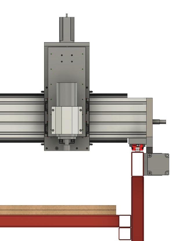

Yep, strong and heavy - CAD says the fabrication is over 370kg!!!!!
JonnyFive
Careful not to get caught up in the "Heavy is good" trap because heavy in the wrong places can be just as bad as underbuilding.?
At least if you are underbuilt you can take lighter cuts and go faster but too heavy and you'll struggle to hit feed rates or suffer from missed steps through motors not being powerful enough to handle the inertia and as we all know it's a lot easier to put weight on and beef up than take it off and a lot cheaper if your too heavy and end up having to replace motors and drives etc.
Understood Jazz. The 370kg is for the welded (static) base frame, I thought mass here would help with damping? The vast majority of the moving bits are aluminium, I haven’t worked out the total mass of the gantry perhaps that’s something I should do?
JonnyFive
Yes nice thick tubes etc will certainly help to dampen vibrations and without a doubt, you need to look at the gantry weight and screw sizes you'll be using to help with motor selection, etc. Mass in the gantry certainly helps here as well but this does come at a high cost with motors etc and isn't always needed so it's worth taking the time to work out the weight you'll be moving.

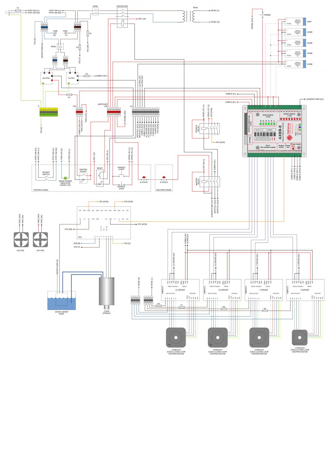

Whilst progress is slow on machining all the parts I need I have put together my attempt at the contrrol circuitry. I have to give a massive shout out to both ROUTERCNC & Joe Harris for their superb videos and documentation covering this side of things - I've watched / read it all several times!!! Using their content, some intense Googling and reading of manuals this is what I've come up with:
Attachment 31390
Attachment 31391
I do have a number of questions, hopefully someone will be able to help:
- Is a mains filter required for the VFD? I notie=ced ROUTERCNC used one but Joe didn't
- I'm assuing I don't need to connect up REV on the VFD as I'll only be running the spindle in one direction?
- I've seen diffferent ways of connecting up the step & direction pins from the motor drivers - either commoning up the +ves or the -ves - what's the difference? Is it to do with picking up the leading or trailing edge of the signal? Which should I use? I'm using closed loop steppers if it makes a difference.
- My motors came with long cables with extensions - are they ok to use? Or should I be making up my own screened cables?
- Do I need to run an earth wire to the gantry & frame?
- Is the rotary interlock switch necessary?
- Do I need to connect the spindle pin 4 to earth? I've read contradictory things about this.
- Do I need to connect the ENA+ & ENA-?
- Do I need to twist the PUL & DIR wires?
- Is it acceptable practice to crimp 2 wires into one ferrule? Or put 2 ferrules into a single terminal?
- Should all the 24V feeds going to the AXBB-E controller be from the switched 24V or permanent supply?
I'm sure there will be many more questions to come. Any feedback would be much appreciated.
Cheers :beer:
1. The filter is more to protect the supply (and other devices) than the VFD.... they're noisy buggers.
2, Correct
3. Closed-loop makes no difference. Whether you're driving high or low is largely irrelevant (the two pins are the anode/cathode of an internal LED used for isolation - so switching either works). What this gives you though is flexibility - for example an open-collector (open drain) drive is designed for low-side switching (i.e. take the + to supply, and switch on the -). The axbb manual describes the non-isolated outputs as being able to push/pull 20mA - so can source (+ve) or sink (-ve) - so can drive either input.
4. Your call. It's better to cut to length but not if you risk damaging anything.
5. Yes. Unequivocally. Do I?, I might.
6. I only glanced at your schematic - it feels a safe design but more than I'd do for a personal machine. I can't knock safe design but I can duck an errant shock 50% of the time.
7. It's a good idea. Otherwise a stray wire in the spindle could short to the enclosure and zap you. Of course your protective earth will then ensure that you brick your VFD before your blow the protective devices.
8. No. Unconnected, the LED opto-isolator remains inert and the drivers enabled.
9. It's a good idea, but realistically will achieve little. You'll be generating pulses at maybe 100kHz at around 5mA, that will generate some EMF but I'd hazard a guess that you're not going to impact much. The driver inputs going through an opto isolator will be pretty tolerant of any induced emf.
10. Yes, in fact I have insulated ferrules that accept two cores (i.e. a wide rectangular receptacle rather than round), Use common sense - if the cores fit comfortably then there's nothing wrong. Test each crimp.
11. I'd go for the permanent supply, otherwise you can end up with pull-lows on outputs when you don't intend this (remember, you still have a 0V supply to the AXBB, it's capable of hard-driving low). But remember I've not really looked at your schematic.

Thanks Doddy, appreciate the feedback.
Doddy
I see, so it's to protect things upstream of the VFD on the same mains circuit?
Doddy
2, Correct
:thumsup:
Doddy
Thanks for the explaination, I'll leave them as they are.
Doddy
I'm fine with cutting them to length.
Doddy
I'll add one in.
Doddy
I'm still in 2 minds, it looks cool but isn't really doing anything that the switch on the mains socket doesn't do other than stop you going in the cabinet which I wouldn't do.
Doddy
Easily solved, I can add it. I've also seen people saying you need to open up the spindle and check that pin 4 is actually connected to the spindle body, I'll check this too.
Doddy
:thumsup:
Doddy
I'll do it anyway.
Doddy
:thumsup:
Doddy
I don't fully understand what you've said but will swap to the permanent 24V supply - sounds like it's the way to go.
JonnyFive
You could probably check this with a multi meter rather than take it apart and brake any seals etc...
#4 Depends on the quality of the wire, the wire on the Lichuan motors we use isn't shielded and we never have any noise issues from it, only on very long wire runs ie: 8x4 or 10x5 machines do I tend to fit shielded cable but even then it's only precautionary thing and I doubt would have trouble based off the other machines we built.
#7 We don't connect this as it's given me problems in the past with noise, if the chassis/gantry is earthed then you won't have any issues.
#11 Permanent 24v and 5V supply otherwise you'll drop power to the Axbb-e and lose your Workoffset if you haven't saved it first, UCCNC only saves the Workoffset on shut down so if you haven't saved the offset then it will be lost with a power cut. It's also a pain in the arse having to restart UCCNC, reload the G-code etc just for an E-stop.
Thanks Lee. I have done a continuity test and can confirm pin 4 is connected to the spindle housing.
JAZZCNC
I'm assuming this is something I could easily upgrade if the need arises once I'm up and running? The cables I have came with 3m extension cables, hopefully these will be long enough.
JAZZCNC
OK, I'll leave it un-connected. The cable from the VFD to the spindle needs to be shielded but with the shielding only connected at the VFD end and not to the spindle connector - is this correct?
JAZZCNC
I'm referring to the 24V to the isolated inputs, the 24V and 5V power connections to the AXBB-E are permanently connected. Should the isolated inputs be permanent too?
JonnyFive
Yea and do the same with the control/comms wire to/from the vfd, except connect that earth to your main star ground in/at the cabinet end.
No ground loops etc...
Lee Roberts
You mean the wires going to DCM / FOR / ACM / VI on the VFD?
JonnyFive
No, sorry I meant to say shielding not earth, but yes the shielding for that group of wires, not the connections themselves...
So I'm talking about the control wire you would also install so that the main cnc controller can control your VFD from software.
Also, I think you should choose Doddy's advice and mine on this one and definitely connect Pin 4, it costs nothing to do and I too would rather sleep well at night knowing your/my spindle housing is properly wired to be safe in a fault condition.
Earth/ground is there for safty first and should be used as intended, using it for noise drain should be considered as a secondary bonus feature in this application in my opinion.
Noise issues can be isolated and remedied, restarting your heart isn't as easy to do...
I have updated the schematic:
- Earth wire from VFD to pin 4 on spindle added.
- VFD to spindle cable screened with screen attached to ground.
- DCM / FOR / ACM / VI wires all screened and earthed.
- Isolated inputs connected to permanent 24V.
Attachment 31542
