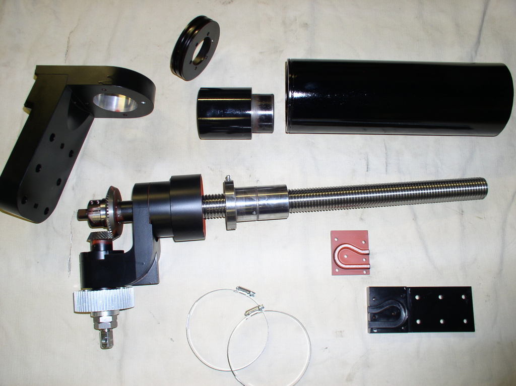

Re: Beavermill conversion to CNC
After making the assembly for the Z axis painting it was a pleasure.
I've chosen a black paint to get a two-tone effect.
On the picture we can also see the clamp that will be used for clamping the counterweight cable .
Attachment 2965

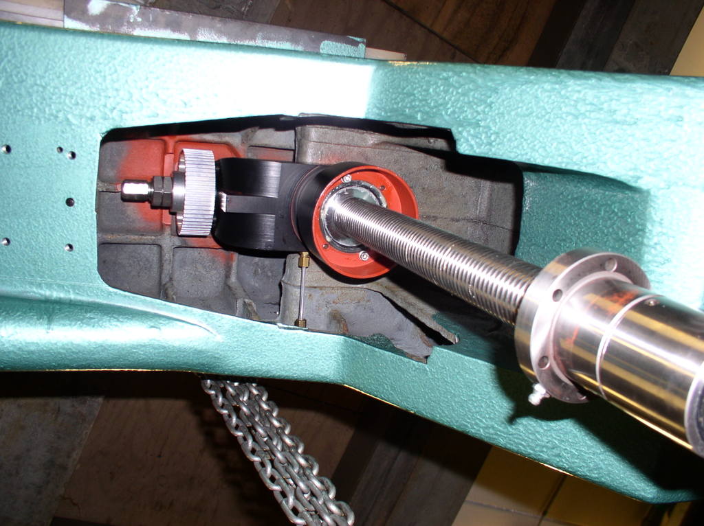

Now I have some more to assemble.
I builded together the knee.
Attachment 2966Attachment 2967Attachment 2968

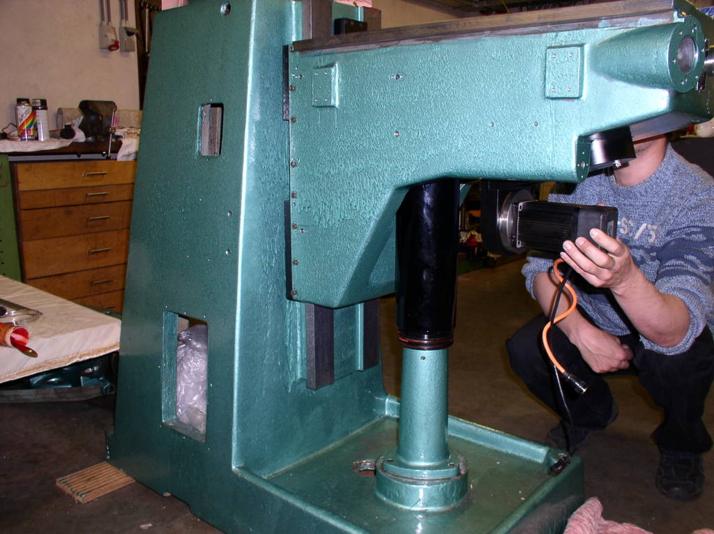

Then I thought having not enough height in the Z so I started making a extension piece
that was faster said than done because I had a metal ring that was to smale on the outside and inside .
On te picture you see the ring when finished.

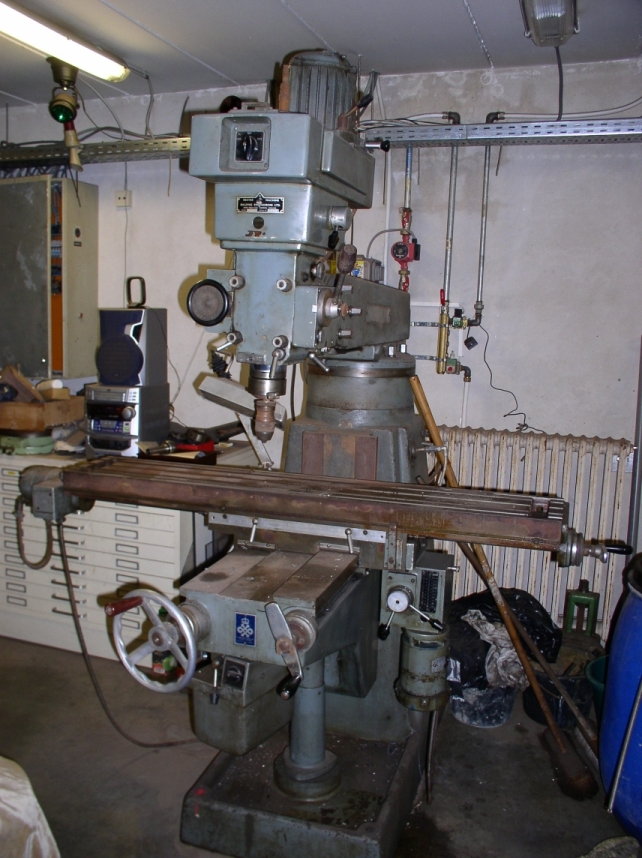

John with the riser you mean the Z axis i supposed ?
Because I did a complete redesign of it on my machine and if you want some more pictures I can provide.
It was a conventional manual bridgy with nod and tilt head but it had a horizontal spindle thru the riser, front to back.

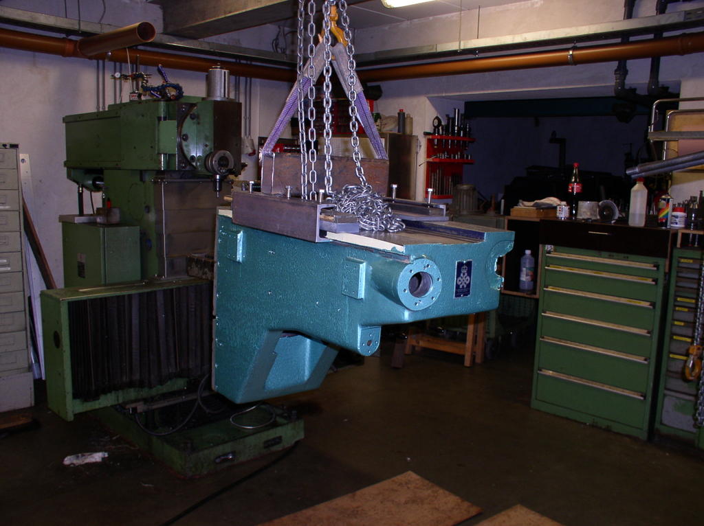

After the bolts were finished we put on the turret.
6 Attachment(s)

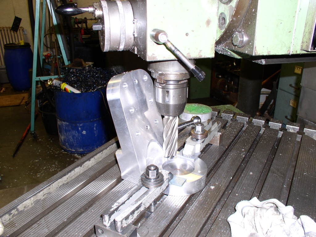

2 Attachment(s)
After making sure the workpiece is in the center of the machine I started with
roughing the outer arc.
