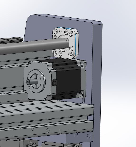

Finally feeling like I may be going in the right direction now! (*awaits comments saying I'm not* =P).
There's just enough room to mount the X axis motor on the inside of the gantry.
Attachment 12783
Attachment 12784
Attachment 12785
Attachment 12786
Re: CNC Router V1.0 Build Log (For Cutting Multiple Materials)
Won't need that top piece it's only adding weight and expense.

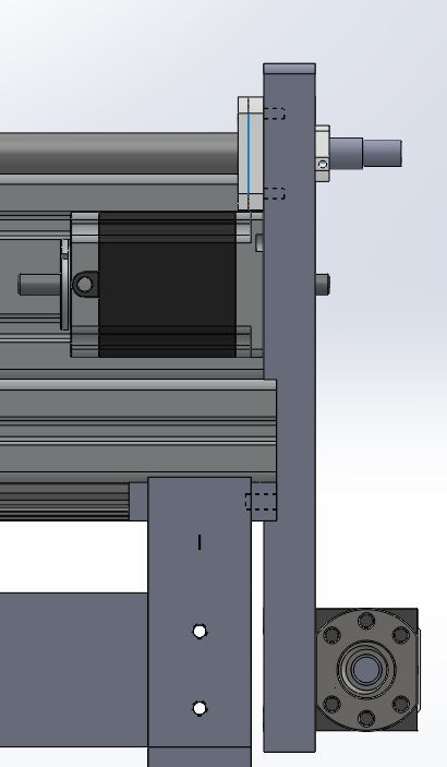

I am looking to mount the motor on the inside of the gantry but I'm going to need a long motor shaft or a pulley with a long hub length to get through the 20mm plate and out the other side with enough length. Any suggestions?

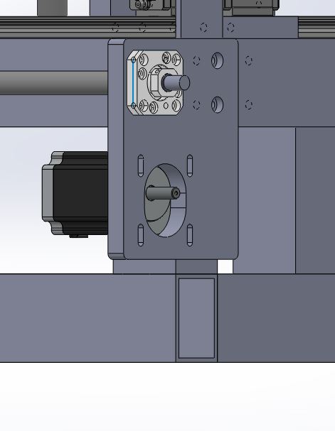

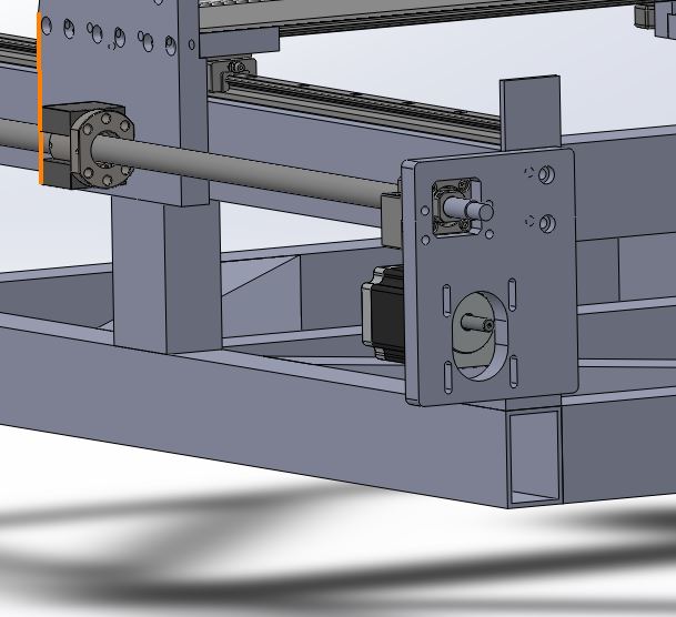

3 Attachment(s)
It looks as if it will be easier to mount the X axis motor on the outside of the gantry plate (See below). If I wanted to mount it on the inside and still use the FK bearing block then the shaft would be too short to mount a pulley.
Attachment 12853
I am now looking at the Y axis ballscrew mounts in a little more detail. In the screenshot below how is the bearing mount attached to the steel box section? (Does anyone have a link to this build thread btw?)
Attachment 12854
I assume that there's another piece of welded steel plate on the end of the box section? As below?
Attachment 12855
While I am on the subject of the "end plate", I assume some sort of adjustment will need to be built in to allow movement in the Z axis as if I use the epoxy method on the box section then it's going to add some height?

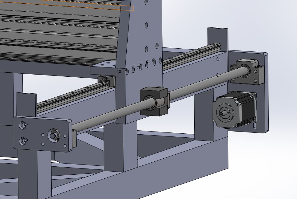

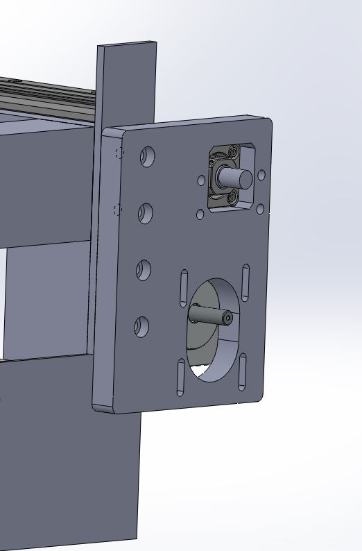

No problem JAZZ. I'm currently making some changes as we speak. A few questions are now arising:
1. What pulleys do most people go for? XL? Not sure on pitch etc.
2. Is there a way of extending motor shafts so that I can overcome this problem below?
Attachment 12908
3. Is 10mm of motor mount adjustment enough for belt tensioning?
Attachment 12907

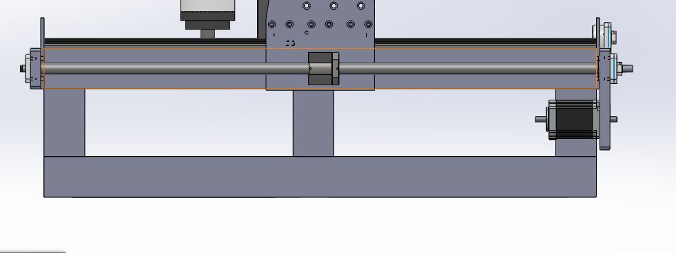

Some progress on the Y axis too:
Attachment 12909
Attachment 12910
Attachment 12911
What most people do is rout out a recess for the stepper to mount in so you've got only maybe 5mm of material where the stepper sits (see here). That way you generally get enough shaft to mount a pulley on directly without needing an extension.
I don't think 10mm of movement will be enough for tensioning, especially not on a long belt. I'd go for more like 25 or 30mm if you can.
#1 Use 15mm wide 5mm pitch HTD pulleys and belts.
#2 Need extensions made on lathe but much easier to use BK/BF bearings inot profile and belt/pulley like shown in my picture on other thread.
#3 20mm slot.

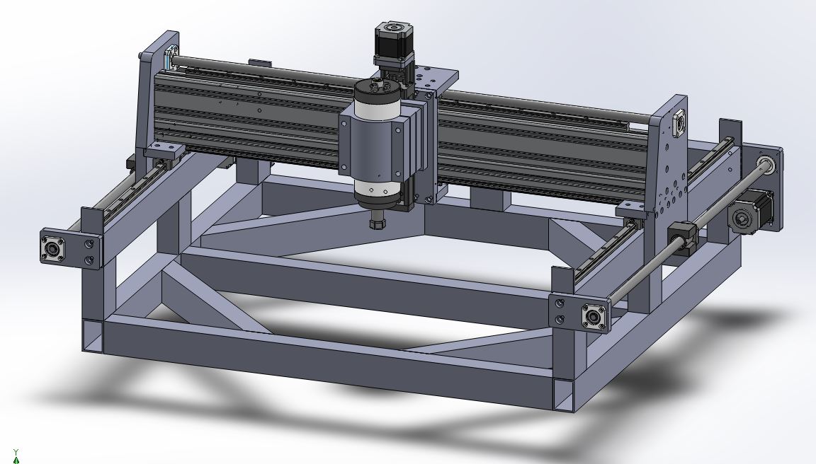

5 Attachment(s)
I think the end is nearly in sight!! :excitement:
All steel plate is currently 3mm ("Y axis "end stops" and end plate attaching bed), should I make this thicker? Will there be any problems welding it to 3mm thick box section? I have a friend who works at a laser cutting place so I'm hoping to get those pieces cut there.
Attachment 13008
Attachment 13009
Attachment 13010
Attachment 13011
Attachment 13012
Any comments on the above would be appreciated =) I think I need to start looking at places to get the aluminium milled soon!
I've been a bit distracted with designing my own stepper drivers but going to put that to the side until I have the mechanical design all done.
I think it would be better to extend the Z axis rear plate to meet up with the bottom plate, like this; it's not shown on this photo but my ball nut fits on the inside of that plate.
Attachment 13312
3mm plate is too thin I reckon, I used 10mm flat bar for brackets, maybe 6mm would do, see what others say about it.

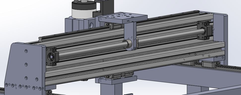

Well it's been a long time since my last post and since then there have been some large changes... Now, I am fully awaiting the groans and face palms when I say this....
I have decided to return to using aluminium profile for the frame. The reasons being:
1) My welding skills are not quite there. They aren't bad but I envisage a lot of trouble trying to get things square and aligned correctly.
2) I now have free access to a water jet which I plan to cut beefy steel brackets from to connect the profile together with.
3) I have re-evaluated what I will mainly be realistically cutting and steel may be OTT!
Anyway, enough excuses. Here's the latest design. I would really like to get the ball rolling with the custom aluminium parts. Am I best posting on the job request page and going from there?
http://www.mycncuk.com/attachment.ph...id=13543&stc=1
http://www.mycncuk.com/attachment.ph...id=13544&stc=1
http://www.mycncuk.com/attachment.ph...id=13545&stc=1
Dave

The design you had wasn't too far away from cutting aluminium. It could benefit from a better/stronger base and the the linear stage for the Z axis isn't really up to aluminium but the general layout of high sides with gantry sat on rails is perfect for aluminium. Gantry design is nice and strong enough for aluminium.
If you sat that lot on nice piece of machine tooling plate or better still Granite base the frame would be sound for aluminum. Ditch the linear stage and put a conventional Z axis with decent rails etc and your sorted.

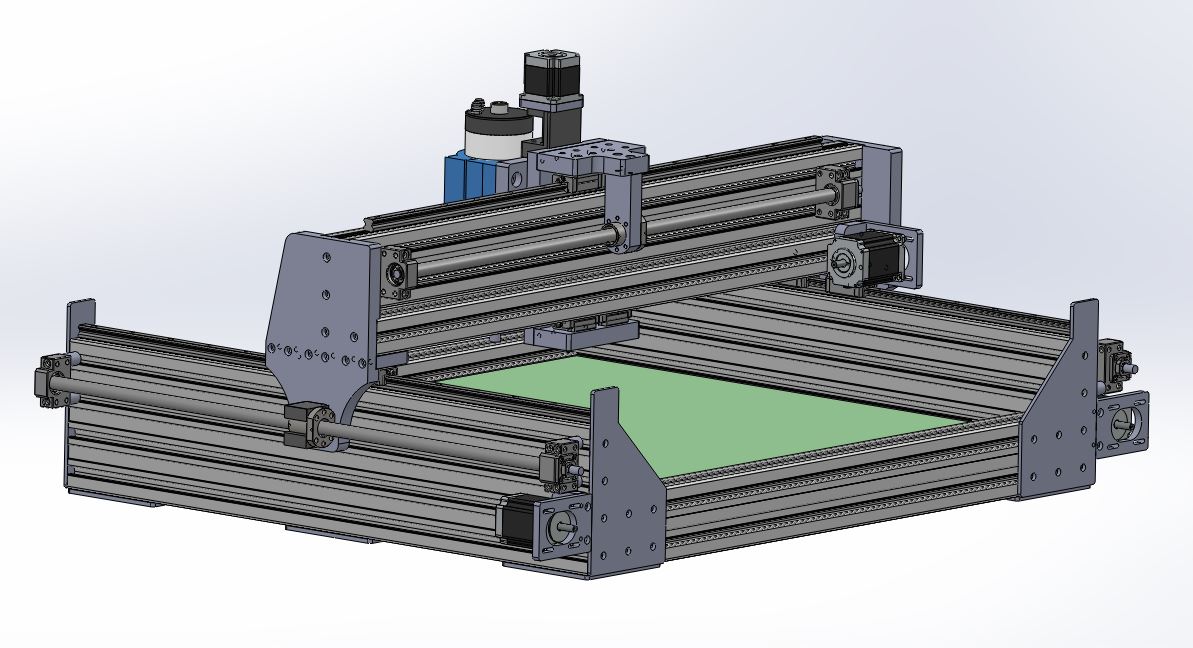

I think an aluminium bed with t-track bolted to it looks like a good idea. Just need to find some for a reasonable cost!

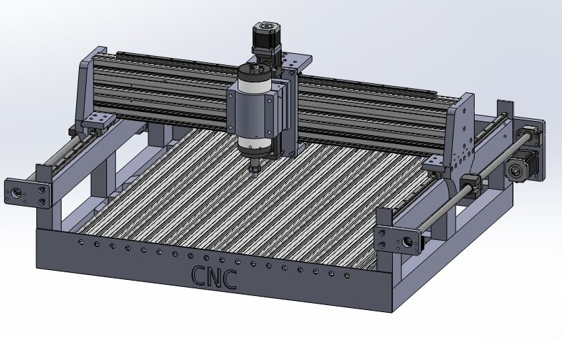

2 Attachment(s)
Re: CNC Router V1.0 (For Cutting Multiple Materials)
I may of found a cheaper solution. "MakerBeam" is a 10x10mm extrusion and relatively cheap. I was thinking something along the lines of this:
Attachment 16364
Attachment 16365
For the bed plate itself (shown in green). What would be the most cost-effective solution? The dimensions are 725x825mm. Steel or aluminium? What thickness would suffice?
