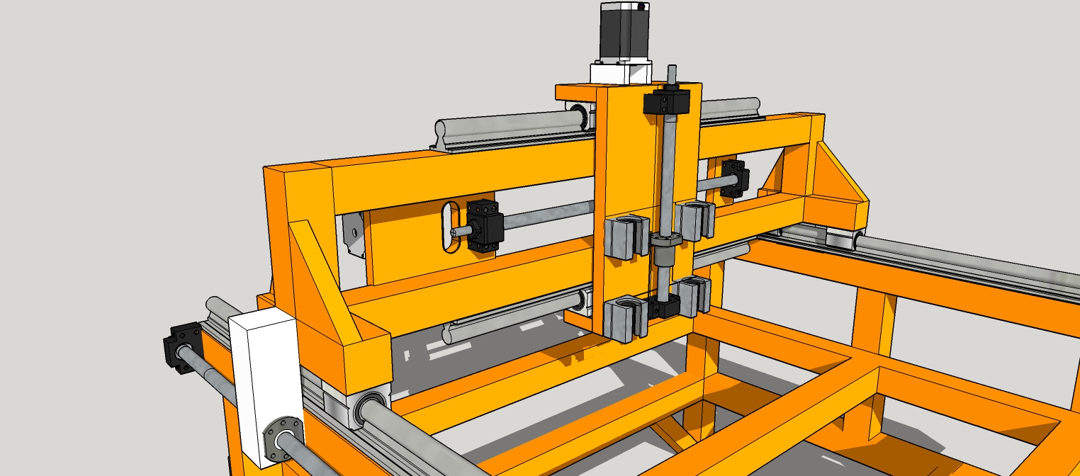

How do you propose to get the main axis shafts level and parallel with each other? Commercial companies using this style of frame will have accurate jigs to hold the frame in position while they weld it. Special purpose machine makers mount rails onto a flat ground plate, which is mounted onto the frame, to ensure flatness. With the flat plate and one shaft mounted you could check parallelism using a dial indicator to locate the position of the other shaft.
Re: Build Log: a Steel Box Section Build with SBR20 & Ballscrews Plus a few questions
Hey colin
Sorry for the Delay in replying. I have given myself room to move components for small adjusting of plates which is lucky too because as previously said I just cant get the holes as close as I would like. although I centre punch and then centre drill and then go larger but I think with my newer drill press it has got better. But i have made 6mm holes in the plates that bolt to the m5 tapped holes so that will give me a small amount of movement.
I have a dial indicator to get as close as I can although I need to find a long enough straight edge to trust and then using the Vernier caliper too.
I will then be able to then flatten the spoil board once everything is running so it won't matter if the machine is a small part of a mm out because it will al be parallel with itself and also the work piece.
Well that's the plan anyway. I will be using Epoxy for the rails to get the top rails flat running a channel between the rails and this will then self level.
i think then it will be a lot of fiddling about to chase every last 0.0 of mm
I would be great to have those known flat and precise equipment of the manufacturers have but money would never allow for it sadly.

What about using a laser level and laser distance measure. If you are careful you could use a sheet of glass to check for level.

Great idea I didnt even think about glass I will be keeping my eyes open when I pass any skips from now on.

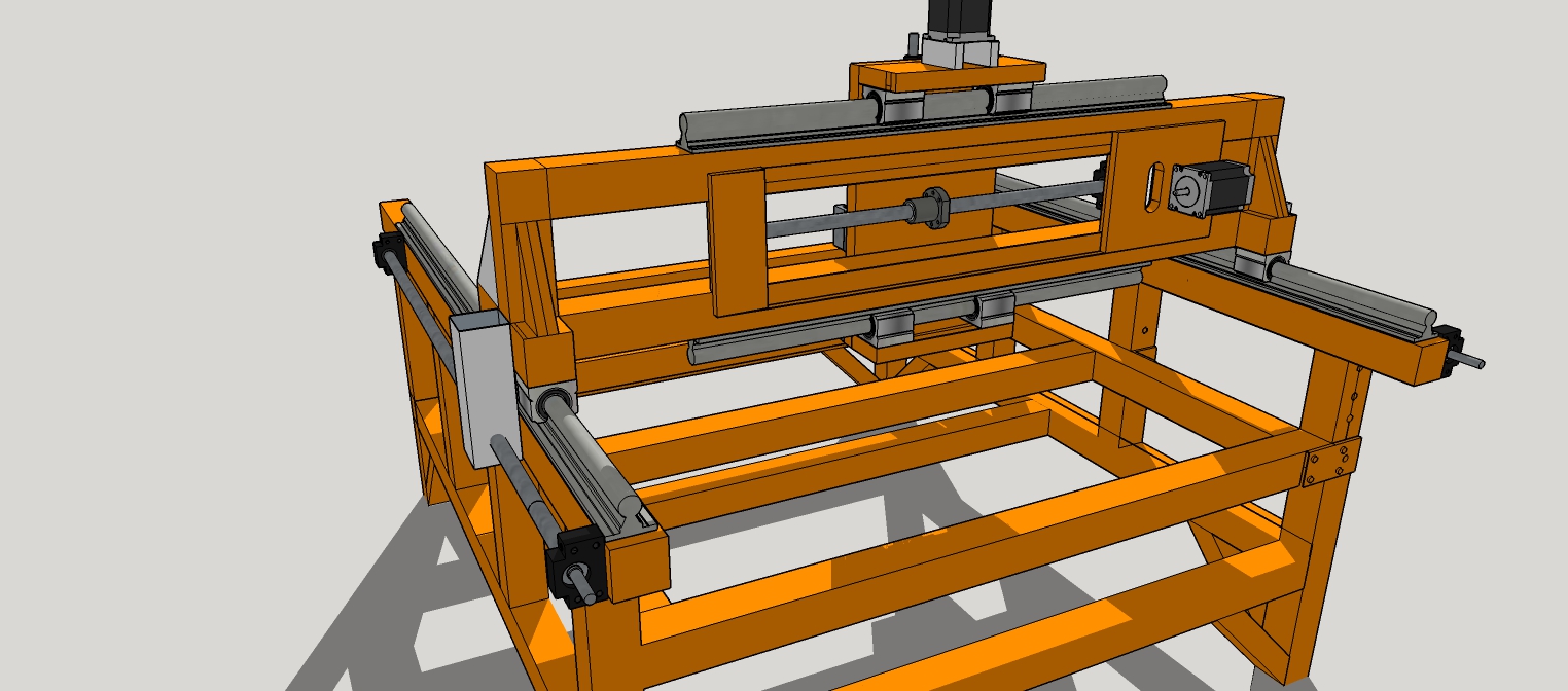

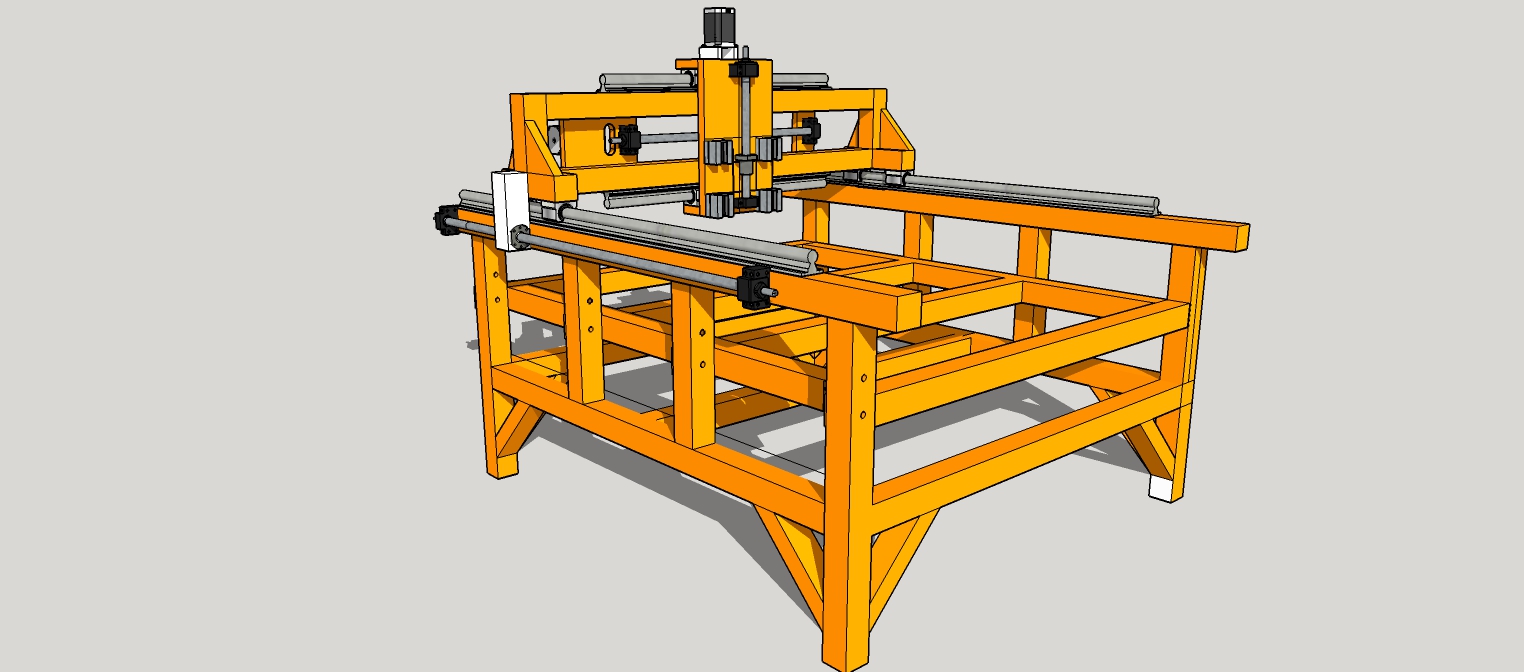

Well still building the frame but also learning as I go about the electronics and everything else.
I am looking at the pulley's to use dean said that a 2:1 gearing ratio is good for a 1605 Ballscrew but does it matter how many teeth are on the pulley as long as it is 2:1 on the otherside of the motor I can't find any threads that show how to work it out.
I am looking at using Nema23 4nm from CNC4You which look to be low inductance and high torque also nothing really shows the torque curves to show if it is usable power through the range.
Has anyone used these motors at all ?
I know that it is best to wait for buying things but my year end accounts are up so trying to make sure I can buy the bits before then.
I have now ordered the 4 Leadshine AM882s because I will be using duel screws on the X.
I'm now ordering the Hiwin rails from Fred because its taking forever to build if I use the supported rails I don't think it would ever get upgraded so do it one do it right.
So its back to cad and make the changes.

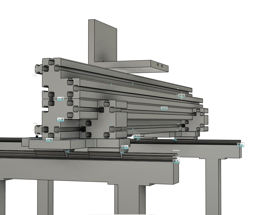

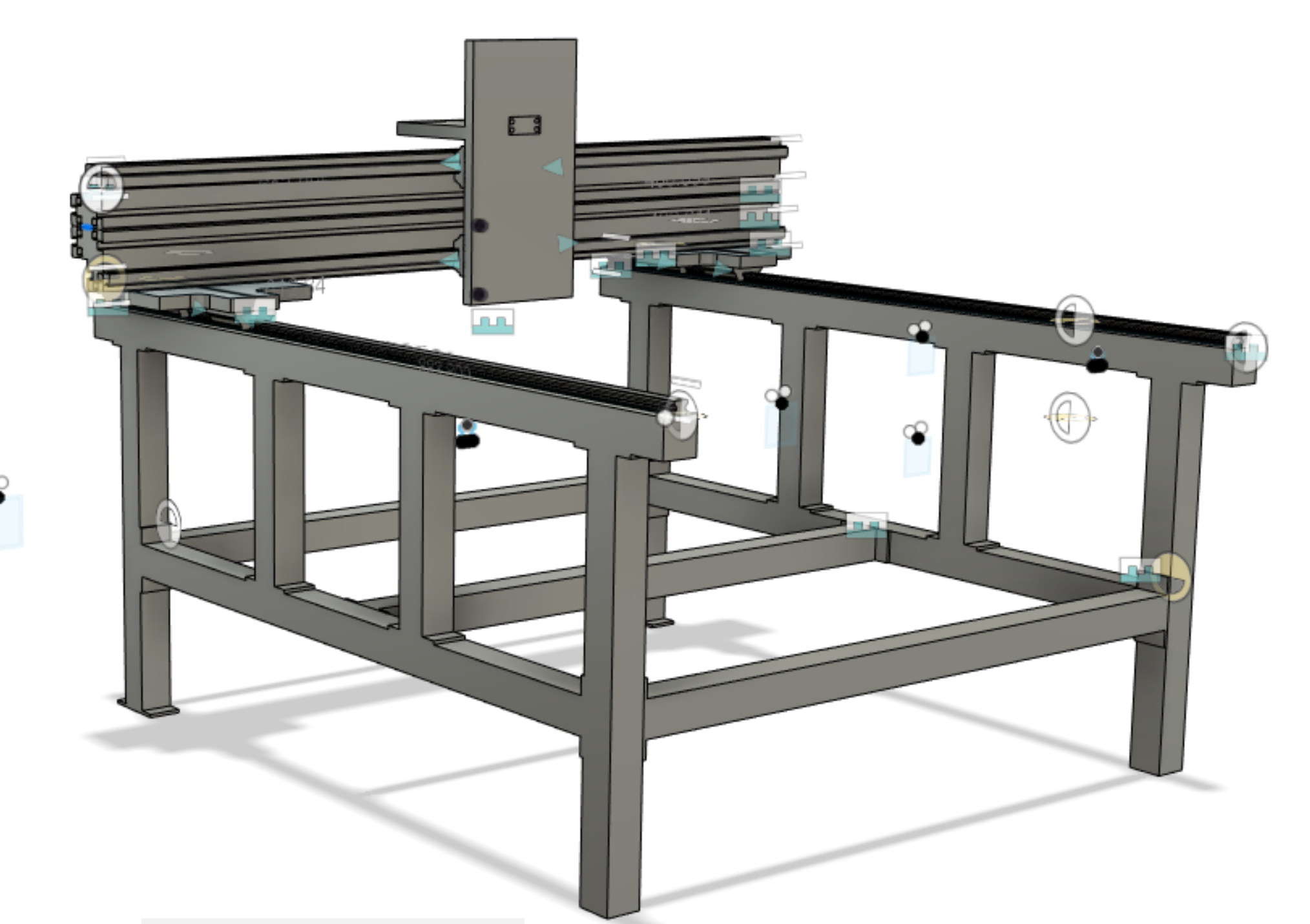

So I still haven't finished my Frame still after a long long delay in making the CNC after house moves work and another daughter it's time to get this thing back on track again, when I started this I never in a million years thought I would still be making it.
Although I haven't been making any progress on my machine I read through the amazing posts on here most days still.
Attachment 29526

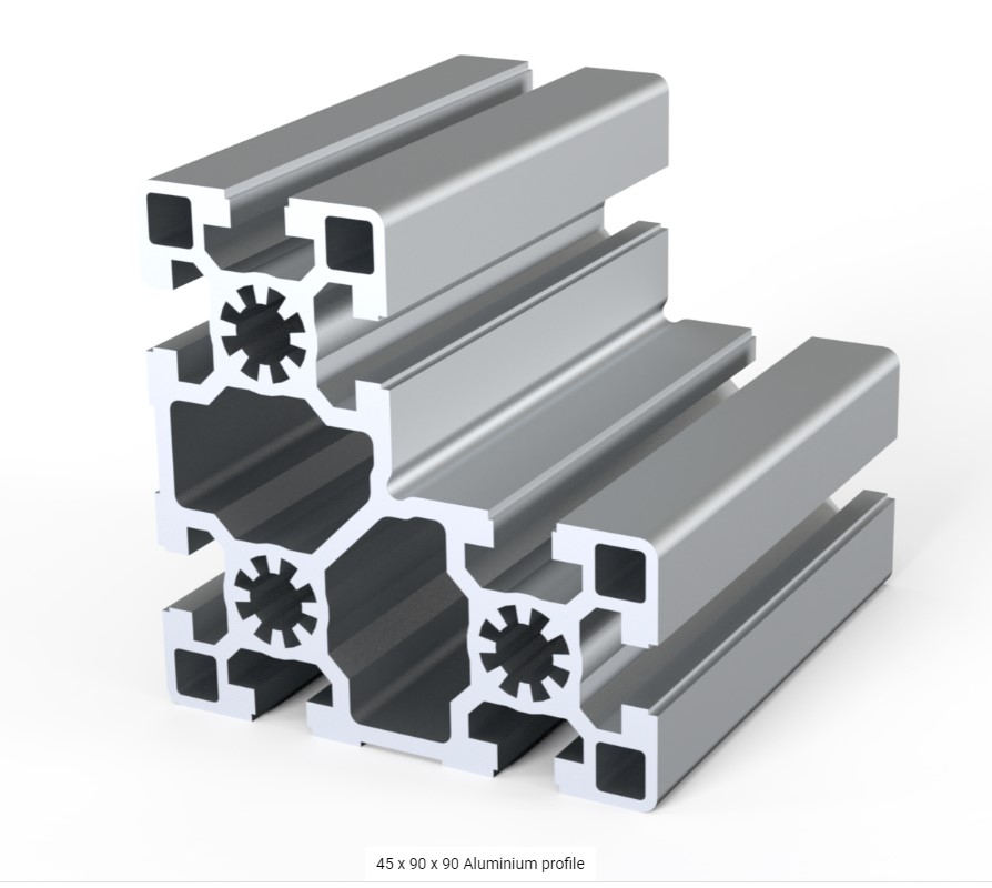

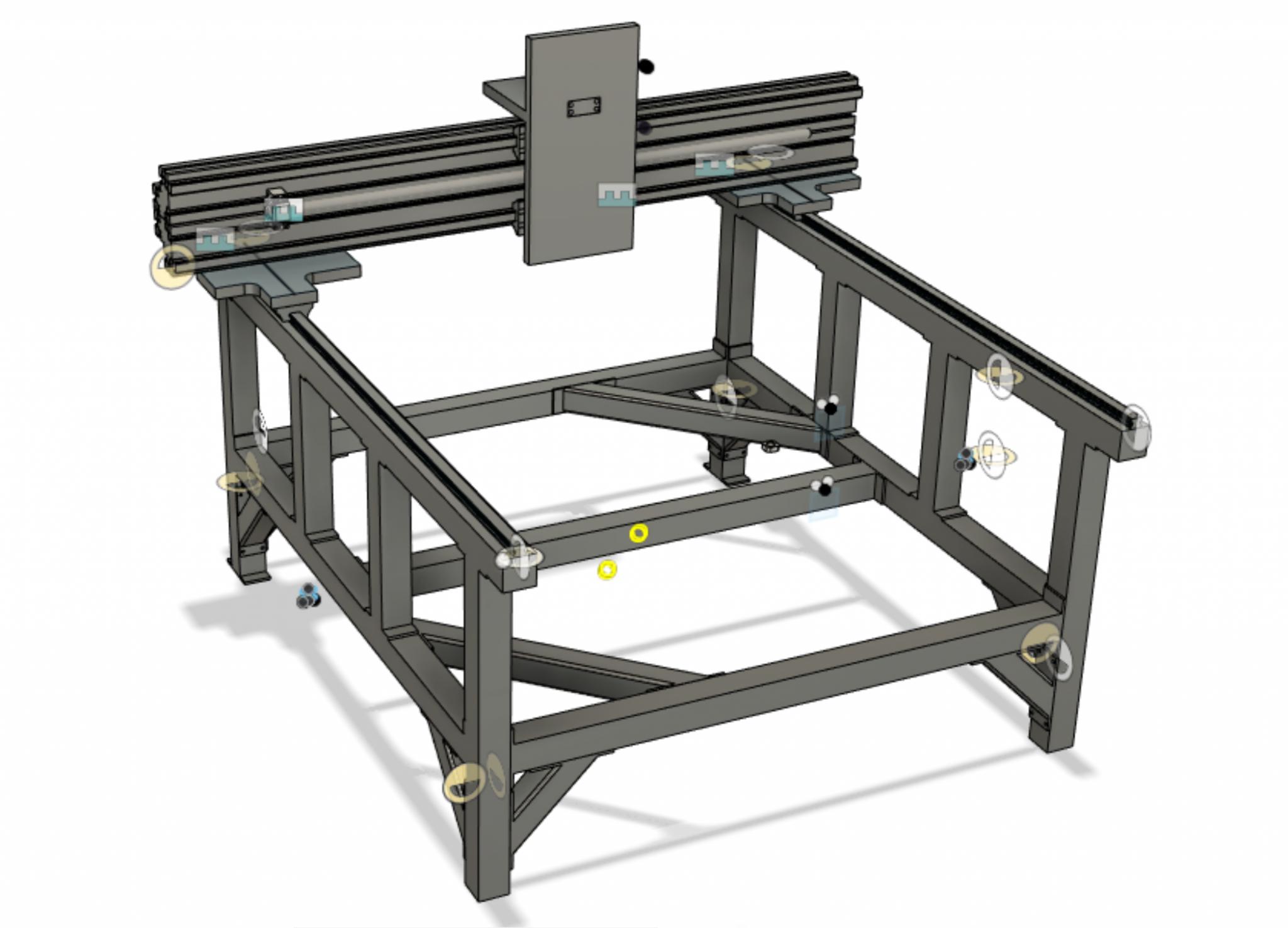

So I have been redesigning my original again and I have found that Item does a 45x90x90 10mm Profile
https://www.aluminium-profile.co.uk/...file-kjn992387
The plan would be to put the two together with bolting through one and then into 'T nuts on the second profile.
It will then be wider than the width of the frame to allow the full width of the cut (Which I didn't have previously)
Attachment 29527
I need to change the bracket so that it doesn't get in the way of the Z
It will have a movable shelf which I haven't added to the design in fusion 360 as yet so the spindle won't need to go right down to the bottom shelf.
It is roughly the same pricing as a 200x100 cold-rolled box section but I think it will be easier for me to complete the gantry with this instead of the steel and not have the resin to be put on to get the accuracy on the rails as time in the workshop is still limited these days.
Looking at the profile it seems pretty sturdy and it would have 5mm on each side of the rail to attach on the slots. But before I get too carried away with the design I thought I would check if this is a good possible profile to use.
Any thoughts would be most welcome.
Thank you

Have a look at John Ward's site.
https://www.youtube.com/watch?v=Xbiipb6nnZg
You will achieve greater accuracy using flat plate fitted on top of your frame and shim at mounting positions.
Re: a Steel Box Section Build with SBR20 & Ballscrews Plus a few questions
Pointless using such a heavily built gantry on such a weak flimsy frame.! You seriously need to brace that frame-up.

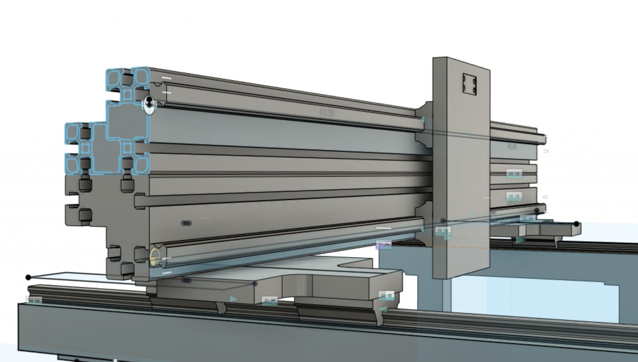

Good Morning
Thank you for the replies, Thanks Colin I will look through the link very appreciated, Thank you Jazz yes the actual frame that I have pretty much built most up and has more bracing of each corner and I'm adding diagonal pieces on the Horizontals of the bed and then the second top shelf (not shown) will also be bolted to the mainframe to add more rigidity.
Because I had that part built its more of the Gantry design I'm changing from the 50x50 box Gantry I originally had as my design to the Aluminium Gantry, but I wasn't sure if the Gantry would be as good and as strong as the 50x50 Box design I had previously,
Attachment 29546
The profile I'm thinking I using is this but I couldn't find too much about the strength of it in terms that I understood (Me not clever enough not Bosch's information)
Attachment 29547
I will use the Profile to create a stable base to connect it to the Plate. the Screw and mounts will be put on ali plates because of the room available on the 45mm and I need 60mm width for the screen bk12 fittings.
But I like the words from Jazzcnc used Heavily then I will continue along that route with my design I haven't ordered the profile as yet and I'm trying to get the rails on order soon.

You can also skin the frame with sheet material (rather than diagonal beams) for bracing

Sheet material will do very little for it other than turn it into a Big Drum. It needs proper and substantial bracing to handle the forces a heavy gantry will put on it. If done properly it will also reduce resonance/vibrations.

Thank you very much for the replies, I have been adding to the design of how I have made the frame, although I still have the horizontal cross members to put together.

If you're wanting the best Stiffness and working the machine hard in a production environment 10-12hrs per day 6 days a week then you should go with the Hi-wins.
Re the frames It's still a little weak on the bracing IMO, because the sides are so tall the short end diagonals don't extend far enough across the beam, same down the sides, this will allow the cross beams to flex as the sides apply a bending motion to them. You would be better with another lower cross beam with diagonal braces between them.
My first machine was built similar to this design but with short sides and it flexed at this point, I later braced it up as mentioned above and it was much stiffer.
If you don't need to pass material thru the machine I would also fit triangle plates to the ends to brace the sides. Those tall sides with spindly tubes are a massive weak link in this design, why such tall sides with such a short Z-axis.?

Hey dean great thank you very much for the information on the Rails I have been looking and will be most likely going for those OEM rails, It will be purely a home Cnc just for hobby work so sounds good enough for me.
I will add some more bracing to the design higher up too.
The original plan was to make foam moulds for fibreglass parts for a car I was building so I could then keep layering up the foam and moving the shelf down to create the arches and other large parts, But that has changed now :(maybe one day) but its going to have a movable shelf for sheet woodwork so once the shelf is in that should also add to the strength too.
I originally left the ends open for end-grain cutting but I will add the end bracing too and I can always take them off when I'm doing normal sheet work.

5 Attachment(s)
I have been working on a mockup for the Gantry at the moment too, The frame is pretty much there
I am working on a movable shelf at the moment so the material will be much higher than the bottom is at the moment but this is if I wanted to create fibreglass moulds for the full height work.
Stemming from my original design I didn't think enough about losing the width of the cut when the gantry plates go to the end.
I originally planned on the Hiwin carriages further forwards and giving a larger gap between the carriages. but not I am thinking the the base plate will then be flush with the front of the Ali Profile and then the x will be allowed to slide further across giving me the maximum cutting size that I can.
the downside of this is that the main load will be on the front carriage but I'm also thinking this will be a plus point, not a negative point the Carriages will be an 80mm gap between each other and I think it looks right.
the Base plate won't be like the block it will be 2 plates of 10mm Tooling plate to make it 20mm thick and it will go across and hold the ballscrew block too.
Originally it was designed to make a plate that goes further forwards to make the spacing larger and the load sit between the 2 carriages better.
I can always change it in the future if I get any issues.
Because everything is so expensive at the moment instead of using epoxy to level the rails I am going to use some Ali profile that I already had for a job that I didn't use to save a few pennies. I can always use Epoxy in the future if it isn't as level as I hope but I will be able to check that.
