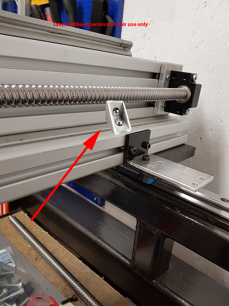

Just re-read the whole thread and I may have missed it again, but did not see how do you connect the two extrusions to each other? What is their size BTW?
I used 40x80 extrusion, most recommend 45x90 but this size was more availible for me.
If doing it again I would order 45x90 :)
Connected the profiles with t nuts in one extrusion. Then drilled through the other to be able to screw it together. Thought this would make a nice 90degree angle all by itself but I was misstaken! Have since loosened the bolts and retightened them while checking with a engineers square.. now I have a much better alignment!
Ofcourse the endplates help. Had them milled by a happy forummember with accurate hole placement for easy alignment.
Hope to get some free time soon to continue with the build ;) Christmas period has been hectic!!
Thanks for taking the time to reply, and thanks for a great build.
Do you have space behind the ball screw, to put a L-bracket instead? Like in this Photoshoped photo?
Attachment 23693
