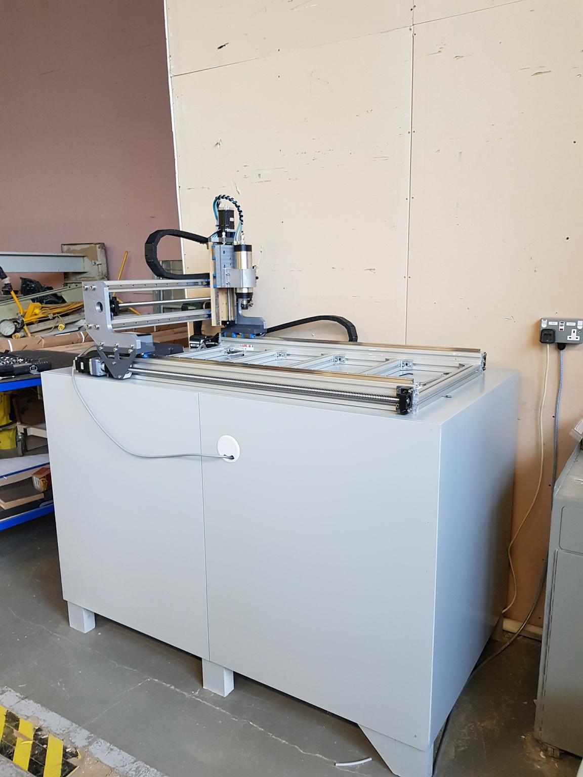

Well guys it may not look like much, but it was a fair amount of working getting to this point:

My Solidworks package updated to 2018 in the last few days, 2018 Professional now comes included with Solidworks CAM - Which is essentially CAMWorks. I spent a lot of time yesterday and today wrapping my head around creating a Post Processor for the DDCSV1.1 to use with CAMWorks, setting up the machine and figuring out tool creation in CAMWorks etc.
As far as CAMWorks goes its a fantastic bit of software, i can just stay in Solidworks and open up the tab, click a button to recognise machinable features and then go from there, once i enter a few more tools into the Machine that are available to use, it will pick out the most suitable tool for the job and generate the tool paths. After this you can visualise them and make any changes etc.
Still need to make some changes to the Post Processor and CAMWorks settings to streamline the whole process but so far its no where near as challenging as i thought it would be.
Now i need to figure out and start researching good ways to reference origins on the machine, i see a lot of people work to the centre of parts, need to do some research on this.
Also looking to get a probe and figure that out with DDCSV1.1.

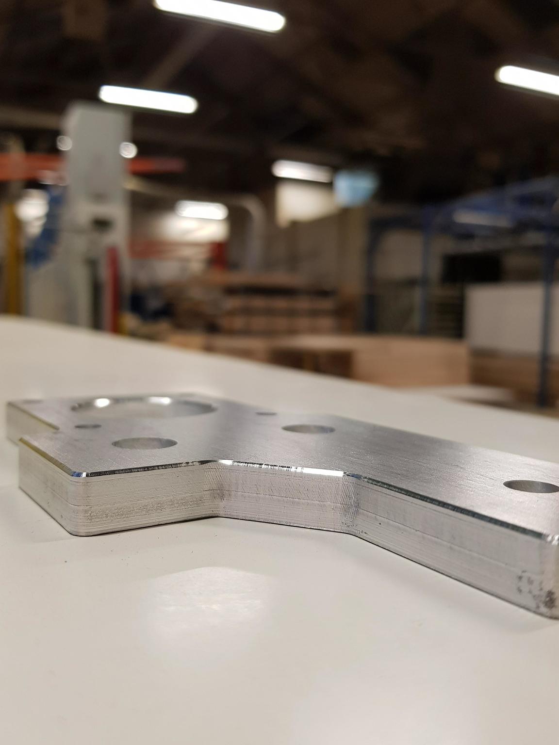

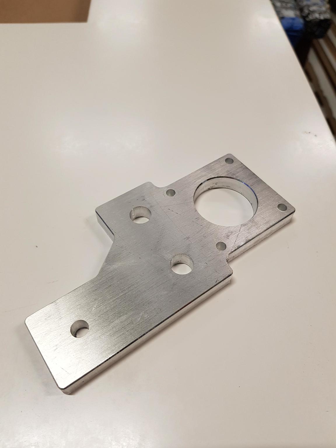

Hi guys, had some time recently to get some more done on the router. I had to get it out of the office and onto the shop floor so made a makeshift bench for it, it weighs about 80kg and is pretty sturdy, i bolted the router to the bench using M8 T Bolts.
Attachment 23905
Attachment 23904

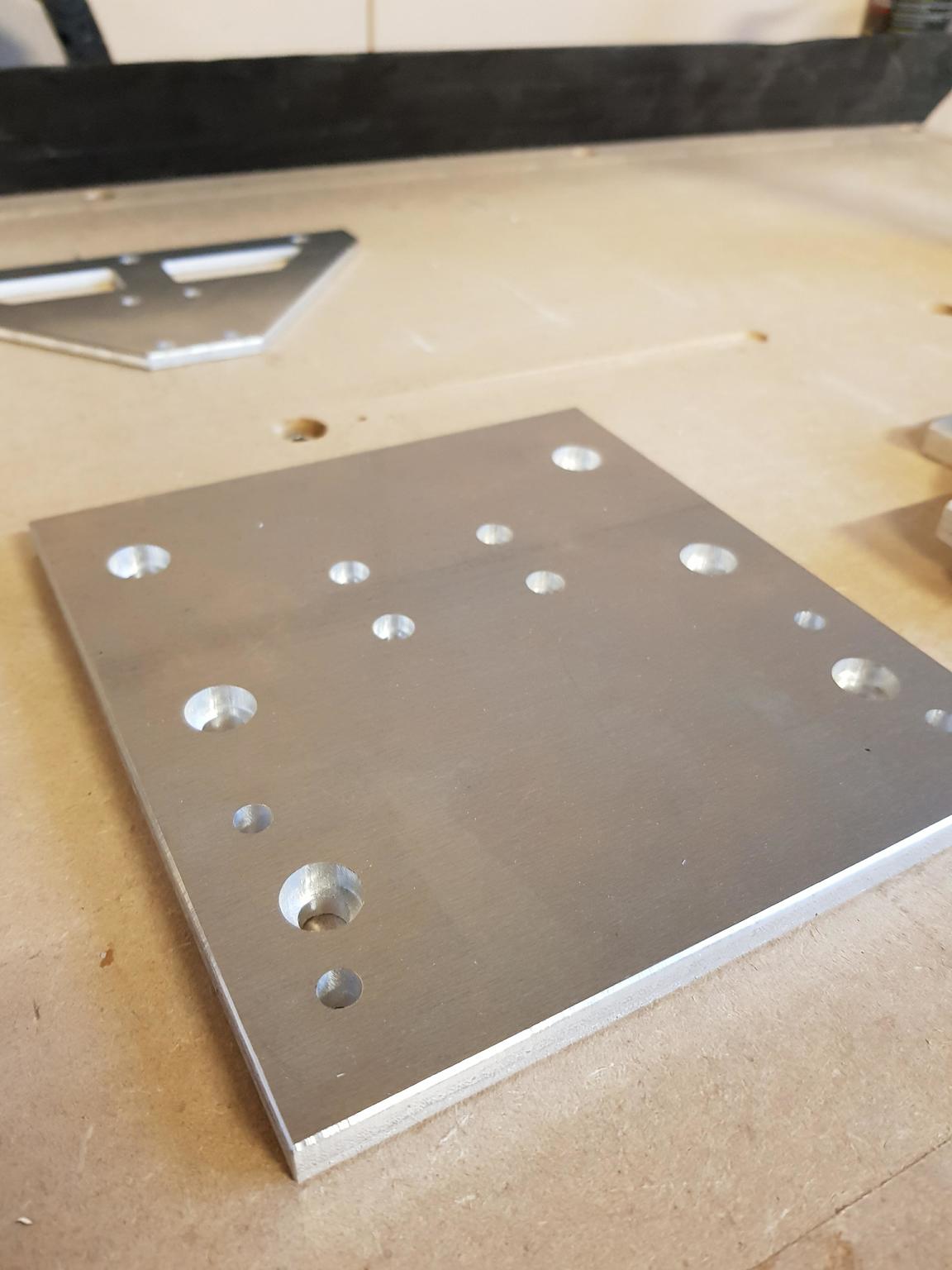

With that done i set to work on the aluminium plates, i ended up purchasing the stock from the Aluminium Warehouse, i started with the most basic 5mm thick plates. It went pretty well, i tried to look at a feed / speed calculator to get a rough starting point but all of them were in inches or didn't actually give me the data i needed, i think i need to hit the books a bit more on that. I didn't purchase any additional tooling as i had a few 5mm Twin Flute Carbide tools sitting around, these seem to perform ok but are terrible at plunging and are very difficult to keep cool with air, i ended up running at 16,000RPM & 1m/min with cut depths of 1mm - as the machine is the opposite of rigid this seemed to "work" but is clearly not correct as a lot of heat was generated and i had to stop mid way through one plate as the spindle sounded as if it was going to stall!
Attachment 23906
Attachment 23907
Attachment 23908

I'm looking for some advice on what tooling i should be using, how to calculate the correct speeds & feeds etc.
Should i be reducing the entire stock to achieve the part, as opposed to simply cutting out the part from the stock?
I watched one video where the guy drilled holes prior to pocketing, is this a good way approach plunging? Or is the a better / correct way to do this.

Double stick tape to hold down and cut the aluminium is a risky way to do the job. Better make the holes first and then use screws to hold down on your table the aluminium plates ,this way you minimize the risk of slippage. ;-)
Yes i know its not ideal, i came across this method online a few times so thought i would try it, it's masking tape on the spoilboard & plate with Super Glue in between, it was actually very difficult to get off :P
First, a word of warning about double sided tape... don't use it to attach aluminium to MDF. I don't think it is a good idea because it doesn't stick well enough and is flexing in every direction. In my opinion double sided tape is only usable for PCB or acrylic, possibly thin aluminium (maximum 2mm) for panels. It is also OK for engraving, but not when you are pocketing or milling thick aluminium or other thick material. Use a vice or drill a few holes and screw the plates firmly to the MDF.
Regarding pocketing, yes, in my opinion it is a good idea to pre-drill large holes. It saves time and material, as well as tools. It is much faster and easier to drill or saw even a very large hole compared to milling all the material, but it requires fairly accurate positioning on both the drill stand and then the CNC bed. I drill or saw a bit smaller then needed and mill it to the final dimension with the CNC. I have a set of drills and circle saws so I can drill from 0.5mm up to 70mm and if I'd need to make even larger holes I'd buy larger (note that the quality is high On aluminium I am using 4 flute 4 or 6 mm diameter cutters, 18k RPM. I am dry milling, not using any lubricant or any spray. Probably it would be better to use something, but I chose not to because of the CNC location (inside my house in an ordinary office like hobby room). Anyway, regarding the cutter, I have no issues with chips welding to the cutter, but I try to keep a fairly high feed rate and it seems to work fine.

Hi guys! It's been a long time since my last post, i had been using the machine steadily for some light work but eventually got round to finishing the Aluminium parts and EVENTUALLY got round to rebuilding the Router. During the rebuild i realized i had made on one of the Gantry Connection Blocks, that interface the Gantry Side Plates and Gantry Base Plates, i managed to "make do" with it to get the Router back up and running, i am going to re-run this part in the very near future.

It took me a very long time to try and make the Gantry Linear Rails as true to the X Axis Rails as i could, unfortunately my only Straight Edge to hand was a length of spare Aluminium - I know this was not ideal, but the run out i was seeing using the Dial Indicator was repeatable using different Ends and Sides of the Extrusion which gave me a slight amount of confidence that the faces were pretty straight.
https://thumb.ibb.co/ndNoZT/20180713_113400.jpg
The Gantry Extrusions were fixed - i would say as straight & true as possible using the tools i had on hand to gauge it by, however i was still seeing almost 0.8mm runout from one end of the gantry to the other, The Gantry Base Plates were exactly the same distance from the Linear Rails on either side, besides this i was really struggling to get the Gantry Rails parallel to the X Axis Rails, after some research i discovered that i might need to shim the rails from the extrusion in order to reduce the runout, this helped in some areas but made it worse in others.
If i performed the same tests but clamped the Extrusion to the Flat Face of the Entry Side Plates then the runout measured was less than 0.2mm from End to End, having spent the best part of 6 Hours on it i decided to leave it there. I am almost certain that something is amiss somewhere, and if anyone had any ideas on how best to measure and correct the runout that would be greatly appreciated, i am hoping to build a mill soon, and i am sure as hell not going anywhere near Extrusions for that!
https://thumb.ibb.co/i1vWoo/20180713_165650.jpg
Once i started to Assemble the Z Axis i realized that Connection Blocks that Space Between the Linear Bearing Blocks and the Spindle Mounting Plate were about 0.4mm too thin, this meant that the Ballscrew and Nut were becoming Extremely Tight at the far ends of the Axis, so i had to shim between the Blocks and the Spindle Plate, now it seems to be moving very smoothly.
I had to drill and tap some holes on the fly to the rear of the Z Axis Base Plate (Forgot about those... doh!) to bolt the Cable Drag Bracket to the Base Plate.
Next i put the Spindle back on and reconnected everything, setup the Limit / Home Switches for the new parts and ran some tests. At a first glance the Spindle seemed to be trammed ok, however i need to get some other bars for my Dial Indicator so i can connect it to the spindle properly and get it dialed in as much as i can. I also 3D Printed a Makeshift Dust Shoe until i can draw up something to be machined from Aluminium.
https://thumb.ibb.co/d3AmM8/20180714_153327.jpg
https://thumb.ibb.co/kZw48o/20180714_170559.jpg
