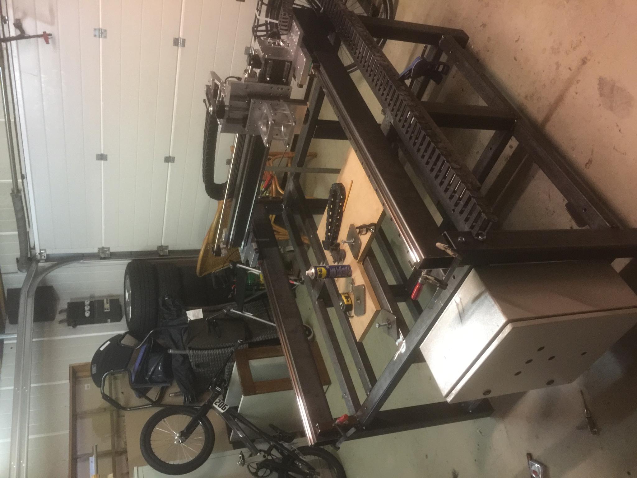

Had a weekend playing with the machine and finishing up a few bits.
Attachment 27441 Attachment 27442
I've used a 75mm cable tray to hold the 62.5mm wide X cable chain and fitted it with 3D printed supports. Looks great, and I think that cable tray size must be made for the cable chain, smoothly fits right in and glides in and out when going back and forth (gosh this post is starting to get a little suggestive...).

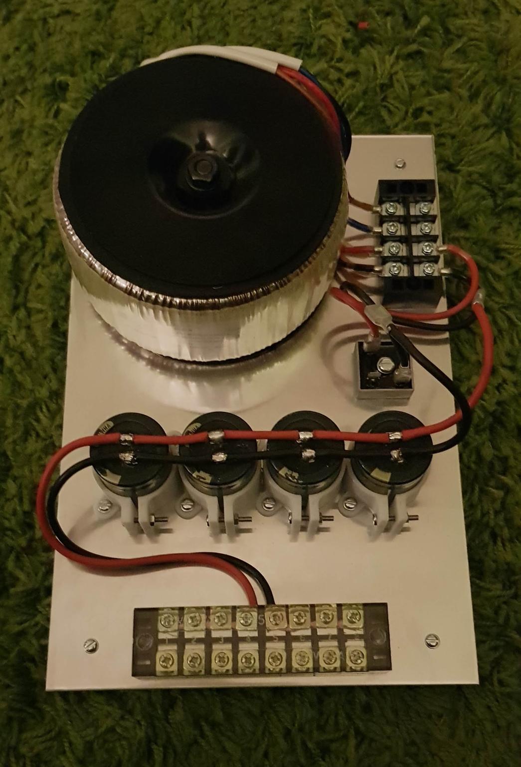

I've tidied up the wiring around the machine generally, although I still need to make a control box for all those switches!
All the limit / home switches are in place and working nicely, again 3D printed mounts. Thanks for the advice on placement Jazz.

Spent last night doing spot drilling on a waste board at all four corners and roughly measuring the squareness of the machine. I should have paid more attention to the above at the time - Its not that the steel frame is a rhombus. The X and Y axis are not quite 90 degrees, which leads to an error of 4mm across the two diagonals. I have a precision angle, but haven't got a way to nicely attach a dial gauge to the gantry yet - Its on my list though!
Initially I'd forgotten the above, and tried correcting by adjusting the home position switches, assuming the gantry was racking. I got the error to 1.5mm (thats 90.1 degrees) on the diagonal, and the next correction stalled the X axis, so clearly I was pushing the ballscrews out of alignment with one another and was twisting the gantry beyond it's limits. That was a big warning sign that I was doing something stupid; obviously the gantry should be nicely aligned to evenly wear the screws and not try to twist against the rails.
Now, I'm not too concerned. Ultimately this just means I've screwed up somewhere along the way getting the squaring on the gantry. Looking at the gantry carefully, I can see the gap between the side plates and the X carriages is slightly larger at the front than the back on one side, and the opposite on the other, which tallies with the rhombus I'm seeing. So I think the main problem is that the carriages are bolted onto the gantry slightly askew. My hope is that addressing this will solve my issue, and mean that without any screws attached my bearings will hit the same point on my rails and remove that earlier error I spotted.
Ultimately, worse case I'll need to remake the bearing plates which those carriages bolt onto (which I already planned to do anyway, I broke a drill bit in one of them so one carriage only has two bolts in - I was kinda hoping I could remake them with the machine itself...!).
I might however do a few cuts with this error in place, just because I'm at the stage where I can start to use the machine for it's purpose, and if I don't get some output soon I think I may get lynched by SWMBO....

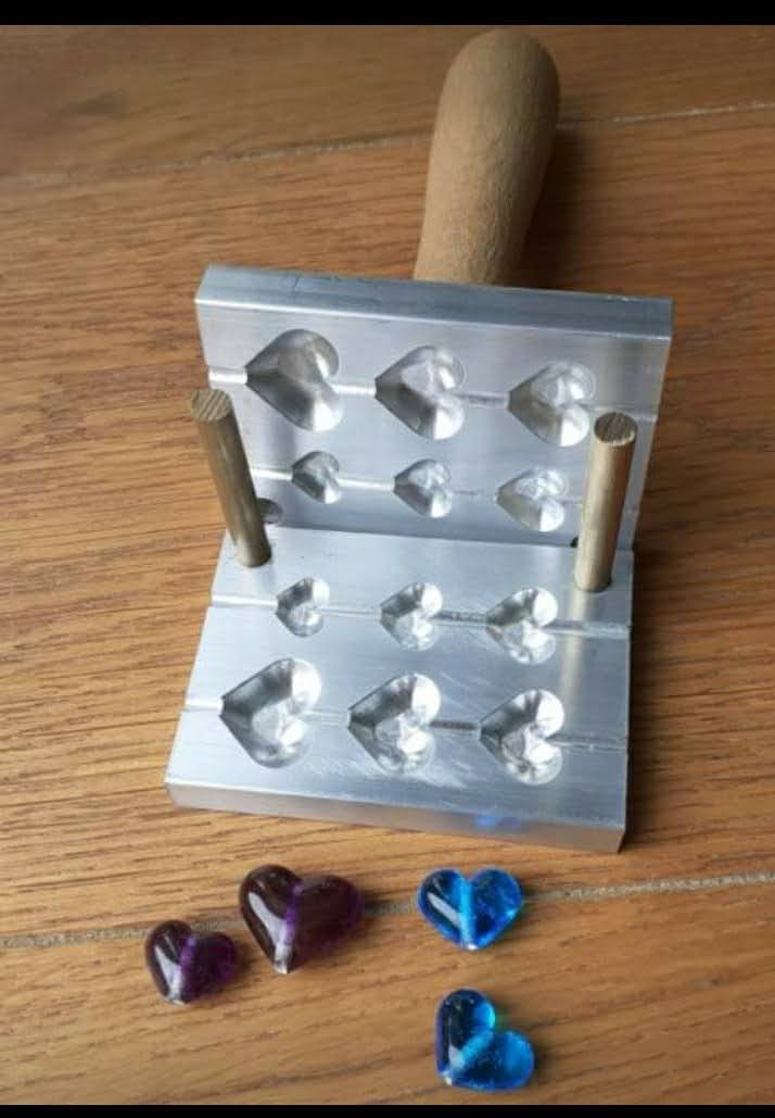

Promised an update when I ventured into Aluminium; its only the smallest of steps, but I'm pleased with the results.
The "client" has requested a lampwork beadmaking tool which could form the molten glass into a heart shape. This is the first in a series of tests; the eventual product will need to have two identical sides to squish the bead into shape, but we've just started with a single side for now.
Tried two shapes, a 3D heart and a 2D heart. I pocketed and roughed with a 4mm single flute endmill at 18k RPM and 1.5m/min. Kept the DOC very low at 0.5mm as this is my first time, but the router wasn't phased in the slightest. Then finished with a 3mm Diameter ball nose, 24k RPM 1m/min. Very basic tool paths from aspire, nothing fancy. Went a bit overkill and gave it lots of air blasts to clear the ships and plenty of WD40 in between!
To give an idea of scale, these hearts are designed to fit within a 15mm diameter circle. Very small.

Nice Job Andy, very rewarding isn't it when you get results like these. Don't be araid to push the machine, I'd be inclined to lower the step over on the ballnose so you get a smoother finish, it could be the pictures but it looks a little scolloped which comes from too large a step over. I use between 3 - 5% diameter on cutters 3mm or less and 10% on anything larger. Takes a little longer but get a nice smooth finish.
Thanks Dean - I used Aspire's default step over, so no idea what it was set to! I'll look into it tonight and get it into that range.
Out of interest, what would you expect to see DOC wise on a router like this with a 4mm single flute? APT suggests slowing down from those parameters once you're over 1.5 D, but I assume that advice is really for mills; 6mm felt like quite a big chunk to be taking.
Ye aspire is mostly based on wood which is a little less forgiving so any small scollops can be sanded away but in Ali you want a smaller stepover for the best finish.
Difficult to say because every machine is different, spindle power and rigidity plays a big part. If it was me I'd start at 50% D and feel your way down. Or just go for it turn the spindle up to full RPM so you are getting Max torque then go with 1.5xD and play with feeds n speeds.

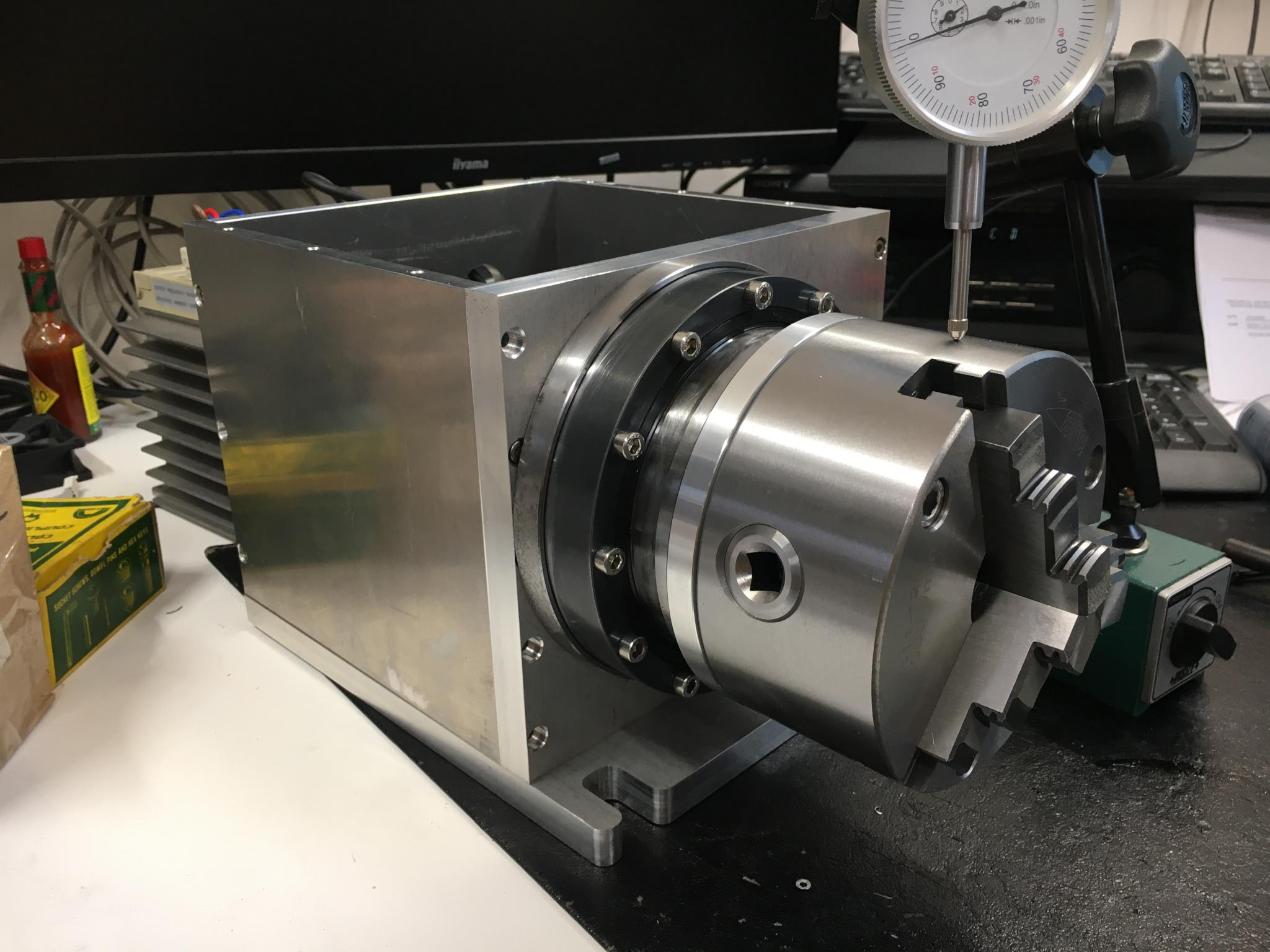

Not sure if it's quite what you are after but I've just about finished a fairly conventional 4th axis using one of the harmonic drives and a servo motor, all culled from one of the Korean scrapyards. Looks good so far - had it jogging yesterday.
This is for a metalworking milling machine, so has a 125mm 3 jaw chuck which I have bored through 36mm, so I can hold long stock.

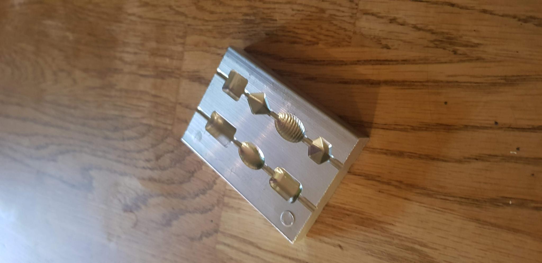

Quick update to the Aluminium Bead Presses. Other half demanded six sizes of the 3D hearts in both a horizontal and vertical press. Settled on a 0.2mm step-over - we did some tests lower down but whilst the finish was buttery smooth the tooling marks arn't translating into the glass, so decided this was a good compromise (or if they are, they're soon rounded up by heat). Getting some great consistency out of the presses, so happy customer :)
Attachment 29030 Attachment 29029 Attachment 29031
We're now exploring other shapes.... (The ribs are intentional - not poor machining!)
