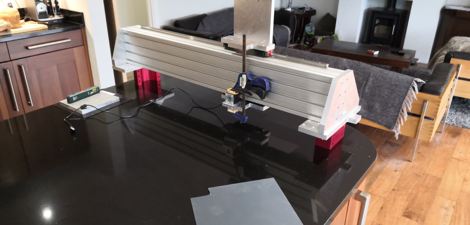

One other thing that occurred to me, how did you ensure you moved the sensor/vice assembly absolutely in a straight line? Any deviation in this procedure would show up as non-linear errors in your linearity measure since it would have been impossible to get the laser perfectly planar with the granite. This applies to both types of laser dot and line. I think you need a precision straight edge as well as the reference surface to check the accuracy of the system.
Re: DIY Laser levelling using webcam and laser level
devmonkey
I used straight edge clamped to the granite, just as you said.

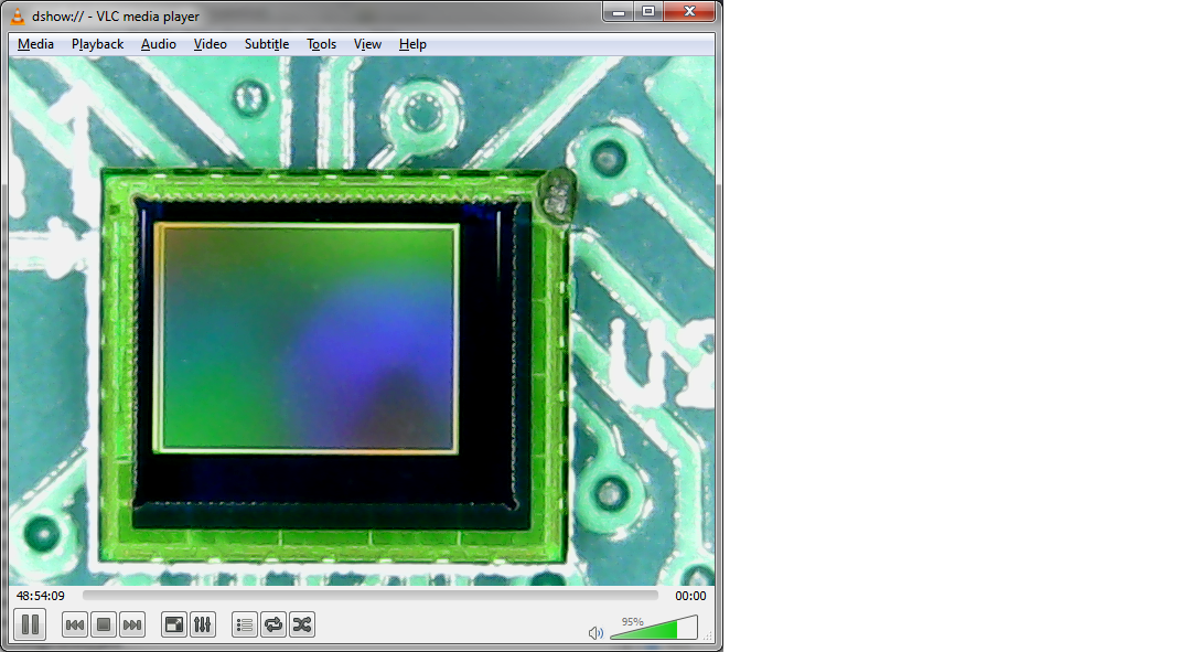

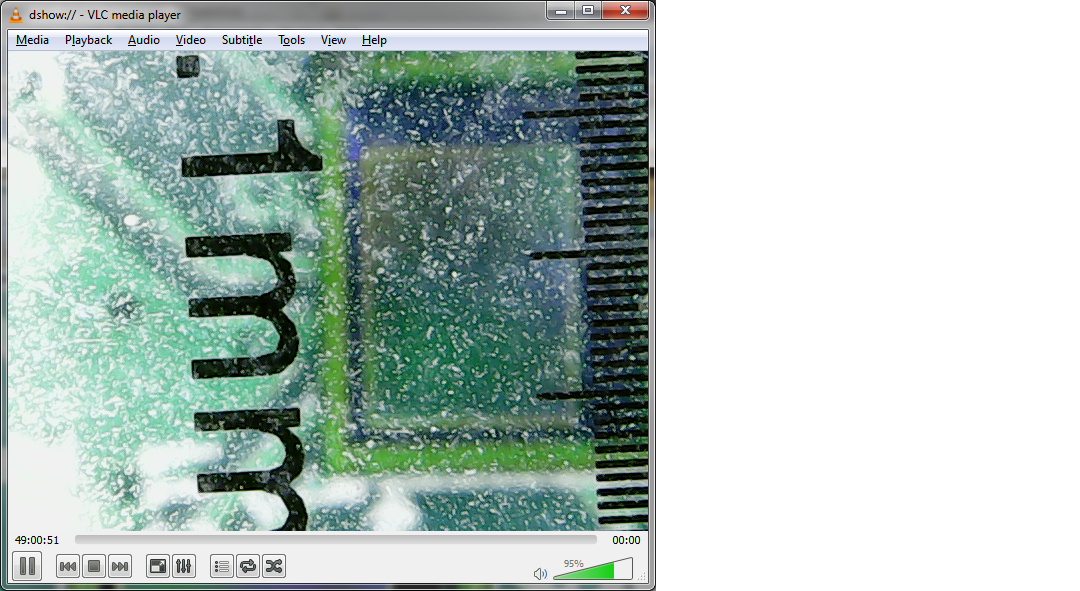

Cheap webcam arrived, useless with lasers, sensor is smaller than the beam, will test it with wire when it gets here.
Sasquatch
Sounds like your laser is no good, can you post a picture of it? Even my dewalt laser level produces a line narrower than the VGA sensor.

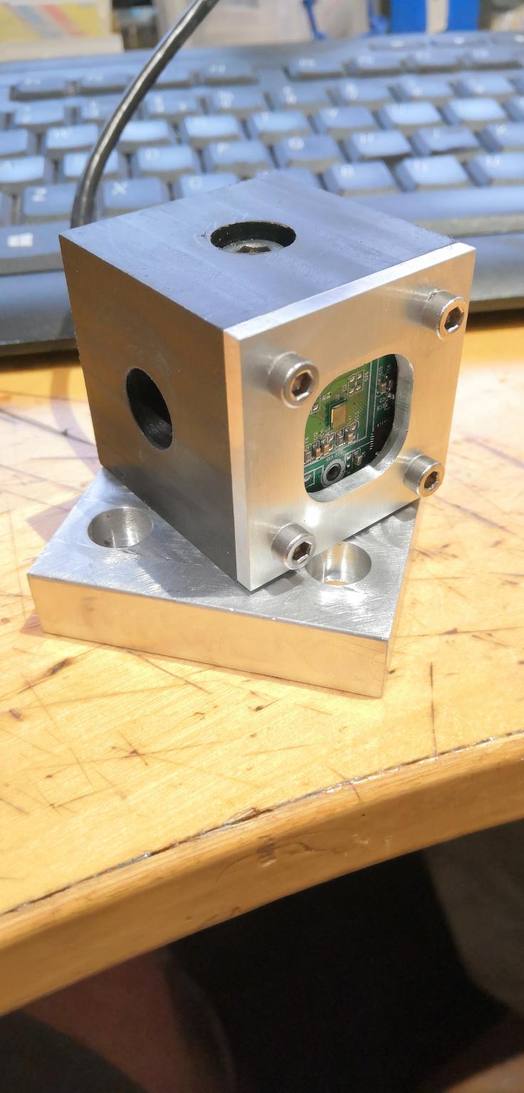

4 Attachment(s)

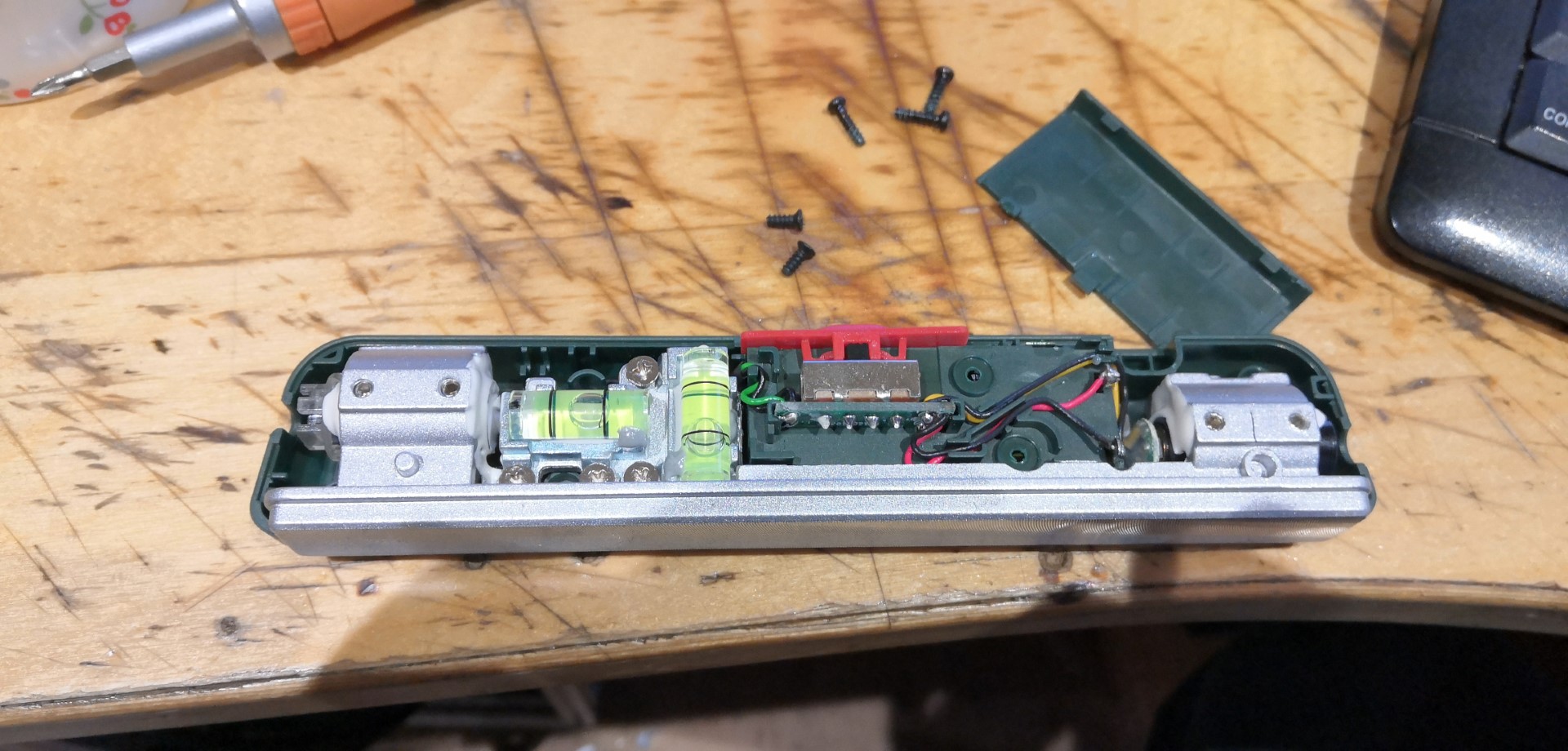

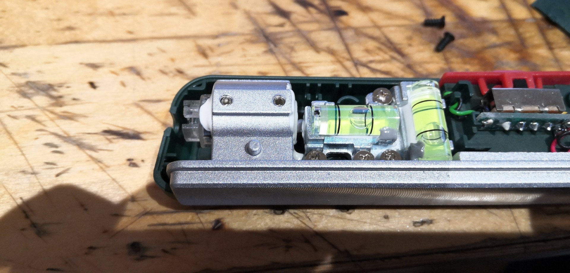

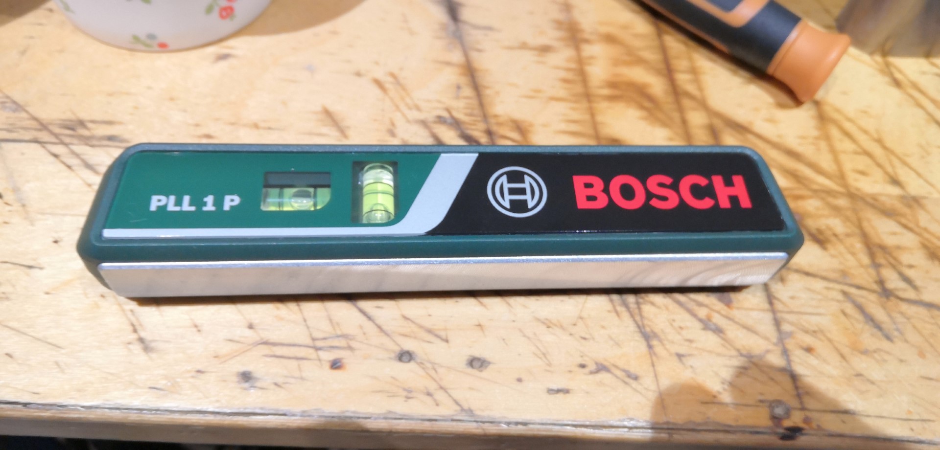

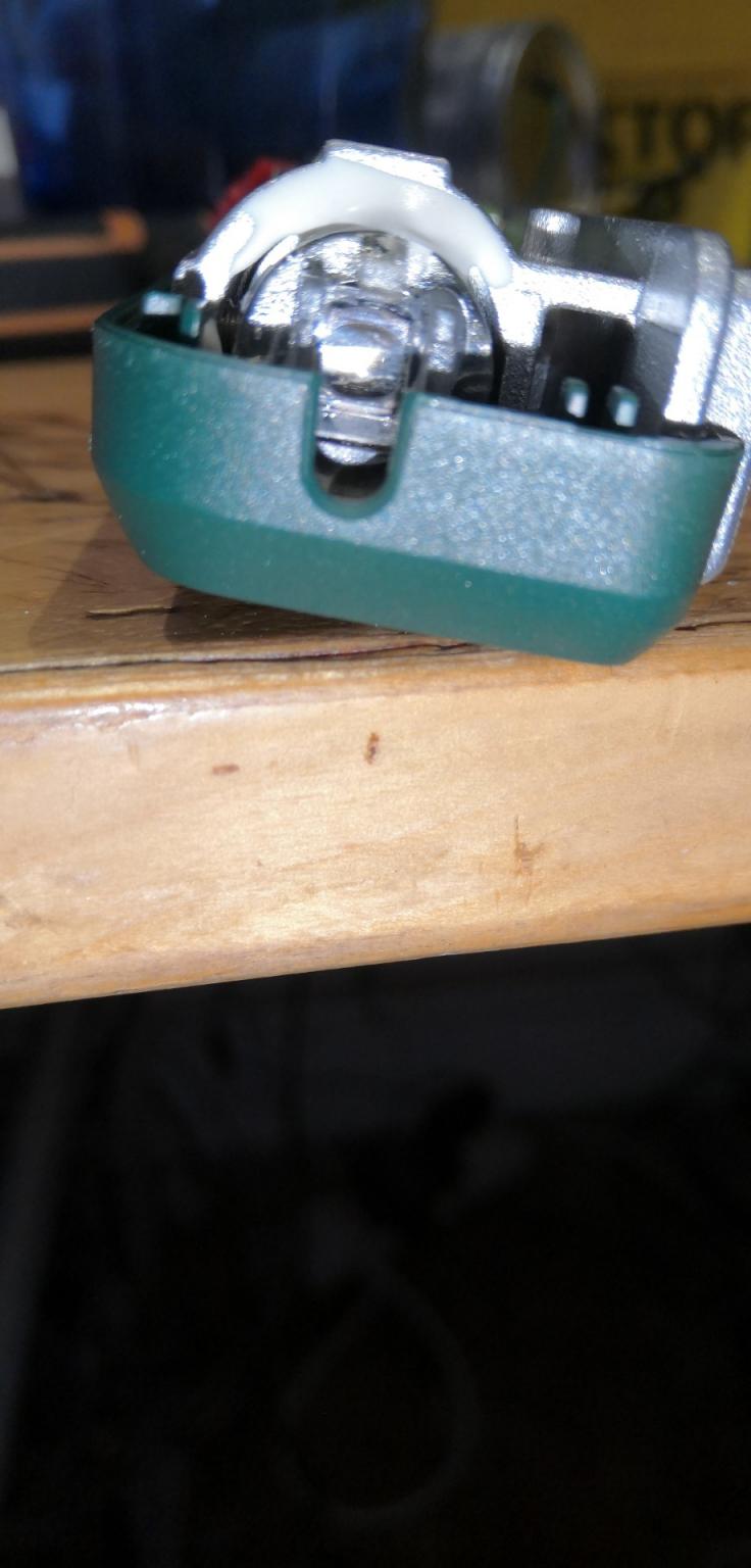

I took a punt and picked up a cheap (Ł25) Bosch laser today. Main reason was I don't want to tear apart my Dewalt and remove the lasers from the pendulum which I think would be required for our purposes. The Bosch unit has the laser firmly mounted into an aluminium chassis, it is actually quite a decent unit. The laser has a cylindrical lens albeit made of plastic. The lens produces an asymetric line, much more line to one side than the other, but I think this is by design as without the pendulum you couldn't use it to level across a transverse wall as well as the wall you have fixed it to, I think it is inconsequential for our purposes.
Anyway I ripped it apart for your pleasure see photos below. I have also tested it with my levelling software and it works very nicely, I think the laser line is slightly thicker than the dewalt but the app can still consistently locate the centre. It is sufficiently solid, from the exposed casting right to the laser which is both clamped and glued as is the lens, to clamp it directly to something in the garage, the laser will not move at all relative to the chassis which is ideal.
Over the next few days I'm going to attempt to map the surface of my new machine frame I'm building on my other thread using this system, will report back with the findings.
Attachment 26995 Attachment 26996 Attachment 26997 Attachment 26998
As a bonus it has a dot laser in the other end which I can maybe use for straightening the master rail.

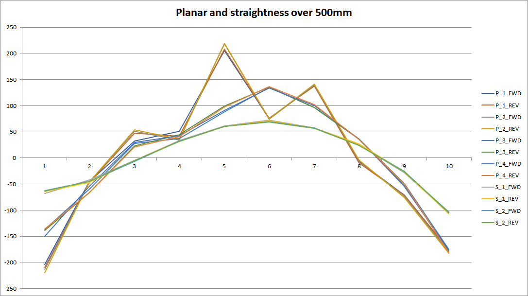

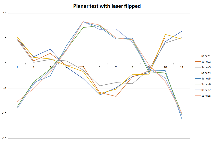

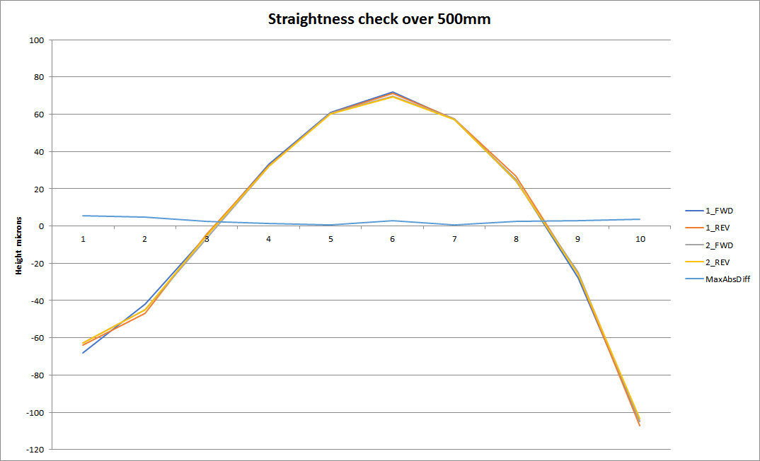

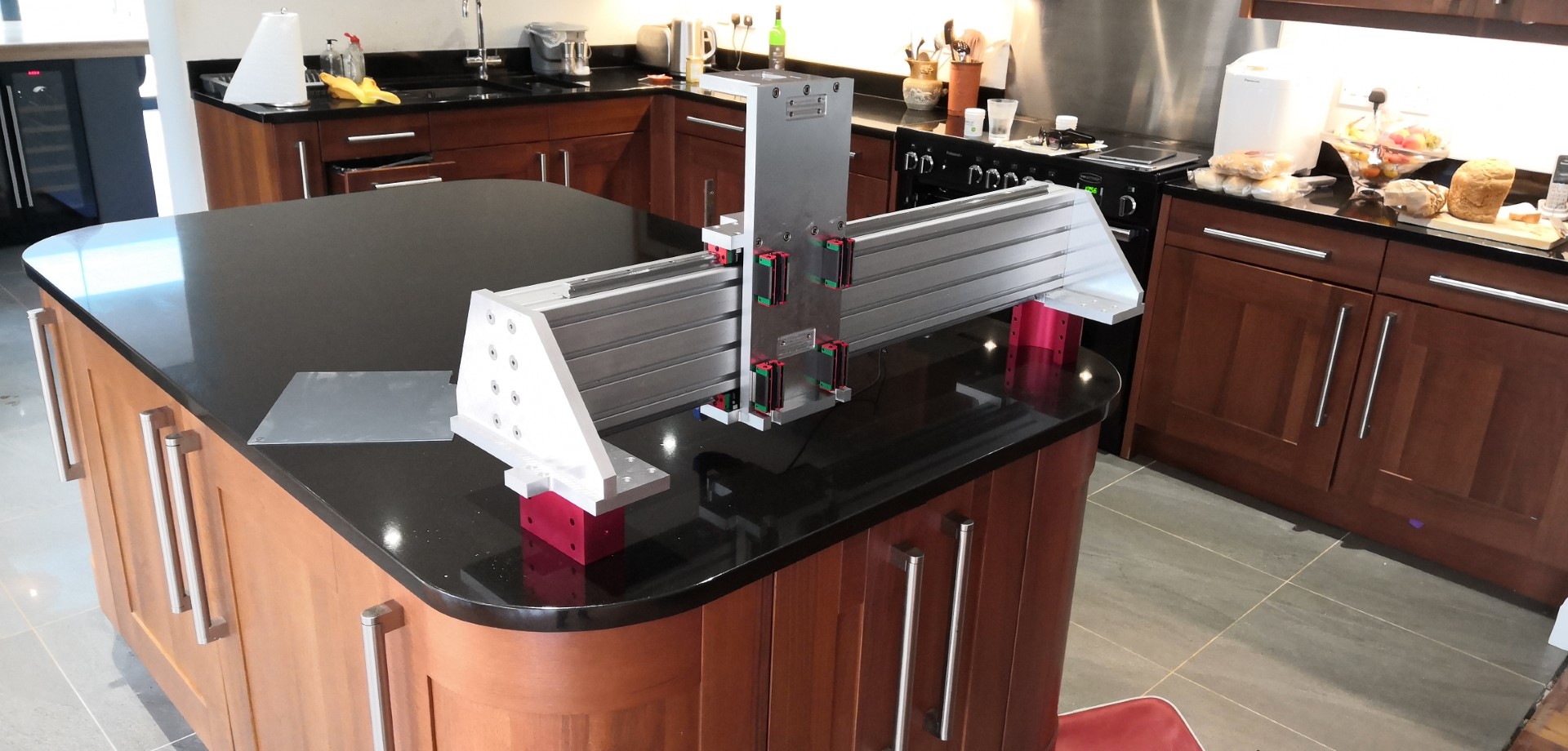

5 Attachment(s)

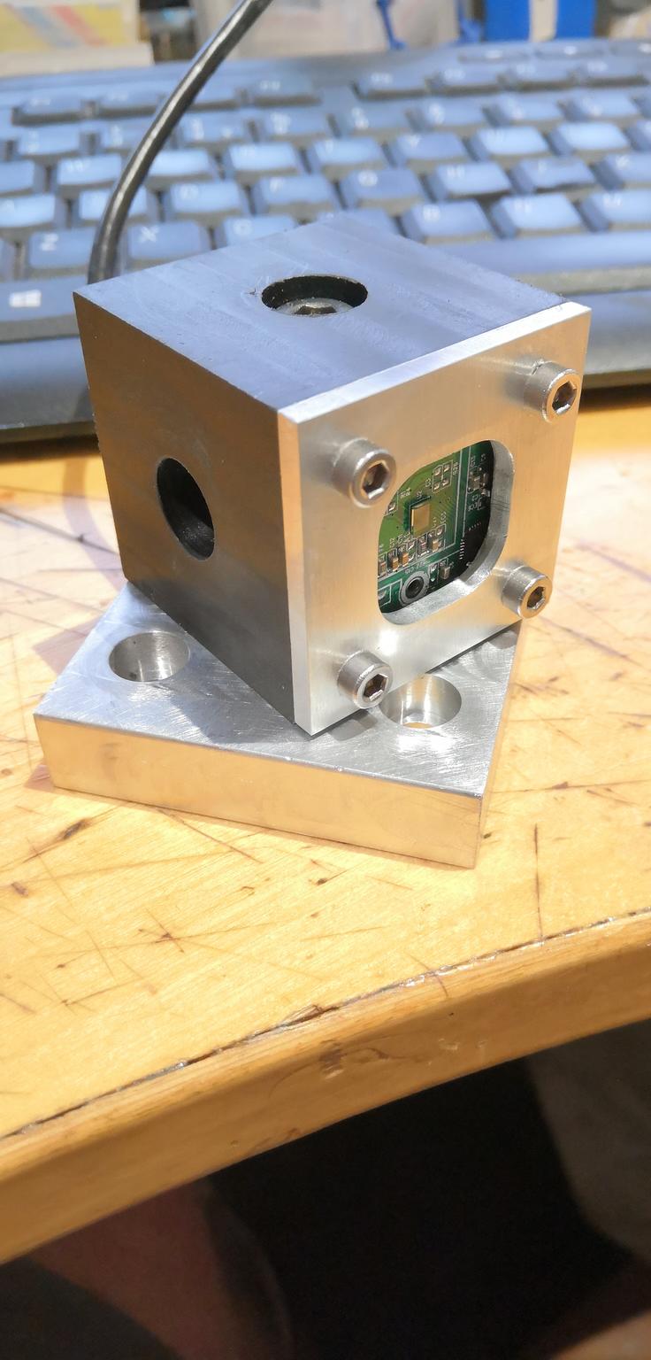

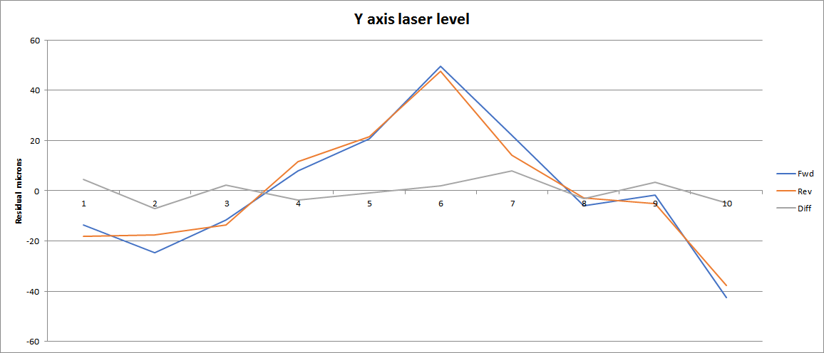

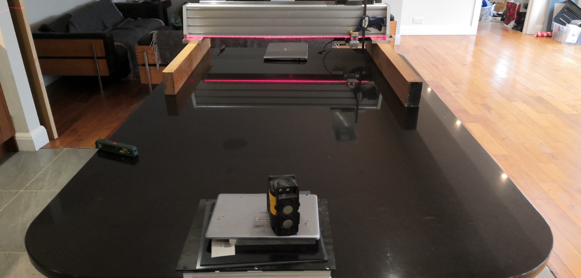

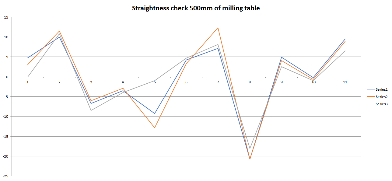

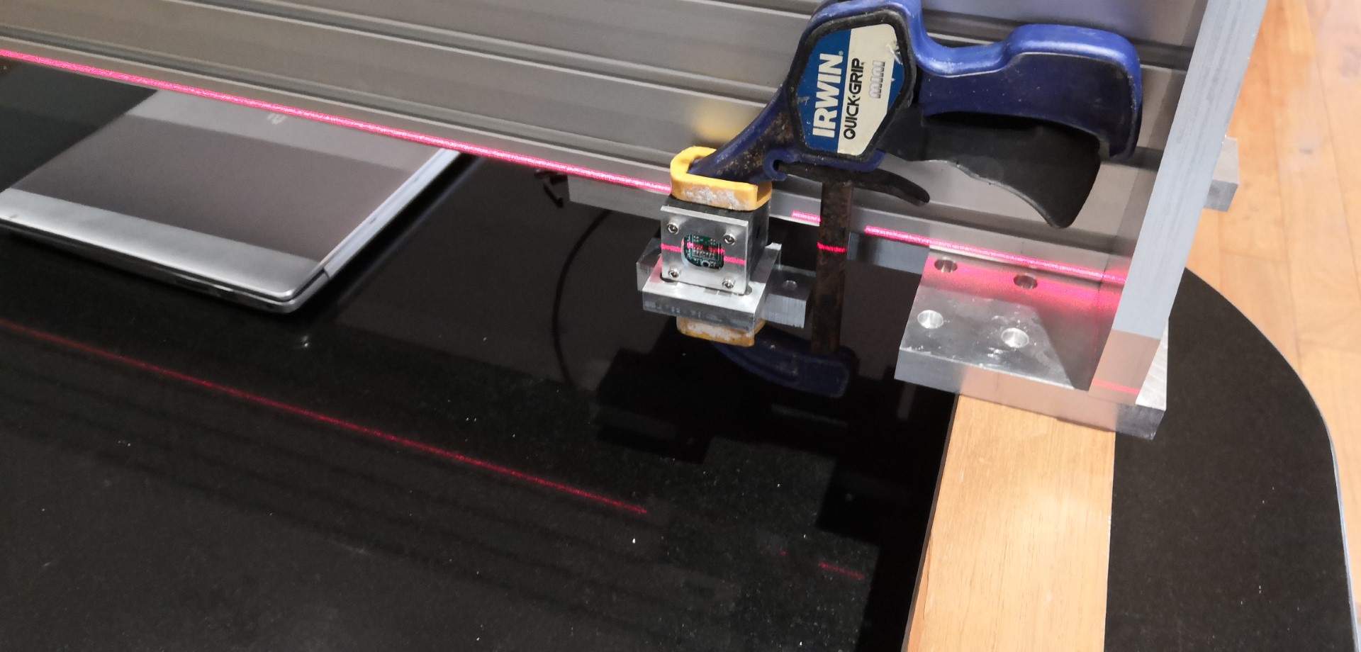

This morning I had an empty house so I grabbed the opportunity to do some testing. I used the dewalt laser and my mostly completed gantry, the sensor was clamped to the rear of the lower Y bearing plate and both laser and gantry placed on a 1inch granite slab (kitchen island). Initially I raised the gantry to clear the Z axis on parts of the spindle mount but it turned out these are not machined with parallel faces on each end and I could rock the gantry a few thou, so swapped them out for two hardwood beams.
Attachment 27001 Attachment 27002 Attachment 27003 Attachment 27004
The test involved two passes in opposite directions moving the Z axis one hiwin bolt hole (approximately by eye), these are on 60mm centres, and sampling the sensor at each hole, I took 9 samples per pass, so around 500mm of travel for each pass. The residuals from a straight line were calculated by the app for each pass.
The two passes (with second reversed so they can be overlayed) are charted below, together with the difference between the passes.
Attachment 27005
The two passes were fairly consistent given the eye balled positioning I used, and that I hadn't clamped the laser nor the gantry to the granite. Worst case absolute error between the passes was 8 microns (0.31 thou). The sensitivity is ridiculous as I could flex the granite plate more than this by pressing on it.
However it can be seen that the either the gantry or the laser or both are not perfectly straight with a max variance of +/- 40 um (1.57 thou). The results are satisfactory however we return to the problem of not knowing if the laser line is straight, question is do we care about a couple of thou?
Unfortunately I ran out of time to repeat the test with the Bosch laser, I will need to setup this experiment on the concrete garage floor. It is a waste of time trying to do any measuring if people are moving about in the house as you can see every footstep within 5m move the sensor reading.
I also noticed that the laser form wasn't a very good gaussian and near the edges of the dynamic range, i.e. where the laser was starting to drift off the top or bottom of the sensor, the beam centre looked quite arbitrary to me, I think I may add a new detection mode that finds the centre based on the maximum local average reading.
A couple of other points of note,
1. ~2mm dynamic range of the vga sensor is not very much, it would be easier with a sensor with large area.
2. dust on the sensor has an impact on the readings if the particle is large enough.

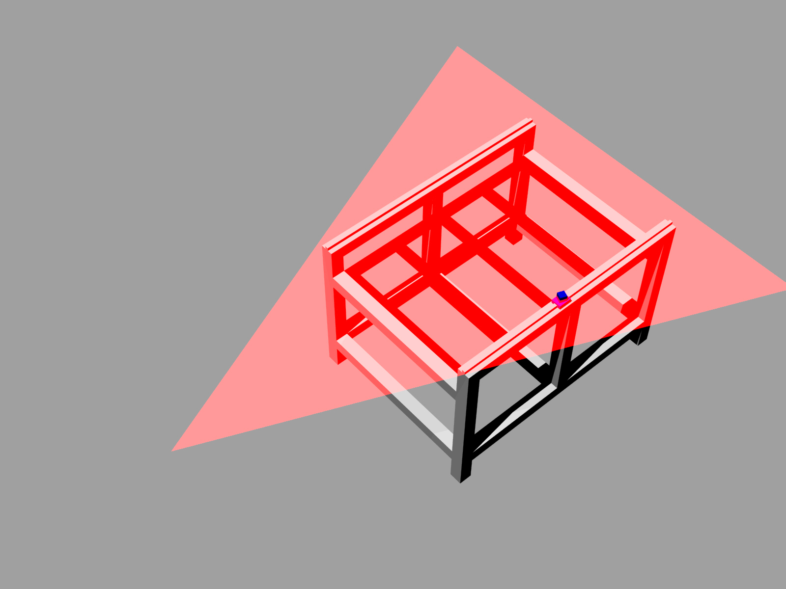

Forgive me jumping in (and apologies if I've missed something) but is the geometry of the measuring setup ideal? As mentioned, the measurements are dependent both on the straightness of the rail and of the beam itself and it's not really possible to separate out the two. If you turned the sensor through 90deg so that it looked along a line parallel to the gantry, and placed the line source just off the end of the gantry but with the laser line intersecting the sensor, you would then be moving the target down the length of the beam (straight apart from gravitational bending!) rather than relying on the optical quality of the cylindrical lens generating an accurately straight line. However, you would need to get the laser line horizontal to reasonably close limits both on the roll and pitch axes (if that makes sense).
When I first started following this thread I had a picture in my mind of a point laser shooting a beam parallel to the rail being measured and striking the sensor in the middle. What I have described above is really only the same thing but using a line source to make lateral alignment less critical.
Or I might have missed the point but I do find this whole exercise very interesting to follow.

Hi Neale,
That works fine for checking something is straight, what I'm trying to do here is build a system that can check things are planar, e.g. for bringing the two X rails into plane, hence the line laser.
One idea to separate the gantry error in this test from the laser error is to run the test twice with different sections of the laser line.
I've just tried a much better detection algo, what it does is find the simple maxima of a moving average window of image rows, it then fits a gaussian to this window only, ideally it would just fit a parabola but I haven't coded that. Readings are now much more stable across the entire dynamic range and it works better with wobbly beam cross sections. Just need to migrate to the cold garage to test it.
So I ran another set of tests directly on my granite island without the gantry, all tests were with the cheap Bosch laser. I ran 3 tests, each measuring 10 stations over 500mm with the laser position moved between each test. Each test consisted of 4 runs, 2 forwards, 2 reverse.
The laser was positioned as follows for the 3 tests
1. Planar test with laser orthogonal to ruler taped to island from a distance of 1.5m so the laser line spanned the ruler.
2. Planar test with laser in same position as (1) but rotated 45 degrees to test a different section of the laser line.
3. Straightness test with laser inline with the rule, i.e. shining along the rulers length.
The idea was that 1 and 2 would test different parts of the laser line arc (say 45 degrees of arc per test), whilst test 3 would use only a tiny part of laser arc, less than 1 degree. The test surface is a granite island that most likely isn't flat but is stable, flatness doesn't matter here as we are testing the laser not the island.
Consistency between the runs of each test was very good, with an peak-peak repeatability error of a few microns, likely due to me eyeballing the station locations against the ruler markings.
The chart below shows the results, overlayed on each other. You can see at a glance the 4 runs for each test are highly internally consistent but that the results vary considerably between tests 1-3. All are parabolic suggesting the granite island has a parabolic surface error of around 100 microns. The jagged line group is test 1, the slightly lower group is test 2 and the lowest group is the straightness test 3.
Attachment 27009
So this is telling me that the laser line generator is not very straight and has a parabolic nature to it with more noise in the test 1 arc than the test 2 arc.
Since test 3 used a tiny part of the laser arc and light travels in a straight line I think we can assume the test 3 line accurately reflects the true surface straightness of the granite island.
Separated out this is the chart for test 3.
Attachment 27010
So (although I cannot be 100% sure without a calibrated reference surface) I think this system is suitable for verifying something is straight. This means it can substitute for the usual straightness test of using a precision level to straighten a rail in the horizontal plane or a tight wire to straighten a rail in the vertical plane. However it needs a better laser or a different approach for checking two things are planar.
I have done a bit of research on how this is done in the optical metrology industry and although they use exactly the same approach of measuring height deviations from the test piece to a planar sheet of laser light they also without exception use a rotating laser rather than a line generating lens. Infact they use something called a penta-prism which bends a laser beam 90 degrees irrespective of the the angle of incidence of the beam to the prism. This means so long as the laser is fixed solidly and somewhat vertical as the prism is rotated above the beam in a solid bearing you will cast a perfect plane irrespective of bearing runout or laser prism miss-alignment.
Unfortunately penta-prisms with a few arc-seconds of accuracy are rather expensive. If you use a cheap less accurate one then you could well be casting a cone rather than a plane as you rotate the prism.

One final test, I repeated the straightness test on my milling machine table, again 10 stations over 500mm, 3 runs again eyeballed off a ruler bolted to the table. The table is pretty straight within +/- 0.01mm over 500mm.
Attachment 27011
It is certainly much straighter than my kitchen island !
I did this test very quickly and it wasn't performed perfectly, for example the laser was really too close sensor meaning that the sensor was saturated or nearly saturated around the beam, this would lead to a little inaccuracy as the maxima is effectively on a flat peak, it would be better if the laser was further away reducing its brightness.
So I have 'borrowed' a much higher quality line laser with decent optics, and believe I have verified that line lasers are not straight. Setup was with the sensor on my milling table moving along 10 stations over 500mm against a ruler that was clamped to the table. Note the sensor was moved, the table was stationary to avoid any rocking on the saddle block.
The laser was setup in a fixture about 2m away so that it projected its line across the top of the table hitting the sensor. The fixture allowed the laser to be rotated so I did 4 runs then flipped the laser 180 degrees axially (so the projected line was now inverted wrt the first runs) and did 4 more runs.
I think this suggests that this laser has a parabolic error in its cylindrical lens or the lens alignment, what do you think? Chart shows all 8 runs, you can clearly see two groups of 4 parabolas, one group the inverse of the other, this parabolic error is greater than any error in table straightness.

Whilst replying on your build thread an idea came to me. I'd be interested in comments on it's practicality:
Could your laser leveling camera and software, possibly using a taught wire as John is doing, be used to measure the height errors as a gantry machine moves along it's imperfect rails and edit the Z axis G-code to correct for them in much the same way as a probe is used to measure and correct flatness errors in PCB cutting?
In this way a machine of modest accuracy could be used to build parts for a better one. I'm thinking specifically of jobs like grinding the top of gantry profile as you have done for your build.
Initially I'm thinking of only flattening a linear cut as above but since your stated aim is making planar measurements is it reasonable to think of correcting over an area in order to turn plain old ally plate into something approaching tooling plate or even turn a piece of granite worktop into a reasonably accurate surface plate?
Kit

Yes you could try to calibrate the machine rather than align it, same as you do for pcb milling which I've used very successfully on very inaccurate machines in the past. It would be more complex if you are hoping to improve 3D (PCB being 2D) but still possible to gain some improvement.
