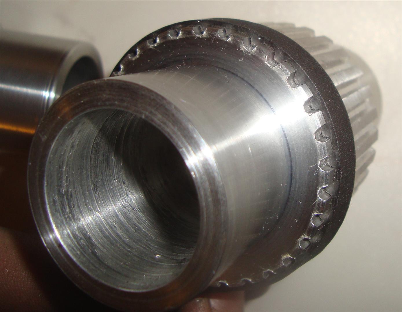

Attachment 4227
I use HTD 5M often and they do not have sharp edges, maybe you should smooth it a bit just to keep belt happy?

As far as the HTD5 rounding, Tom, you are right. I assume most of people will cut them on 4rth axis or indexing head. Anyway below pictures of the absolutely correct profile and size of the 30t puley. I have parametric model that have drawn of HTD5 so if sb say wants a 300T pulley up to specs just drop me aline and will send you a DXF. But here i include the DXF for 30T pulley, the passing hole 27mm and shaft 35mm, needed for the important part in the rotating ball nut. So you can base your drawings correctly.

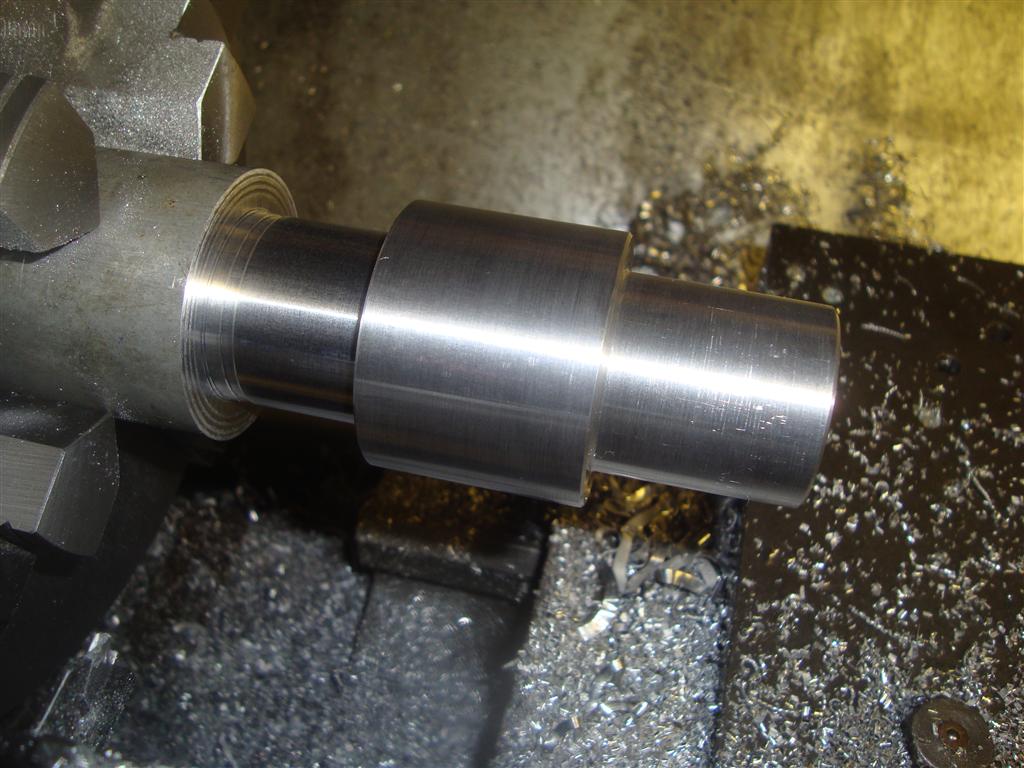

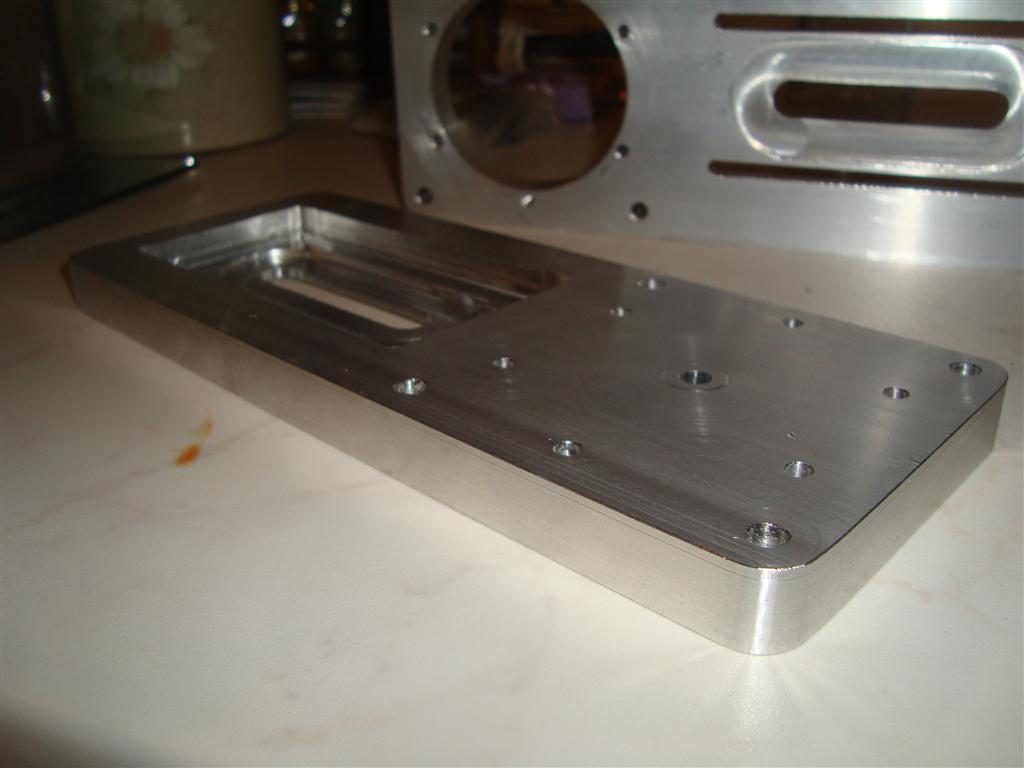

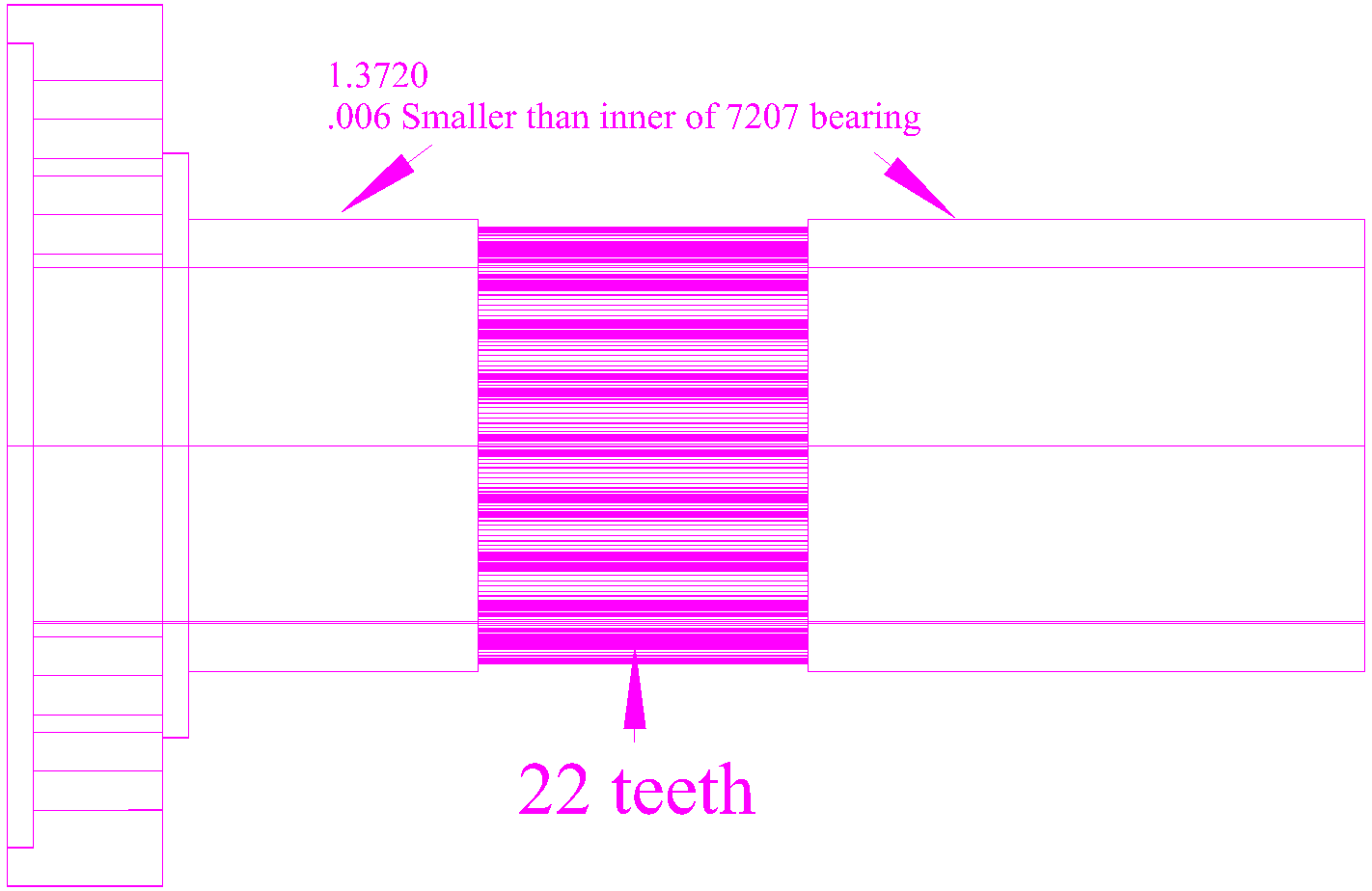

Hello to all. I need some advice. I finally got back to tackling the rotating ballnut. After drawing on turbocad the htd gears on th shaft that fits into the bearing box/block(Shaft with gears machined on it with head piece that attaches to the ballnut) I realized that the 7207 2rs bearings will not fit over the machined gears or the large round headpiece that attaches to the ballnut. If I just find a larger ID like 47 or 50 angular contact bearing with 80 or 90 OD, can I substitute it? Of course I'll make the bearing box accomodate it. Thanks Mutzy
Re: Rotating Ballnut - design ideas
mutzy
Hows that will not fit? Over no, but there is a sequence of pressing the parts together. That's why the pulley is bored from a separate pulley and then pressed together. if you machine right on shaft, then you will have to machine a smaller pulley so the bearing passes on top of it. But then the ball screwe size pass trough hole, so you will have to check if that's at all possible. I believe it was possible but not sure now. Have to check

Attachment 22973Attachment 22974 Can't I just get a larger ID bearing for near the machined on gears to compensate for this?
mutzy
I could explain deeper why not, but isn't it easier to bore 4$ pulley than machine a complex part and buy twice as expensive bearing for which you will need bigger aluminum housing which is also more money?????
I would say generally No. The short answer is: do as i suggest, its best for many reasons or before jumping to buy bigger bearing, just sit down and make a detailed inertia calculation, what snappiness of the machine you need, what will be your maximum speeds and so on. And if that will change the motor you need to bigger!
Why? lets have as an example my machine 8x4 / in reality 1300x2600mm in metric/. If you invest in long ballscrews you generally make the machine right. Which means the gantry will be heavy around 180 to 300kg. If you gantry on that span is less than 160kg, then go with Rack and Pinion as that means your machine is not made to cut aluminum, so save yourself the trouble.
Generally if one is there already, one will use servo motors to move the gantry. But next is even more valid if steppers are used.To obtain the right speeds of the machine, the screw will be xx10 , best is the 2510. No need for bigger screw.
So most probably a gearing has to be used or bigger servo motor. Which means much more money if motor is not Chinese.
Also i have found that with normal servo motor the most desired ration is like on mine machine 20t:30t. fast enough and geared enough. It gives me a machine that has 307.2 pulse por mm ---- 1/307.2=0.003 mm resolution with maximum speed 20m/min . In reality that speed is 30-40 as my servos can spin to 6k rpm instead of the normal servos 3k rpm
Anyway, if you feel like, of course there are bigger bearings. But it seems easier for me to preload correctly 2x the same bearings than different sized ones.

Boyan, were you able to put some brain cells around the idea of keeping the same number of teeth, but lowering the overall height of the machined gear?

From table below we see that without changing anything, these 3 sized pulley will be possible to incorporate ion the rotating part without further change of components
Attachment 23016
So from these 3, it seems the best will be the P22-5M-15F . 22t is not so bad, outside diameter of the teeth is 35.01 so basically same as the 35mm of the OD of the part and the ID of the bearing. That will work.
Attachment 23017
Not to have in mind that 400w servos and bigger have shafts starting from 12 if not from 14mm in diameter. So smallest pulley there could be even the 12 teeth, also 14, 16, 18, 20. But in reality could be also 13, 15, 17, 19, as i can draw the pulley with as many teeth i would like to and it suits me.
from my Favourite belt calculator https://www.bbman.com/belt-length-calculator/ having in mind minimum distance from motor shaft to center of pulley is 90mm, and if bigger than 400W servo even 100mm, we could see that:
12t puley is No good, less than 6t engagement
But all puley more than 13t including are ok. Now it should be considered that the bending radius of 13t puley is too small, this for the durability of the belts. And believe me it will generate heat on the belt and pulley. But as belts is 3-4 $ its not of a great concern.
So yes, it could be done. 13t pulley and bigger.
now when you divide 22/13 , 22/14 etc. its not a whole number which i dont like. the first one that divides well is the 22/16=1.375 so nothing has to be rounded, 16t pulley i see as a minimum for a good bending radius. So that would be the one i would have used.
Obviously 2x 750W servos at both sides will do the job and if something extreme is desired even bigger could be fit. having in mind gantry around 180-250 kg and max machine speed at 30m/min with acceleration around 3000m/s2 which is my machine tested and it really rocks. You should do calculations again for the specific scenario but more or less thats it.
Also all time i am speaking of Samsung servos and brand servos in general. I have never tried the chinese servos but i think they will do well also. Plus really they are almost same price bigger or smaller/ servos must be correct size, not bigger or smaller /.
It should be noted that when i am engraving small stuff i lower the acceleration at 1000, talking about aluminum stamps and so. But this is very delicate work which normally is done on a mill.
I think that answers your question.

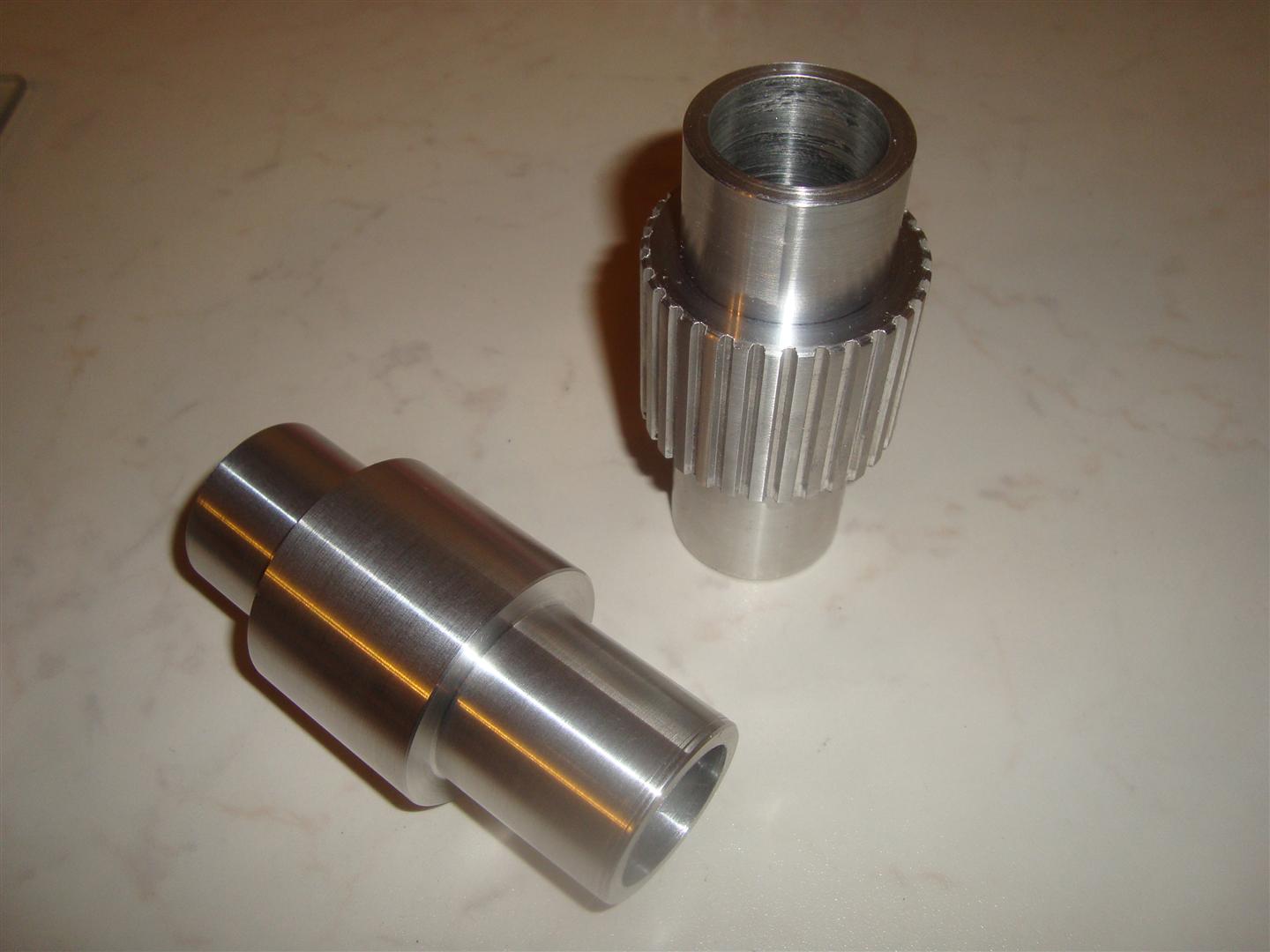

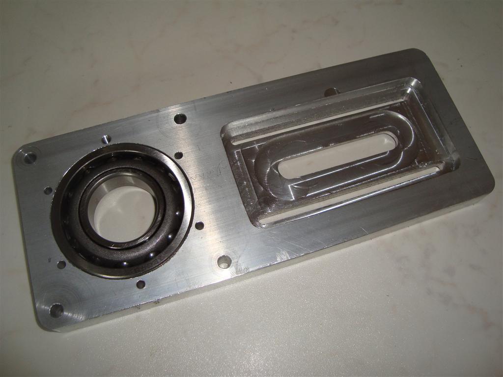

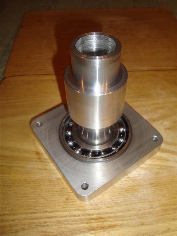

2 Attachment(s)
Boyan, how are you? sorry it has been a long time. I got the 22 teeth HTD drawn onto the shaft. The shaft is only .05 in thickness. is this too small?
Attachment 23460Attachment 23461

mutzy
I think its too thin. The clearance from screw has to be no more than 1mm, in fact mine is 1mm. so inside bore will be 25+2=27mm.

So boyan, 22 teeth will not work with the 1 in ball screw. Anything larger will not let the bearing slide over the gears.

Still working on it Boyan, and thanks for all your help as well as Jonathan. I made the Inner diameter of the RBN to be 1.0787. That would be 2mm of space for the ball screw as you suggested. Then I made the outer diameter of the RBN to be 1.3720 in which is about .006 smaller for the 7207 to fit nicely. Still as you can see, at the HTD gear part, The wall is about .0421 in in thickness. I think since both sides of the gear are attached to 1.3720 it will be strong enough. What do you think. MutzyAttachment 23481Attachment 23482Attachment 23483
Just over a mm wall thickness. You might get away with it in steel, but I'd expect aluminium to sheer.
By the time you consider axial loading due to bearing preload/dynamic loading, then the belt/nut causing some sheer/twist/radial loading, that part is going to be under a fair bit of stress under high loads. And that's before you consider stress points due to not being a smooth shaft.
Thanks for the input M_C. How much minimum thickness do I need in Alluminum vs steel? If I bring the numbers to what Boyan suggested in the previous posts to 27mm ID it would leave the thickness at about .054. not too much more, but it helps. mutzy

Please take some important notes:
In reality the screw is 25.00mm. And as all must be lined up to under 0.01mm/ 0.02mm could be felt as tightening at certain point/ so you can use 26mm of the center hole with no problem.
You must not make the parts smaller than the fitted part! |I have made that mistake and is impossible to fit correctly. Make all parts "press fit" 0.02mm bigger That means shaft must be 0.02mm bigger than inner bearing and bearing bed must be 0.02mm smaller
You know what i am saying? This is not a skateboard wheel. All your design is based on "esy to service", but in reality it must be based on "precision"
I dont know why the worry about the thickness. Let's speak in mm as this Imperial system gives me a headache
If i am not wrong ~ = The bearing has 35mm internal diameter. 22t pulley has ~35mm OD and ~31mm diameter on the tooth lowest point/35- 2x~2mm/ . So if the hole is 27mm that gives a 1 mm clearance from the 25mm ball screw, then (31-27 ) /2 = 4mm wall at the pulley thinnest point, so whats the big deal?
Even so where the tooth is its thicker by 2mm so...???

I was just going by the drawing, which put the thinnest point at 0.0421", or 1.06mm.
It probably would be ok in aluminium, but as I mentioned, by the time you allow for all the forces likely to be acting on the shaft, it is quite a highly stressed part. I wouldn't be comfortable with it unless a FEA showed a good bit of safety margin, but it seems to be a lot of work just to avoid boring out a pulley.

Boyan, I did reset the OD of the shaft back to 35 mm + .02mm on both sides of the gear.
The inner diameter hole was set to 26 mm.
The pulley is 33.899 mm outer, 29.533 at the tooth lowest point
Wall thickness from lowest tooth point to inner dia is ~1.85 mm.
Yes M_C, I was doing this to eliminate the pulley step and as Jonathan posted earlier to lower the moment of inertia. (hope i didn't open another can of worms by saying that.LOL
