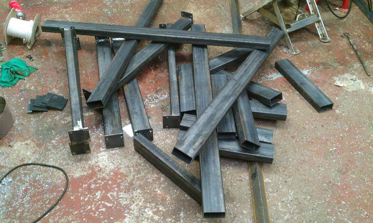

Okay base is on the way and looks more like a jazz base then the previously drawn tea trolley. So I am starting on the electrics. Laid out a few components and will hopefully get some wire, plugs, connectors etc tomorrow.
Fillets and bracing added by the blacksmith.
Re: Definately a scrapyard challenge
motoxy
Don't blame me and anyway it looks nowt mine.!!. . .Attachment 5807

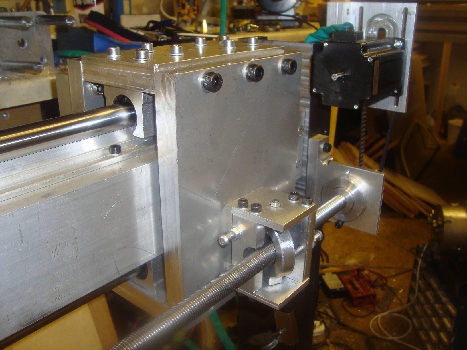

Thats most of the metal bashing completed know. All thats left is brackets to connect the x screwnuts to the gantry and mounts for limit switches. Gues I will have to start on connecting the electrics now. This is the bit that I am not confident about so a bit more reading of old threads and a few stupid questions, as usual.
The y motor has had its mounting made after this picture was taken.
Bruce
Just looking at them X brackets Bruce how are you going to mount them to the bearing plates with that big overhang from the plate which the rails sit on.?
It's looking good thou getting very close to fire up time.!!!
I will send you a dwg and you can tell me if it will work.
Bruce

Cannot believe its been 3 weeks!! Today I decided to swap over the ballscrews but leave everything else as is. The binding sound now comes from the other side and yes I think I know the problem. You may remember that I thought it was a good idea to take a ballscrew apart and see how they worked. I think that I may have not found all the balls and that this is the cause of the problem. So I shall have to get another ballnut and try again.

Limit, homing switches in place and both drag chains. Trying to connect the touch off plate but so far to no avail. All thats really left to do is connect the spindle. Tried the water pump I had and it was useless so its off to ebay. Promise a picture next time I am in the workshop.
Runs beautifully at 2000 mm/min on the x but any more and it sounds yuck and at 2500 it seizes. Tweaked alot so just have to keep looking. I suspect that the old drill press, chopsaw, handtools build suffers a bit from lack of precision so when I am cutting I will try to fabricate the more essential parts to a higher standard.
Nearly there!!
Bruce
Bruce 2mtr/min is more than enough for cutting Ali to upgrade so don't fret mate.
You'll be amazed how much more you'll eck out the thing with a bit of shimming and tweaking.
What's with the plate.? What's it doing or not doing.? How you connecting it.?
