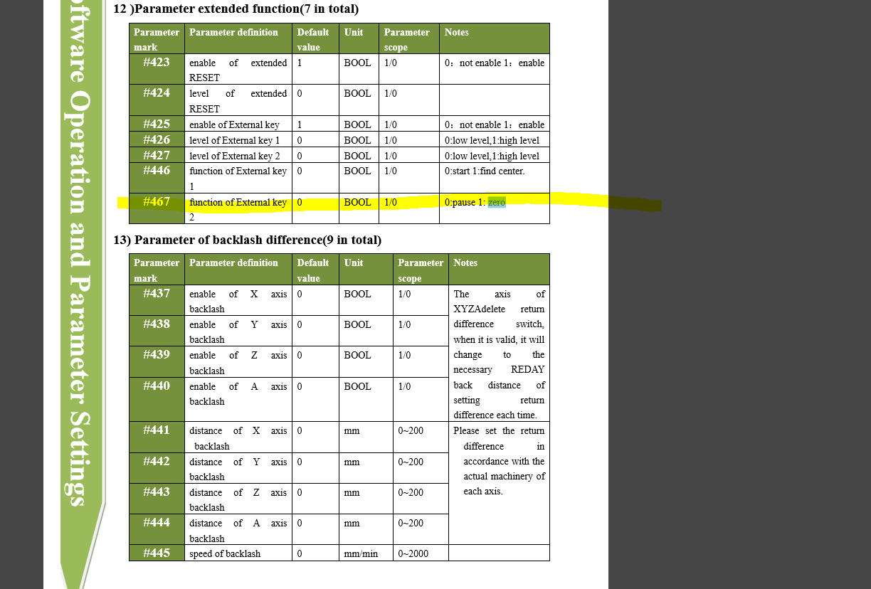

Jazz, I just tried your software on my controller, all good, but when I'm going to do the tool probe, the controller freeze, and I have to reboot. Is your probe working?
PS. As soon as I reload the old software it works again....

Jazz, did you find out why the "tool offset" are in the parameters list? If yes, have you tried it? If not, what is your thought about? That will help to build the tool change routine/pages for the controller. Thank you
Cheers 🍻
Sent by my tapatalk
I've not done anything with this controller other than throw few motors on it to test if it slaved motors for Boyan.
However don't see anything wrong with having tool offsets in list of parameters. After all thats what they are Tool offset parameters.
Having separate page doesn't really affect anything other than slightly easier to access more quickly but in practise once tool lengths are entered they rarely get changed unless tool breaks or new tool. Not big deal to me or worth lot of effort to change how it is now.
Just making the Bugger use M6 will be big step forward. Going for that before anything is what I'd say is priority.

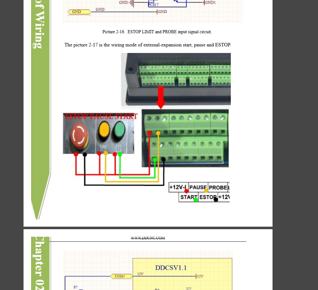

Thats how i have it. Push a button and all zeroes/ the DRO/. Not that the machine starts a zeroing procedure.
Yes, but how is it done? How do you wire it up? What are the connections?
Much appreciated. Thank you. When I'm done I'll post a few pictures

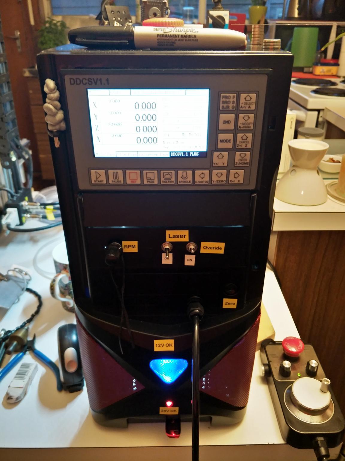

Just as a side note: I watched again a nice video where a guy have made the controller like a pendant. As i said in comments of video, i wish i have come up earlier with that idea. Now i have to go back and forth on my big machine, instead of taking the pendant with me.

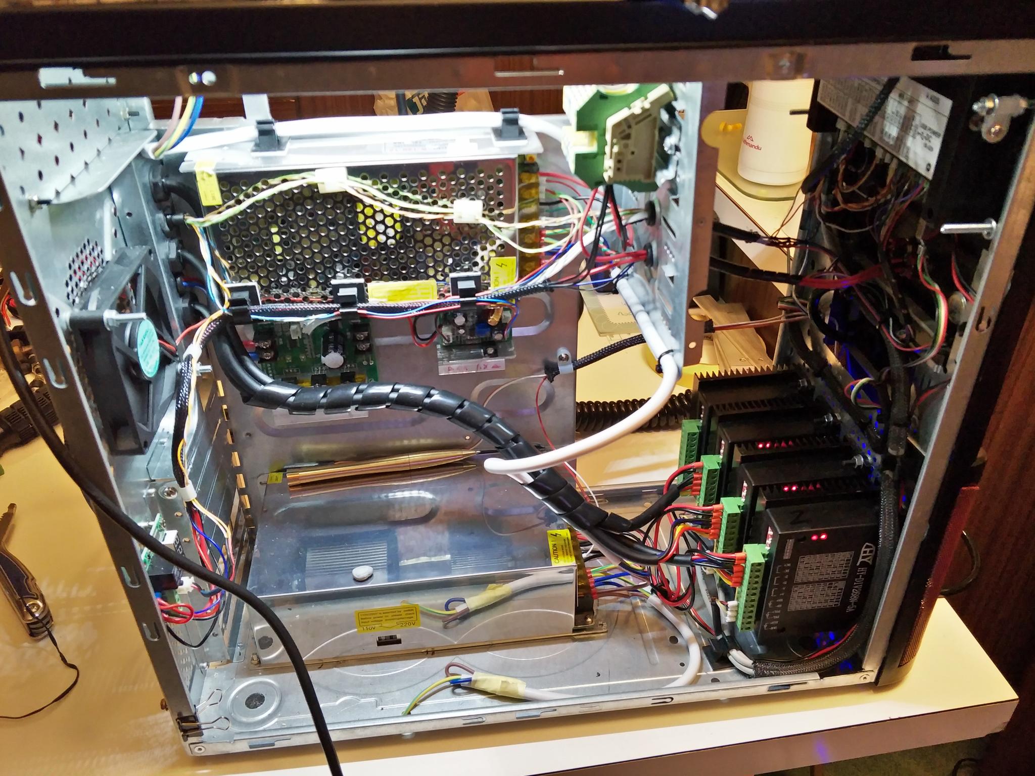

Been working on this for a few months now. Trying to find a nice way to mount the controller. Didn't come up to bad albeit with a few mods to the PC case.
There's one more power supply to go in for the spindle motor.
Once that's done i'll be up and running :)
Thanks Boyan,
The drivers are just generic Chinese brand set to half step.
At the moment i only have one fan at the rear blowing in... i will replace this with a bigger fan soon and would like to use some smaller ones near the drivers. This is still a work in progress.

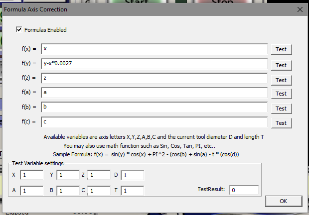

How is the software corrected for the perpendicularity of the axes?
My question does not concern the subordinate axis.
The question of correcting the perpendicularity of the axes.
For example, in Mach3, this is solved through formulas.Attachment 23077
Ok i see. I did not even know it existed in Mach3.
Answer is No. But any software can do this. So it could be corrected in CAD.
if we are talking DIY CNC here, if its correctly constructed that will not be an issue. Epoxy leveling or surfacing. Mounting one rail against straight edge. With the help of same long straight edge and 2 precision squares mounting the second rail. If care is taken straightness and parallelism less than 0.05-0.02mm could be achieved even in a big router, which is absolutely enough. I have mounted 1000x500 machine with even better precision.
At the end of the day its a cheap controller. But as i said you can skew the drawing in any CAD then send it to CAM and machine.
All clear. In any case, I already ordered ddscv1.1 4 axis for the experiment.
Editing in the CAD program is not suitable for a variety of reasons, so this function is in all serious machine control programs, even in an amateur like a mach3. Precise adjustment of the axes perpendicularly incommensurably faster and more accurately done programmatically, especially in those cases where it is already very difficult to do mechanically.
Of course, not everyone needs this function.
I've never had a manual milling machine where X wasn't correctly aligned with Y but I've only had seven.
