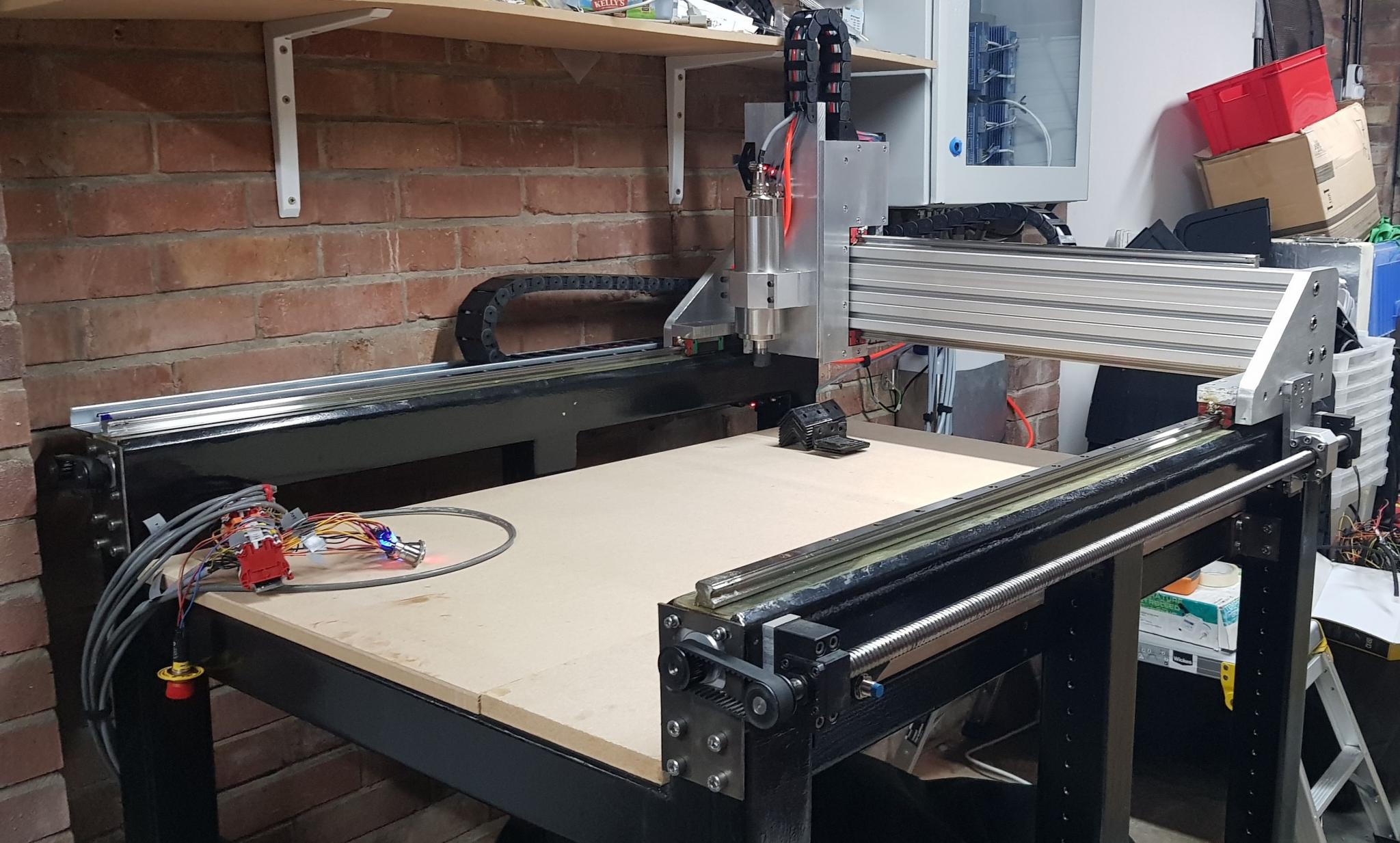

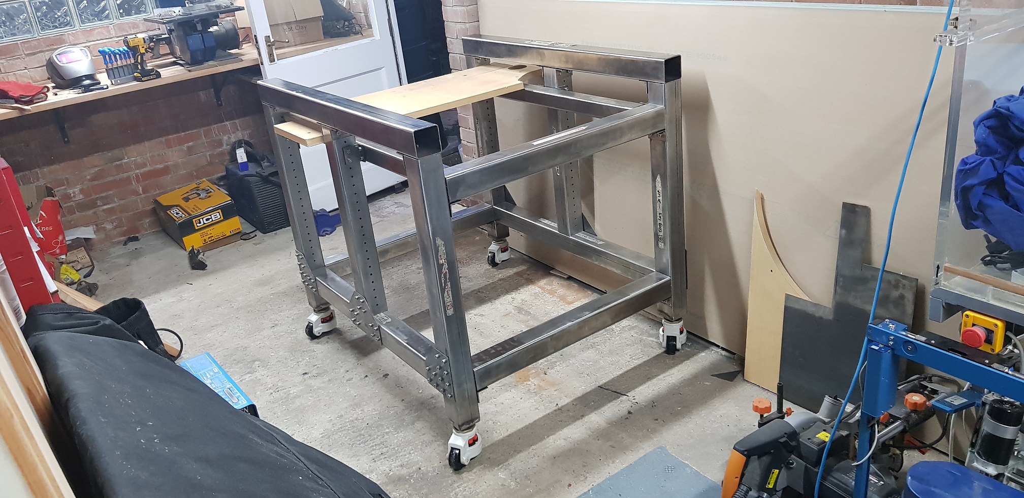

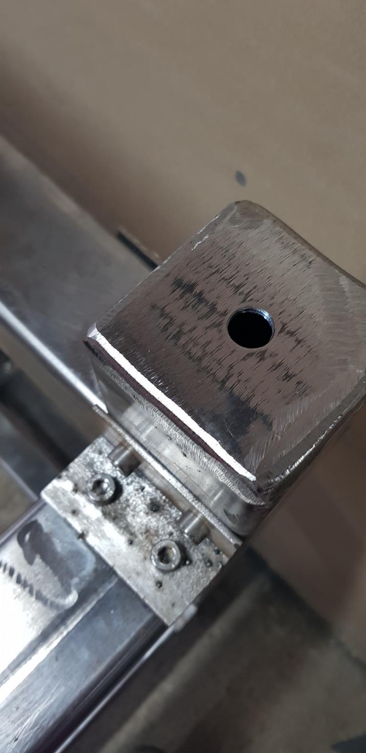

Oh, so you essentially welded the sides, then assembled the table with screws and taps, and then welded it together? was it mostly to prevent it from moving?
What about the legs, did you solder anything below the open 80x80 tubes? I cannot bolt the table down to the floor because i have floor hitting and i'm sure i'll be unlucky enough to hit a hose with the drill. Probably won't be necessary as the table will weight a shit ton.
Looking back over the photos in my thread, I can see why you thought it was just bolted. As it was my first time welding, I wasn't at all happy with how the process was going - I thought the welds were coming out pretty ugly and I had a number of "retries" grinding out bits that felt crappy and weak and doing them over again. As a result, I just didn't take many photos of the build during this stage, I was quite disheartened with it. It wasn't until I had something I was happy with (after lots of grinding, welding, regrinding, smoothing with some filler, sanding, then finally painting that I started taking photos of the frame again.

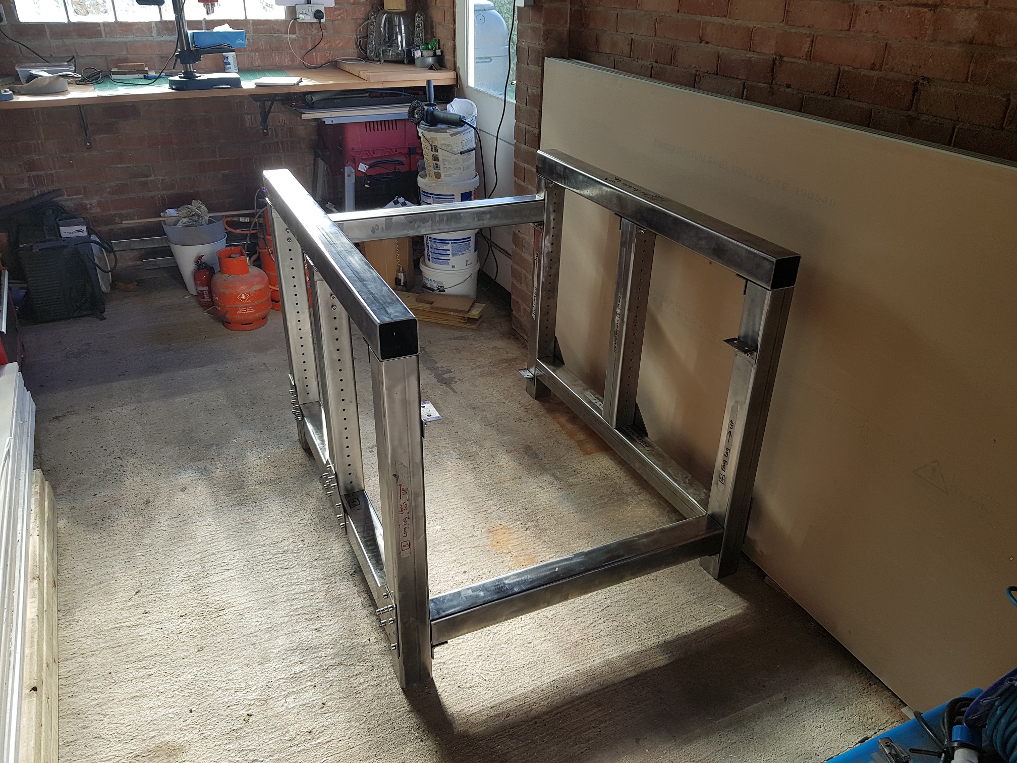

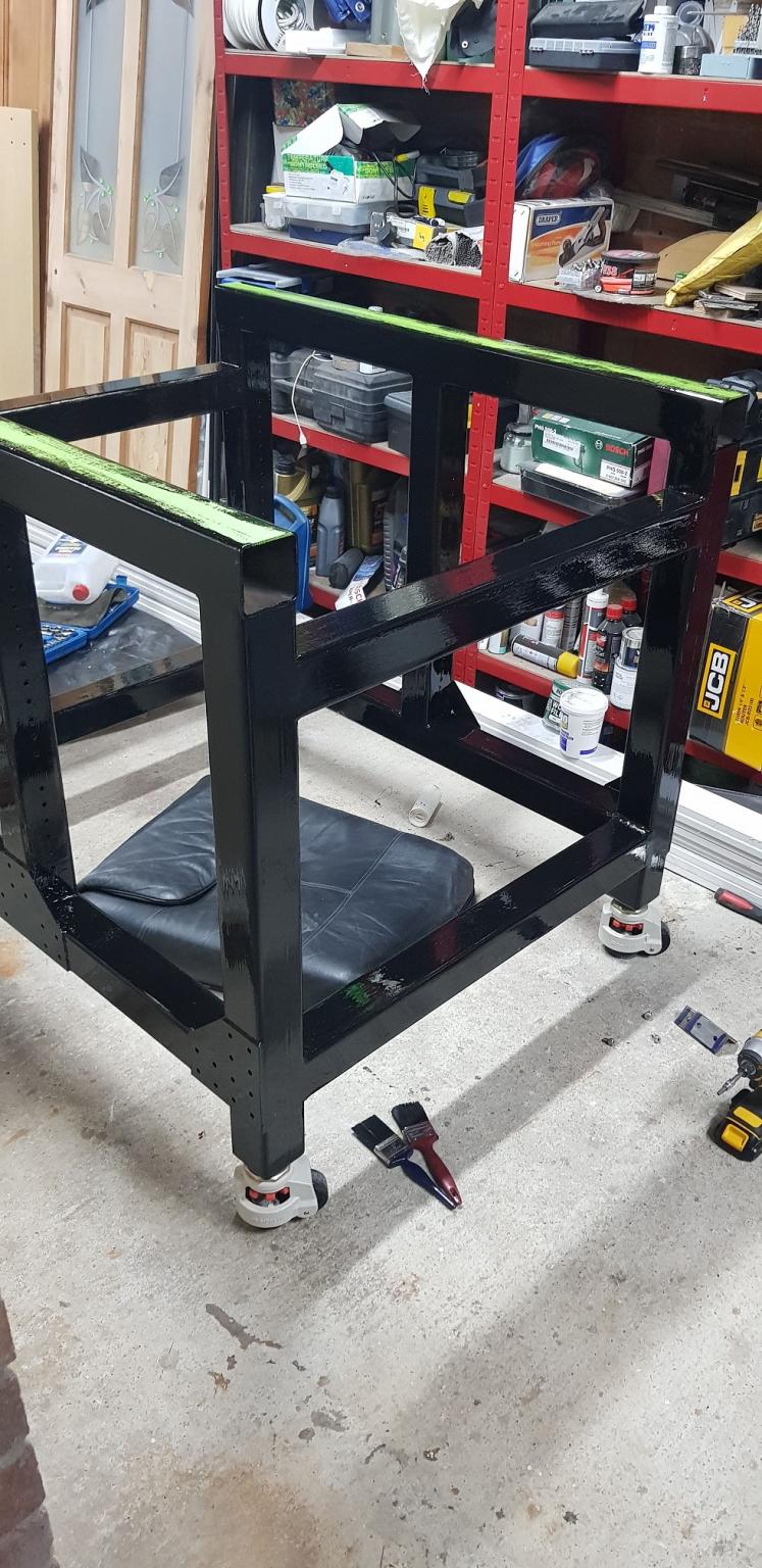

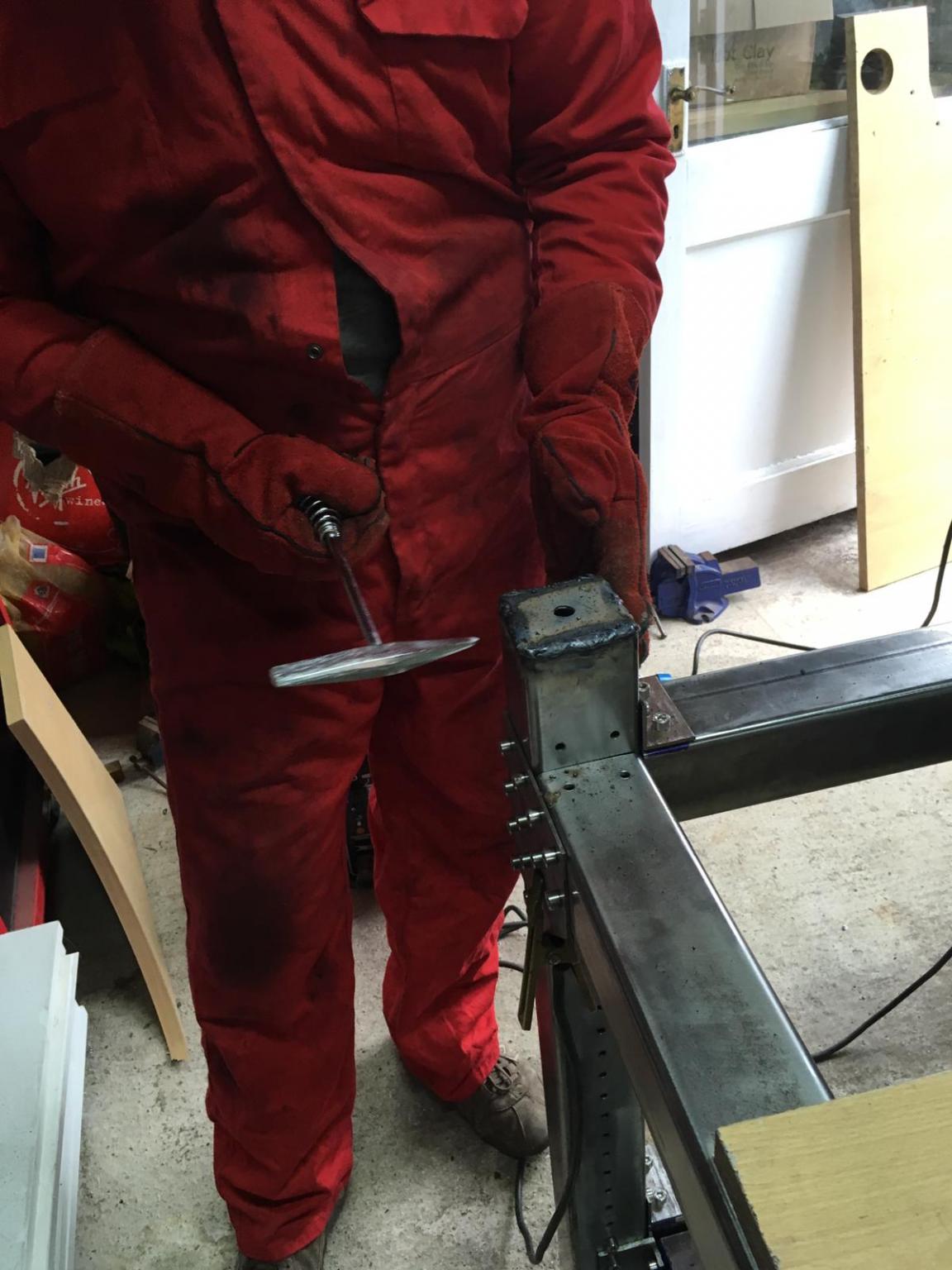

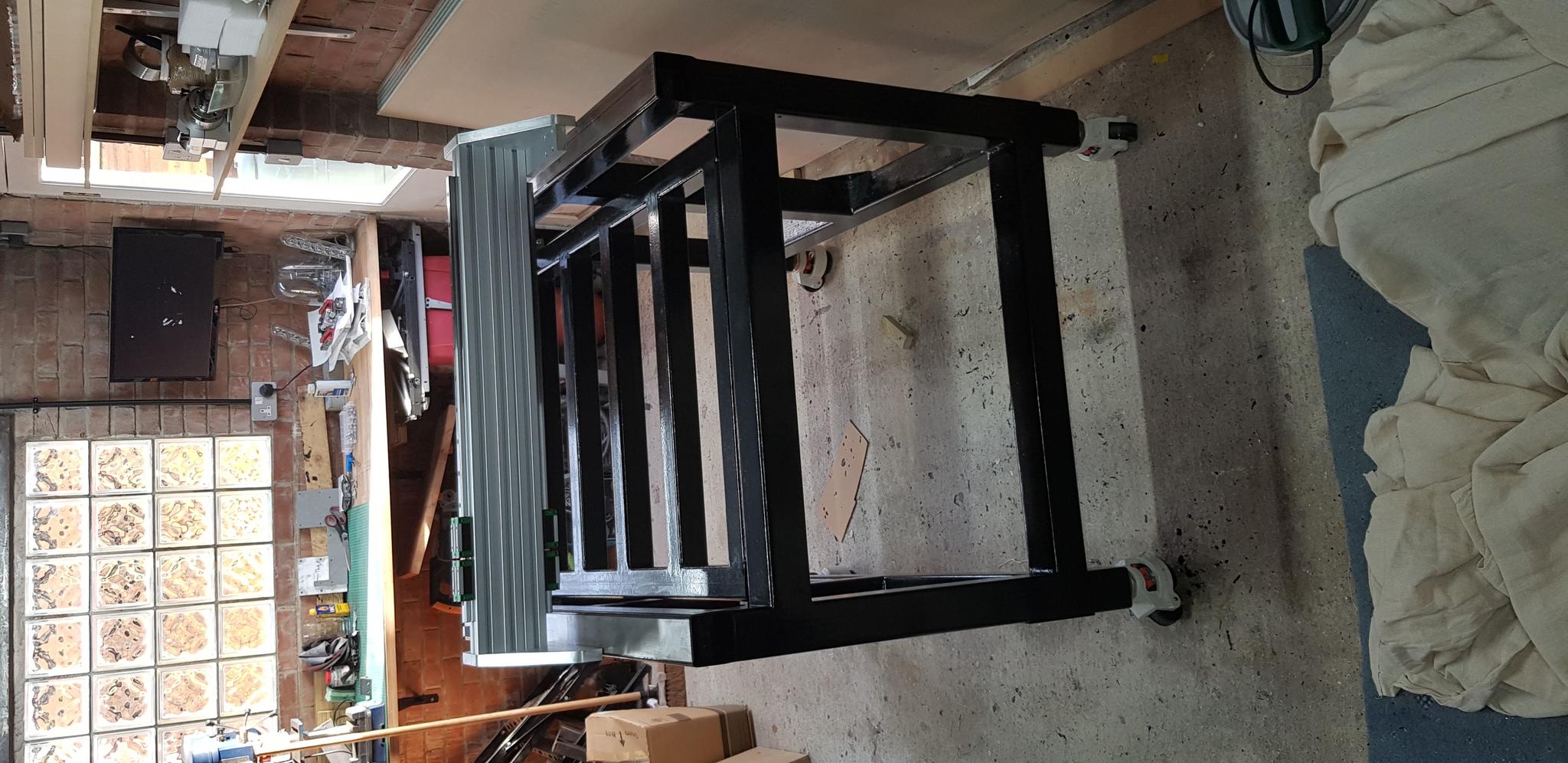

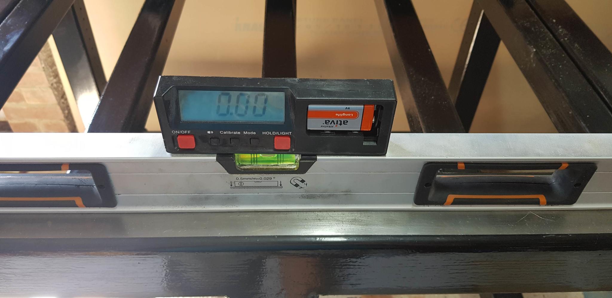

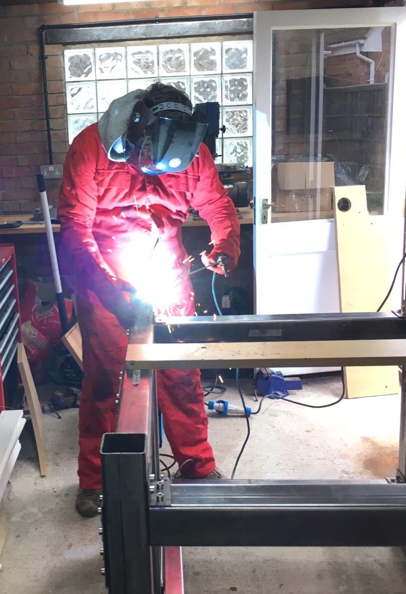

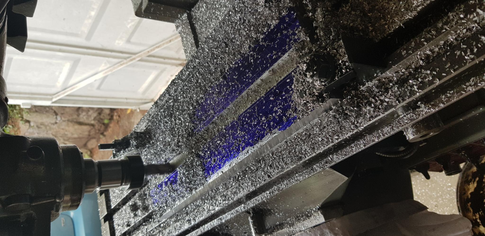

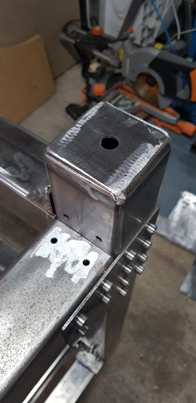

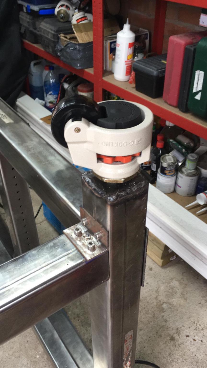

Lets start back here - October 2018, all the frame steels (bar one!) were cleaned up, tapped, bolted together into an assembly I was happy with.
Attachment 29093
I then turned the frame over, and started welding the caps on the bottom of the square tubing for the feet. I'd drilled and tapped these prior - but in hindsight I'd have welded a nut on the inside first to give more thickness to the thread. It was at this point I set my crotch on fire. ;)
Attachment 29096 Attachment 29094 Attachment 29095 Attachment 29097 Attachment 29098 Attachment 29099 Attachment 29100

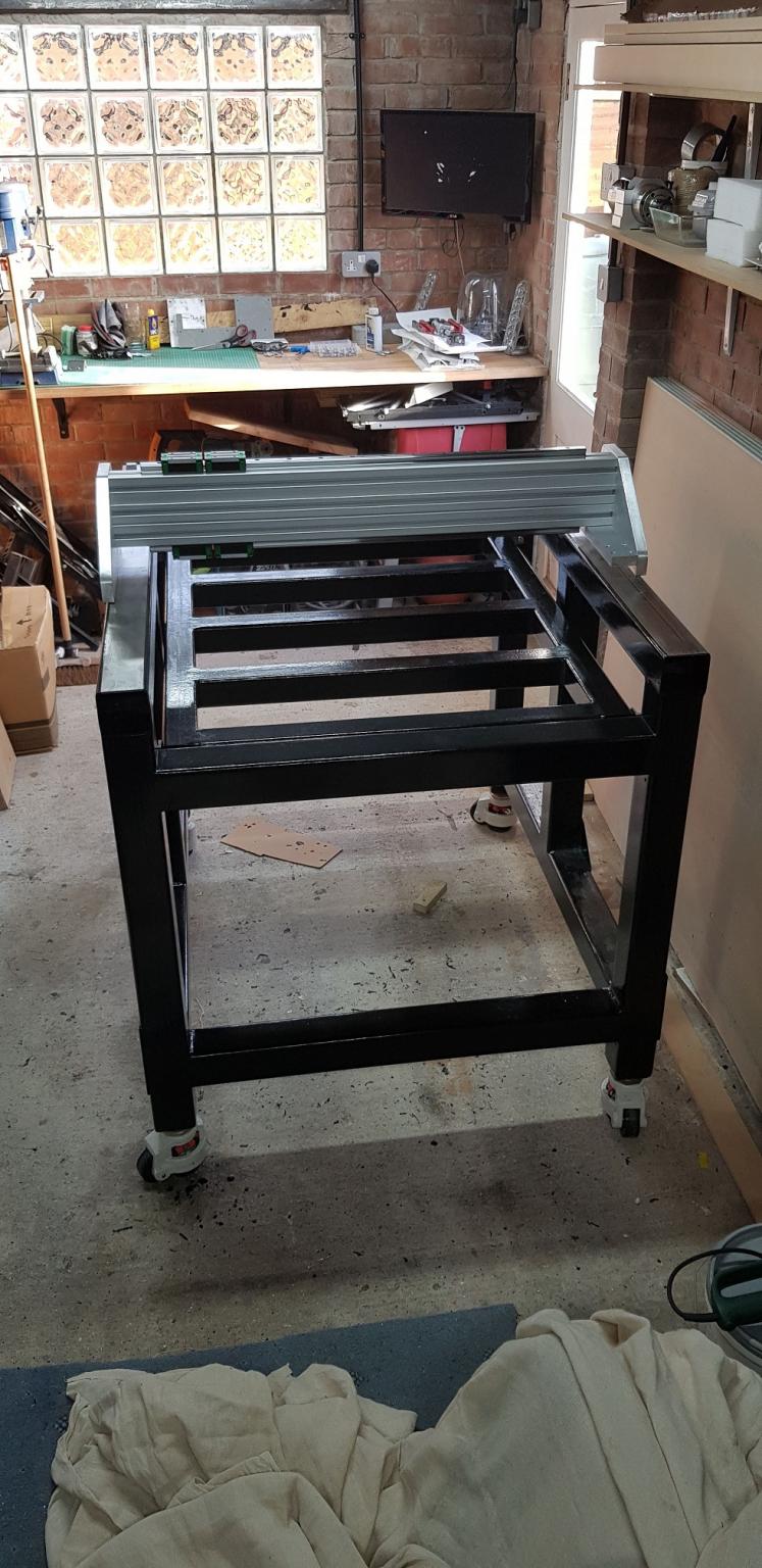

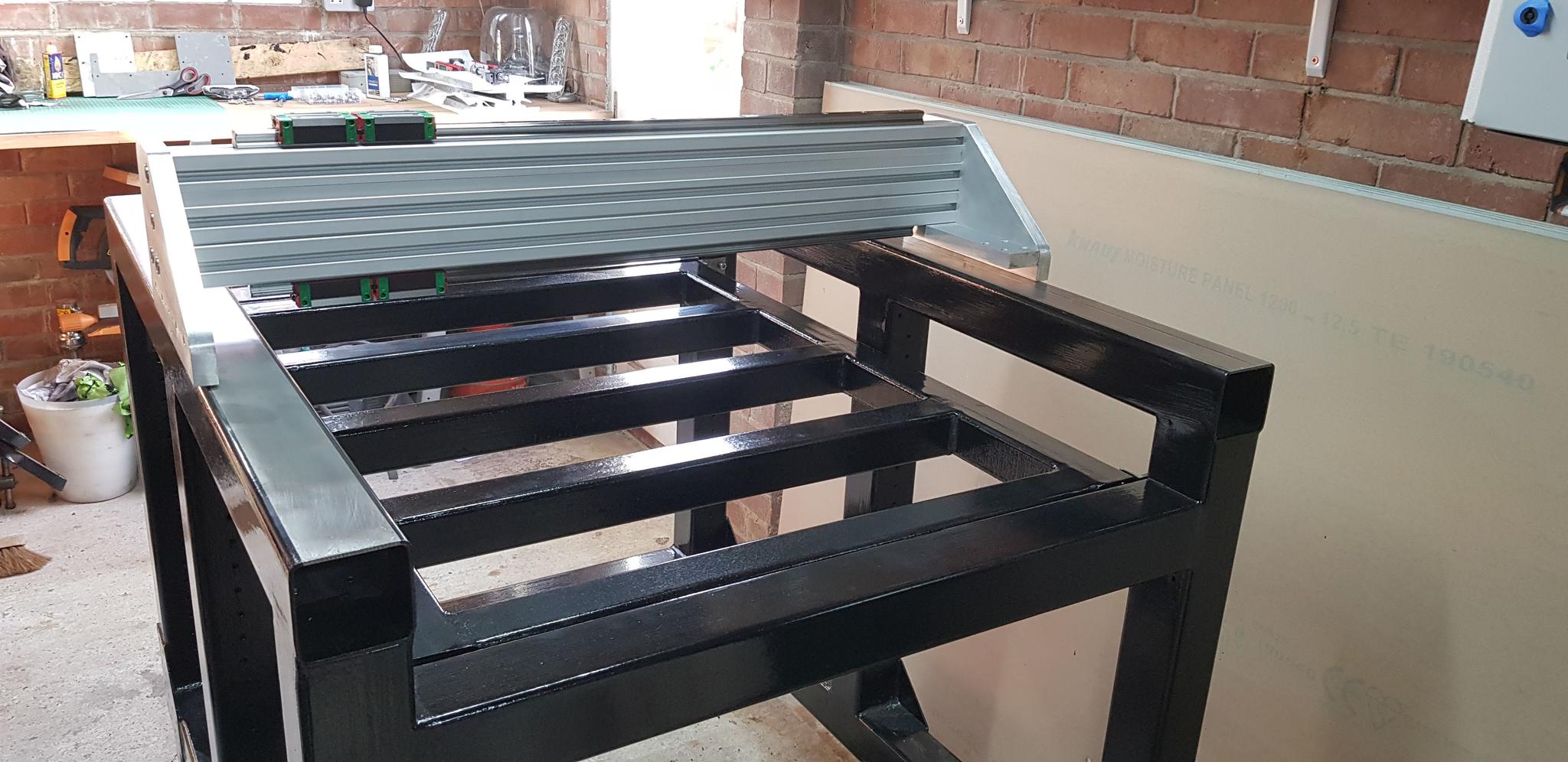

By the end of the day I was quite happy with how it was sitting on its new feet. I'd also started preparing the steels for the adjustable height bed.
Attachment 29101
Then I started to tack weld the joints together all the way around, being sure to do one tack, then move around the machine to try and reduce distortion. Once that was done, I came back to each one in turn and gave it a full bead. Rinse and repeat.
I was so unhappy with it I literally don't have a picture of the frame until it was painted.... and even then I wasn't happy with the brush marks in the first coat, so that took a while to sort out!
Attachment 29102 Attachment 29103

Ok sounds good - let me see what I can do about the CAD model to help you out.

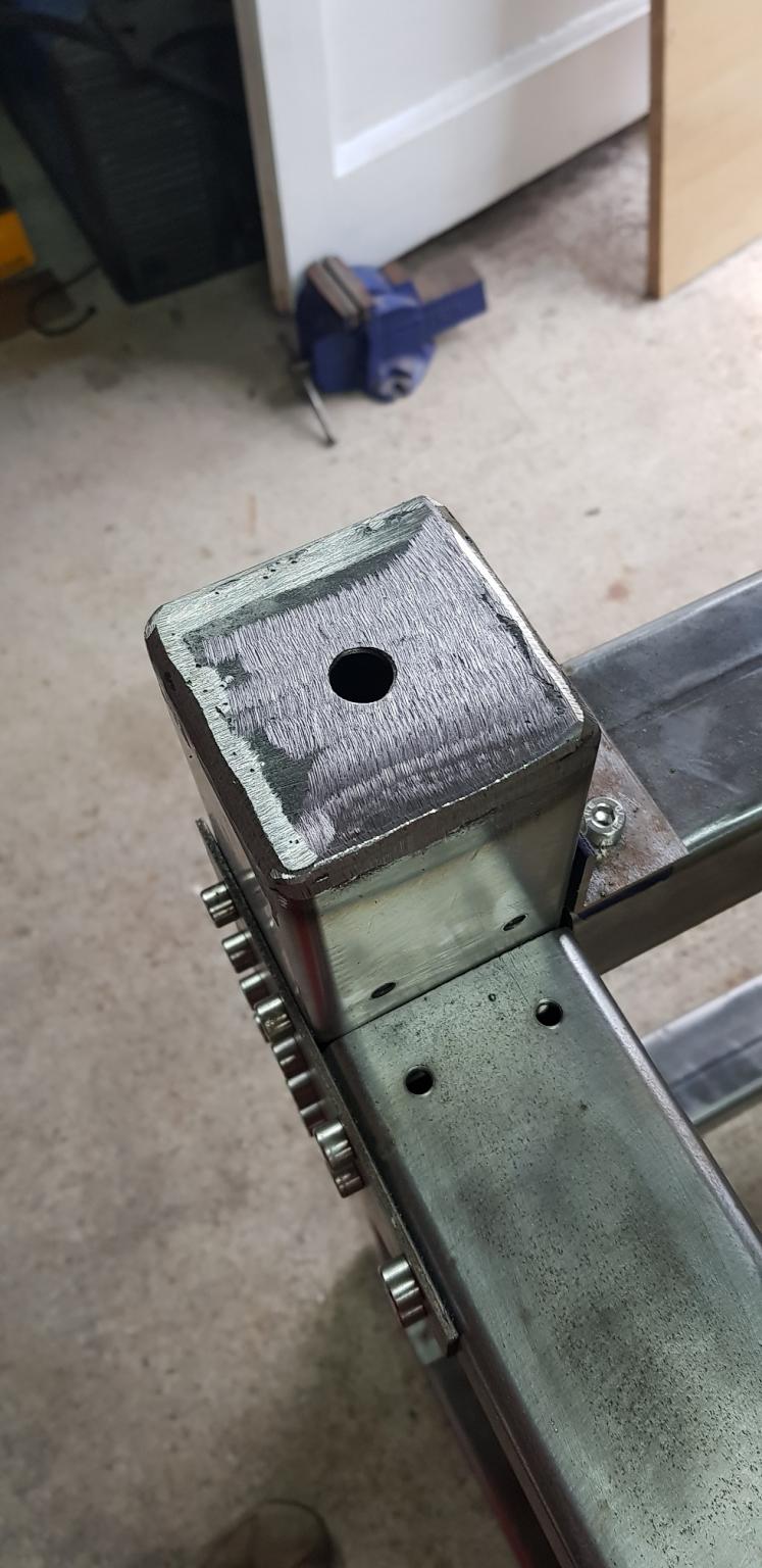

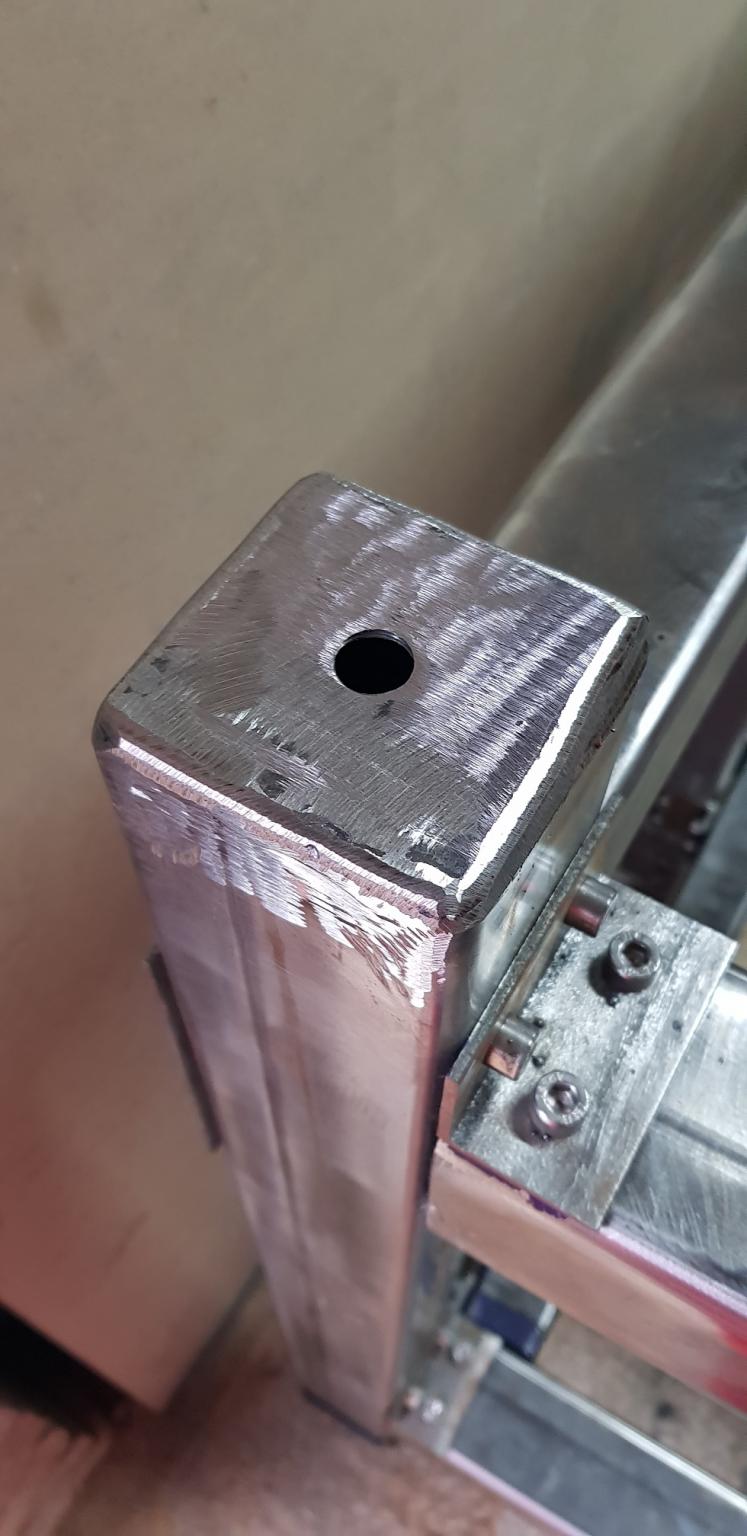

Attachment 29093
Attachment 29101
These are going to be really useful. I appreciated it! I'll post my table on my own thread whenever I have time to start it.

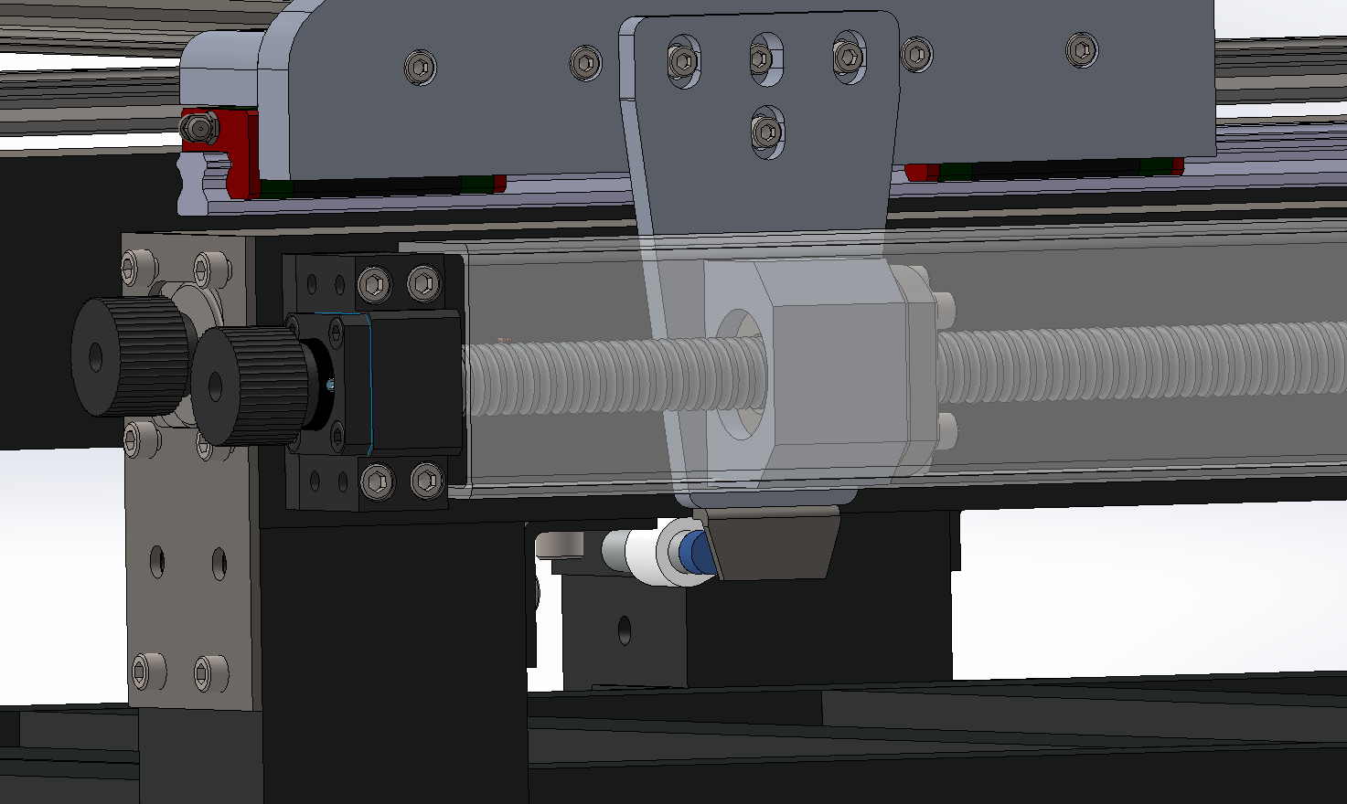

I've been hard at work with the CAD! Could I bother you for some measurements? Could you tell me how far apart you have the linear bearings for the same rail on each of the axis... Say.. Measuring from the outside of the blocks? (and if you're happy with the resulting rigidity)? It's the one area where I don't want to simply overdo it since you lose work area.

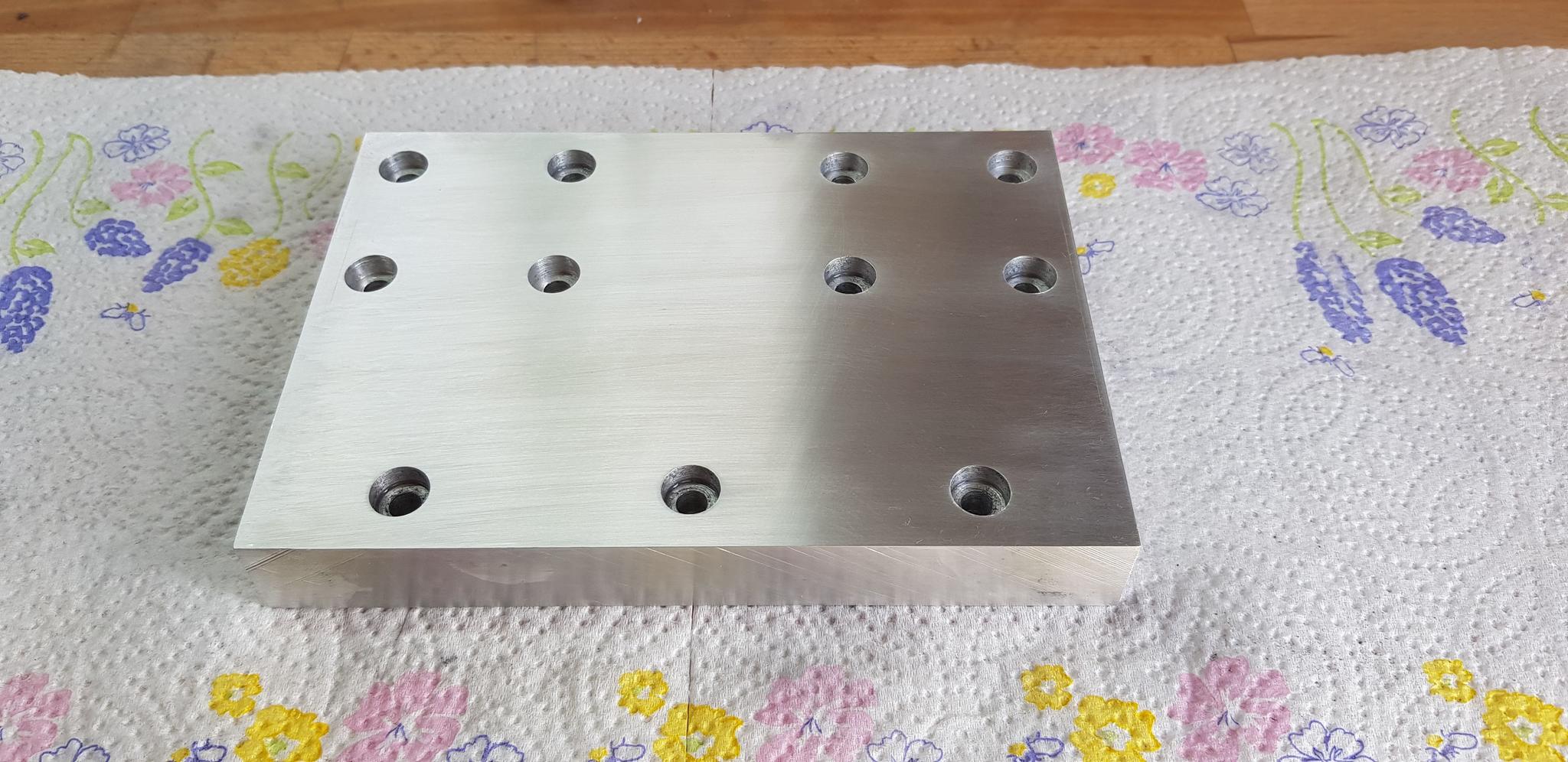

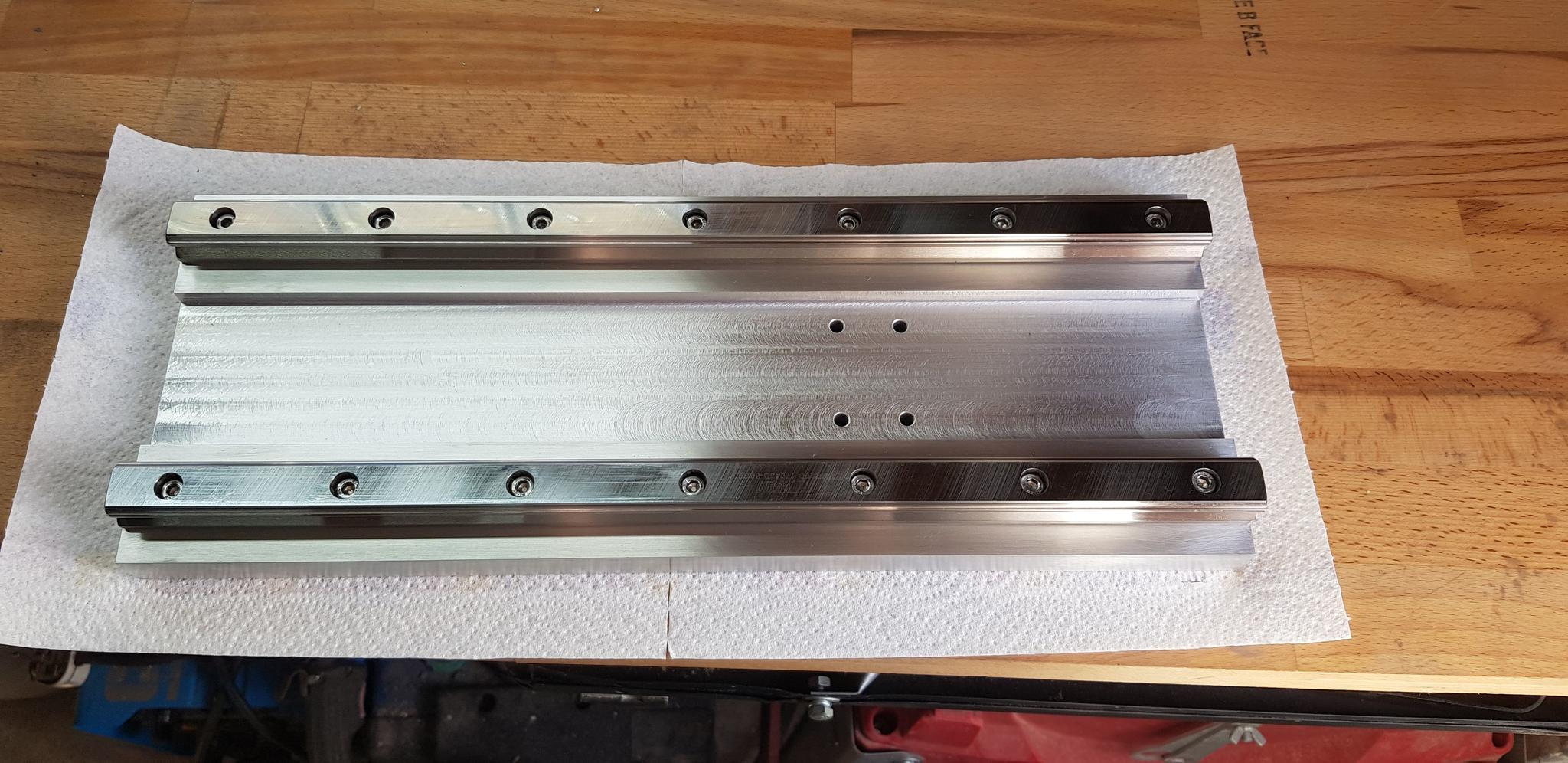

X-Axis (dual, longest dimension, probably should be referred to as Y but I've long ago given up with that), ~280mm between the near edge of the first carriage to the far edge of the second (i.e the maximum possible dimension!). That was designed so that the spindle fell between the two.
Y-Axis (along the gantry) ~ 170mm. This mostly came out of wanting a 15cm wide Z axis plate and then having 1cm side plates.
Z-Axis ~205mm. This coincides with the height of the aluminium gantry profile, and the Y rails and carriages. The bottom one is placed as low as it can be without blocking the bolts on the lower Y carriage assembly plate, the top one is placed as far up before fouling the bolts on the upper one.
Totally appreciate the work area concern. Its one of the things that slightly frustrates me with this design is the work area is substantially smaller than the footprint - but hey. I'd recommend extending the rails at one (or both) ends if you can - If you extend rearward you can cut on the entirety of the bed, a slight forward extension would allow vertical clamping and working.

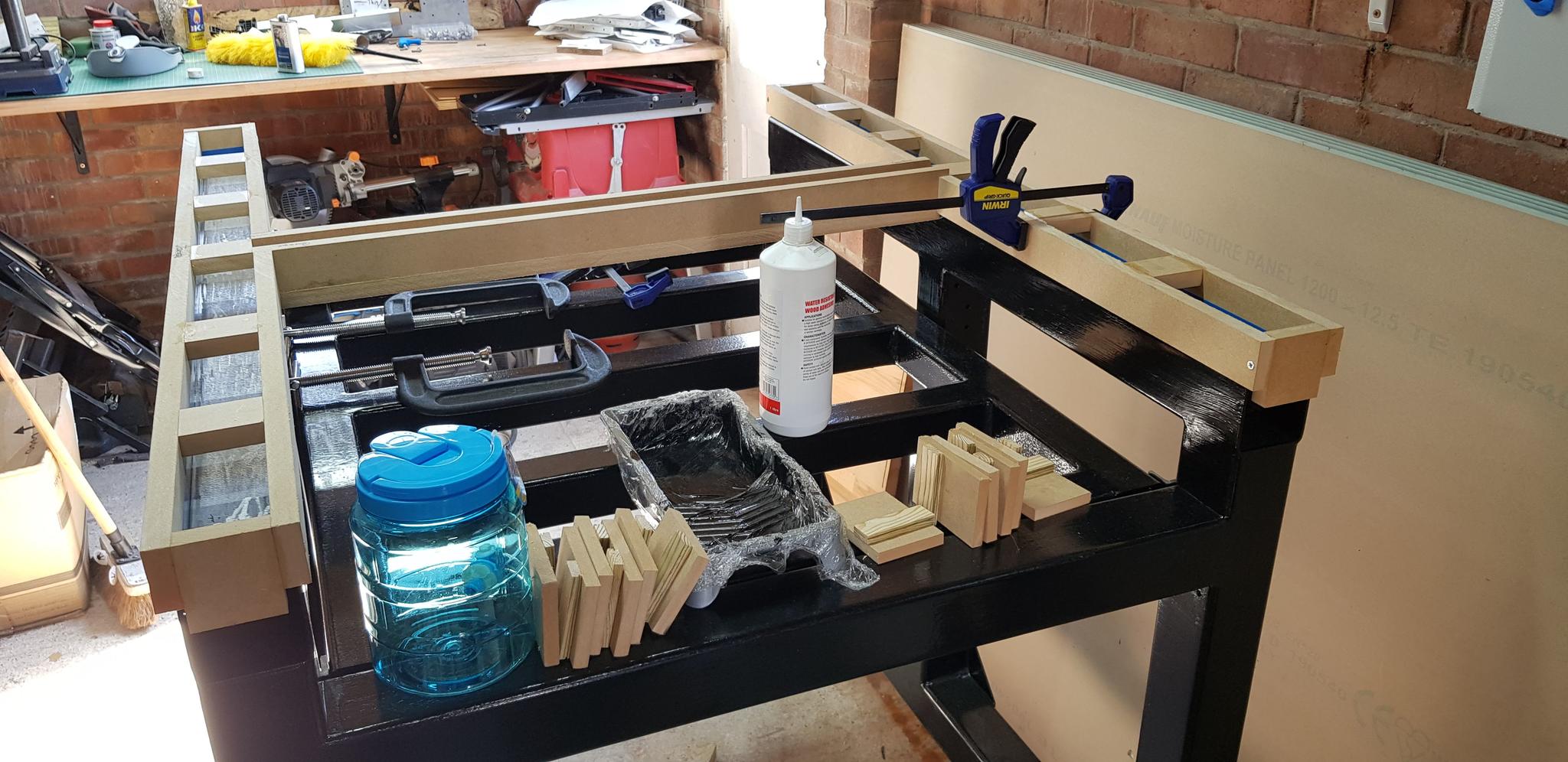

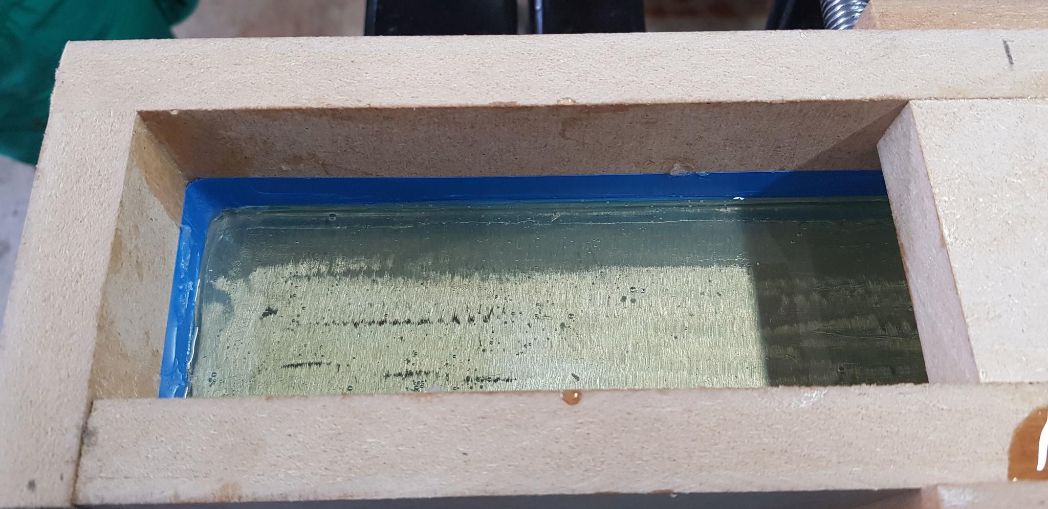

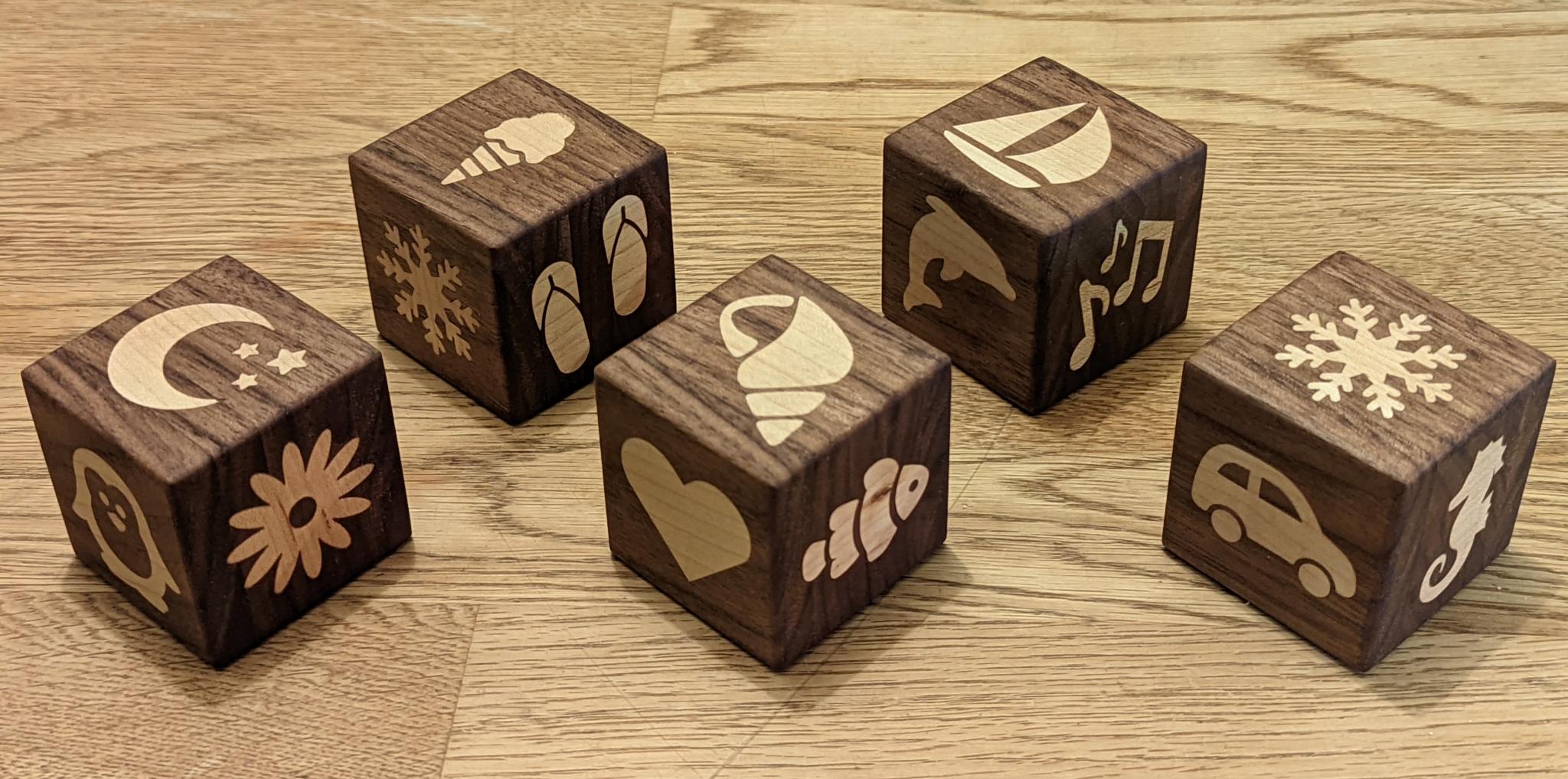

Finally got around to trying my first inlay with this machine. Tried to challenge it by using a series of line widths, 0.5mm up to 3mm. Classic walnut and maple. 70x70mm square.
Used a 30 degree V bit, 2mm inlay depth, 1mm glue void depth, 1mm air gap above.
Plug and base (are there real names for these?) - Ran the cut twice on each to clear up some fuzzy bits - suspect my feeds and speeds arn't quite right, but I was being conservative.
Attachment 30050
Glue time.... used some pretty standard PVA, that might come back to bite me but seems to be working.
Attachment 30051
Trimmed the excess slowly and gently... reveal time!
Attachment 30052
Some sanding through the grits, add oil... et voilą.
Attachment 30053
Not perfect; looks like theres some reaction going on at the interface between the two woods, and I think there was an imperfection in the maple or the plug cutting that caused that slight discontinuity, but overall quite pleased for a first attempt.

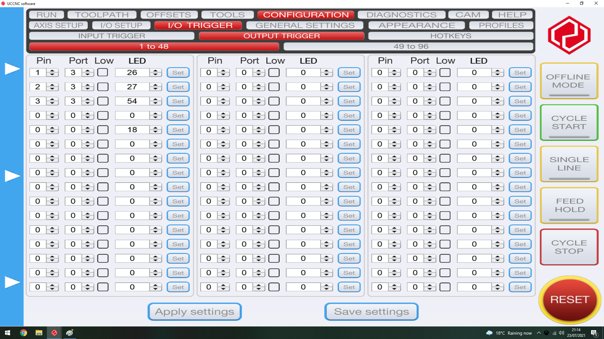

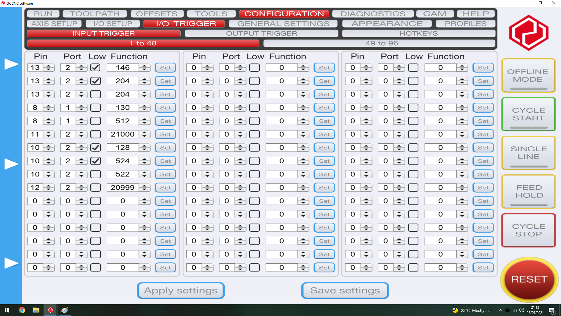

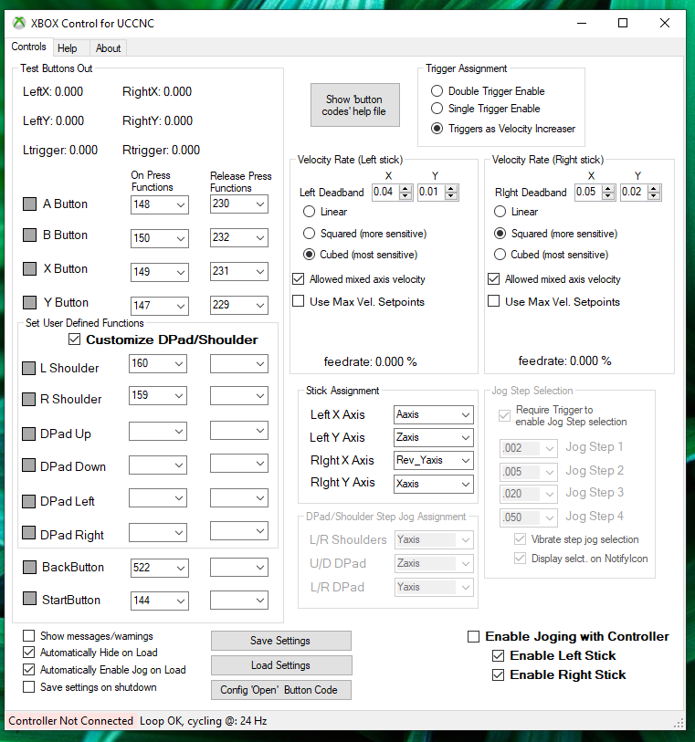

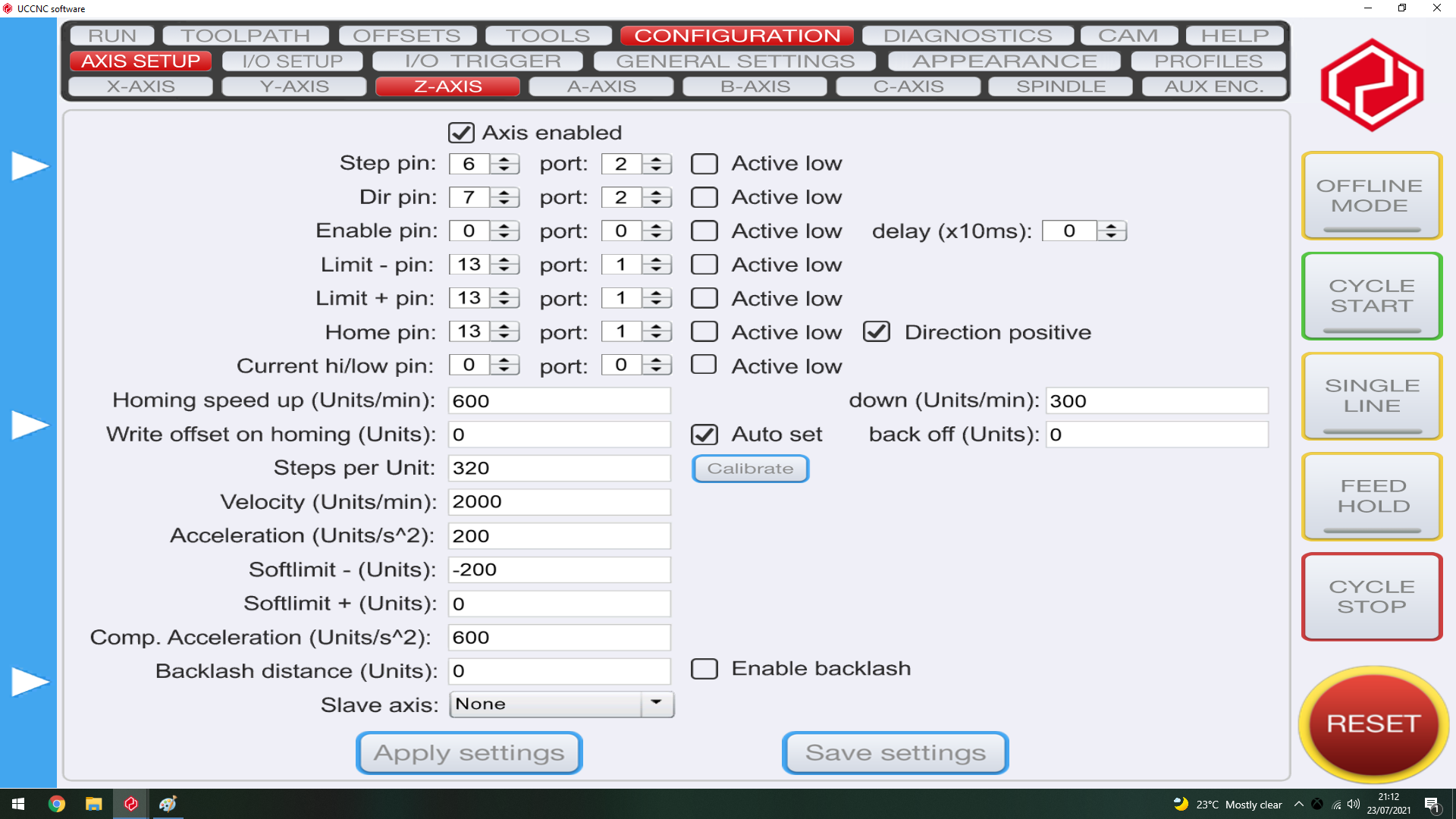

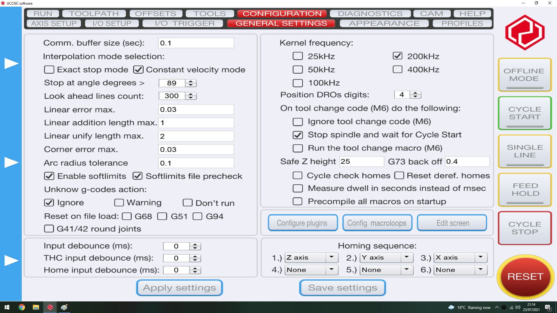

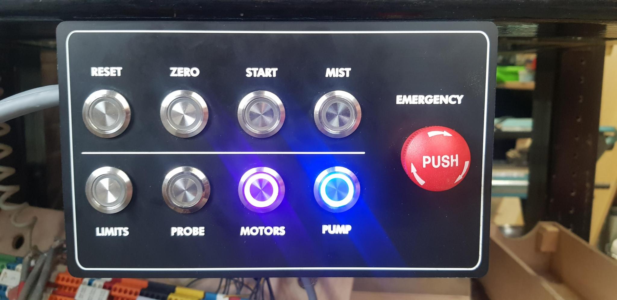

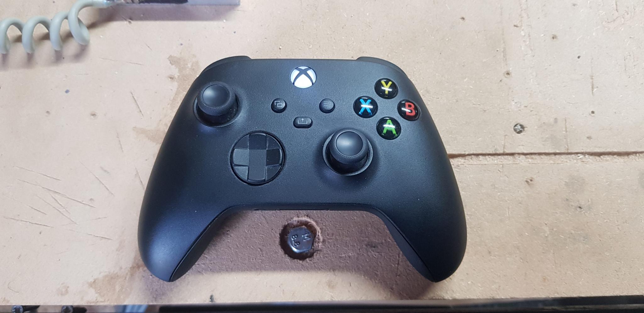

Thought it might be interesting for others designing their control boxes to see why I've made my new one like this and how it works. Also welcome to hear any improvement suggestions.
My typical workflow is:
- Turn on the CNC & PC (UCCNC Autoboots)
- Reset the EStops (Red momentary reset button lights when safety circuit is tripped) & Turn on the wireless (bluetooth) Xbox controller.
- Enable the motor drivers on the control box (Purple latch button - lights when motors enabled).
- By this time UCCNC has loaded, so use the Xbox controller to do a software reset on UCCNC (the start key).
- Home the CNC. This can be done by pressing the (white) Zero button on the control box. This button homes if the CNC isn't homed yet, otherwise it resets the X&Y position to zero if its lit up. The button only lights up when the CNC is idle (i.e. stationary not running a cycle or dwell), homed, and the spindle is off.
- Load the GCode using mouse & keyboard.
- Setup the work piece & do a tool change.
- Set the X&Y zero coordinates, positioning with the Xbox controller, then press the Zero button on the control box again.
- Set the Z zero coordinates using the touch plate by pressing the Probe button (Orange latch button - lights when a probing routine is running or soft probing mode is enabled) which runs the auto-tool height setting macro.
- Limits & work holding checks.... If I do somehow hit a physical limit (only really posibile at startup due to softlimits) the yellow LED illuminates to indicate an inductive limit switch is triggered. Pressing the latch button allows limits override until the switch is released, at which point the LED turns off. Softlimits can also be toggled at any point with this switch.
- Engage water pump if needed.... (Blue latch staight to relay in control cab)
- Press the cycle start button in to start the cut. The cycle start button is a green latching button that lights when a cycle is running.
- If needed, releasing the cycle start button will feedhold.
- Engage mist if needed.... (Blue latch staight to relay in control cab)
Attachment 30254 Attachment 30255 Attachment 30256

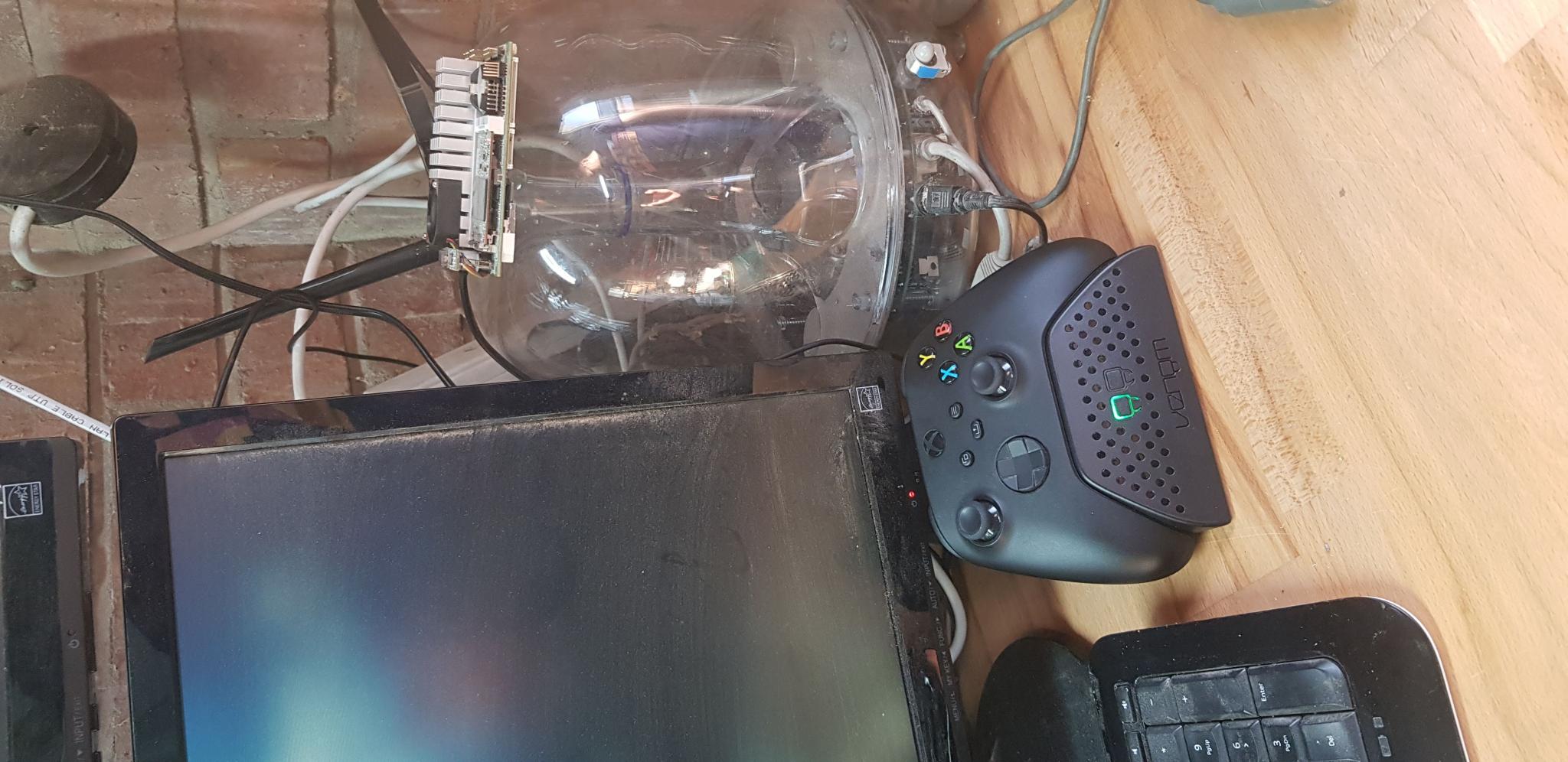

I've recently updated to Windows 10 just so I can have this wireless bluetooth controller. Expensive? Yes.. Awesome? Totally. I'm using Crafty CNC's Plugin to give extended functionality, I tried it a year back and wasn't too impressed, but after trying again and ironing out a few bugs I'm really happy with it now.
The left analogue stick gives up and down control over the Z axis, varying in speed cubicly between 0-50%. Holding down the left trigger at the same time changes this to 0-100%. This means you can quickly get to the right position, but have very fine positioning control as well. The right analogue stick and trigger do the same for the X and Y axis. I've set the ABXY buttons to also jog X and Y with feedrates controlled by the left and right bumpers, this is really helpful for large innaccurate rapids across the table, or if you want to be sure to constrain motion to just one axis.
The "Start" button on the controller is set to toggle the software reset on UCCNC. This is good to get things started, and is effectively an E-Stop button for the controller. The "Menu" button is set to toggle feed hold as a mobile pause button.
This leaves the 4 Dpad buttons free for assigning to other functions I haven't quite decided upon yet... :)
I've also got a docking station to keep the controller charged up and give it a nice safe "home"! - Oh and you see that single board PC sitting on my subwoofer? Thats what I run UCCNC on. Its a quad core i5 @ 2Ghz per core, 8GB ram, 256GB SSD and with some serious integrated graphics.
https://youtu.be/MLwGqcwMeeo

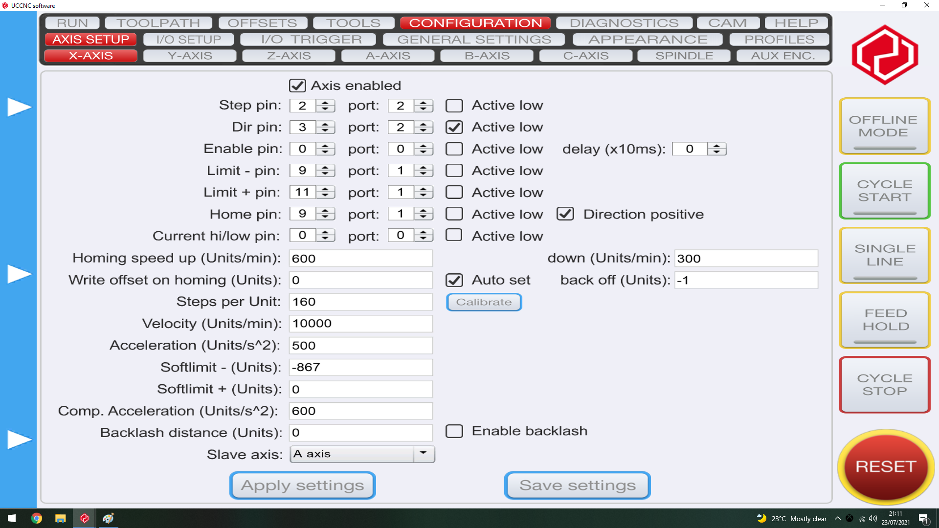

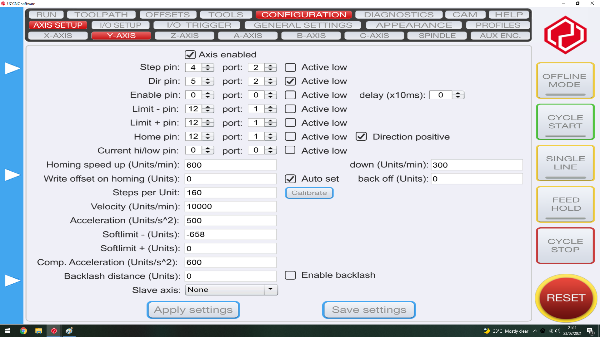

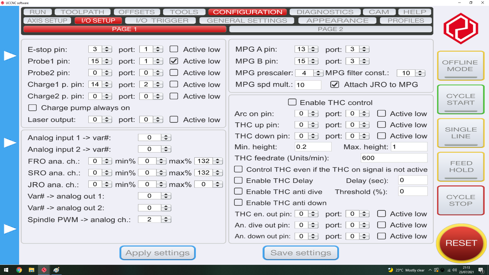

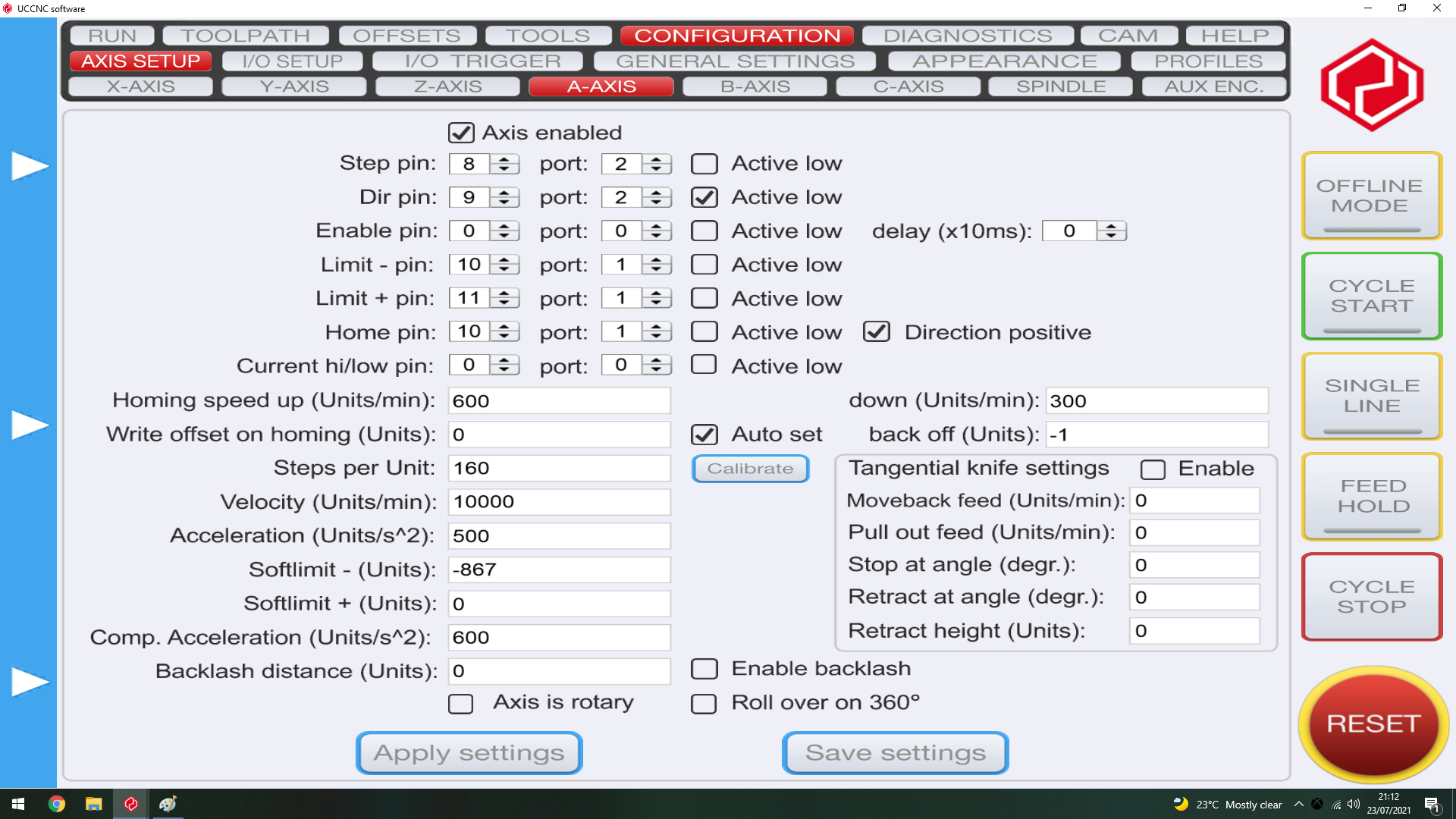

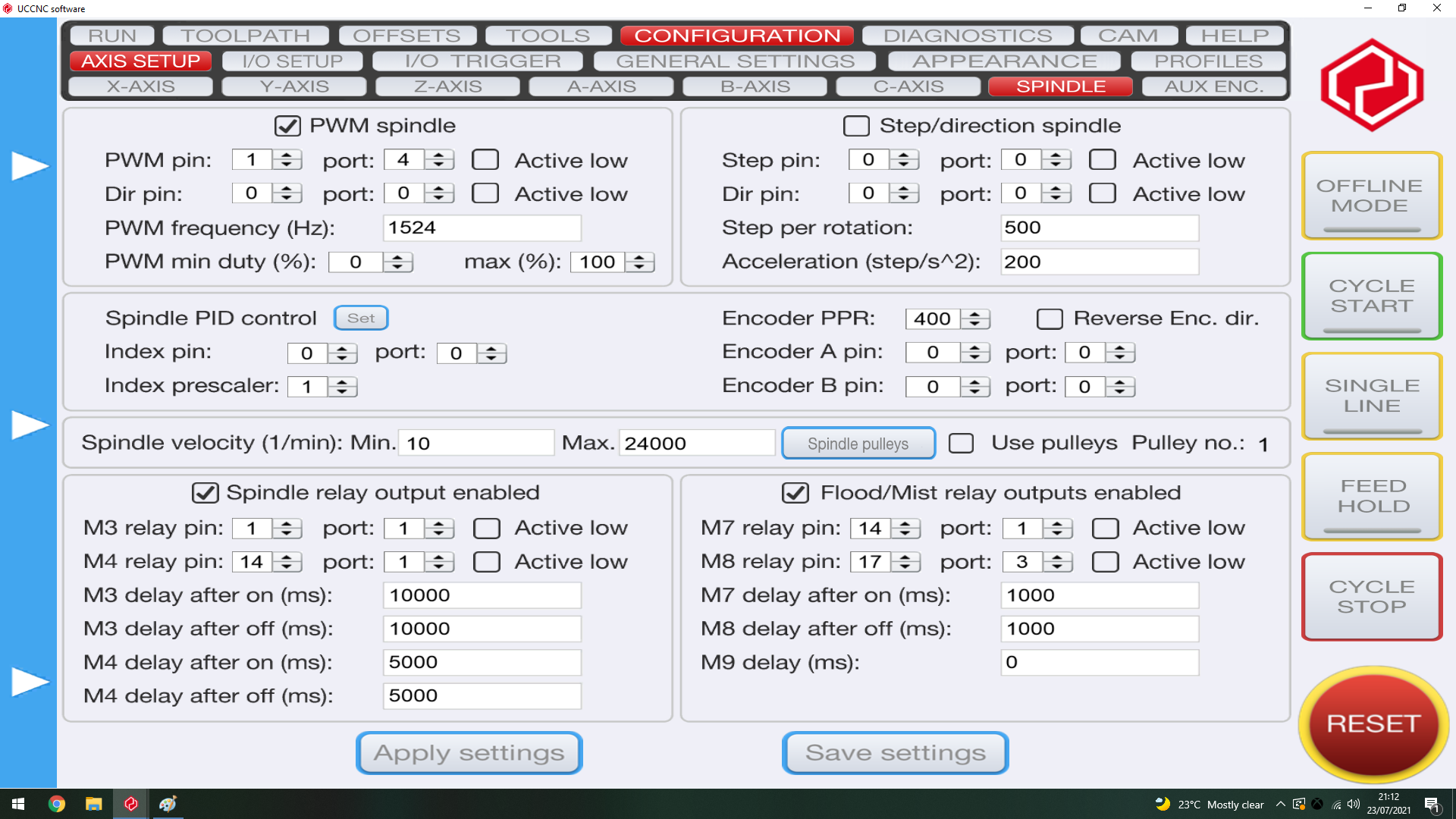

I've recieved a question about my UCCNC setup, so thought I'd share and discuss my config in public, just incase it helps a future builder.
The vast majority of these settings are taken directly from the UB1 manual, where there is a section on UCCNC and Mach3 setups. All the port and pin settings are taken from the UB1 manual, in combination with my circuit diagram.
Axis Settings (X/Y/Z/A)
Attachment 30287 Attachment 30288 Attachment 30289
Attachment 30290
Note slaving of X and A. X&Y Steps per is pretty self explanatory (200 steps per rotation on the steppers, 10mm pitch screws, 8x microstepping = 160 steps per mm). Z is 5mm pitch so 320mm. Y&Z use a travelling inductive limit so port and pins identical. X&A have independent static switches for home and -ve limit, but share a +ve limit switch. Speeds and accelerations are set quite conservatively to avoid stalls.
Spindle Settings
Attachment 30294
As per manual, nothing special here.
General Settings
Attachment 30291
Mostly as per UB1 manual, but note use of soft limits, ignore unknown gcode (bit risky), M6 pauses for manual tool changes, & homing sequence.
Input Settings
Attachment 30292
Input Triggers
Attachment 30293
These handle my control box switch inputs, you can make the same switch have multiple actions, some occur on depress and some on release (hence the low tick). If you see high numbers in the function code its a custom macro to do more complex actions, like my Z height probing or my Zero button which does homing or X&Y zeroing depending on the machine state.
Output Triggers
Attachment 30295
These exclusively control LEDs on my control panel, alongside some of my macroloops.
Xbox Controller Settings
Attachment 30296
See my previous post to discuss these.
