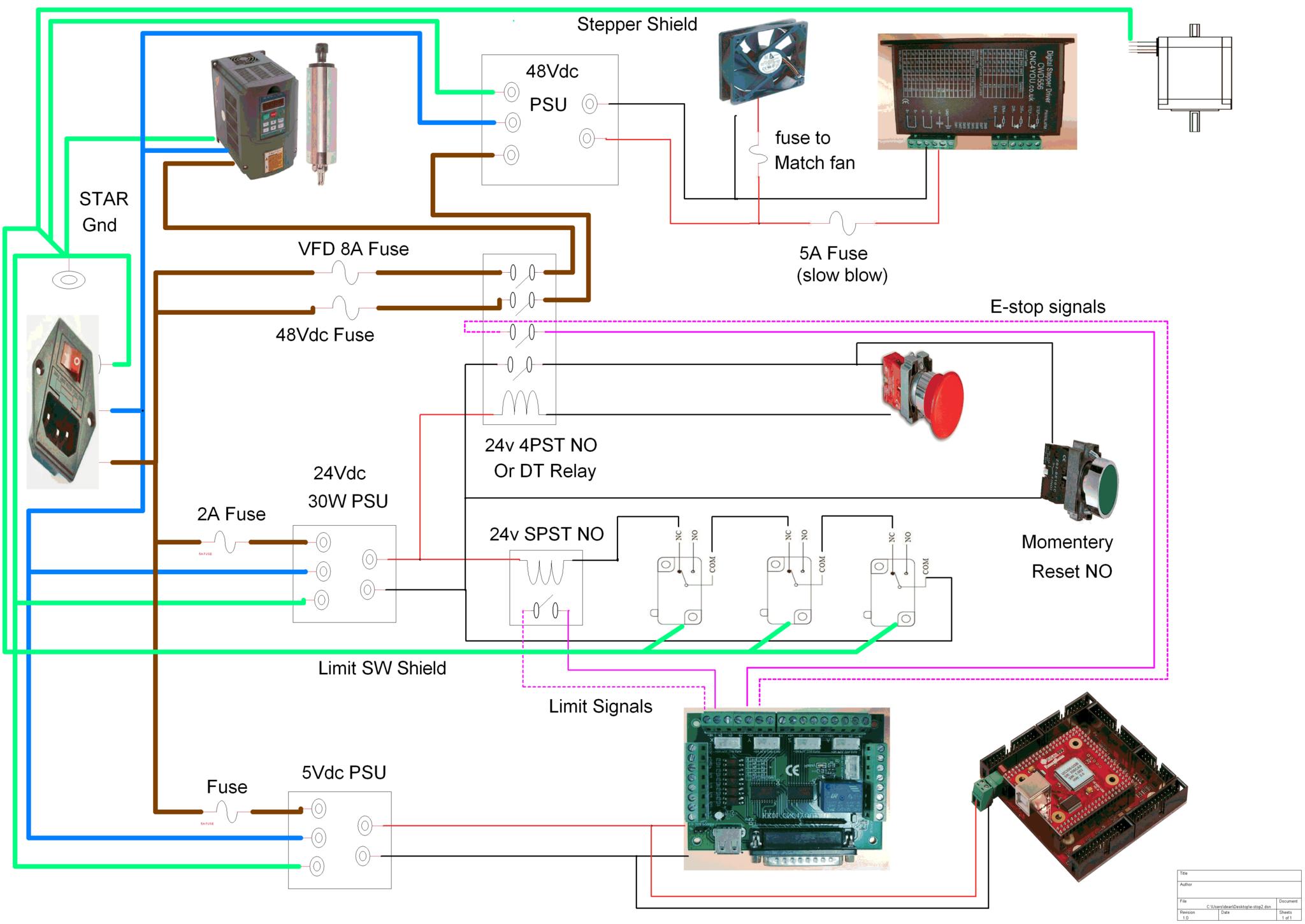

I did notice that the case (which is earthed) may of been touching the outside metal part of the USB connector. I fixed this and plugged the USB in again and it then connection was established ok. Not sure this is related to be honest.
Yes this would cause problems because it would create an earth loop with the PC. The USB gets it ground from the PC earth.
Don't earth the case of the PC to same Star Earth point used for the control box. The Pc gets it's earth from the Mains directly thru the plug.
Vibration or resonance won't cause these problems. It mostly makes the motors run rough and lower performance not miss steps etc unless really bad.
USB can be flaky to start with so if you have any poor wiring connections or noise going on then it will be picked up.
But Before starting on the wiring I'd go over the mechanicals with fine tooth comb to make sure no lose couplers or binding issues.
Then Go over your wire connections very carefully. Make sure Power wires are away from signals. Esp around the VFD.

Yes it's possible but whether or not that is the problem I'm not so sure.! The easy way to check is to remove the VFD from the Control box.
The VFD cables running thru the machine shouldn't be a problem provided you have a little separation from signal cables.
Like I say this won't be load related because I've pushed cutter thru MDF without spindle running and motors not stalled before material is ripped from bed so with the small DOC and low Feed rate you have been using then it won't be load. Even with a very tired cutter it wouldn't cause this problem.!. . . Again thou easy checked just throw a new cutter in it.!!
The amps are fine at 3.8A. 2000(10x) micro steps are fine so you have no issues there.
It's not the drives protecting them selfs, they would just fault and blink at you showing what cause the fault.
Can you make it do it and video it. This may highlight some things. Also show the Electrics and wiring around machine.

I think you have 2 issues really. The losing connection I'm 99% sure is noise affecting the USB.
The Jogging I'm betting is keyboard related.

Ok. So after some more testing with the UC CNC software i am still getting the odd reset during a cut. No crazy lost steps though which is good.
So I have decided I am going to bite the bullet and redesign a new bigger box for all the electronics, as I am sure the packed in proximity of everything is part of my problem.
At least now I can use the machine as is to make it.
I am planning to make the box out of 18mm birch ply as i have it.
I would ideally like to get the vfd in the same box, but with a significant internal shield to separate it from the sensitive stuff.
Also I am wondering whether my dust extractor which sits under my bench in fairly close proximity to the box could be causing me a noise problem as well.
Can anyone tell me what materials block noise? Or would you fail safe and just separate the VFD completely.
Would it also be sensible to separate and shield the mains stuff from the low voltage stuff ?
Conductive and earthed ones, that's why metal boxes are the norm. Ferro magnetic ones are best.

Following a very kind visit from Komatias, he suggested that I may have a ground loop.
So before I go off building a new box I am going to to try his suggestions, and see if I can't get rid of my Gremlins that way.

I decided to run a little bit more to see how often the problem occurred and see if I could spot a pattern. E.g. Did it always happen under load ?
Well i have just run nearly 1/2 a million lines of GCode cutting a complex 3d model with 6mm and 3mm ball noses (in four batches) and I have not had one reset.
I was getting really adventurous on the feed towards the end of the job. Ended up running at over 4000 mm / Minute.
I will keep an eye on it for now and record when and if I get resets.
