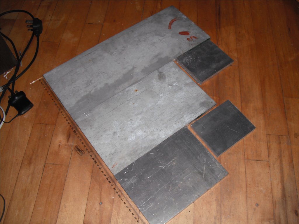

I went to FromStock today and picked up a fair bit of ALU for my machine. all cut to size.
I'll get a pic of it when i find a camera.
I have enough to make my spindle mounts, and my gantry, the only alu i need now is some 50x10 and 50x20 for the frame.
Attachment 4538
this is my fair bit of Alu, that's a 50cm ruler next to it and I got it for a stupid price.
it would be unfair to tell you the price due to pure jealousy, but you can guess at it :)
it's all 12mm thick also.

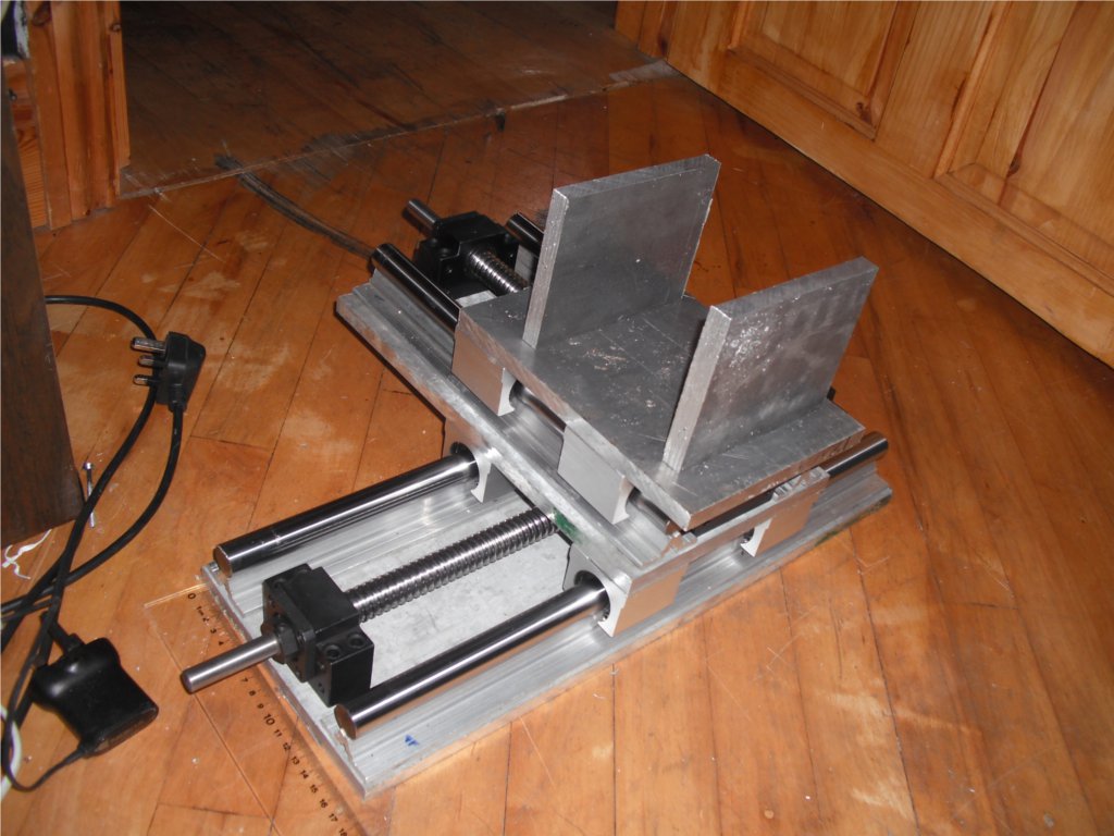

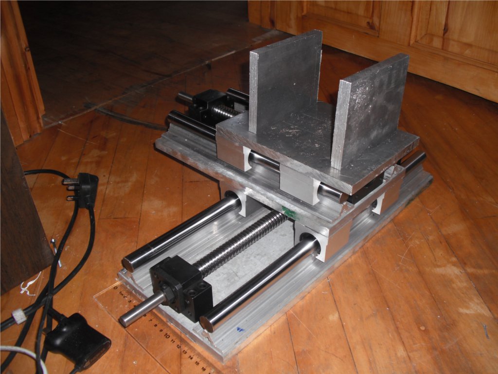

I will be drilling some holes later, but I need an engineers square to be really accurate.
Attachment 4539Attachment 4540
So if the ruler was a stupid price how much was the aluminium? Looks like about £31 worth to me...so I guess a stupid price would be £20.
You seem to have laid it out with the Z-axis rails mounted to the Y-axis slide, not the other way round. Was that just for the photo? Putting the rails on the Z-axis so they move up and down and the bearing blocks are fixed is stronger.
the ruler was £1.29, £20 is bang on.
I'll give it ago with the rails the other way around, it's just I thought the extra weight would be a problem.
