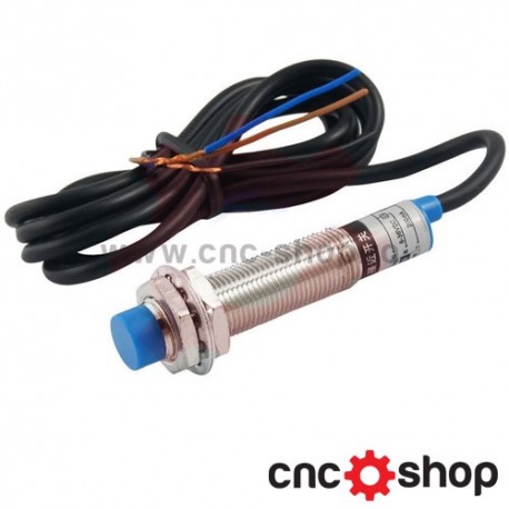

NPN NO inductive proximity senzor, 4mm detection distance, 6-36VDC,300mA,3 wire (brown,blue,black)

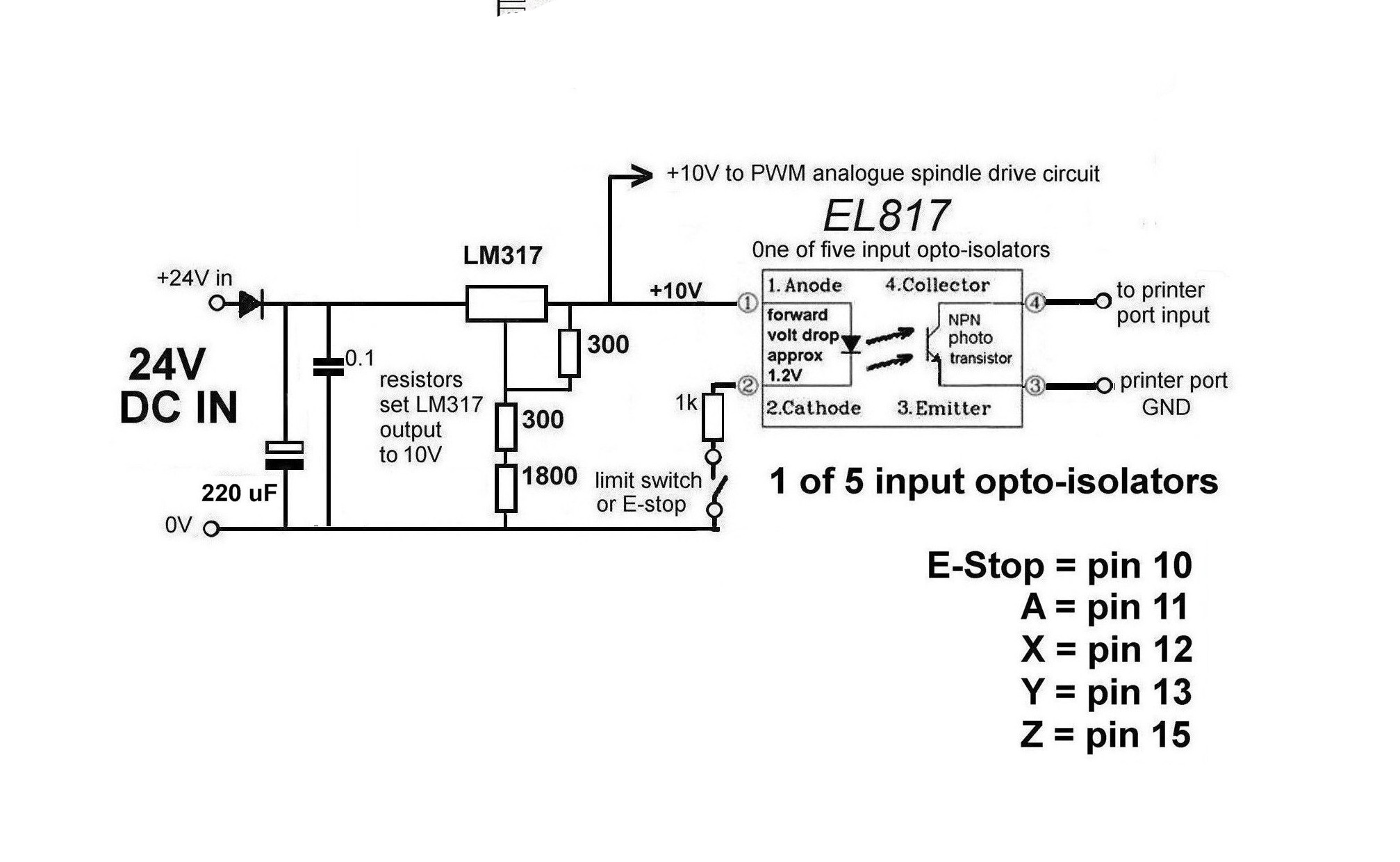

The BoB input alone is not reliable enough to be used for an emergency stop.
Estop, the emergency stop, that big red mushroom button should be there for emergencies. Water is leaking through the motor electrical connections and on the floor so you could be electrocuted or something in the machine catches fire ... You will be hitting the Estop while running for the door or the fire extinguisher. In those cases you want to kill all power to the machine with that button.
The reason I've put the limit switches on the same loop with the Estop is that I have the sensors for the limit. If the sensor is not stopping the axis, then something should be really bad with mach3 or the motor drive and I want the end switch to stop everything before hitting the end of axis travel.
For minor "emergencies" like loosening the workpiece or hitting a clamp you have the mach3 Stop or Feed Hold buttons.

Please do not wire the limit switches as I did! Better wire them in series to a relay coil and from the relay to BoB estop and the stepper drives enable pin if they have it.
If I were in your place I would try to convert all the control circuit to 24V if possible. 24V is the industry standard as it is more reliable and resistant to noise and EMF than lower voltages.

As far as the inductive proximity sensors is concerned you need at least 12v, preferably more, for them to work reliably.

I just finished this evening installing the homes, and they seems to work just fine with 12v supply. I will however post a video these days, with the aparently last problem :)) (I know, don.t laugh), of the y axis wobble, or whip, I am not sure yet, maybe you see something I don.t. It.s not that bad and it is manifesting a bit strong only on 10-20 cm of travel.
