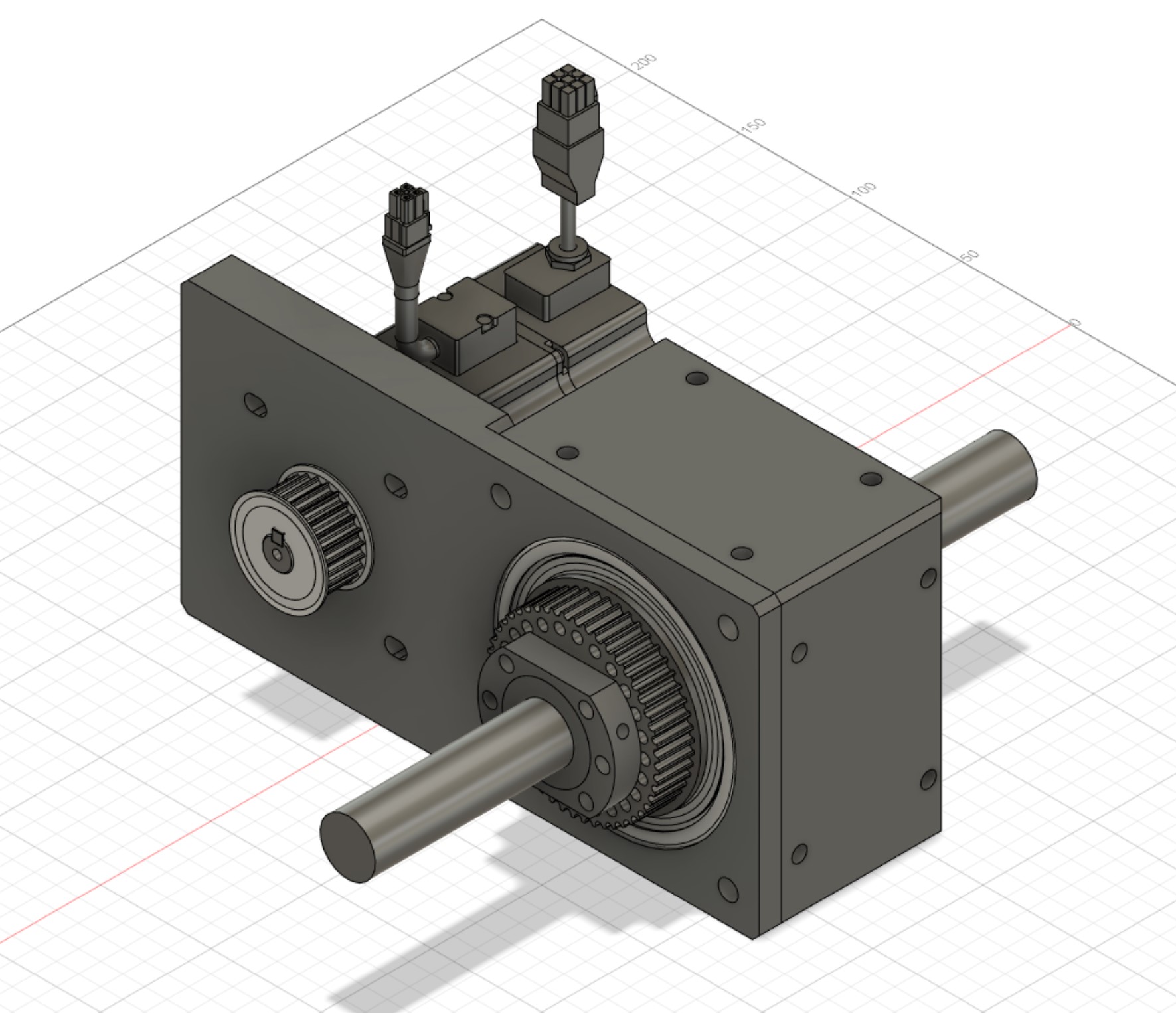

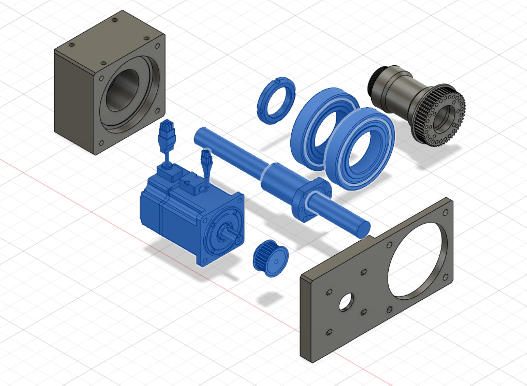

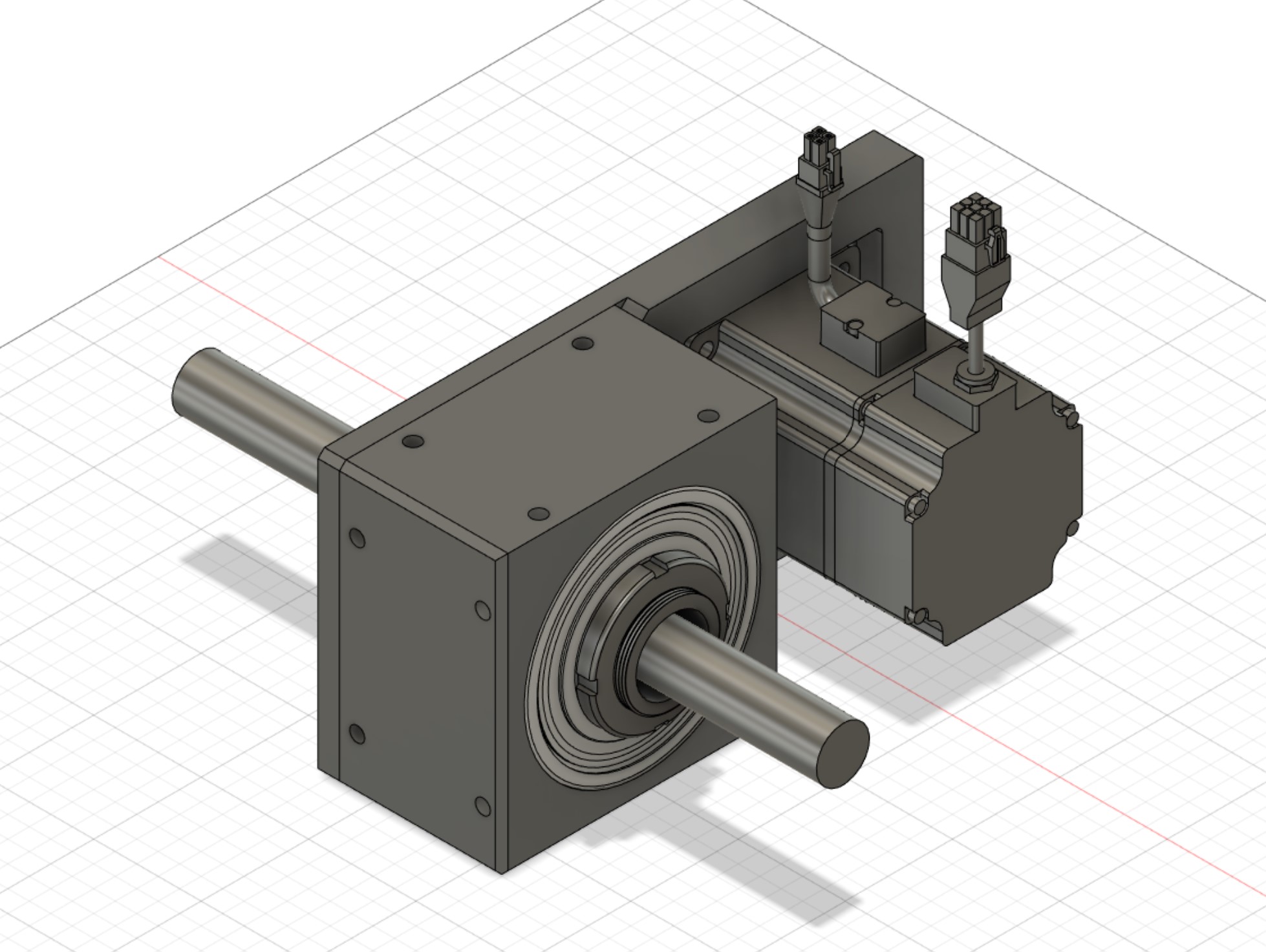

anyone done a simple driven nut on an acme/trapezoid thread? - looking for something compact
3 Attachment(s)
Re: Rotating Ballnut - design ideas
I tried to match both The Ideas From Jonathan Design and Haase "German Designer" Into One Design, The Ball Screw 2510 with SNFU nut and 750W Servo,
Attachment 29639
Attachment 29640
Attachment 29638
Main differences:
- Both Pulleys Are Now exposed Which make it easier for larger ratios like 2:1 " 50T : 25T
- The Nut is inside not out side in opposite direction
