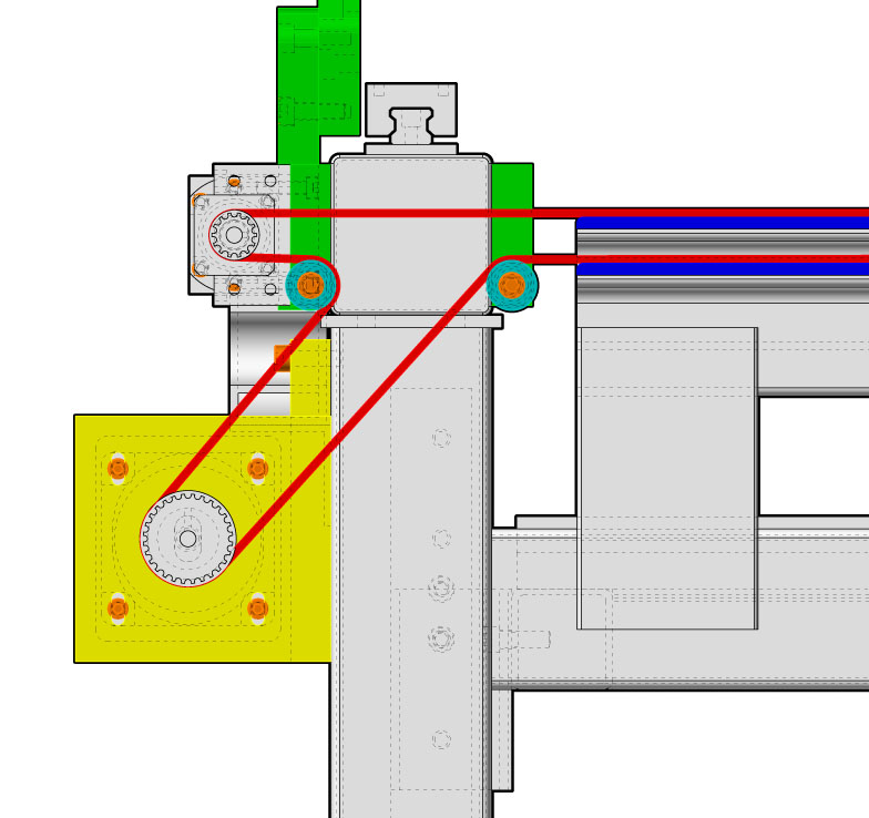

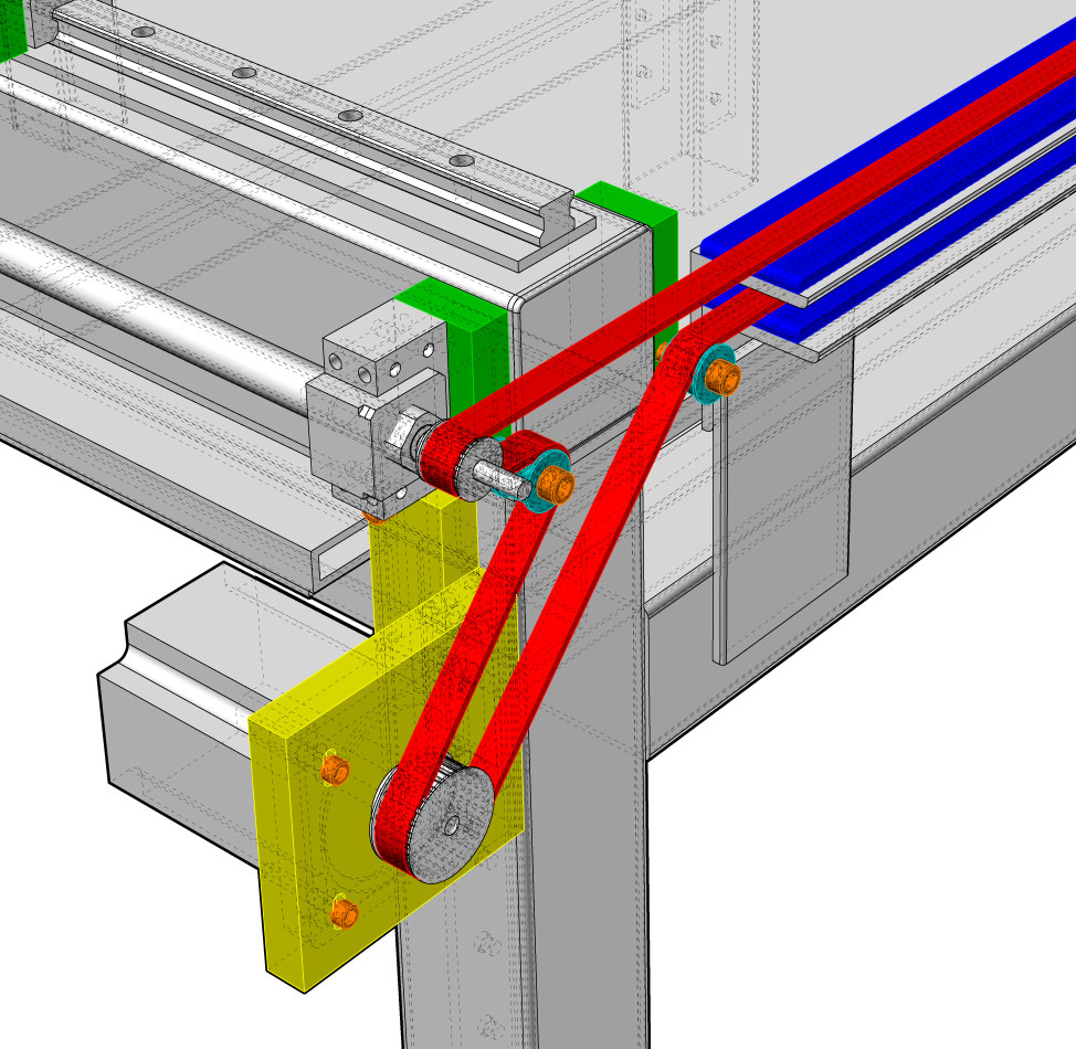

I'm still getting the best part of 7 teeth engaged and 5 fully. According to Jonathan this should be sufficient. I'll have a think...🤔 as always - appreciate the critique even if it does mean more redrawing (again and again!!)
Printable View

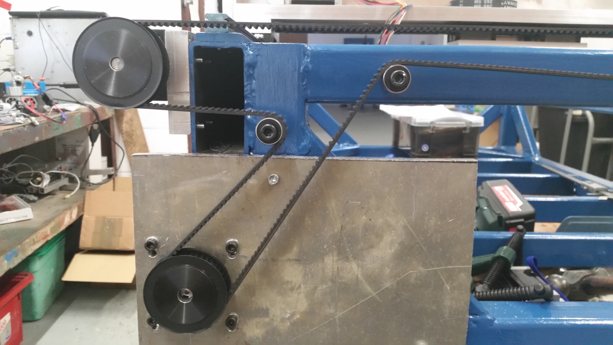

That's how I've bodged mine in, at some stage I'll design a neat back plate and use the machine to cut it.....a bit Heath Robinson, but it works :thumsup:
Attachment 17561Attachment 17562If at first you don't succeed... be glad you modeled it first!
That looks loads better Joe n1!
Cheers Lee!
That looks good Joe :)
New you would get there in the end Joe its tons better now:applouse:
That's it Joe.:thumsup:
Cheers guys. When measuring the belt to order a bespoke length, do you measure one side or the centreline or what? Won't make a big difference I guess but if there is a right way I'd like to know.
You build it then you get a piece of string and rap around pulleys and take to belt place and say I want one that long.!!:encouragement: (or then measure it's length.)

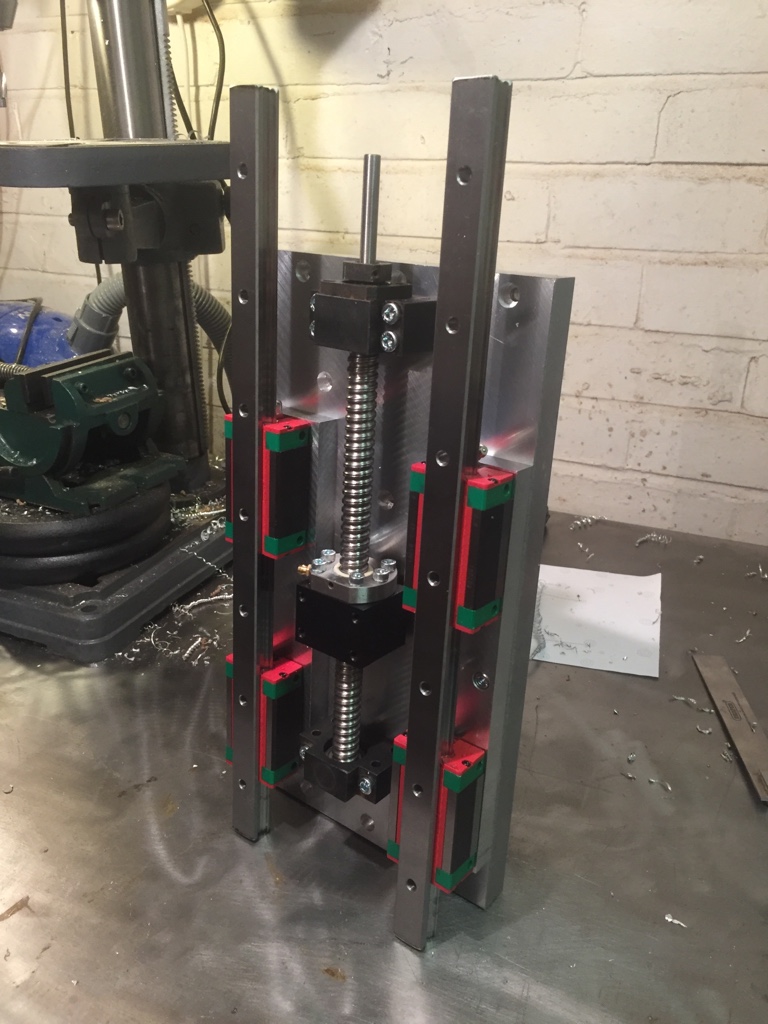

Z axis progress pictures. Attachment 17826Attachment 17827Attachment 17828Attachment 17829
Very nice as always Joe. Great idea on the spacer plates to save pocketing the ball screw BK mounts although it does push the spindle further out slightly. :thumsup:

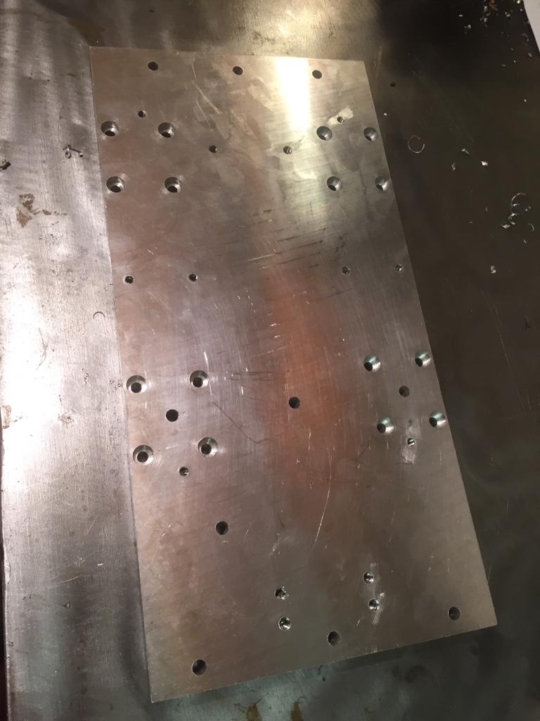

Attachment 18386
Surface ground and scored with sandpaper. Dams almost complete... Attachment 18387

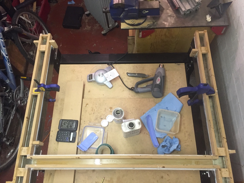

Ready to pour! Attachment 18429 I made some little brackets to hold the mdf in place Attachment 18430 sealed both sides with silicone so hopefully no leaks! Attachment 18431 and heat gun and Vaseline at the ready! Attachment 18432
Best of luck, looks like you've got everything prepared though so I'm sure it'll go fine.
careful with the heat gun joe you can easily cause hot spots which harden at different rate. Only a quick flash is needed and only if really needed. Few air pockets won't hurt anything.
Not quite sure what the vasoline is for thou.?
This is why you want slow cure epoxy - this a time lapse- https://vimeo.com/166112200 the movement is barely perceivable in real time. Attachment 18448 well it's done. Now we wait... Attachment 18449
Great stuff especially the time lapse video. It might be worth keeping the bridge between the 2 rails in place during initial setting up if you need a datum to DTI off to align the gantry Y rails - depending on the gantry rail design you've decided on
