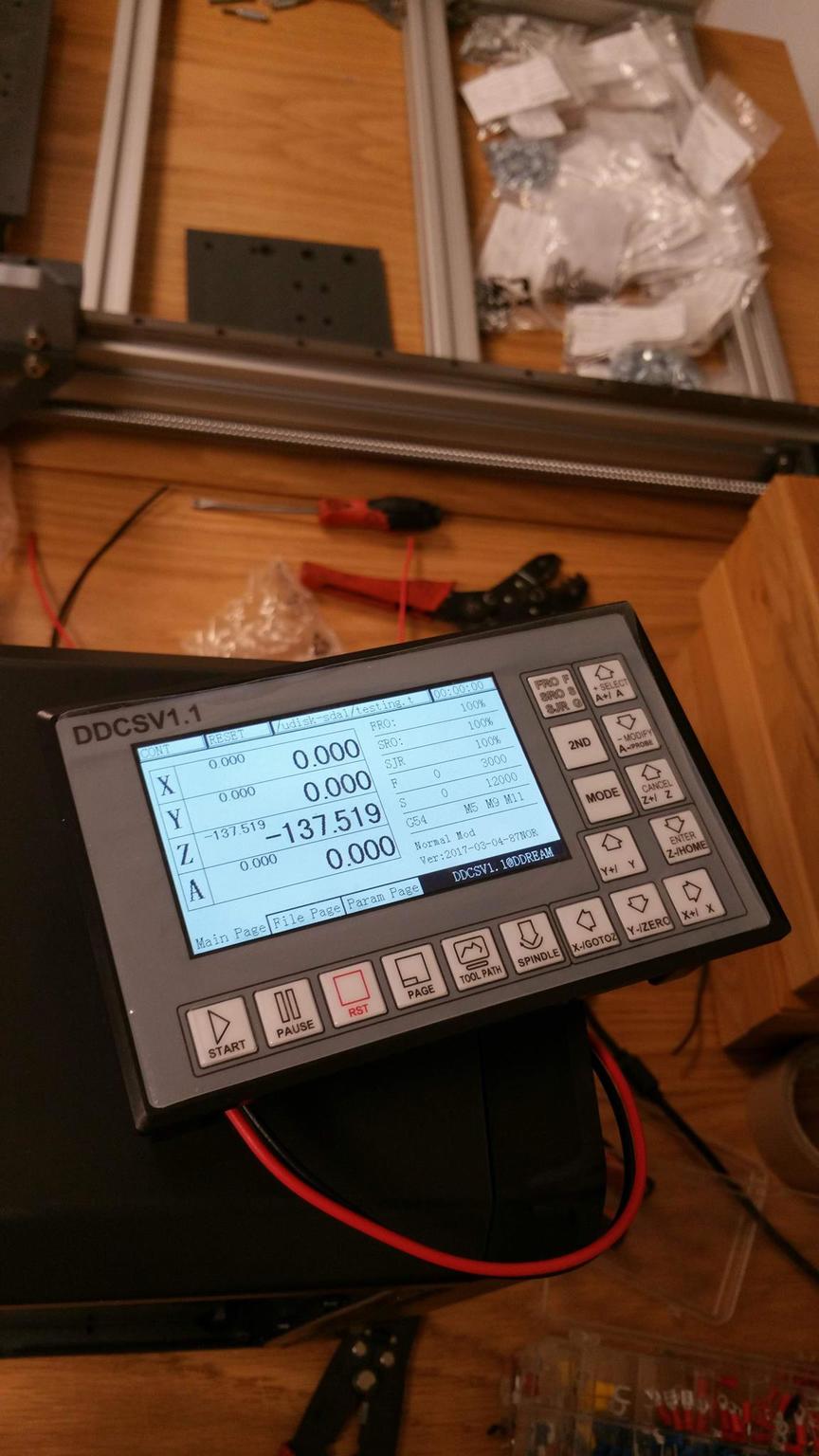

Done some more on the electronics whilst i wait for some bolts to come, also need to machine some mock up parts tomorrow to finish the dry assembling, then hopefully should get some movement early next week. Was confused as hell earlier trying to figure out wiring the VFD using single phase, actually it was simplest thing ever!
Need to decide if i want to mount the controller on top of the PC Case using some kind of Arm / Swivel attachment, then fix the PC Case to the Bench the machine will be sat on, or have the Controller as a portable unit. Not sure the machine is big enough to warrant a portable one.

Alex I would be putting some insulation over the mains terminals in the box before it bites you.:hororr:
Re: Building My First CNC Router, Looking for Advice & Other Info
Yeah i got a load of Heatshrinking to do, just wanted to make sure everything was functional before i made it pretty & safe :D
