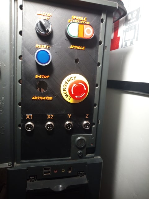

Surely the second hole for estop is for the big flashing lamp??
Why didn't I thought of that ! Now I need an extra big lamp to put in there!
Thanks guys you are all so kind!
I am thinking to place the emergency stop at the bottom right ,since there is the right hole for the switch and scrape the e- stop letters from the bottom left hole?
Maybe I can put another switch on the bottom left hole in the future a button that I can not think of now.
For sure I can print new letters or marking on the panel....

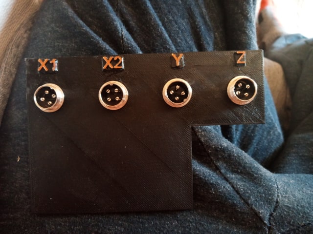

Small progress.
I 3D print the lower panel for the motor connectors no big deal but I like how the front panel looks now...:excitement:

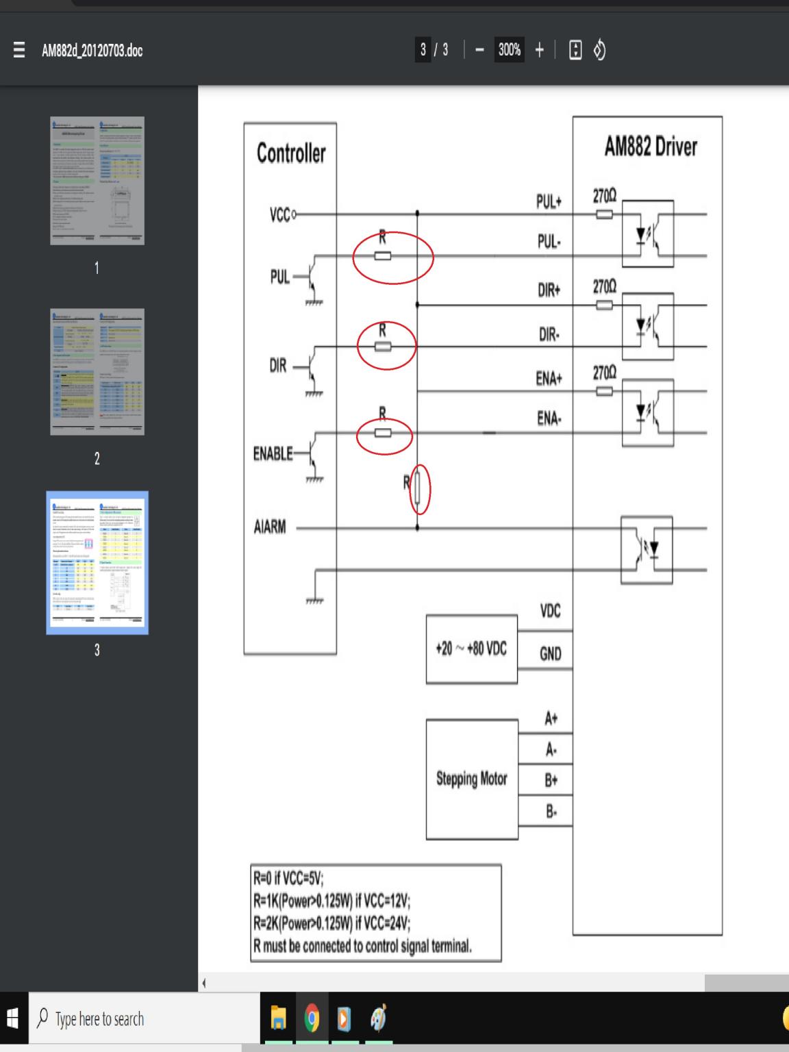

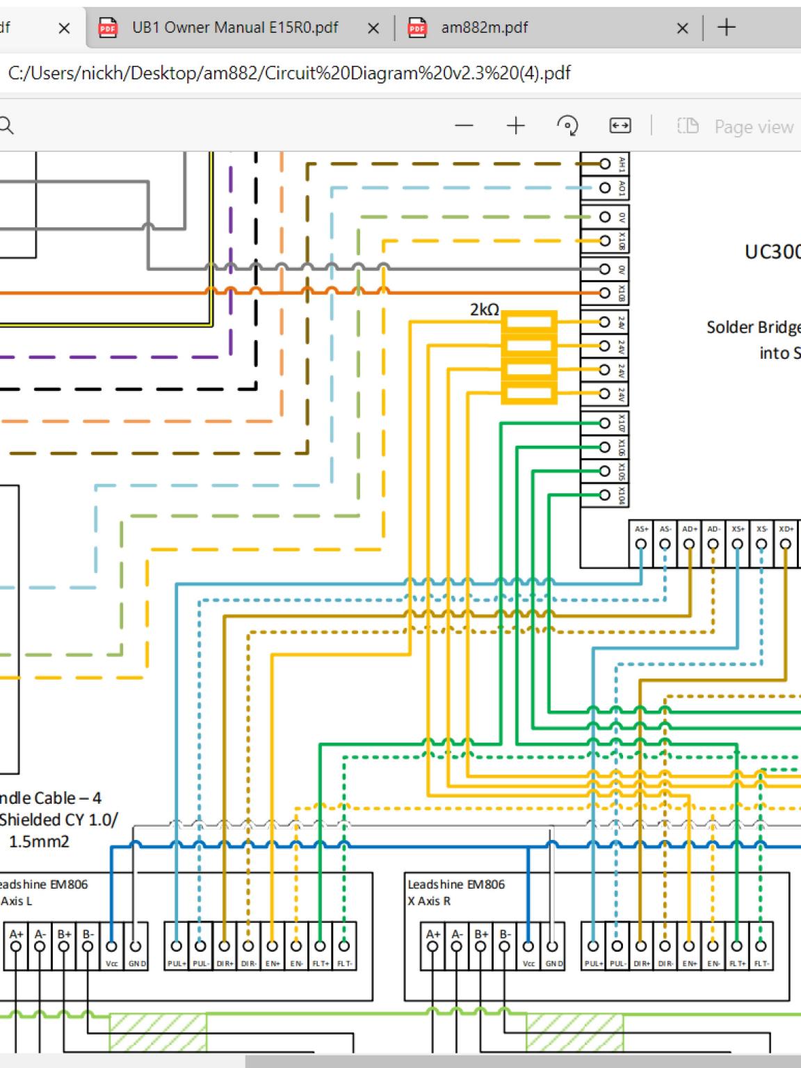

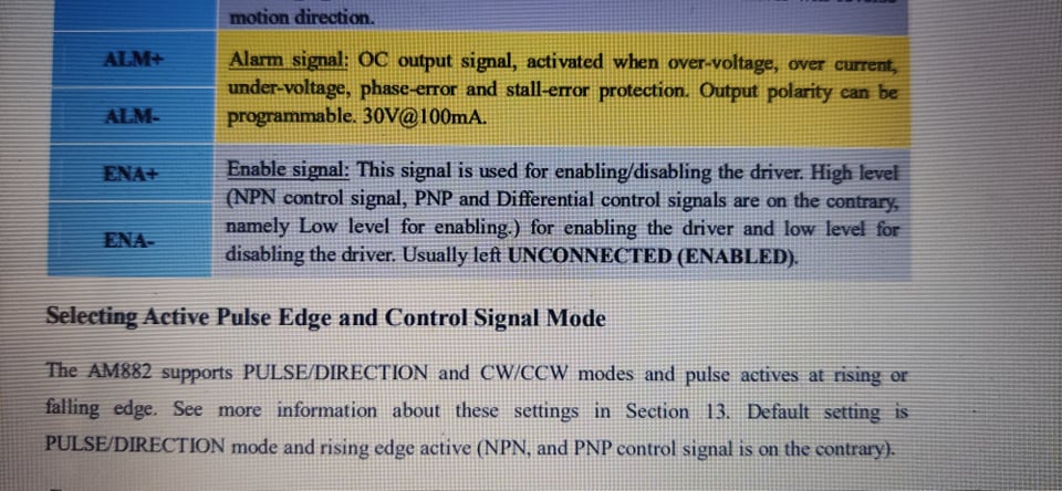

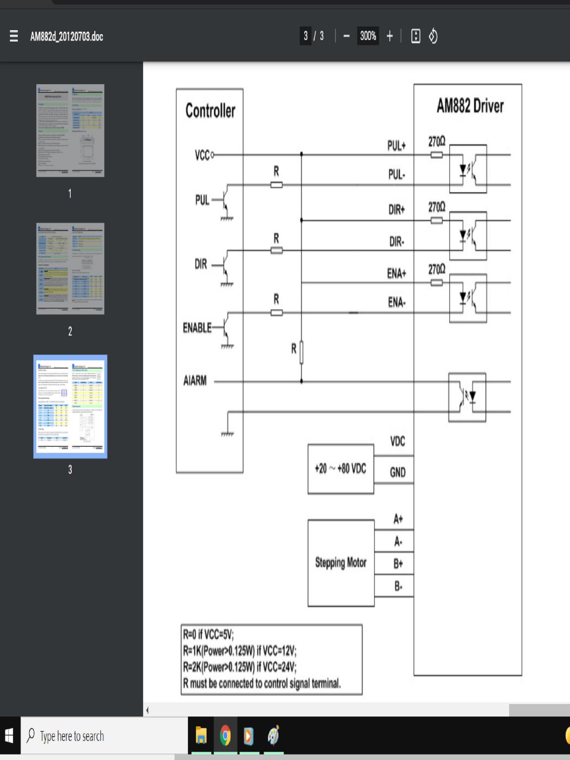

I am using the uc300eth UB1 with AM882 Leadshine stepper motor drive, as I understand from the Leadshine manual I have to use 2k resistors for the PUL- , DIR-,ENA- and alarm since I use 24volt outputs of UC300 eth ub1 right?
Can someone explain why the resistors are connected to - lines? Is that safe for the drivers? I have seen some diagrams connecting resistors at the + lines for protecting the drivers but this is the first time that I see the opposite.
Attachment 30222Attachment 30223
Re: 1200mmX900mmX170mm 4axis cnc
All the resistor does is limit the current to about 12 to 15mA at 24V going through the led
So is it safe to use only one resistor per driver, at EN+ as the diagram above?
Nickhofen
The MOTOR OUTPUTS are 5V not 24V, only the general OUTPUTS are 24V, so you don't need the resistors for the drives.
So I am going to use 2k resistors as shown on the diagram below, right?
Sorry for keep asking, I want to eliminate the chance to make a critical mistake.
Attachment 30224
Nickhofen
Attachment 30224
No, see my post below. You don't need resistors because the motor outputs are only 5v NOT 24v
I forgot to mention that at AB882 controllers you have to leave the enable pins disconnected otherwise the servos won't start.
Attachment 30303
Nickhofen
I manage to see my steppers move for the very first time last night.
Congrats Nick! Isn't it fantastic when things start moving?! Getting very close now!
I think the drivers being enabled when disconnected is the default behavior. I changed mine in the protuner configuration software to need the enable signal in the opposite direction. My thoughts being that an active signal of "yes motor you can move" is better than "no signal means everything is okay" because if a wire got disconnected it fails into a safe state.

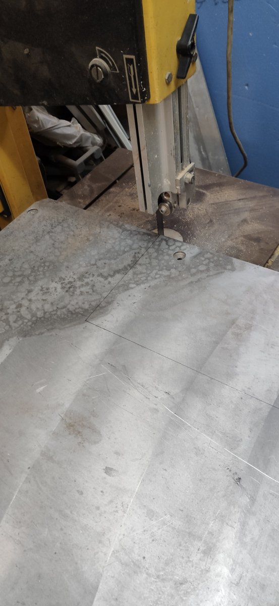

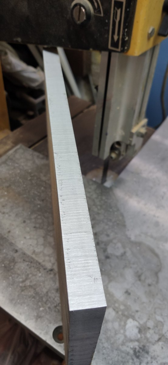

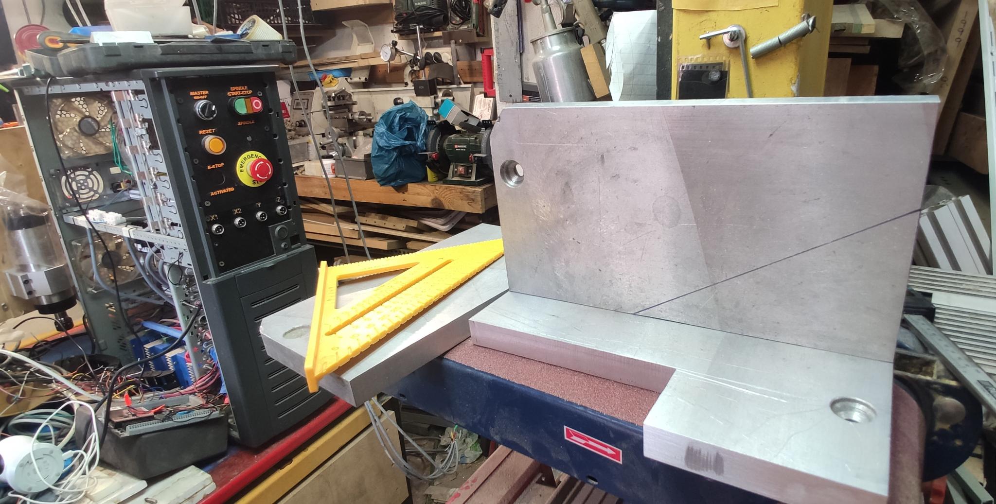

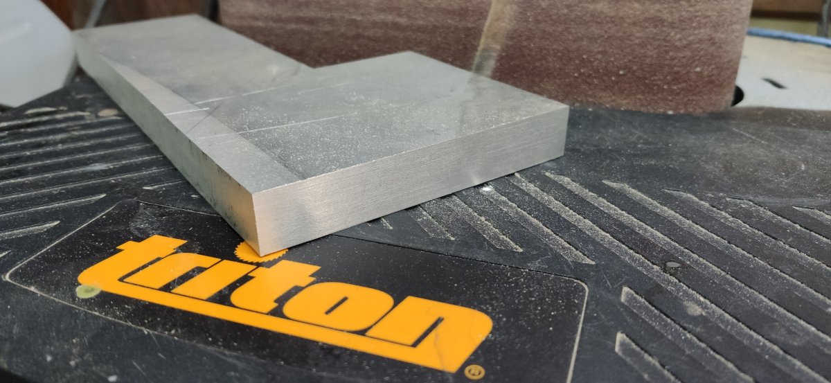

I cut with my bandsaw the 20mm thick aluminum plate I bought from a scrap yard for 80 euros, to replace the MDF I use to mock up everything.
Things went well.
Attachment 30733
Attachment 30734Attachment 30735Attachment 30736Attachment 30737
