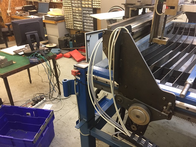

That's a lovely machine I'm interested in why the z ballscrew/lead screw is so big?
This is what I know as SY cable Attachment 21878 metal braided armoured cable it really doesn't bend much.
This is not what's in your energy chain is it?

I bought this machine as a barely working home made table, wiring was atrocious, much of the mechanics were ropey, but it worked. (I needed to cut some bits for a 6 foot flail mower I was repairing), but I bought it in the knowledge that I'd eventually have to re-build it.

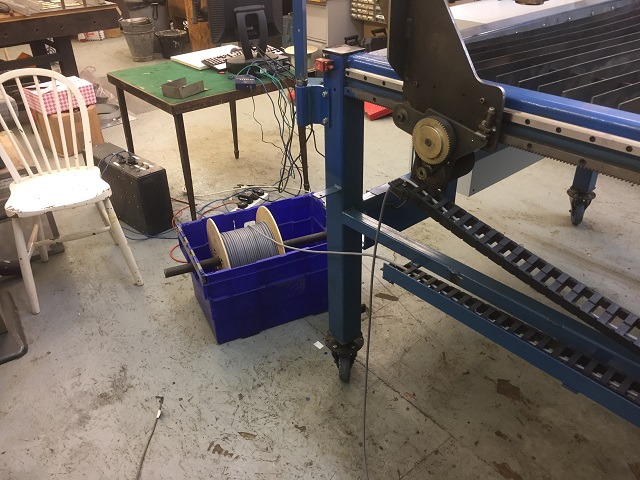

Cable ordered.
