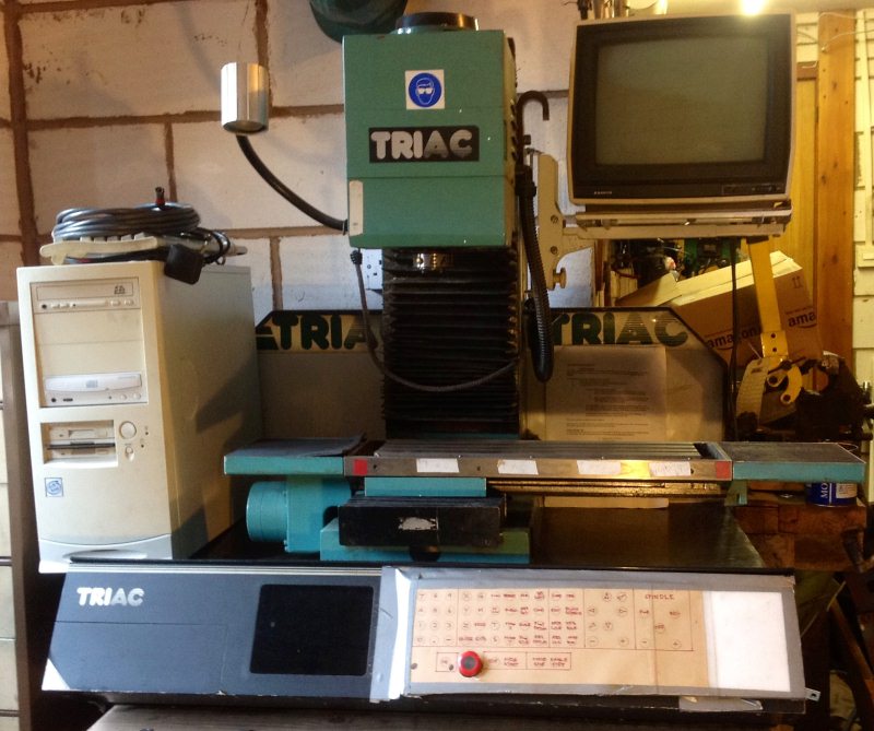

Hi all,

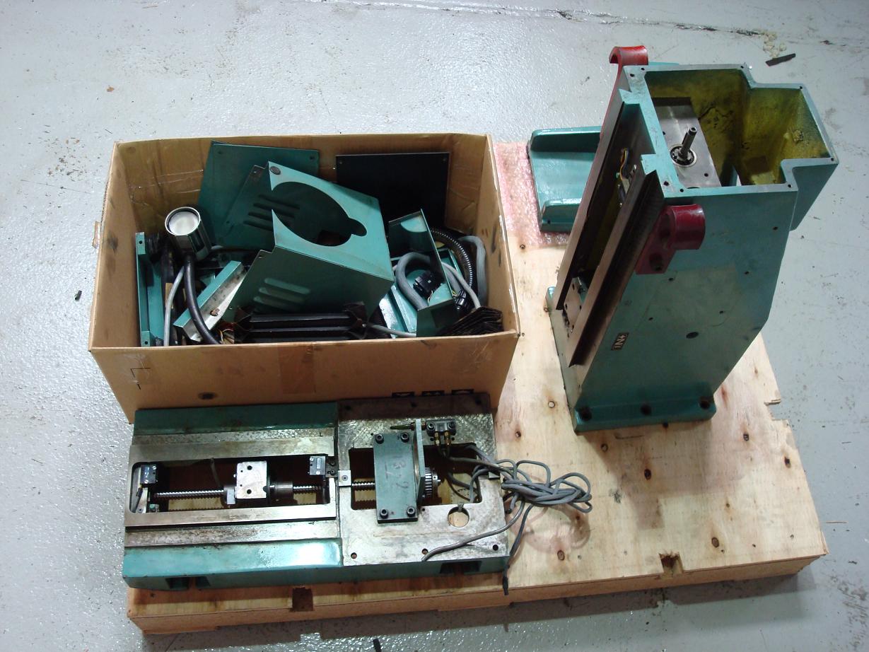

I bought a Triac (The green one with stepper motors) and I started the conversion to run on Mach3.
Here are some pics of what I've done so far...
first, machine as received, then disassemble and got reed of the base (too big) ready for transport home!
Attachment 6592Attachment 6593

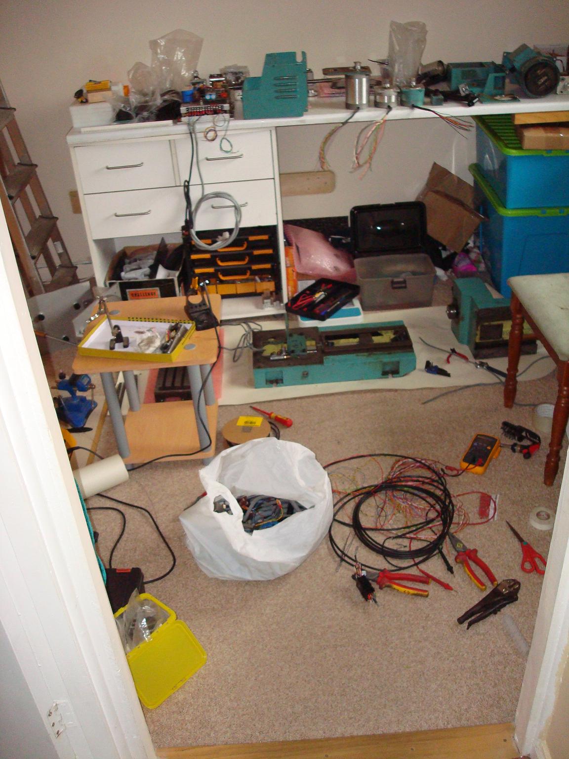

Now, move upstairs in the side bedroom (yes bedroom... :barbershop_quartet_ )
Attachment 6594Attachment 6595Attachment 6596

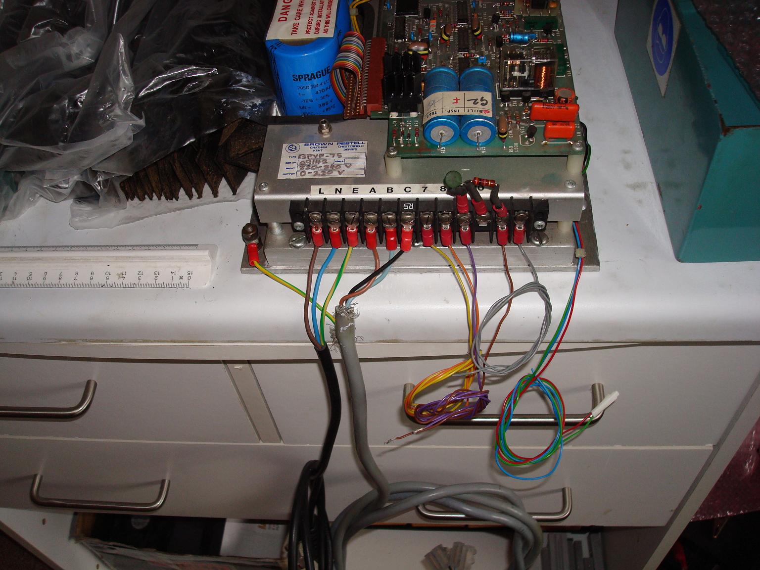

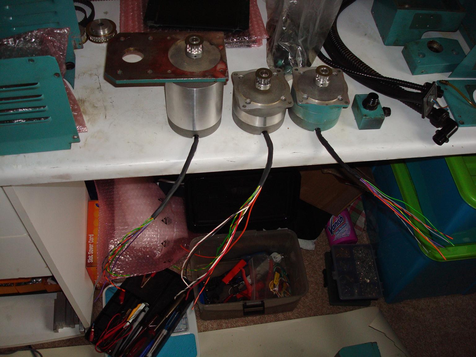

Start wiring 3 Phase spindle drive and stepper motors.
More coming soon !
RNR

OK,
I received the electronic now, except for the 3 phase inverter.
I got all 3 steppers running. Now looking for a suitable enclosure.

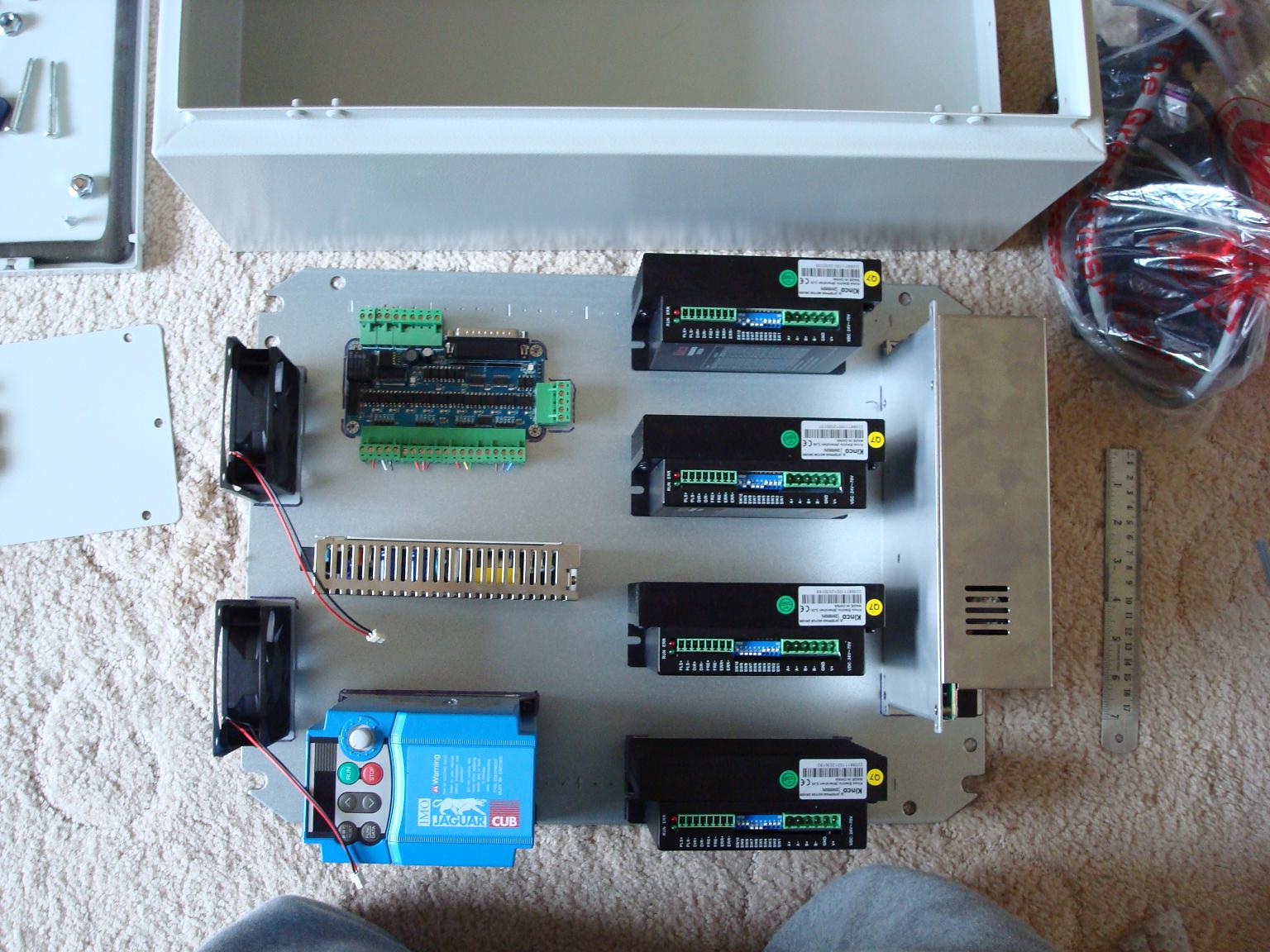

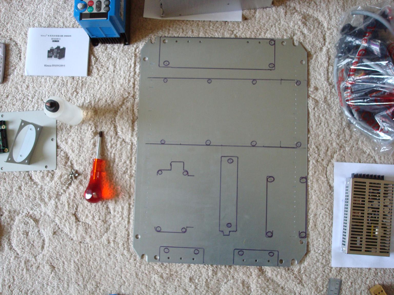

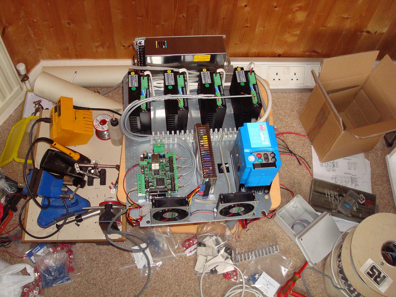

3 Attachment(s)
Re: Denford Triac Mach3 conversion
Hi all,
I started to put the new electronic together this weekend. See pictures attached. :playful:
Attachment 6684Attachment 6685Attachment 6686
Waiting for more bits to before putting it all in the enclosure...!
RNR
