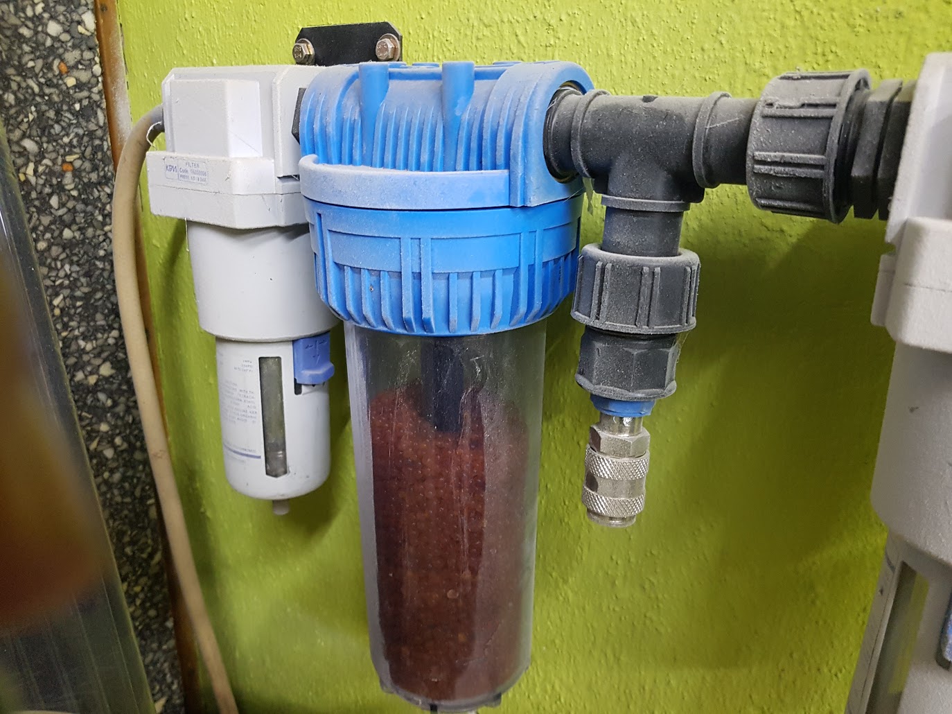

MDF looks nice when sealed with Acrylic Primer , used in cars and then finished at least with 2 component Polyurethane Paint. Or car paint.
If perfect finish is desired, it should be treated exactly like painting an expensive car. Thick primer, Thin Primer, etc...
Having said that the typical industrial finish is Polyurethane.
Don't you have a local professional paint shop or a place where they sell car parts to mechanics? These are the right places to find all cheap and compatible.
I did not get if you would be painting professionally or not, but i assume yes.
1. You need a proper Gun/s . Saving money here will make you sorry later. These are the guns i made a present to my wife's father. he is a carpenter and uses them exactly for the same purpose like you. This is just basic setup. Just to compare i am using a cheapo chinese gun for crap and 400euro 3m gun for important stuff.
You will need that sizes nozzles for the primers and the other for the actual painting
2 x Devilbiss SLG-620 Compliant Spray Gun Gravity Feed 1.3mm/1.8mm Paint/Primers
2. Any normal car primer will do / not if you use epoxy, you will need a better one.
Synthetic High Build Primer Grey Fast Drying 1L/5L
3. Hempel is a good quality polyurethane paint. Though as i said your local paint shop is your best bet, as there paint will be around 18GBP, and they will have the proper thinner and base. hempel for example is double the price.
In short, locally=cheaper, better
PS. Without air drier =Mission Impossible. DIY one from water filter vase filled with reusable silica
Attachment 18856
PS2. Even if you are tempted to use cans, dont do it. You will never even get close to the desired result, whatever sb would advise you. There is no free lunch.
There are no short cuts to a really good finish. And it all starts with the material, and preparation.
MDF is probably not the right material for a high quality paint finish. High density fiberboard is a better choice, as it's less porous.
Any wood type product is going to need all of the pores sealed, followed by a heavy coat of primer, sanding, filling, more primer, and more sanding before it's ready for a top coat.
As I mentioned earlier, I seal my MDF with epoxy.
My method will eliminate most priming and sanding, but it's time intensive.
Cut your part about .1mm oversize, and leave an onion skin of about .25-.5mm thick. Do not remove it from your machine!!
Brush a heavy coat of epoxy over all surfaces, especially cut edges. Wait a few minutes, and do it again, so it soaks in thoroughly.
Wipe off any excess from the top surface, as you don't want to have to sand or machine it away.
Let cure.
Cut your part to the finished side.
The edges should be smooth, like a hard plastic, right off the machine. Prime and paint.
