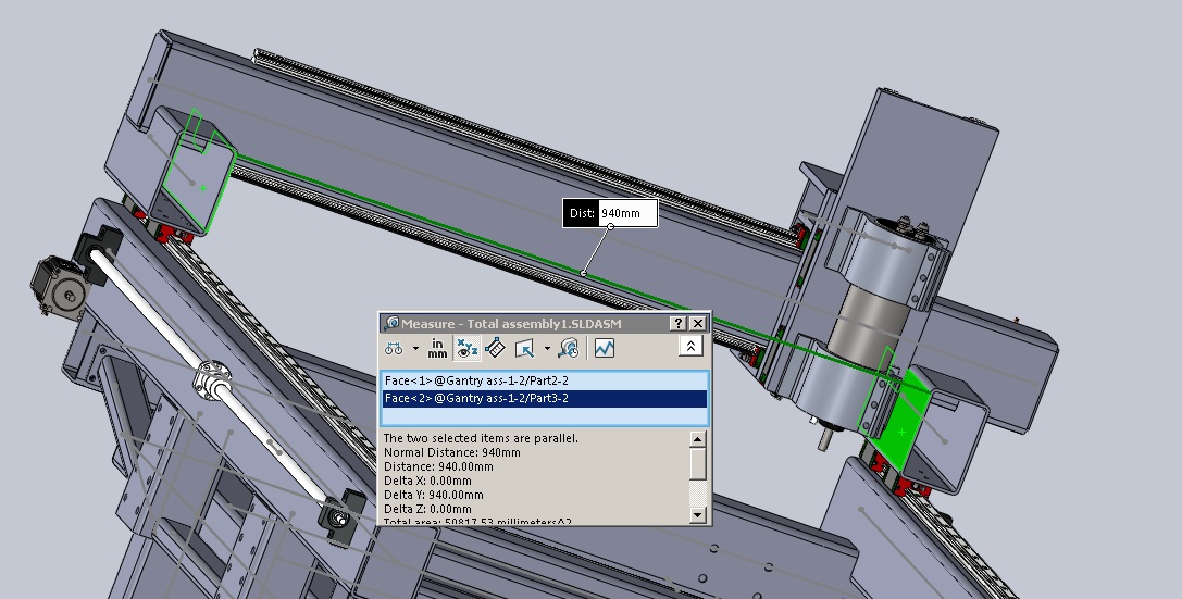

Ok... so i am in a bit of a struggle... i am not sure about my gantry beam.. i have not found a way to calculate deflection for the beam.. Iam not a strucural engineer ☺
So my beam is 940mm wide between the rail blocks. It is a 120h x80w x4t mm profile.
The maximum z extension is about 25cm on the tip of the tool.
Planned working extension maybe 15cm
The tool is extended about 15 cm.
Can sb point me to a tool to guestimate deflection based on real world cutting forces?
Is read on this forum cutting forces in any given direction do not exceed 400Newton? In soft metals.
I need this info to guestimate the total weight of the gantry and continue on to electronics selection...
Any help is welcome here.
Bert.

cnc machine stiffness calculator
for soft metals 120x80 x4 is not rigid enough . Weld 2x / 1 thin side and one wide side 10mm steel plate/ and you will have reaper

I think i better step up to a bigger size gantry beam maybe 120x120x10, there will be more meat to mill flat also.
BTW i cant weld more than 4mm.
Oh... endcaps ... hmmm well...
Need to figure out that one
I will bolt the gantry beam to the bearingblock mounts i guess then.

If its to cut wood and occasionally aluminum its perfectly fine.
But apart from deflection, there is ringing, vibration, when cutting metal. Ideally when an engineer is designing a machine he will know frequency of the tool - material and space bearings of Z and all other parts so it does not synchronize so all starts ringing like a bell. And i suspect use much more weight than needed just to be sure .
I remember what Dean said about one commercial machine , an expensive one, that if you hit it with a hummer it would "thump" not ring. So thats also important especially with metal machining.
In a DIY situation after designing a couple of machines as light as possible and as rigid as possible / blamed to be OTT even / i believe using 10mm plate as an additional steel bracing here and there we could imitate at least 5-8 times heavier machine properties.
For example my machine /1300x2600x200/ weighs 700kg all included and is at least as strong as 4 ton commercial one, if not more. You could lift it and hold it from one side, other side in air and deflection will be less than 0.05mm if not less than 0.01/
So remember the magic word- " bracing" with thick 10mm steel in all possible directions to imitate solid shape properties and at the same time keep things light. If you are making a machine to work aluminum. For wood your problem always will be not this but the spindle KW and how fast the machine could move.

Ok.. so i did some calculations.
Based on my original design the total moving gantry weight is +/- 65kg
~32kg z
~65kg z+y
Aditional bracing would add some 35kg.
Can this still be run on twin nema 23 / 3.1 nm gearing 1:2/ 1610 screws (y)

Yes it will be fine. Your good to around 90Kg
Re: Initial design advise wanted
You mean additional bracing will add 35kg to the 65kg? It will become a bit heavy for steppers then. Problem starts that it's ok for steppers at 1:2, but steppers are not like servos to spin reliably at 3000rpm or even 1000. So i think then it could be better to use bigger motors/ that will need bigger and much higher voltage drives /
Then just brace with 1 plate on the 80mm side from bottom of the gantry beam. That should be enough. You keep the weight right, also the rails themselves when bolted on are very strong. As bend from forward backward movement could be the biggest eventual problem and that will prevent it . You could always bolt sth at the back later if needed.

3 Attachment(s)
Clive S
Yes but is that the design with the extra bracing you want to put on?
Clive eh no, the initial gantry design is 65 KG with no extra bracing (80x120x4). The profile used is 940mm between the linear blocks.
Attachment 19331Attachment 19332Attachment 19333
The profiles on the gantrysides will have inserts so the m5 bolts can still be reached but sides ways flex is stopped.
Maybe i need to brace the Z slide on the sides ... aluminum can be flexi i heard.
What i am thinking about is maybe step up the gantrybeam to 120x100(or120x120)x5mm .... the linear rail wil be mounted close to the edge of the profile, for maximum stifness.
It will also generate some extra space for cable management, i have to look in to that too for the long axis also.
Some diagonals in the legs. maybe panel icw kabinets.. to be determined.
Filling the Highlighted parts with sand may do some good anti vibration and ringing?
