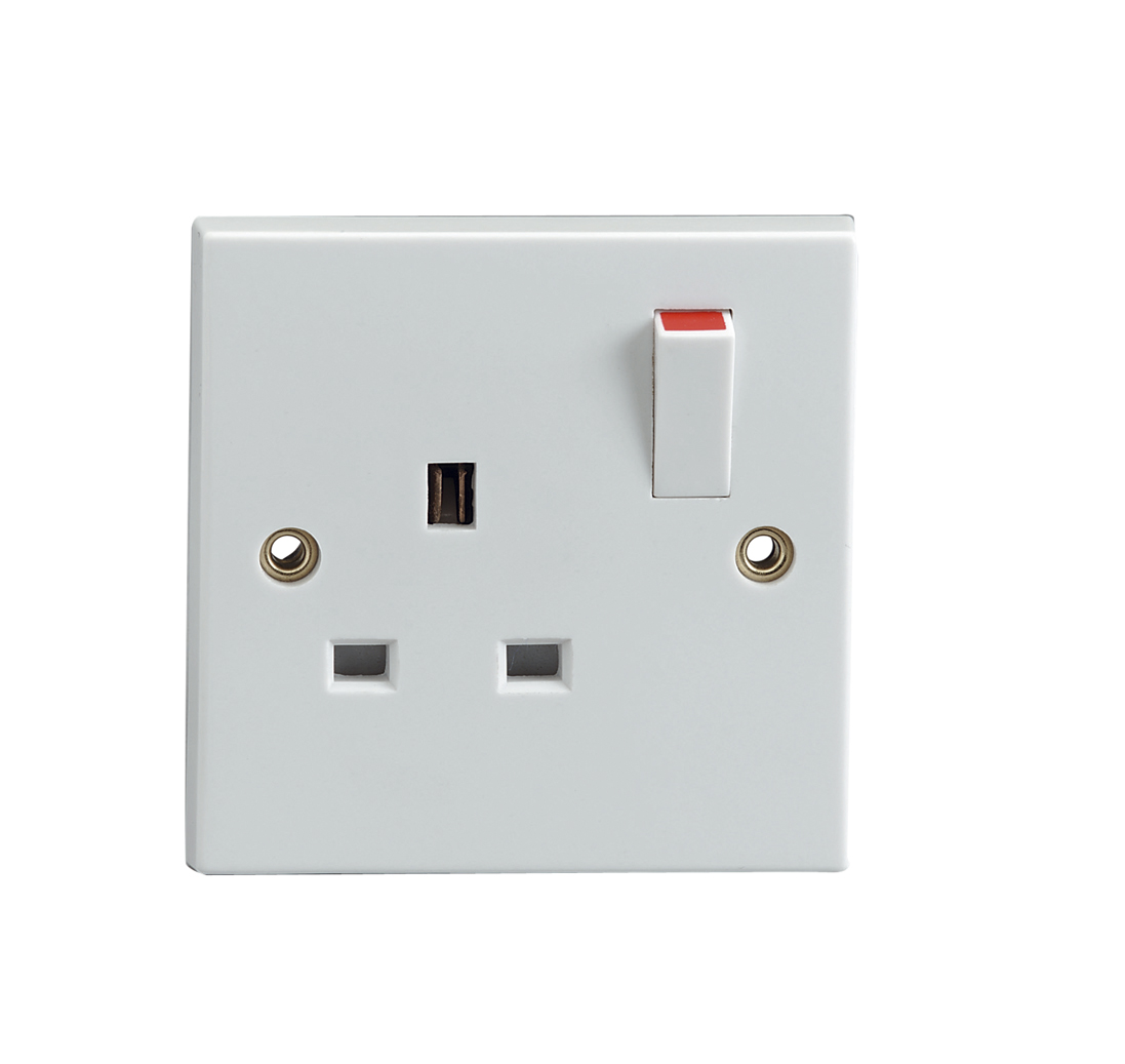

		Personally, one of these:
Attachment 19581

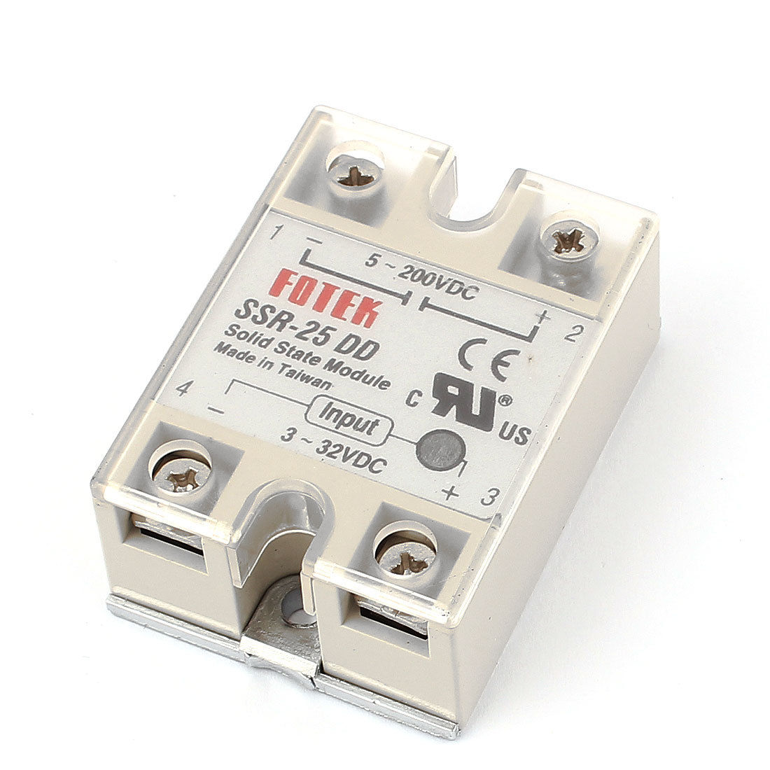

Or, if you can spare £1 on eBay, a 25A SSR:
Attachment 19580

 I didn't have much joy using an SSR to switch my toroid supply on.  Can't quite remember what it did now but something didn't work.  I then read they aren't good with these types of loads.  They also fail ON.  Swapped it out for branded contactor (controlled by 24V logic on an estop circuit) and it works fine.  Thanks to a kind forum member for sending me that part FOC !
Would go the contactor route if I ever built another.  The inrush current bothered me but then it not really my area to comment in detail.
The mains switch made me chuckle.  Should also be fine but then it's not part of a safety circuit if you want to have that feature in your system
 This could be because some SSRs switch only at the nearest zero crossing point, which is the point that gives the highest inrush current for a transformer, so not such a great idea. Other than that I can't think why they wouldn't work well.

		I did look at a peak switching SSR, but after seeing the price, quickly abandoned that idea.

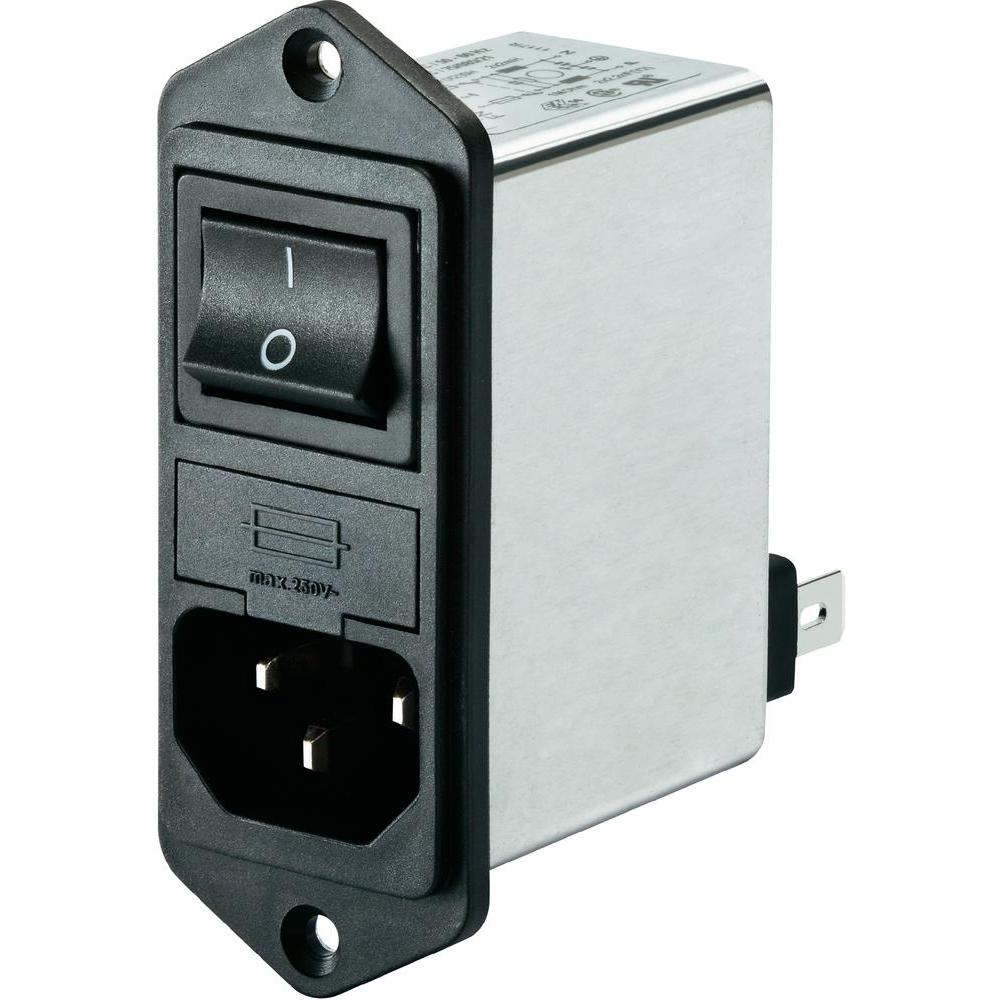

 I have a switch with fuse and filter like this one...
Attachment 19582

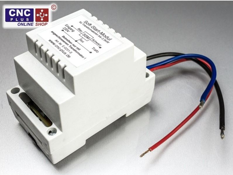

...and after that a slow starter like this:
Attachment 19583
Switching on slowly means no "bang" and current rush. Switching off is no issue at all. The currents are MUCH less than a vacuum cleaner.

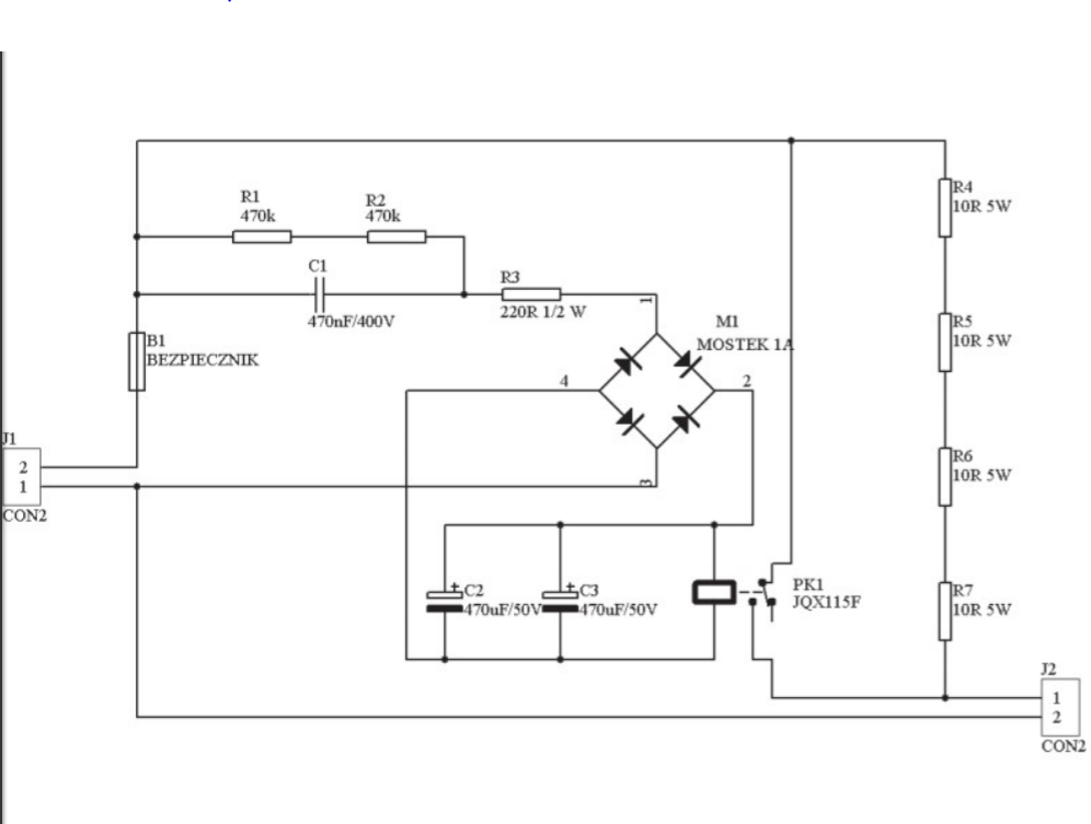

		I use the softstart, via 240v switch, than contactor via fail safe latching, but after reading few post will try MCB type D without softstart - will upload results.
Meantime here is my softstart
Attachment 20210
It switch primary coil via 4x10W resistors  just to kill in rush current and after second small relay bypassing resistors before they became too hot. This delay is enough for peak to go down.
This is only inconvenience for toroid trafo I know.
